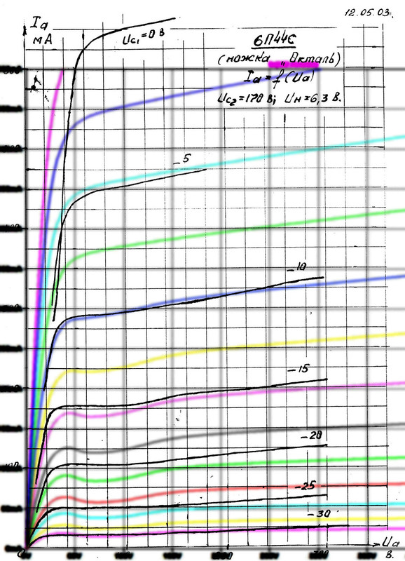

I have tried to make a code for Russian tube 6П44С / 6P44S using pentode paint tools. This is the code I got:
This is how it fits - not the best, but I couldn't make it fit better. Please note that I have Vg with 2.5V steps (color lines), while original has 5V steps. Curves are OK for 0, 5, 10, 15 and 30V, and 20 and 25 are not good. How to fix this?
Which parameters shall I try to adjust to make this kink smaller and to make less slope at the coordinate system origin?
To fine tune kink, click on "kink" will pop up a small window you adjust it. Ex controls how much the entire curve is bent to left or right, while Kg1 control only the slope of curve. I have reduced the Ex and Kg1. Vg2 should be 175v, you can turn on the "Screen Current" and "Triode Mode" to make sure the current is not to high.

**** 6P44C ******************************************
* Created on 05/26/2020 19:03 using paint_kit.jar 4.7
* [URL="http://www.dmitrynizh.com/tubeparams_image.htm"]Model Paint Tools: Trace Tube Parameters over Plate Curves, Interactively[/URL]
* Plate Curves image file: 6p44c.png
* Data source link: <plate curves URL>

Thanks! It would be nice to have some kind of description for all those parameters, but quite simple. For example, if you change X, it will move curves this or that way. This is too complicated for me 🙁
Also, did anyone tried to manually read values from datasheets and write them into text files, and then to feed that data to ExtractModel.exe from dos4ever.com? It is a software for making models from data read using their tube tester device called uTracer, but I suppose it can be used for manually entered data.
Read this article you may know what some of the Koren parameters do as well as how to manually digitize curve require for data extraction. There are many digitizer online but it may be not in format you required. You can also use Curvecaptor to digitize the curve and it will output a data file which you can further tailor to required format.
I can't get this pop up window for additional controls for kink???
The popup windows may be outside the display area, try to restore down and resize it, the small window open / close when kink icon checked / unchecked.I can't get this pop up window for additional controls for kink???
You're right! It shows when main window is not maximized. There is a bug - if the main windows gets maximized BEFORE you click on Kink, then this pop up window will not show. So one must click on it before maximizing the main window.The popup windows may be outside the display area, try to restore down and resize it, the small window open / close when kink icon checked / unchecked.
It's a hard one to fit, indeed! That's the best I could do, but the trouble is if I fit 0-5V fine, then 20-30 is too far from graph, and vice versa. So I tried to fit 20-30 range the most, because I presume that total error is smaller then.
