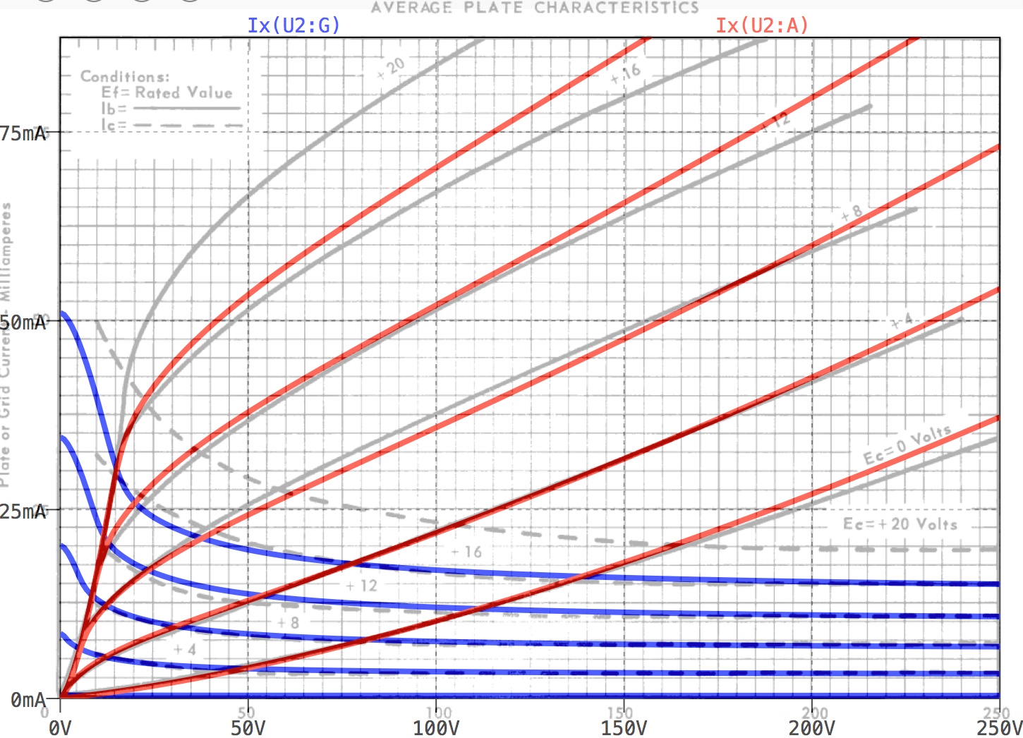

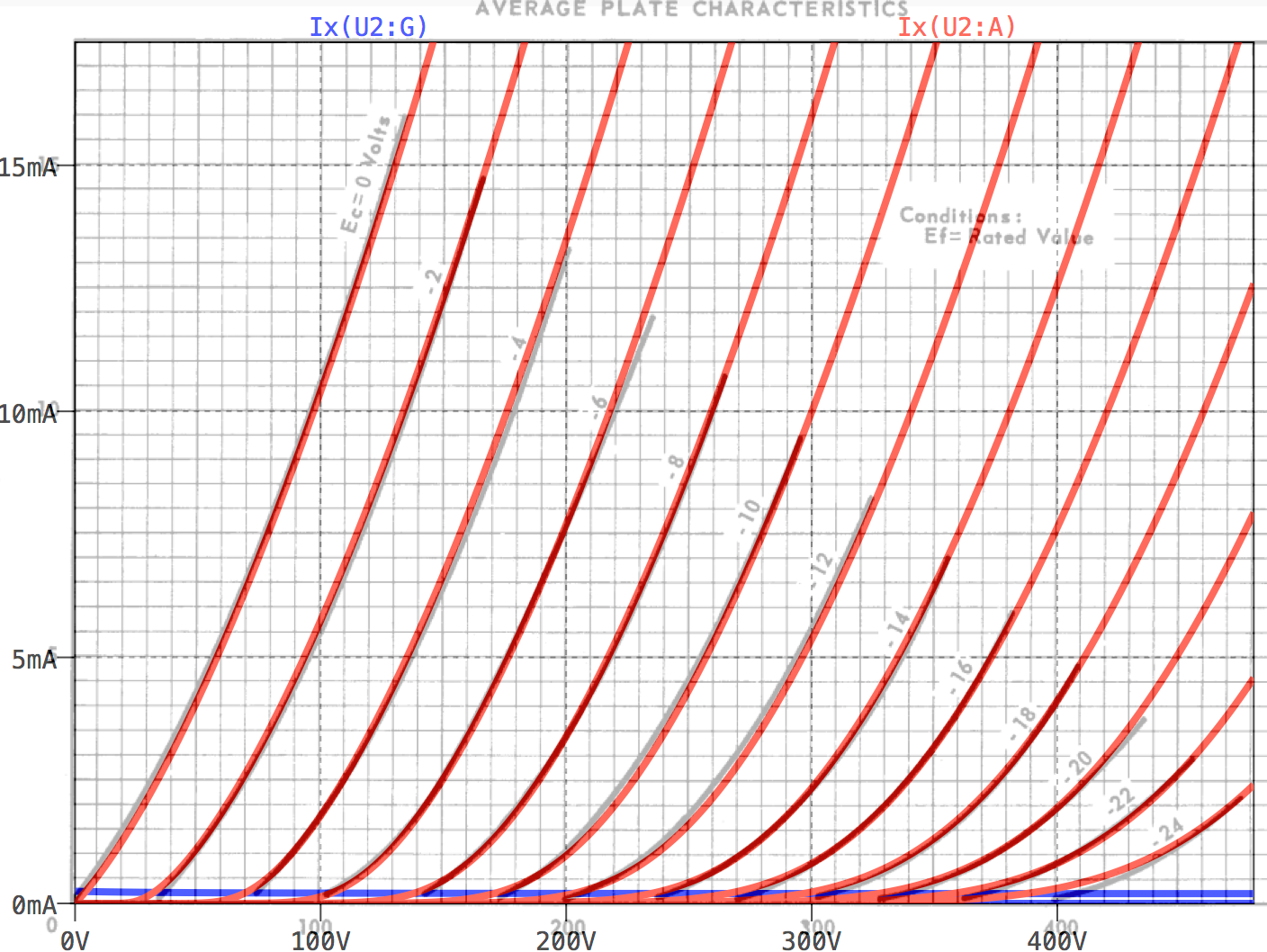

...here it is!
As mentioned, its is based on the Raytheon 6SN7WGT data sheet.
While the negative grid voltage range was easy to fit, the positive grid voltage range was difficult. But the result is usable up to Vg=16V.
all the best, Adrian

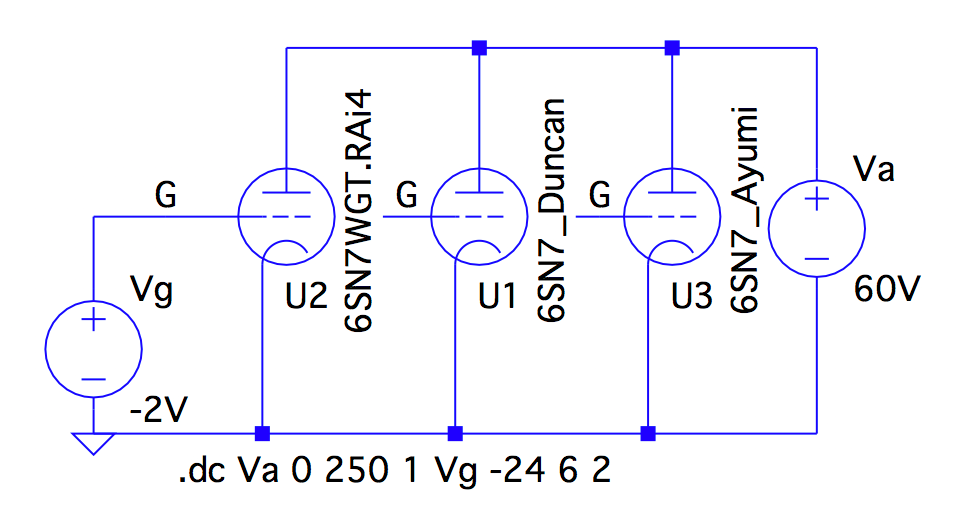

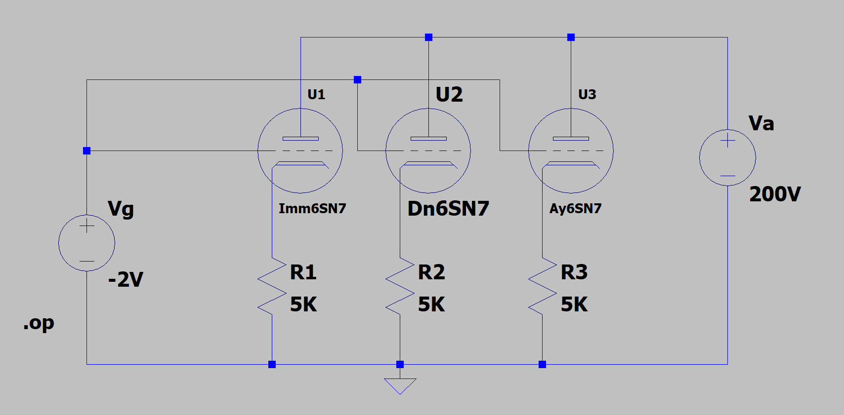

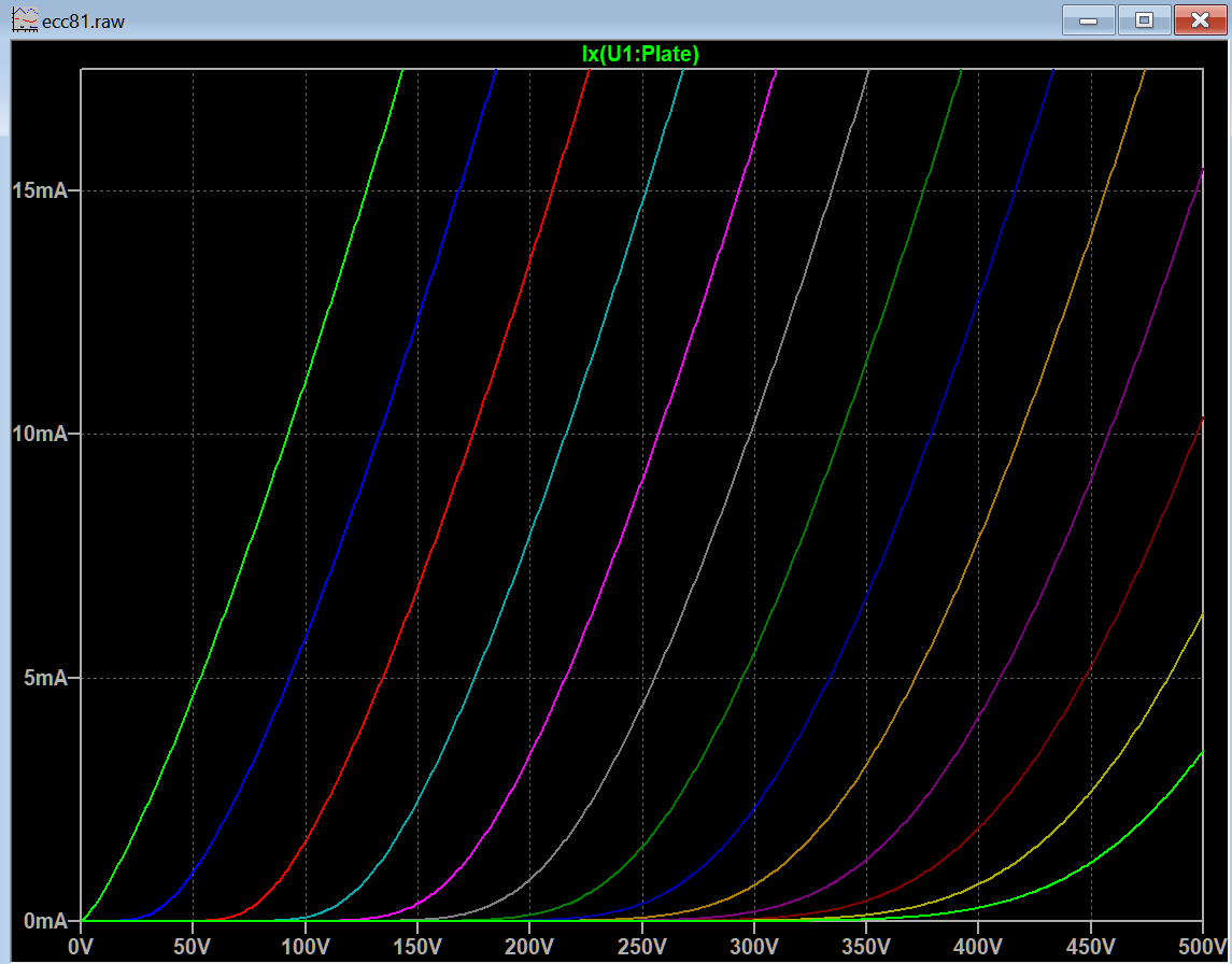

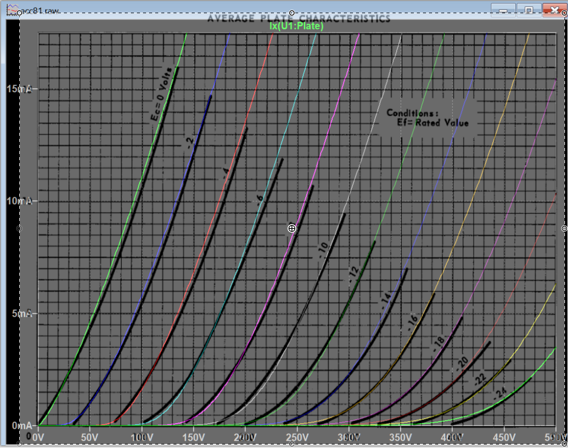

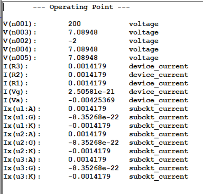

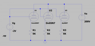

OK, I've done 3 separate simulations for this tube, the Immler, the Duncan and the Ayumi. They all give identical results in every aspect, down to 6 decimal places. Surely this can't be right! I have used the 'long-hand' method, as first taught to me by Admin Mooly. I can only think that I have made an error in my file-naming or writing to the 'tube.lib' file. I need to check, but I have my doubts.
I would recommend to drive a.dc simulation, e.g. like that:
.dc Va 0 250 1 Vg -24 6 2 (see attached picture)
with all the 6SN7 models you have, in parallel connected.
This way, you will easy see the differences of the models.
cheers, Adrian

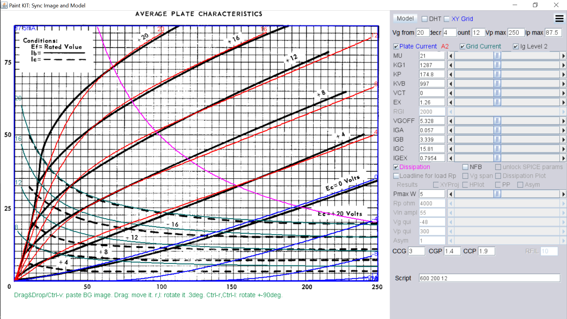

Here is my Raytheon 6sn7 model with grid current level 2, see how it compared with any other model:
Code:
* [URL="http://www.dmitrynizh.com/tubeparams_image.htm"]www.dmitrynizh.com/tubeparams_image.htm[/URL]
* Plate Curves image file: 6sn7-ry.png
* Data source link:
.SUBCKT 6SN7_RY 1 2 3 ; Plate Grid Cathode
+ PARAMS: CCG=3P  CGP=1.4P CCP=1.9P
+ MU=21 KG1=1287 KP=174.8 KVB=997 VCT=0 EX=1.26
+ VGOFF=5.328 IGA=0.057 IGB=3.339 IGC=15.81 IGEX=0.7954
* Vp_MAX=250 Ip_MAX=87.5 Vg_step=4 Vg_start=20 Vg_count=12
* Rp=4000 Vg_ac=55 P_max=5 Vg_qui=-48 Vp_qui=300
* X_MIN=32 Y_MIN=35 X_SIZE=821 Y_SIZE=576 FSZ_X=1296 FSZ_Y=736 XYGrid=false
* showLoadLine=n showIp=y isDHT=n isPP=n isAsymPP=n showDissipLimit=y
* showIg1=y gridLevel2=y isInputSnapped=n
* XYProjections=n harmonicPlot=n dissipPlot=n
E1 7 0 VALUE={V(1,3)/KP*LOG(1+EXP(KP*(1/MU+(VCT+V(2,3))/SQRT(KVB+V(1,3)*V(1,3)))))}
RE1 7 0 1G  ; TO AVOID FLOATING NODES
G1 1 3 VALUE={(PWR(V(7),EX)+PWRS(V(7),EX))/KG1}
RCP 1 3 1G   ; TO AVOID FLOATING NODES
C1 2 3 {CCG} ; CATHODE-GRID
C2 2 1 {CGP} ; GRID=PLATE
C3 1 3 {CCP} ; CATHODE-PLATE
RE2 2 0 1G
EGC 8 0 VALUE={V(2,3)-VGOFF} ; POSITIVE GRID THRESHOLD
GG 2 3 VALUE={(IGA+IGB/(IGC+V(1,3)))*(MU/KG1)*(PWR(V(8),IGEX)+PWRS(V(8),IGEX))}
.ENDS
