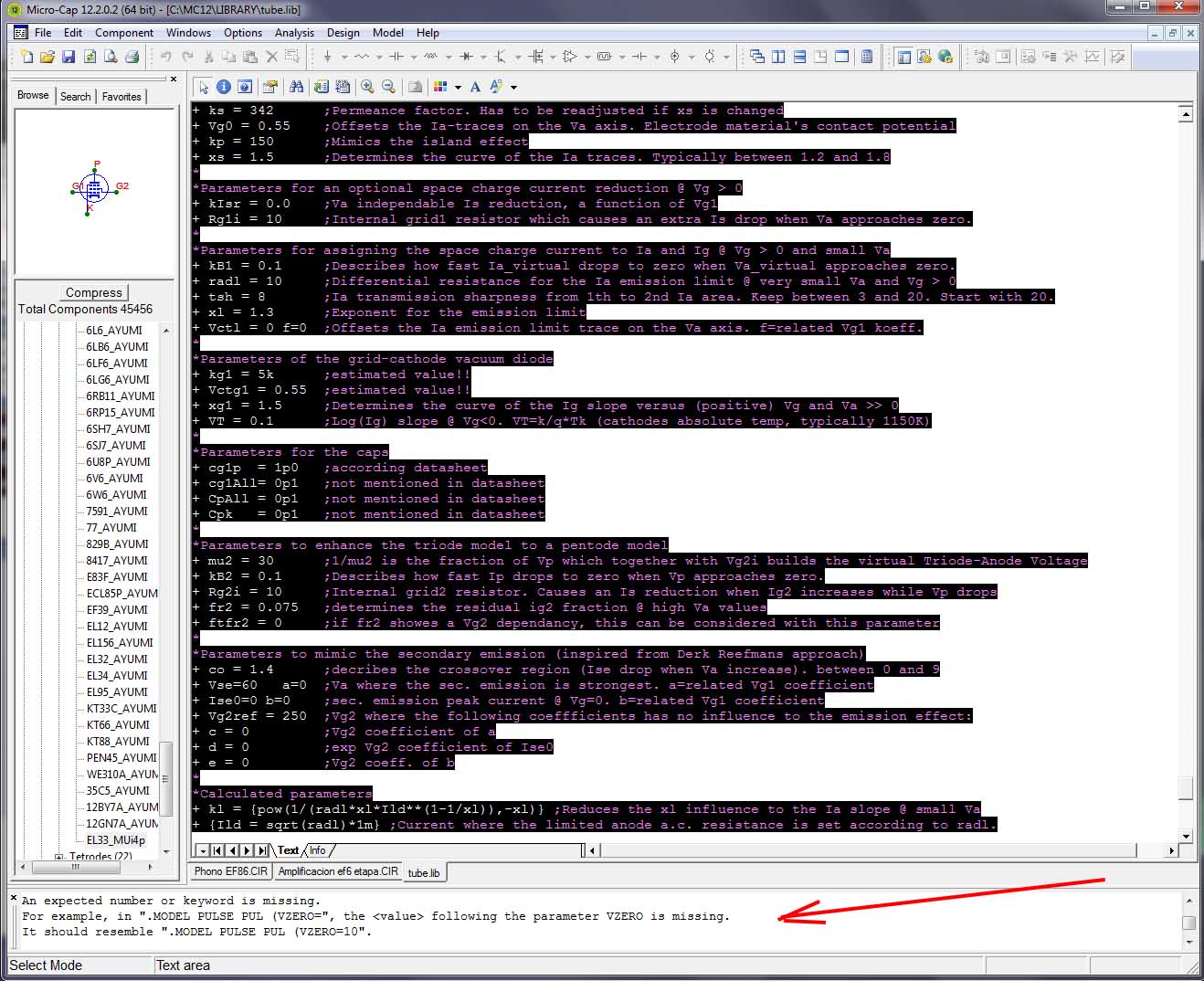

Adrian, I have deleted "the dot", I have also replaced it with "an underscore" as I have seen in other designs. When using the tube it gives an error. Look at the photograph.
Pillo69,
you modified the Ild codeline in a wrong way. The bracket "{" should be set AFTER the "=".

I thank you for your efforts Adrian. I think I've gotten the EL33 tube to work on MC12. This afternoon I will definitely test and comment on the answer.
Adrian, the file works for EL 33 in MC12.
The changes mentioned by cogsncogs in "+" of params and the braces in "Calculated parameters", plus the change made in ".end / .ends" allow it. Thanks for your attention.
