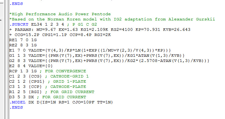

Pillo69: Micro-Cap is a really nice piece of freeware, but people in DIYA have been using LTspice for a long time, so I suggest you start with that, for its better support, i.e. Mooly's tutorial.

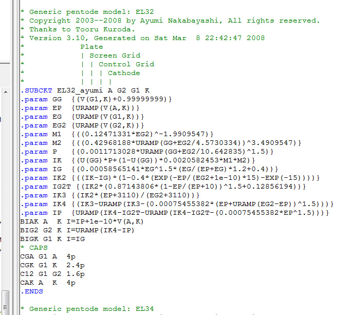

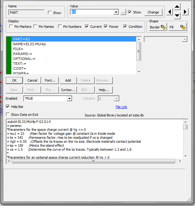

I understand that the EL33 data cannot be used for MC. As I have shown in the previous images. Thanks for your attention.
Hi Pillo69
To be honest, I have never used something else than LTspice, so I'm not familiar with MC or any other spice tool.
But in general, I was said that it mostly turns around different notations how to set an exponent, and how to write very big/small numbers.
In our pics, I can see that MC understands at least "^", "pwr()" and "pwrs()", while I used "pow()" and "**" for exponents in my model. For proper translation, one must be aware that all this notations may handle negative values in different ways (consult the integrated help menues or online user guides)
According to your pics, MC seems to understand also number-notations like 1p5 (instead of 1.5E-12) so that seems not to be a problem.
all the best, Adrian

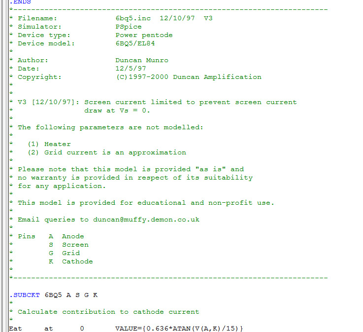

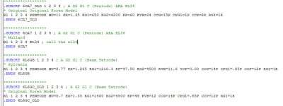

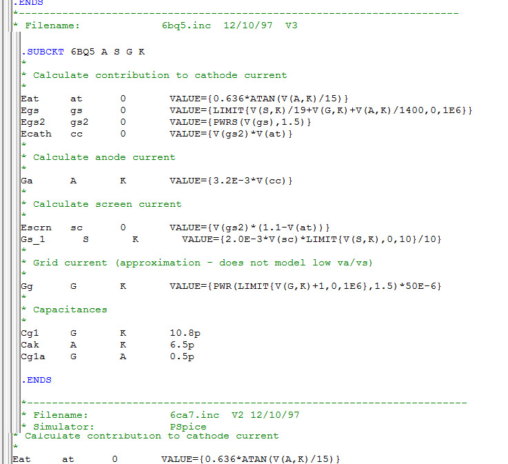

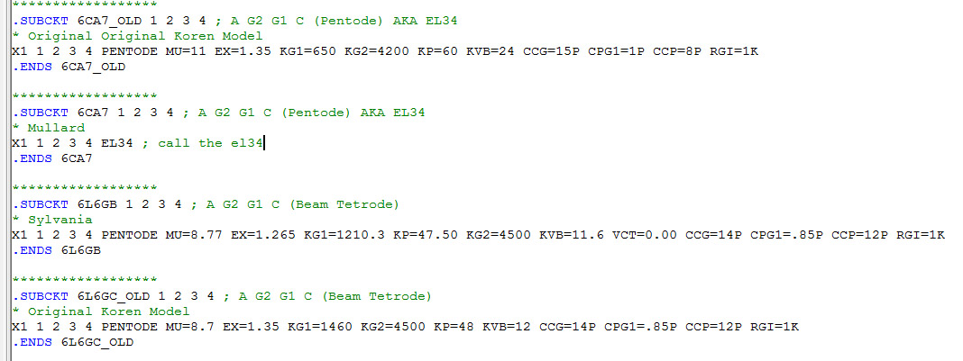

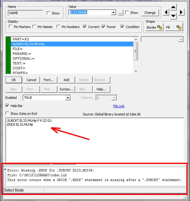

Hi Adrian.
Here's the error I get when trying to run your 6L6GC_i3f model in Micro-Cap 12.
Error: Duplicate definition for ( RAD*XS*IAD**.
I changed ".params" to + params:" in your model as Micro-Cap sees that as an unknown command.
Error: Unknown command.
Text: .PARAMS
I believe the problem lies in the syntax. Below is the "very" slightly modified model of yours that I'm using in MC12, which BTW runs fine in LTspice.

Hello I have made the modifications that you indicate for MC12, of the EL33 tube. The tube response is as in the image. Issues the error in the box below. In Adrian Immler's original file "only" ends in ".end", I have included the expression as in ".subckt" but it still doesn't work. What can be the error? Thank you.
Hi Pillo69,
Perhaps MC has a problem with the point in the spice model name, as points are used to introduce a command. Why not do a trial without the point in the spice model name?
