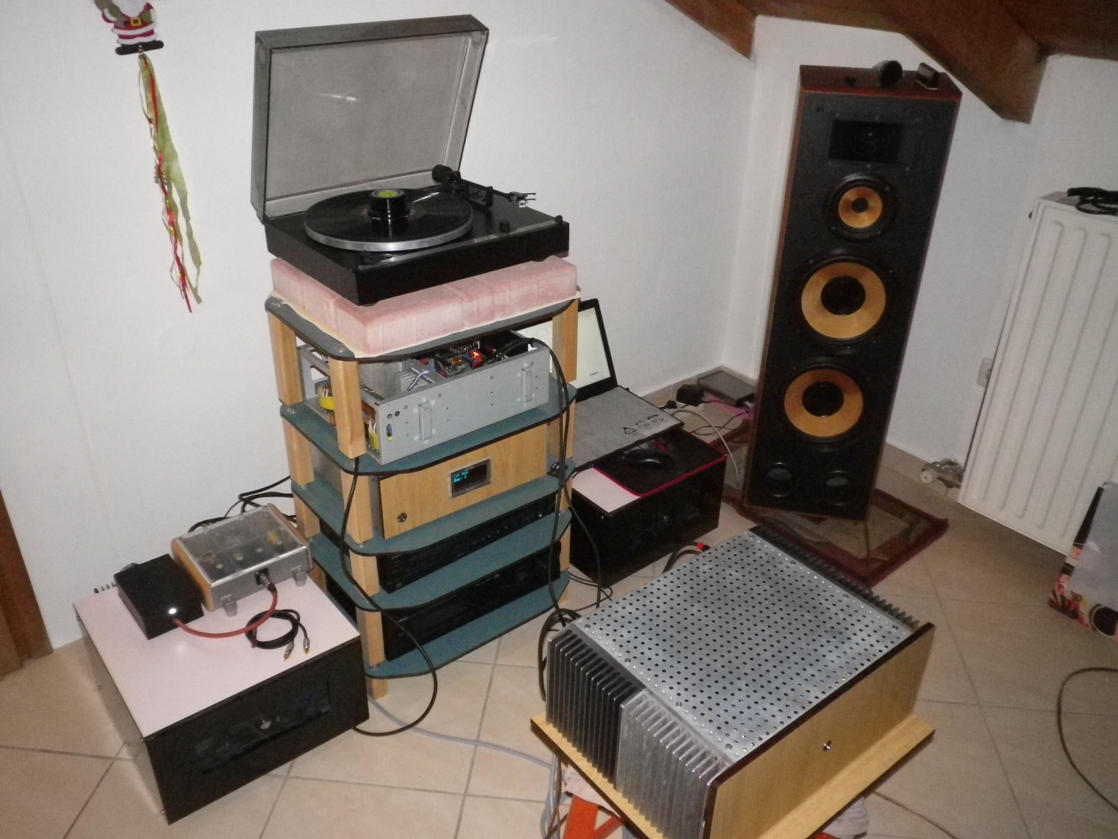

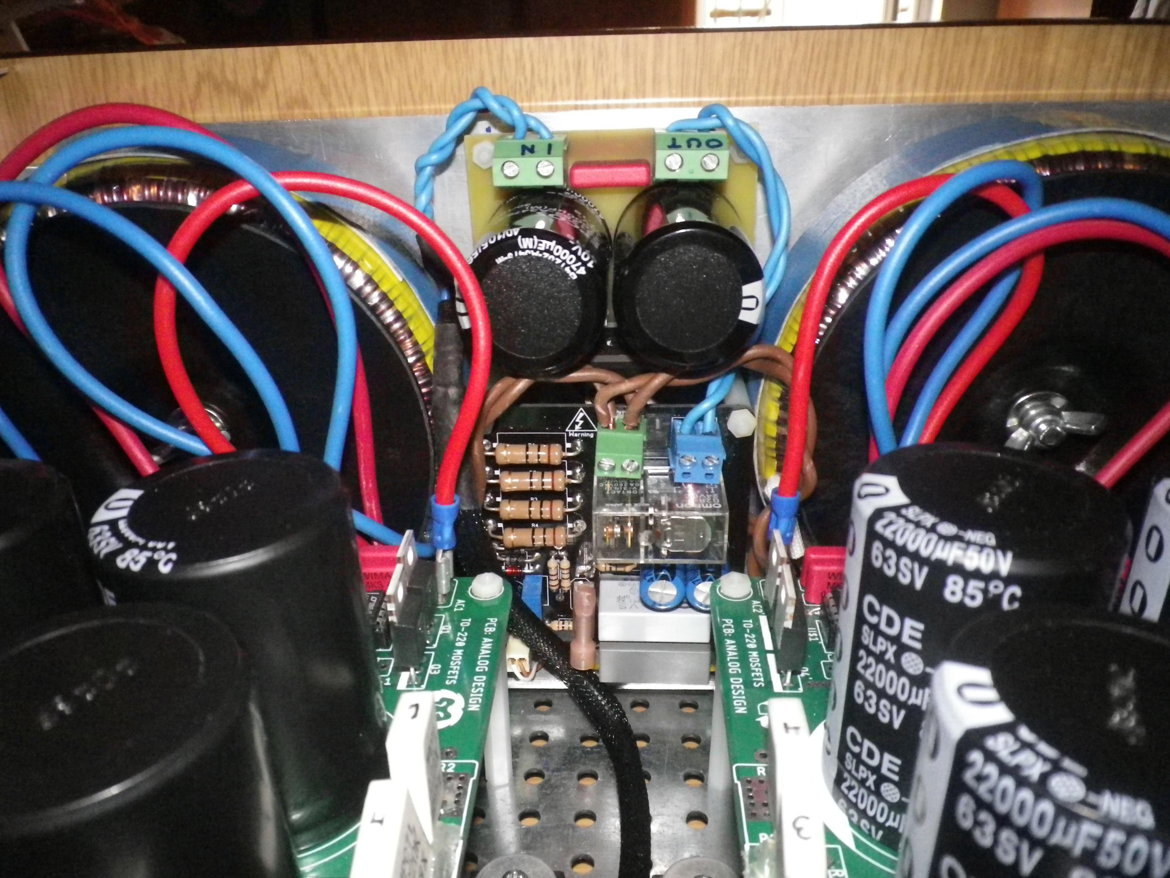

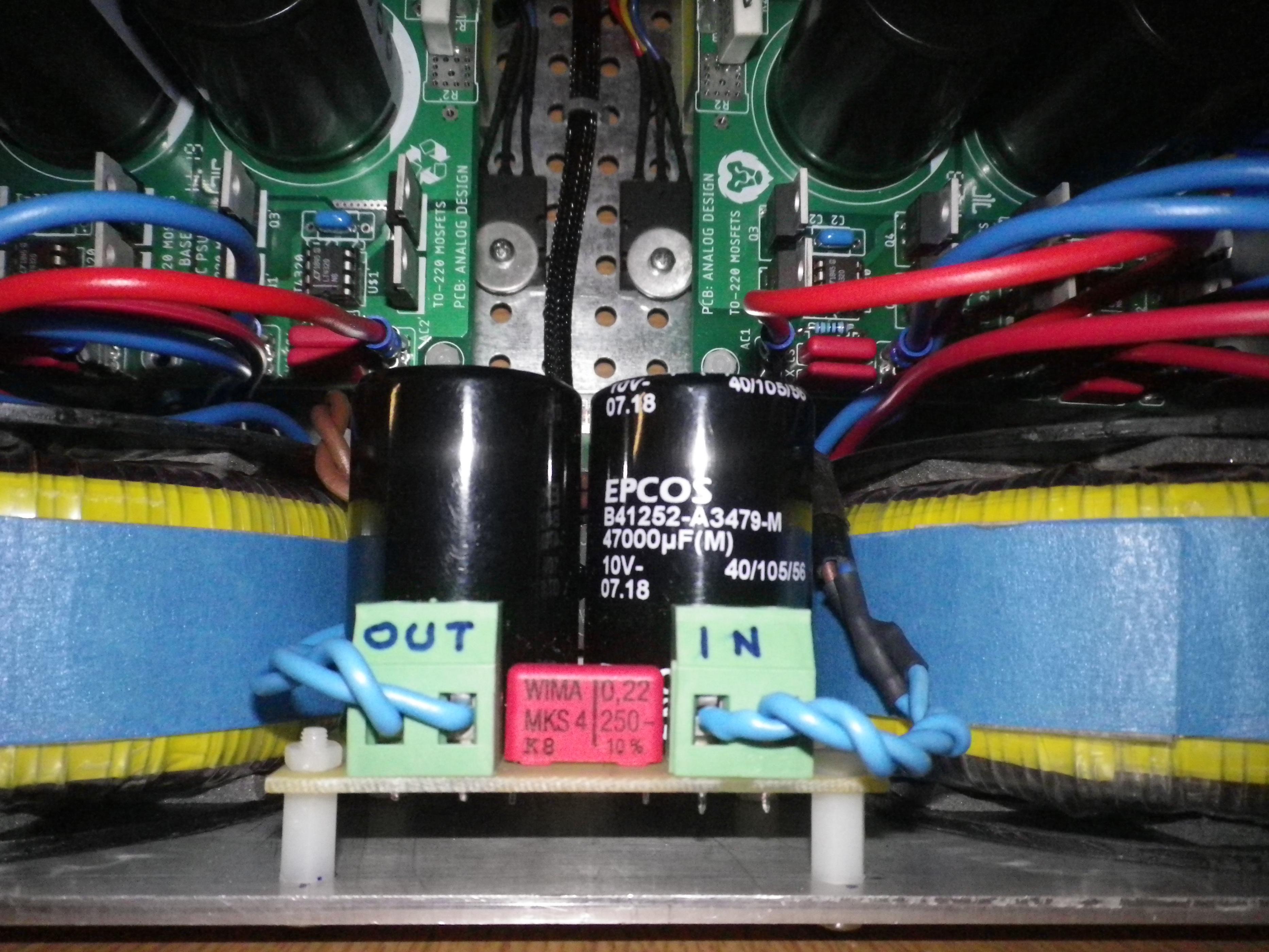

These days I placed at the entrance of the transformers the small board dc trap now quiet forever, velvety sound accompanied by the DCG3 preamplifier.

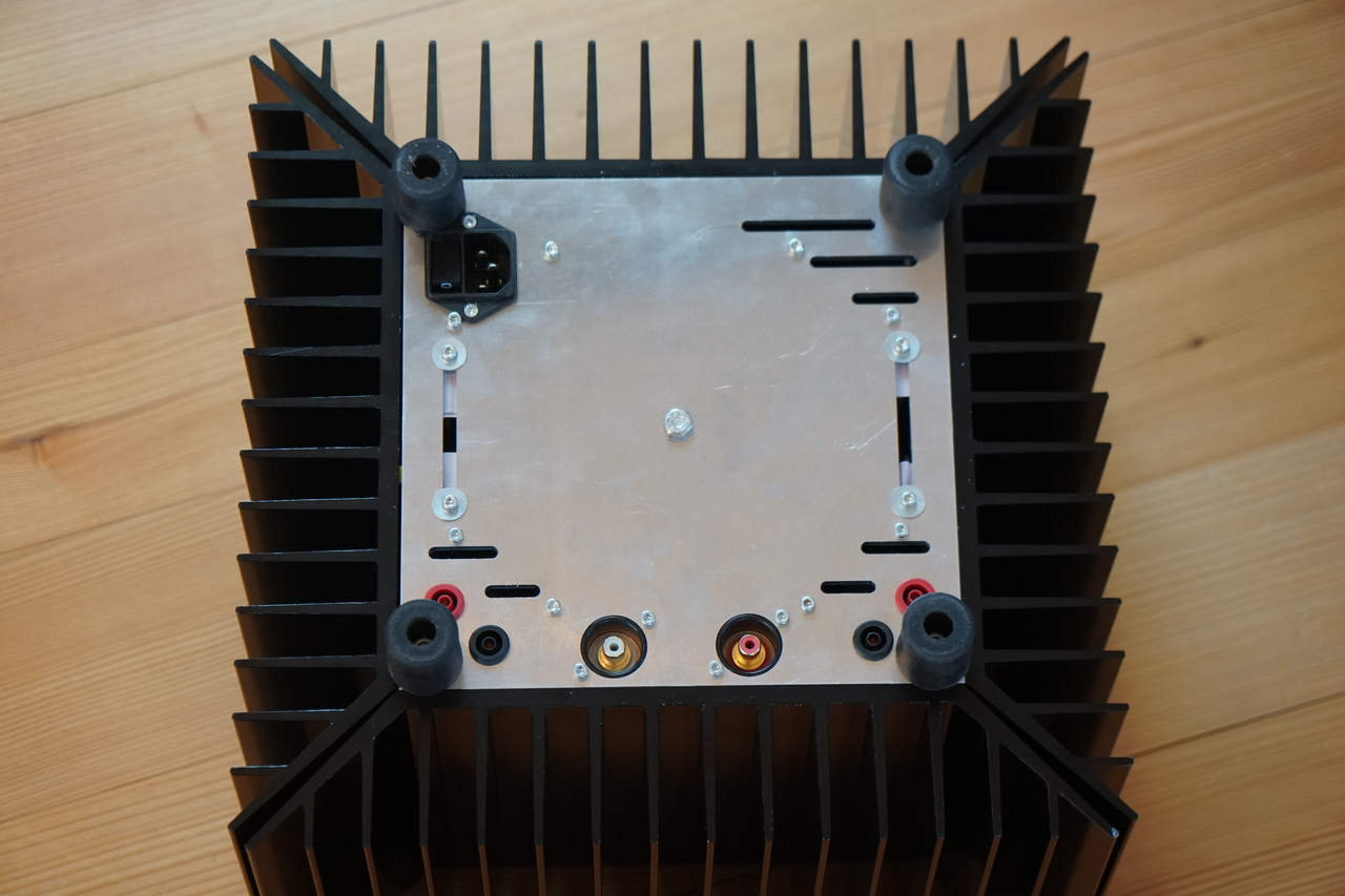

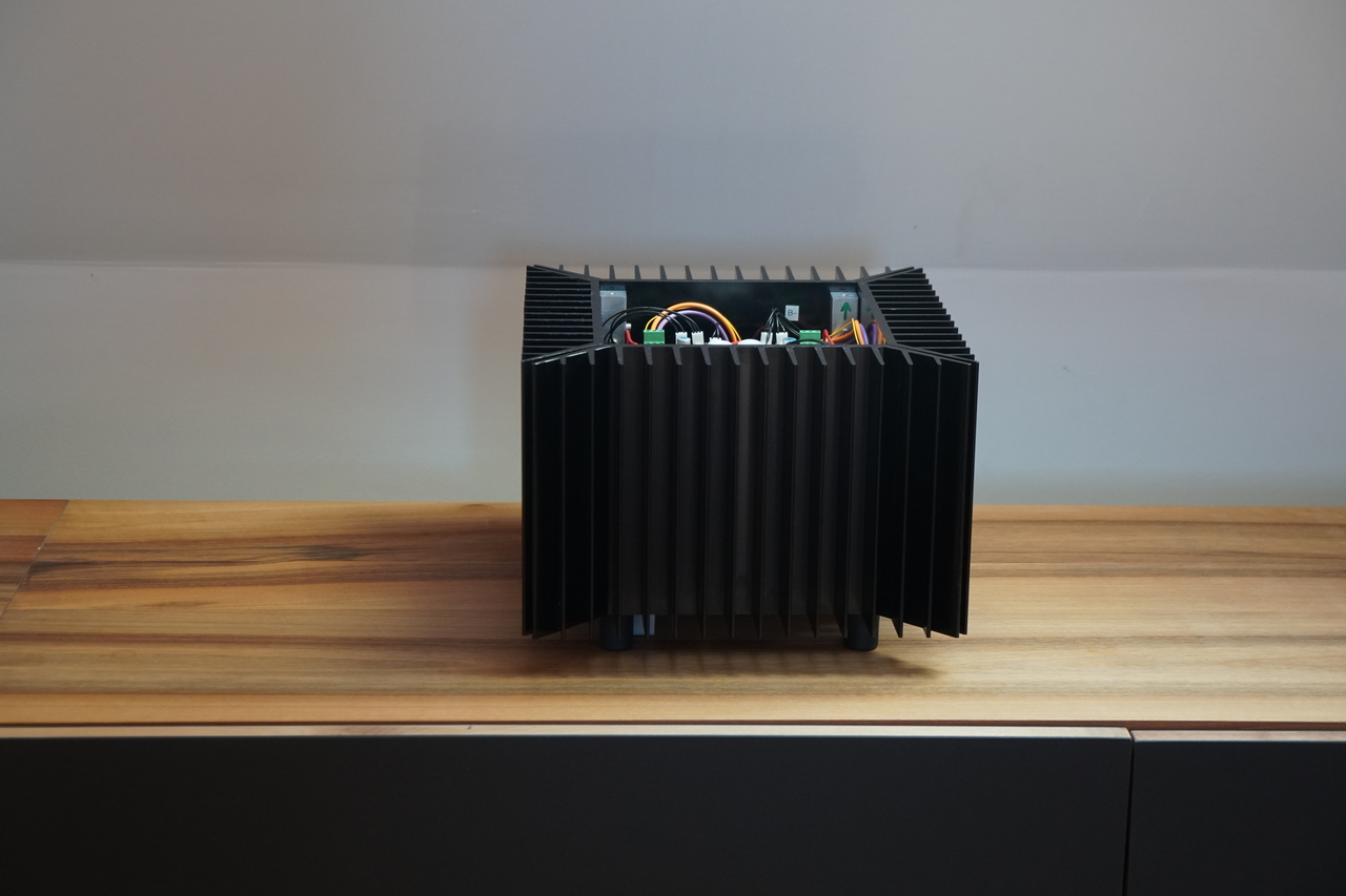

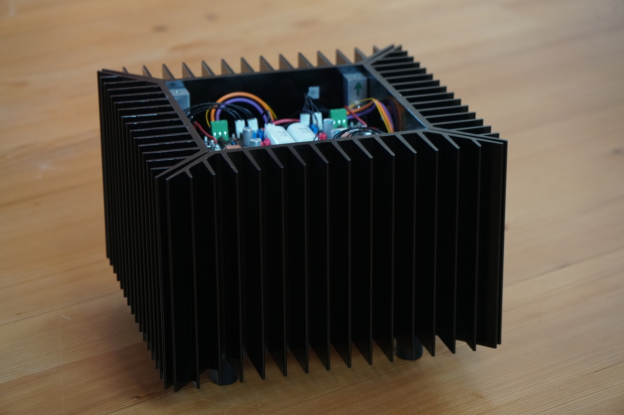

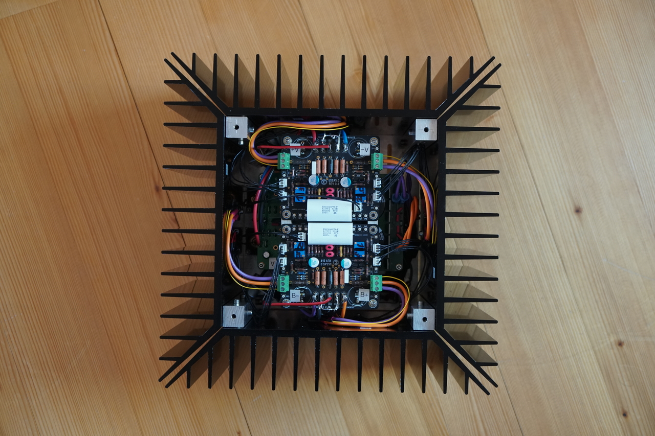

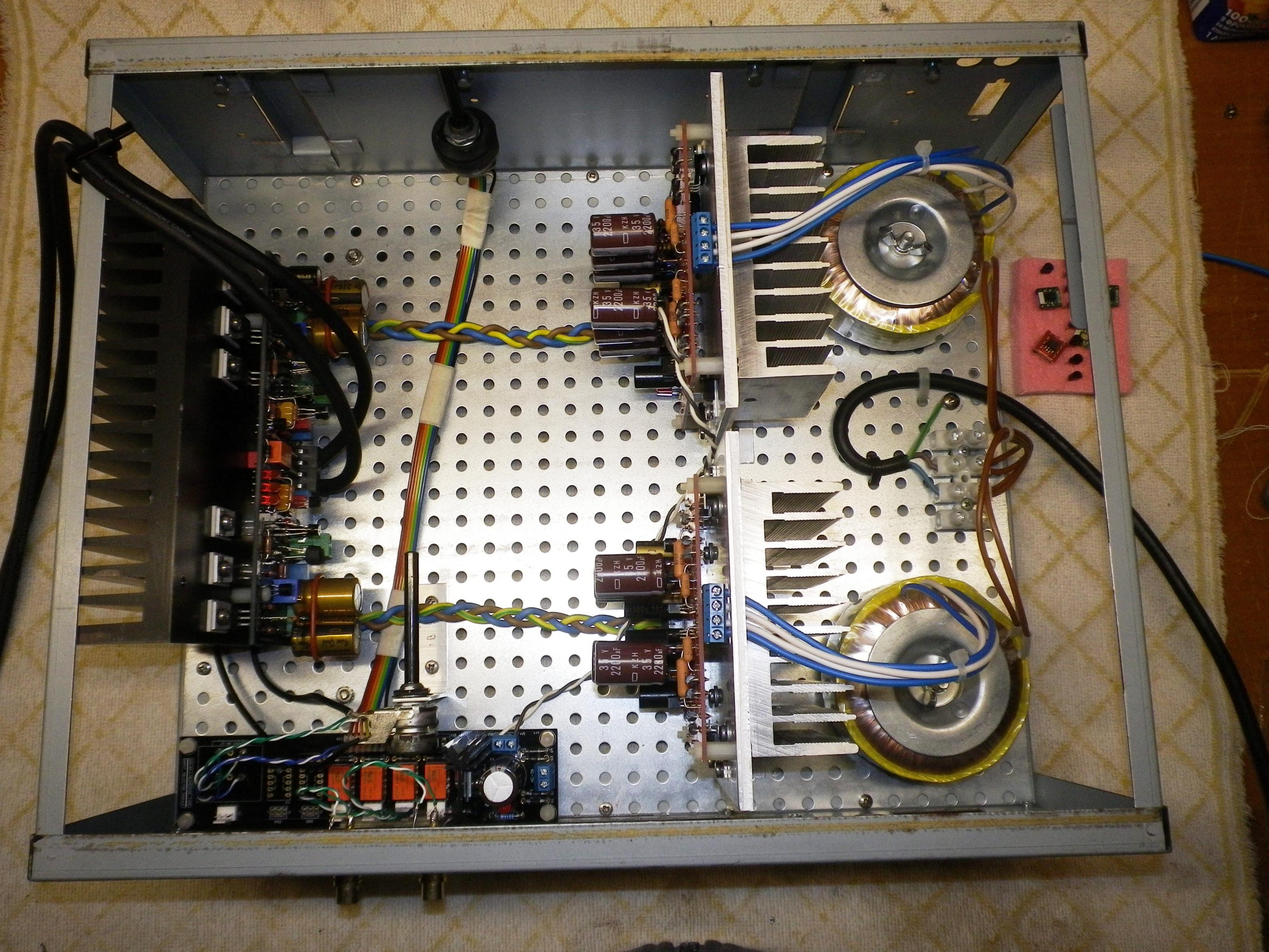

Here are some better photos of my build. The amp is still running topless, just because I think it's cool. I'll put on the top lid when the cat becomes too curious.
This is a very nice looking amplifier Mbrennwa. 🙂
Thanks for posting.
At the end what is the bias current you are able to manage with this small size class A amplifier but with efficient heatsinks use ( 4 sides instead of usually only 2 ) ?
Fab
I was running it the USSA at +/- 25.5 VDC with 1.5 A for a while, and it was pretty hot. My Aleph uses the same chassis at +/- 23 VDC with 1.8 A, and its borderline hot.

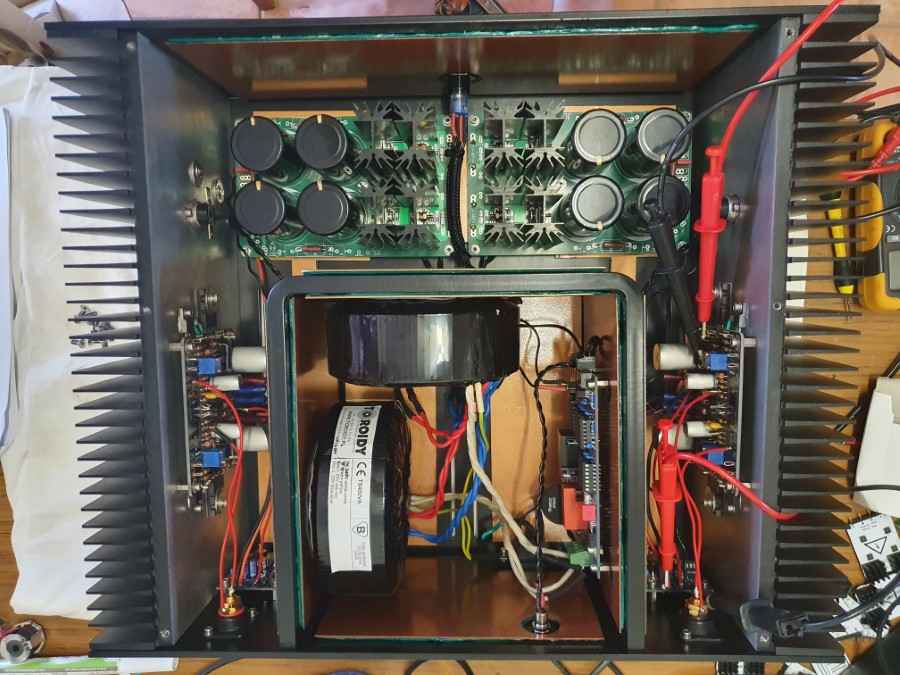

It's been a while, late 2018, but I am back to getting this amp finalised. Before I got busy I had just calculated and installed RV1a and RV2a and stuffed things in a box I had built. Not even enough time to adjust the bias or DC offset...which is where I got to last night some two years later.
Right channel was easy to set at 65mA across R15 with DC offset virtually zero. All good it seems.
Left channel I can set 65mA but the DC offset is about 8V (yes volts) and winding the trimpot from one extreme to the other changes this insignificantly if at all. Frustrating! Is this something you are able to easily diagnose? My familiarity with the build has left me over the past two years and I am trying to avoid a lengthy investigation or going back to the start.

Hi acg
For the channel with issue,You can redo all measurements from the manual again. Here is an extract:

Hi acg
For the channel with issue,You can redo all measurements from the manual again. Here is an extract ( I have removed a redundant part).
If you have 65mv across R15 then you cannot have also 65mv across R16 if you have such extreme DC at output.🙁
Have you checked for shorted D2 and D4?

Thanks Fab.
So I have started debugging.
(1) Both bipolar PS's have about the same voltages on their rails. Good.
(2) Both R15 and R16 have the same voltage drop across them even with 8Vdc on the ouputs. Mmmm, that's not right. Previously I had been measuring just the one resistor, but both go up and down in tandem as the amp warms up.
(3) The problem channel has 21V at the speaker protection circuit. The good channel has 8V. As you suggest it might be time to make sure the speaker protection is not causing the problem. I shall investigate further.
