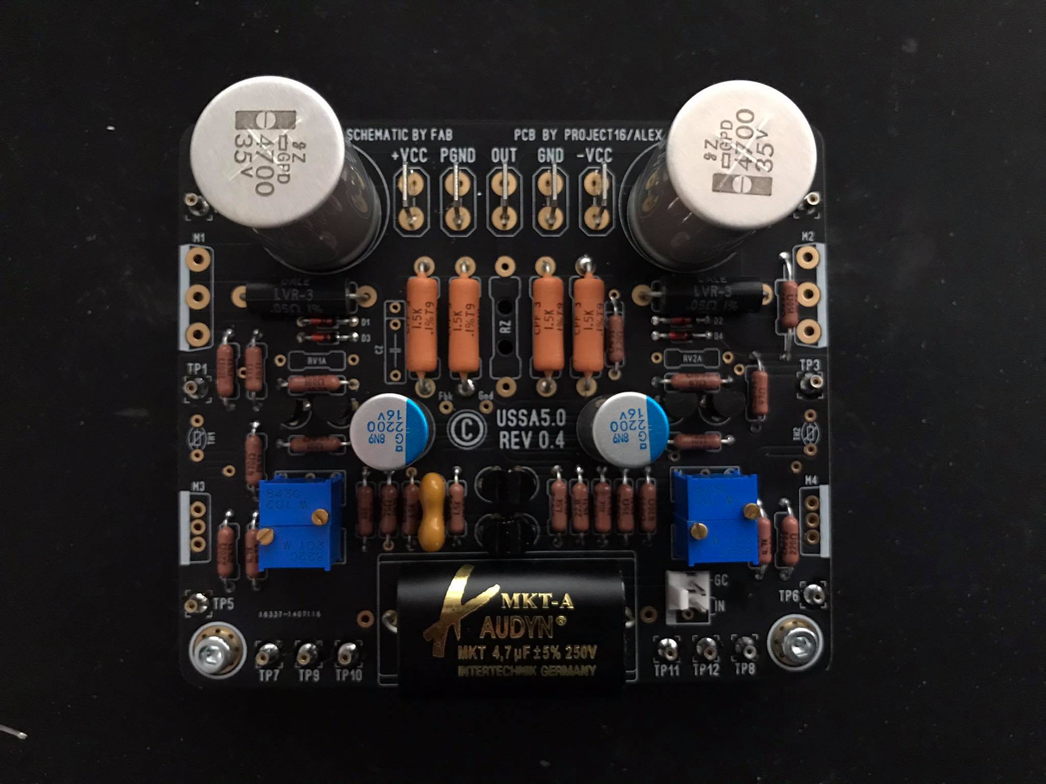

Hi Amadeus
Good progress. So at this stage of the build have you tested the input stage?
I cannot see clearly the input transistors if they are touching together. There is a small advantage to have the input transistors to be thermally coupled for enhanced temperature control (DC offset, etc...). Take a look at other builds on the thread. This was a small improvement of the new pcb layout compared to the version 1 of the pcb.
Fab
Fab
Yes, I was able to adjust current in input stage, so far everything seems to be ok. I am using your manual step by step. I will try to couple input transistors, but they are already soldered and there is like 0,5mm gap between them.
Just put some heat shrink over the transistors.
PCB ready to be mount on heat sinks.
Very nice work!

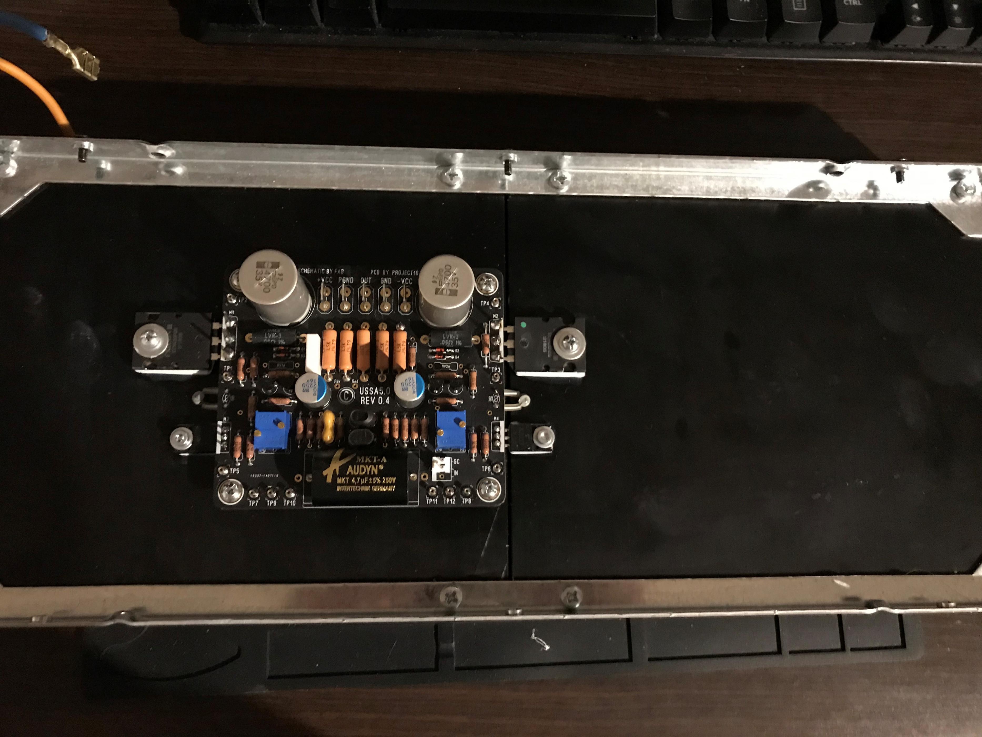

Front end testing Mk.II.
Hi FAB,
Thanks for reply. After I posted my issue yesterday, I decided to continue. I connected two VU meters to TP6 and V- and TP5 and V+ at the same time. By adjusting P1 and P2, I was able to get 300mV on both measured points. However, I needed to find balance because increasing/ decreasing of voltage was not linear or same for P1 and P2. Was also able to get 50 mV between TP4 and V- and TP2 and V+. After that, I measured OFFSET on output and it was 90mV, so I adjusted it to 0, however after 15 minutes it was 2,7mV and growing continuously (heatsinks were quite warm as well). There is one question: should I wait until heatsink reach stable temperature and then adjust offset or just adjust it immediately? Then I checked voltage between TP4 and V- and TP2 and V again, was same for both measured points at level of 48,7mV. VGSN was 0,914V and VGSP 1,509V. Back to your initial question, I was able to reach point 8.17. I checked diodes (types and polarity-should be OK). Just writing what I did in order to get approval or maybe some guidance. After you can confirm my results, I can do the math for Rv1a and Rv2a and then try to do another adjustment. Nevertheless, I will continue tomorrow since I am at work whole day today.
PS: You can see my PCB installation on heatsink. Not sure if this disproportionality of transistors layout might affect thermal characteristics and have some impact on overall results. I was considering also transformer and PSU position in my chassis, which is why I decided to install it that way.
One more thing. I was using my original PSU for all adjustment steps, only for 8.17 as intended in your manual. Not sure if it is good or bad …
Hi FAB,
