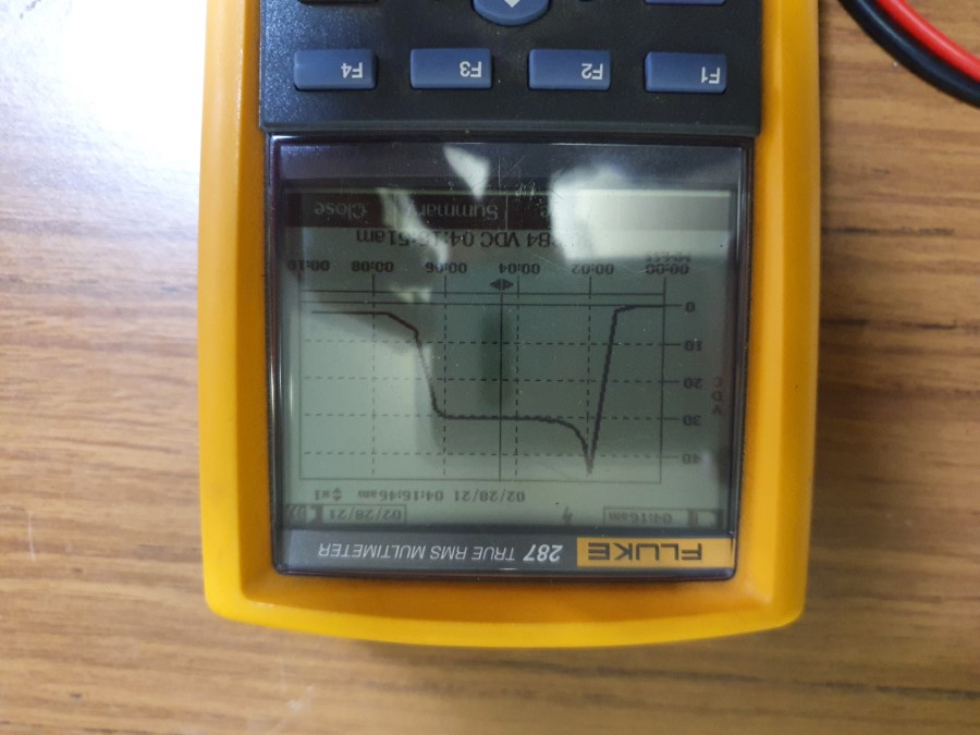

Hi Fab,
Following on from earlier, I have released some magic smoke, but only from the speaker protection on one side..no amplifier modules were injured.
Diagnosing the problem has led me to identify a voltage spike at startup that occurs only when the power supply caps are empty or very nearly empty. If there is a small amount of energy left in these caps the voltage spike does not occur. Please see the attachment. This voltage spike does not happen on the surviving channel under any circumstances so far.
The speaker protection circuit did not like this kind of supply voltage and eventually decided that a capacitor needed to be distributed across as many nearby components as possible...who know so much 'stuff' fitted inside such a tiny can?
Are you able to think of a cause for the startup voltage spike on this one side? The power supplies are very simple and both seem to be outputting the very similar voltages apart from those moments from a cold start. I am thinking there may be something on the amplifier module that is causing this to happen, but my knowledge how of the circuit work is not good.

Hi Anthony
Not sure I fully understand your second paragraph and the curve you have provided....
Normally the big PSU caps are meant to be fully discharged after a while with the discharge resistor. There is nothing on the amplifier board that can cause what you describe. However, the only thing that I can think of is maybe if one (or both) 4700uf electrolytic cap has been damaged while you had problem previously with your speaker protection... as a test you can remove both caps from the board since the amplifier would be functional anyway.

Hi Fab,
The curve/photo is the voltage going to the speaker protection board from a cold startup. So starts at zero volts, I turn on the amp, quickly hits 45 volts, falls back to 31 volts. Then I let it run for a short while and turn it off so the voltage falls back to zero.
The good channel just rises to 31V with no overshoot. Power supply is 400VA twin 20V secondaries and a simple CRC filter.
I'll check the 4700uf caps now.

Do you run the speaker protection boards from secondary supply or from the main amplifier PSU?
I would suspect more the speaker protection board than the amplifier pcb...
Do not connect speaker, remove the speaker protection and observe the PSU voltage.
