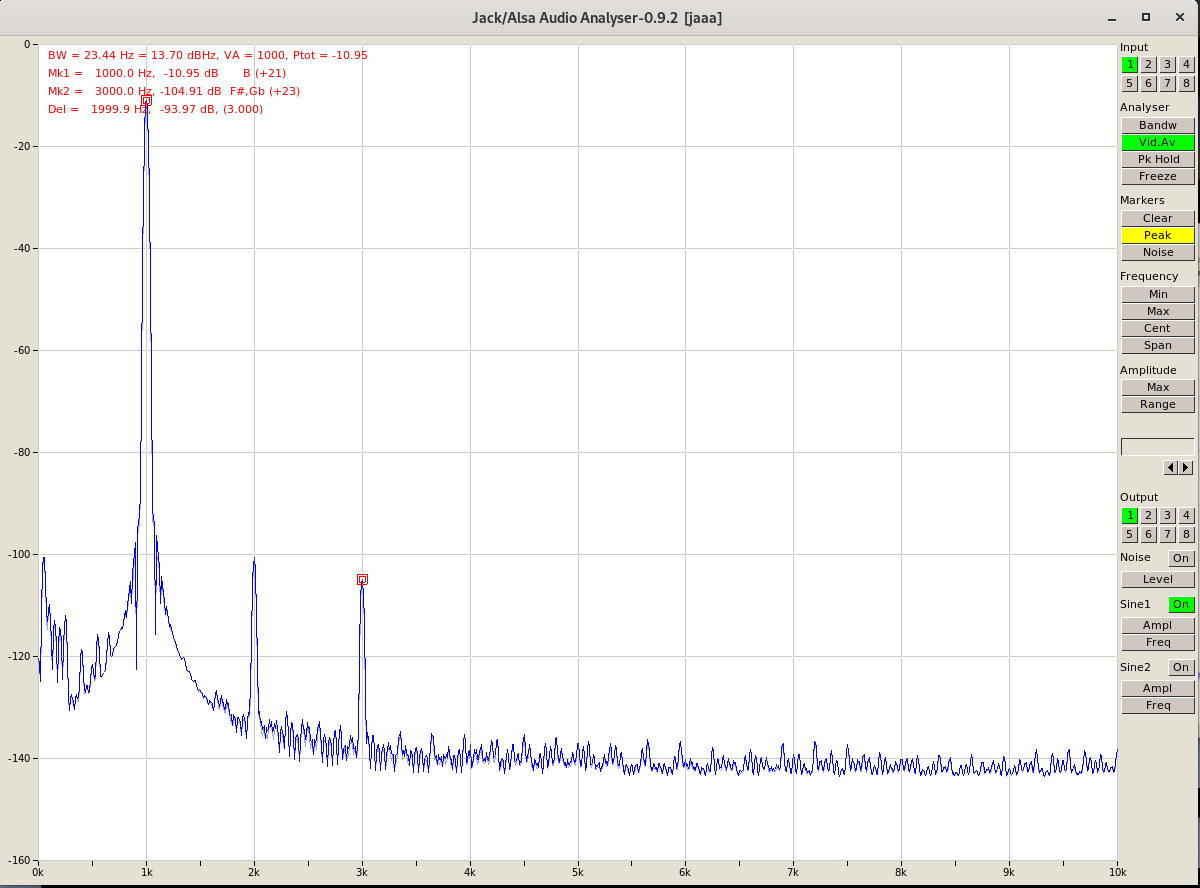

Just a quick update (and note to myself): if I bias the output at 1 A and set P3 and P4 for 28.0 mV (standard values in Fabs build guide), I get pretty much the same profile of harmonics as that shown by Fab (1 W into 8 Ohm). Upping the output bias current requires some imbalance in the P3 and P4 settings to maintain the harmonics profile. For 1.3 A output bias, I found that P3 = 30 mV and P4 = 28 mV gives the profile in the attachment, which is very similar to the 1 A / 28 mV / 28 mV profile, but with slightly lower 3rd harmonic and more output current headroom.
Running at 1.5 A also works out ok. Heat is fine in my workshop, where I have no heating (about 12 °C ambient right now). However, under the normal living-room conditions in my listening room, the amp gets a bit too hot for the cat.
Oh, and I believe I figured out in which camp I am when it comes to H2 vs H3... but the difference is subtle compared to the other goodies you get from the USSA5 sound.

This is excellent work Mbrennwa!🙂
Glad you seem to like it 🙂🙂 You can also report back once you have more break-in done.
Also, a picture of the completed assembly in your good looking chassis could be fun to see.
As for your camp for H2 and H3 it would interesting to get your personal preference...
H3 level reduction with higher bias current is quite normal for a class A design.
Section 19.1.3.1 of the manual gives insights about the effect of different input currents for positive and negative part of circuit. This info was brought up mainly for USSA-5.1 where the use of bjt for driver tends to reduce dissimilarity between positive and negative waveforms thus reducing H2. Since there is some reports of correlation between sound preferences based on H2/H3 ratio I just wanted to give the opportunity to play with it. But as Ggetzoff and yourself indicate this ratio does not provide a night and day difference but subtle one at these levels. What is more important for me is the very low levels of higher harmonics compared to H2 and H3. Personally I believe that the sound character of the amp is not mainly determined by this H2/H3 ratio unless H2 is unusually set very high which can obviously also provide a more prominent coloured sound 😉
The manual says this: "The total of the two current values should remain the same (28+28 = 56mV or 27+29 = 56mV or 29+27=56mV)."
Why is this? I guess the idea might be to keep the "total bias" of the driver / output stage as it is, but I am not sure if there's something else I am missing.
I just played with different P3 and P4 values and then re-adjusted P1 and P2 to get the desired output-stage bias and to zero the DC offset.

Hi Mbrennwa
I could have indicated about the same value (56mv) to get the same overall results. This is the input stage current that is adjusted with P3/P4. Higher input current means lower load resistor value (to keep same bias) but then lower input stage gain, thus lower open loop gain thus lower damping factor....
Lower input current means higher damping factor.....There are many combinations that can be done but please start with the original settings of the manual to get the feel of it so you will get the same amplifier as the other builders...😉

What is the final bias used and level of H2 over H3 at 1Wrms that you set it to?
