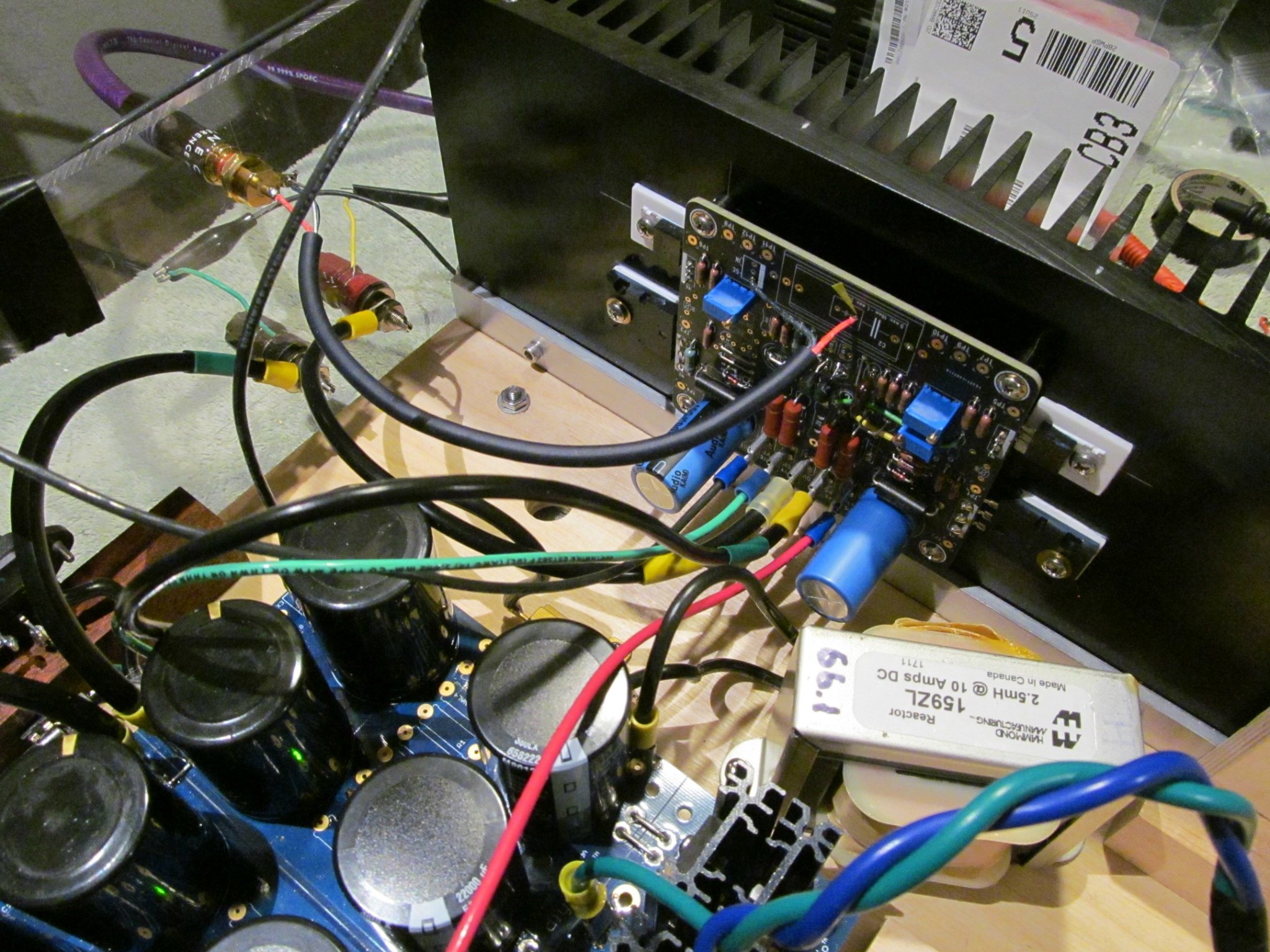

I just got the thermal pads in place for the USSA 3.2 . With +/- 23 Vdc voltage rails , biased at 1.2 Amps
the heat sink gets uncomfortable to hold . So for your case design , recommend your heat sinks are raised up about 10 mm
so that there adequate ventilation underneath them .
Also , as Anatech pointed out , recommend your case has ventilation holes in the bottom and top so that the case
does not become an easy bake oven inside .
Reactions: Eliad
So here is the USSA 3.2 with AL2O3 thermal pads installed .
Instead of risking resoldering the MOSFET's , the length of the stand offs was increased
by the thickness of the thermal pads .

I asked FAB about the Grounding of the USSA 5.0 boards .
The discussion on this begins on Post 2,011 .
Note there are 2 ground connections required for the USSA 5.0 rev 0.4 board .
Hopefully , I have this correct .
PGND - is the higher current analog ground for the MOSFET's
where as GND is the lower current analog ground for voltage gain section ( small signal transistors ) .

On a Preamp or Amp , the analog Ground Node is a connection point where everything is referenced to the same " 0 Vdc . "
Its often called Star Grounding because the RCA Ground , Speaker Ground , Amp Ground and Power Supply Ground
are all directly connected to that same point .
On FAB's USSA Amps , he recommends that the Analog Ground is physically located on the Ground of the power supply board.
But the RCA Ground goes straight to the USSA Board .
IMO Hydro Earth is quite noisy . So its not recommended that its connected to Analog Ground .
Code requires that a metal case is connected to Hydro Earth as shown in the Rod Elliot article .
Then Analog Ground and Hydro Earth have components connected between them .

for the USSA 5.0 rev 0.4 board , I'm measuring distance of 0.274 " ( 6.95 mm ) between the disconnects .
Female disconnects designed for 10awg to 12awg have a yellow sleeve .
Some yellow sleeves have a diameter of less than 0.274 " ( 6.95 mm ) so they will fit fine .
I just bought a box of 50 from Canadian Tire and the yellow sleeve on these measures 0.330 " ( 8.4 mm )
So these will create a bunch of crowded teeth .
