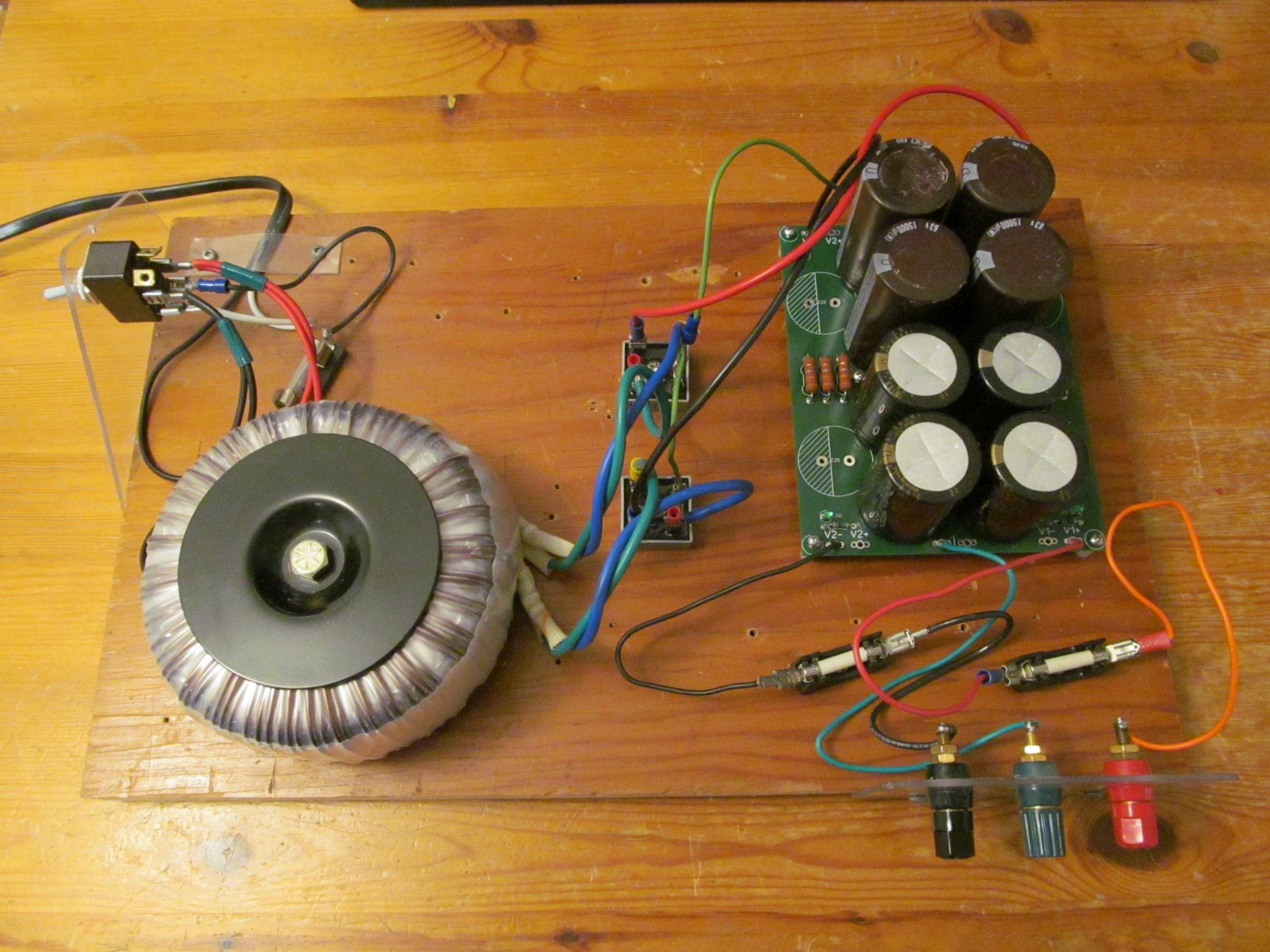

Here is the test power supply I used for 1 channel of the USSA 3.2 Amp, .... and it sounded fabulous .
Transformer AnTek AN-4218 300VA with dual 18 Vac + 18 Vac secondaries
The caps are 4 x 15,000uF and 4 x 10,000uF
2 Amp Slow Blow Fuse on the input , 3 Amp fast blow fuses on the +Ve and -Ve output .
Resistors are 0R11 on the +Ve and -Ve ( 0R33 // 0R33 // 0R33 )
Long story short , go with a dual power supply .
If you try to cut corners with the power supply , it will limit the ability of the USSA amps .

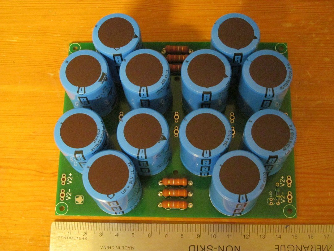

Power supply caps are quite expensive , but consider 2 power supply boards as shown on the right .
With 12 x 10,000uF 50 Vdc caps on each board .
Sit down before seeing the price , but these provide a high performance / cost ratio .
So a Qty 24 of these caps will be needed ( to point out , lead distance of 10mm is standard for caps with snap in leads )

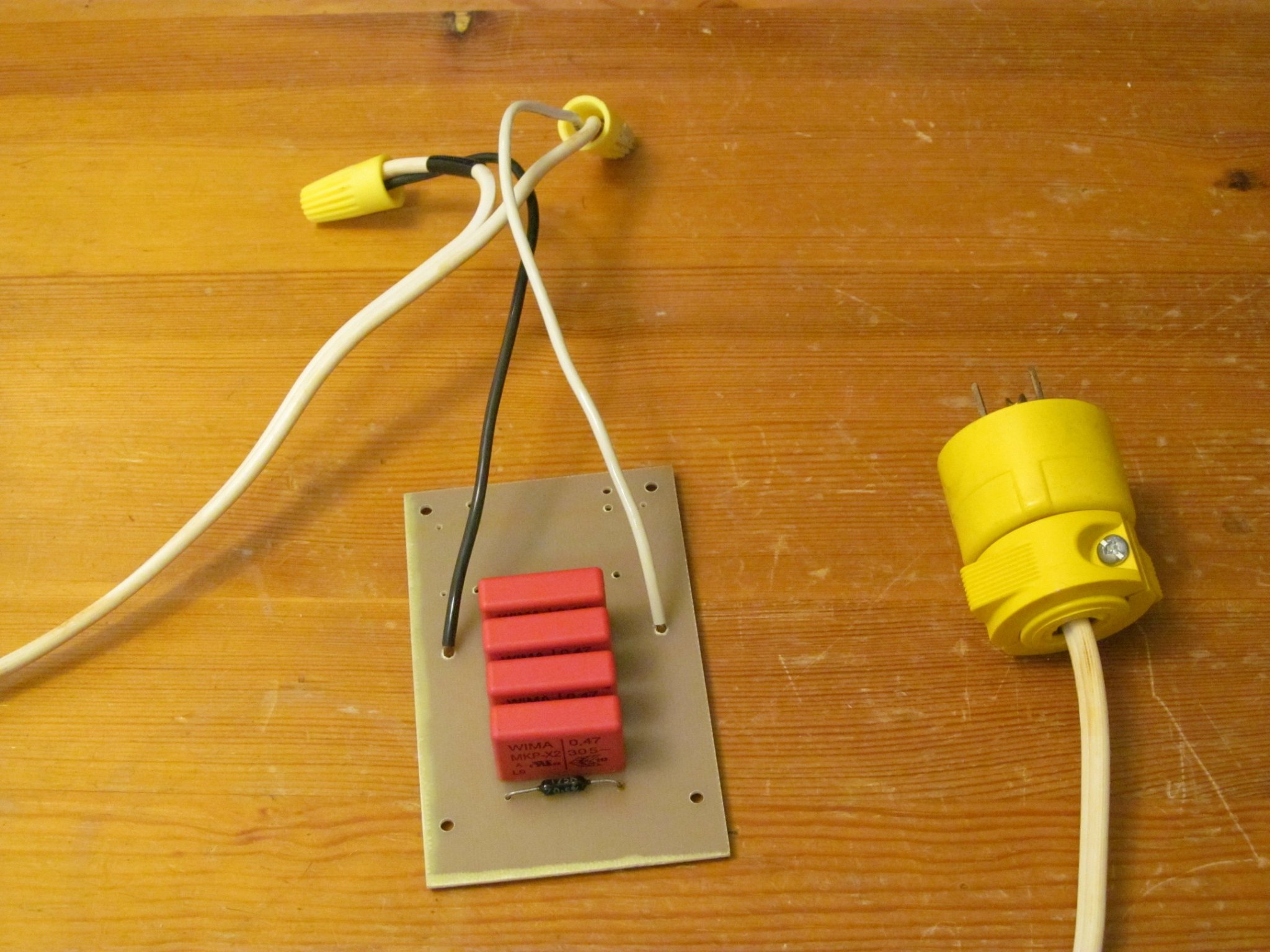

What I highly recommend is building a DIY EMI filter designed for audio
which I connected after the power switch .
When listening to a Mozart Piano Concerto , and using a CRC power supply board ,
when this bank of 4 x 0.47uF class X2 caps is plugged in ,
I can hear a slight reduction in the distortion during the transient response of the piano
and a slight improvement in clarity in the string section .
https://www.wima.de/en/our-product-range/rfi-capacitors/mkp-x2/
The EMI filter also needs a common mode choke - not shown .

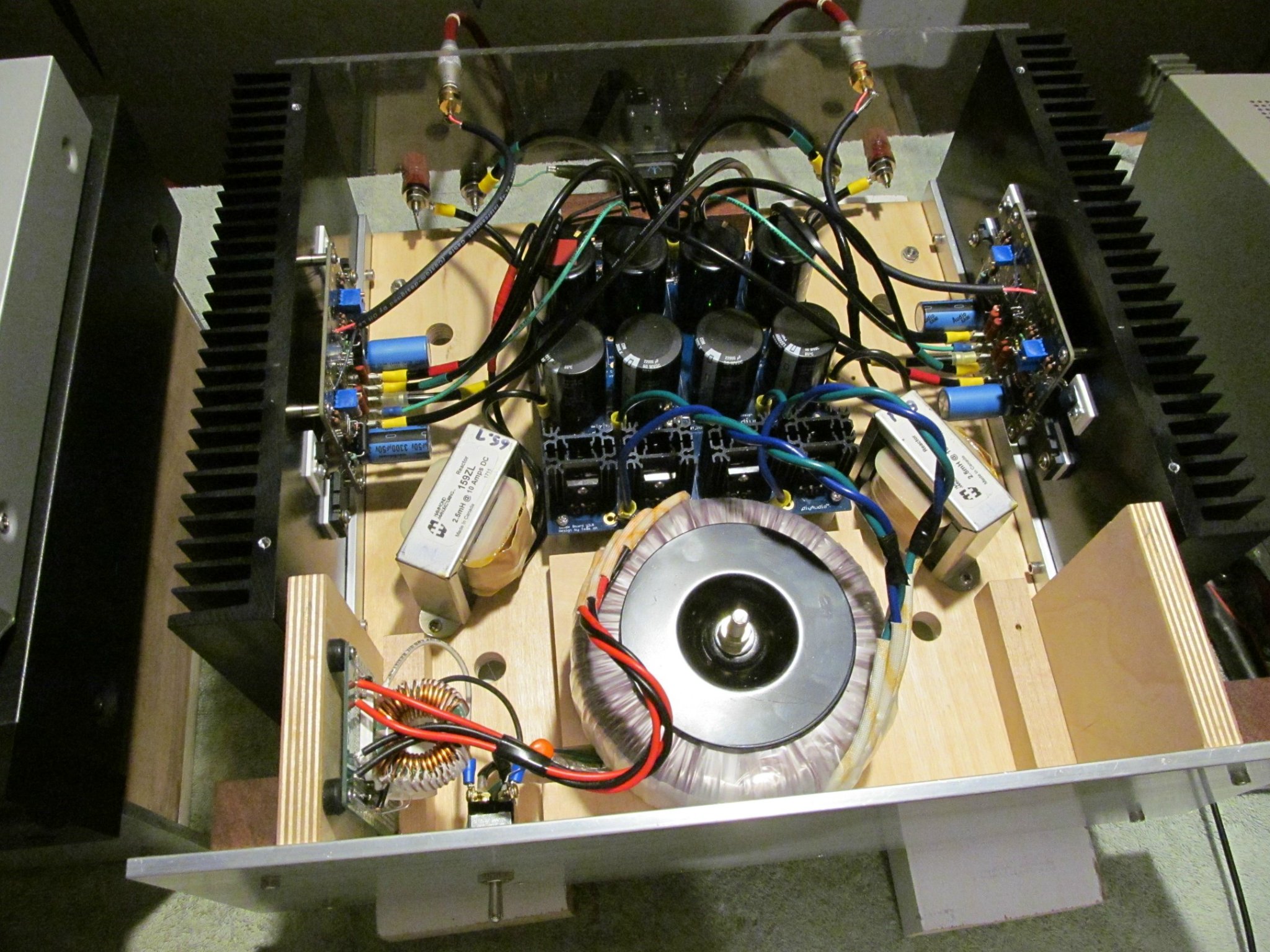

For the mono power supply shown below , with 8 x 22,000uF caps , I tried
1) 2.5 mH chokes + 0R25 dampening resistors . After another 60 hours of break in , one channel sounded great .
But then when both the R and L channels were connected , the sonics were awful .
2 ) So took out the 2.5mH + 0R25 's , and replaced them with 0R1 12 Watt resistors .
After 10 hours of break in , both channels with the CRC power supply sounded great .
So I knew the 8 x 22,000 uF caps could store enough charge and the ESR was low enough .
3 ) Then took out the 0R1 resistors and connected the 2.5mH chokes , without the dampening resistors
and the sonics were slightly more refined than with the 0R1 resistors .
fo = 1 / ( 2 * Pi * sqrt ( L * C2 )) , so with a 2.5mH choke and C2 = 2 x 22,000uF
that works out to be 15.2 Hz .
fo is so low , in my opinion , leave the dampening resistors out .
The USSA 3.2 sounds so amazing now , I don't even want to tinker with the power supply any more .
I'm going to cut a piece of polycarbonate for the top and that's it .
