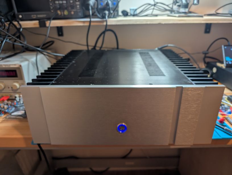

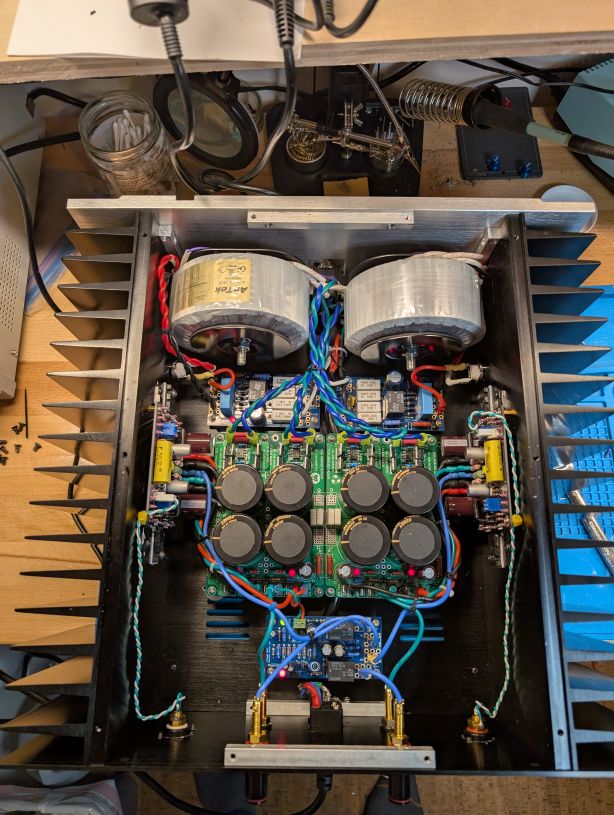

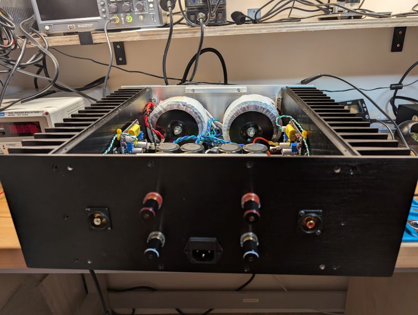

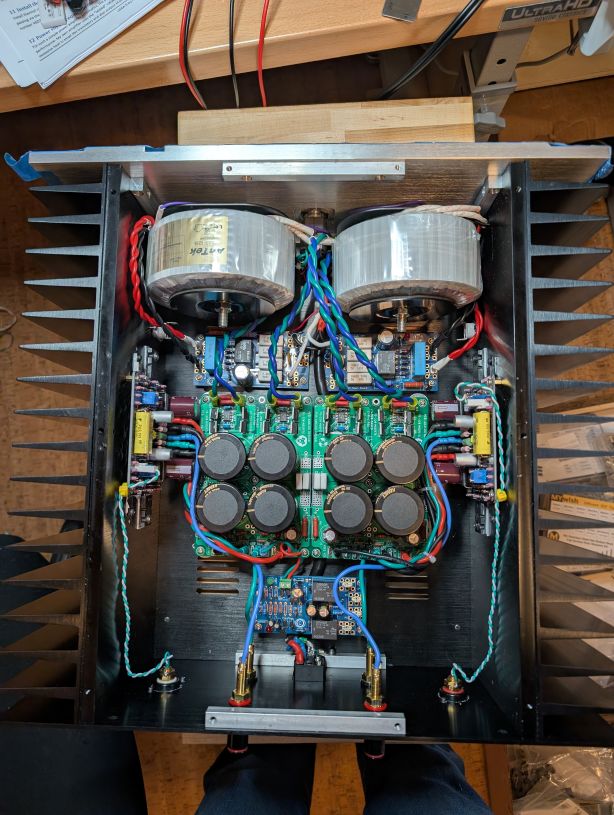

@fab USSA-5 has been continuously running for over 50 hours. Bias is now at 80mV, input voltage is 25Vdc. The temperature at the hottest 53C spot. I think I will leave it at this point. Now I have to do the listening test after few more hours of burn in. I did some spot listening and sounded quite good.
here are the pictures of my final build. I got 300VA 18V AntekInc transformers. Heatsinks are massive and do a great job cooling the output MOSFET.
I got this case from ebay, search for Power Amplifier Chassis Aluminum Class A DIY HiFi Pass A Case W430 H150 D418 mm 4315Pass. You might find the same chassis on aliexpress.
Another option for case would be Tokban 430*150*315/363/415mm All Aluminum Power Amplifier Chassis Enclosure Class A Amplifier Audio Case Shell Accessories, get the 400mm depth. This chassis heatsink are not as massive as the one above.
If anyone wants to know any measurements for either of these two let me know.
