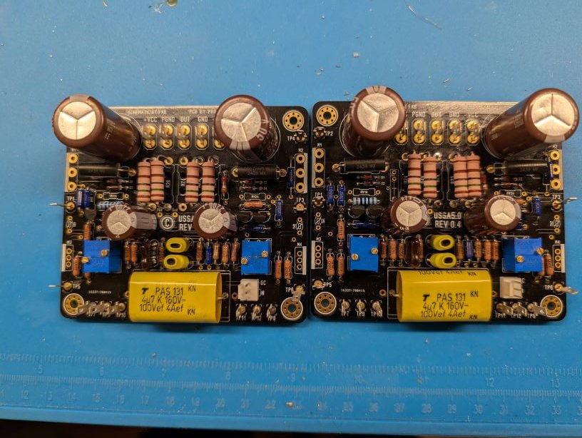

Making progress, today I received the missing parts. I removed some of the components and finished adding all the components as per section 8. I cleaned up the solder joints and make sure there were no cold solder joints. Now I am ready for section 8.7. At this point, do I need to use the final power supply or can I use a bench power supply. I have a good linear dual power supply that I could use. Is there a specific voltage i should set it or is really anything between 15-30Vdc as stated in the manual?

The amplifier is alive and playing beautifully in my make shift huge cabinet. I have now run it for around 2 hrs. Dead silent and I have used a big NTC thermistor as a soft start on the AC mains and no thump at all. With my Audio Nirvana super 8" drivers rated at 96db the amp is 99% dead silent and I can hear a very very slight hiss when I keep my ear close to the drivers. Otherwise I haven't build an amplifier which was so silent and that too with dual mono design. PSU's are borrowed from a friend temporarily which I built using the Prasi's CRC with LT4320 regulators.
Bias is stable 65mV with offset being <1mV even after 1 hr of playback.
How many hours should I run before making a judgement 🙂

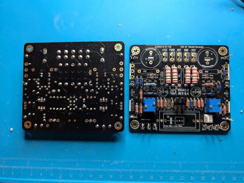

Making progress, until now the testing and adjustments went well, now I am at the point to install the power transistors. I will have to wait for the chassis to arrive in order to go for the next steps. Also, waiting for the PSU PCBs. I will update when I have something to show.

... I am at the point to install the power transistors. I will have to wait for the chassis to arrive in order to go for the next steps. Also, waiting for the PSU PCBs. I will update when I have something to show.
BEFORE soldering on the MOSFET's ,
The board should be mounted on the heat sink , with the MOSFET's in place , on the thermal pads .
Soldering on MOSFET's is the last step .
Mounting the board
For some reason 3 x 0.5 mm machine screws have become a standard - with 50.8 tpi - which I think is too fine .
Consider using 4-40 machine screws instead .
I used 6mm long stand offs
Harwin 4-40 UNC x 6mm R44 - 1000602
But with probably need to use longer stand offs ... depending on the thickness of the thermal pads .
Make sure the board is mounted , centered on the heat sink , with the disconnects at the bottom .
If you gently clamp the heat sink on a drill press , drill the holes , keep it in place , then put the tap in the drill chuck .
Automatically the tap is lined up with the hole . Twist the chuck by hand to tap .
For a cutting fluid , synthetic motor oil seems to work fine .
Bend the leads of the MOSFET's around a form ... such as a drill bit ... maybe a 1/4" drill bit or smaller .
Before Soldering - there should be good surface contact between the MOSFET's , thermal pads and heat sinks .
