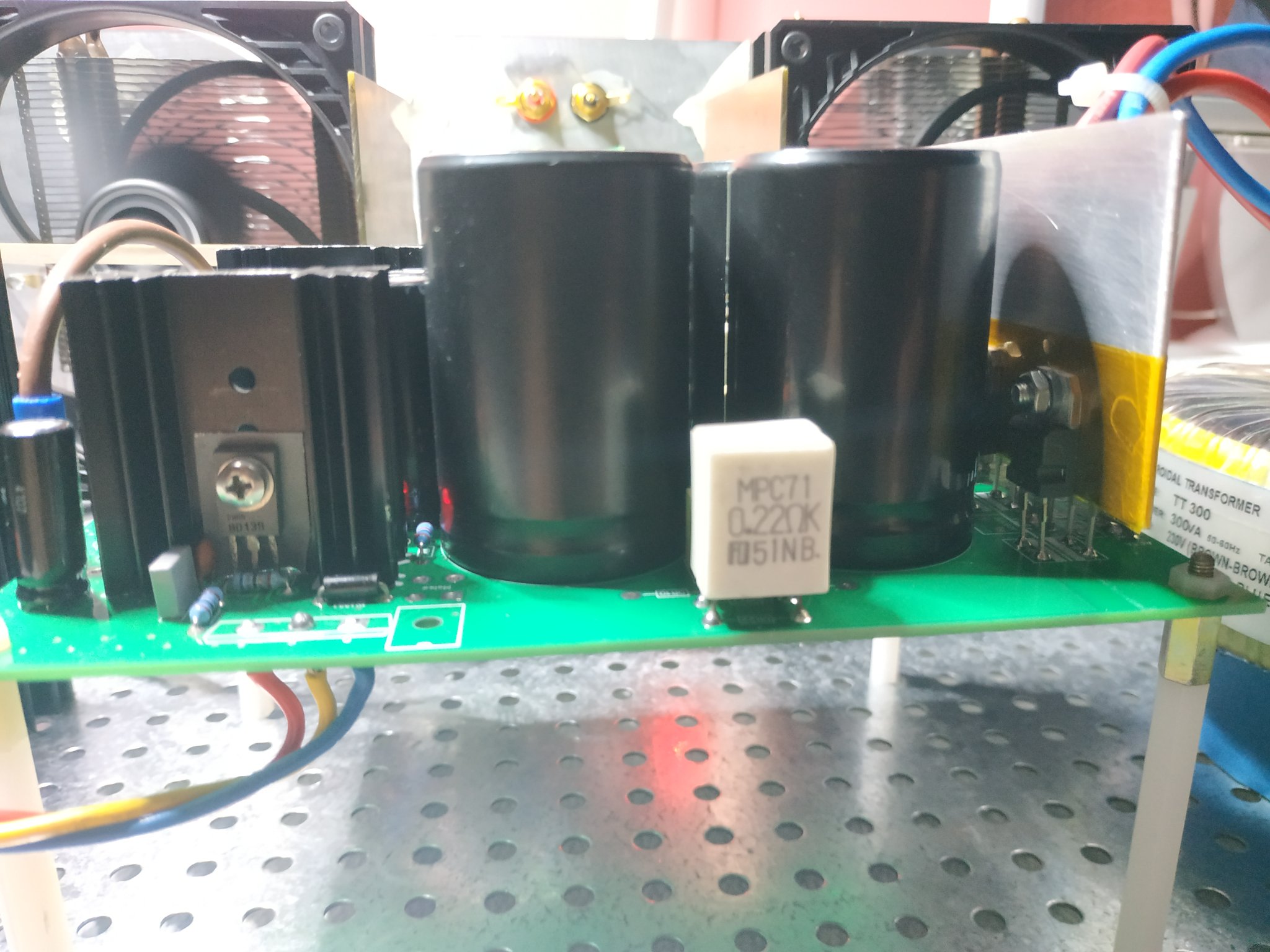

This single rail power supply is an improvement over R21 power supply add-on module. It has an active rectifier, RF filter and super-regulator on a single compact PCB (120 x 70 mm). Performance is comparable to R21, except for the PSRR at high frequency, where this new supply maintains > 60 dB PSRR far into MHz range. It doesn’t have, for now, negative voltage counterpart.
It works, as is without any changes, from 10 to 60 V output voltage for a version without RF filter. Max. output voltage for a version with RF filter is 50V. Output current is up to 10 A (20 A short...

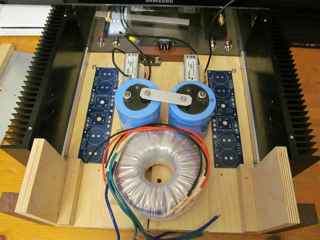

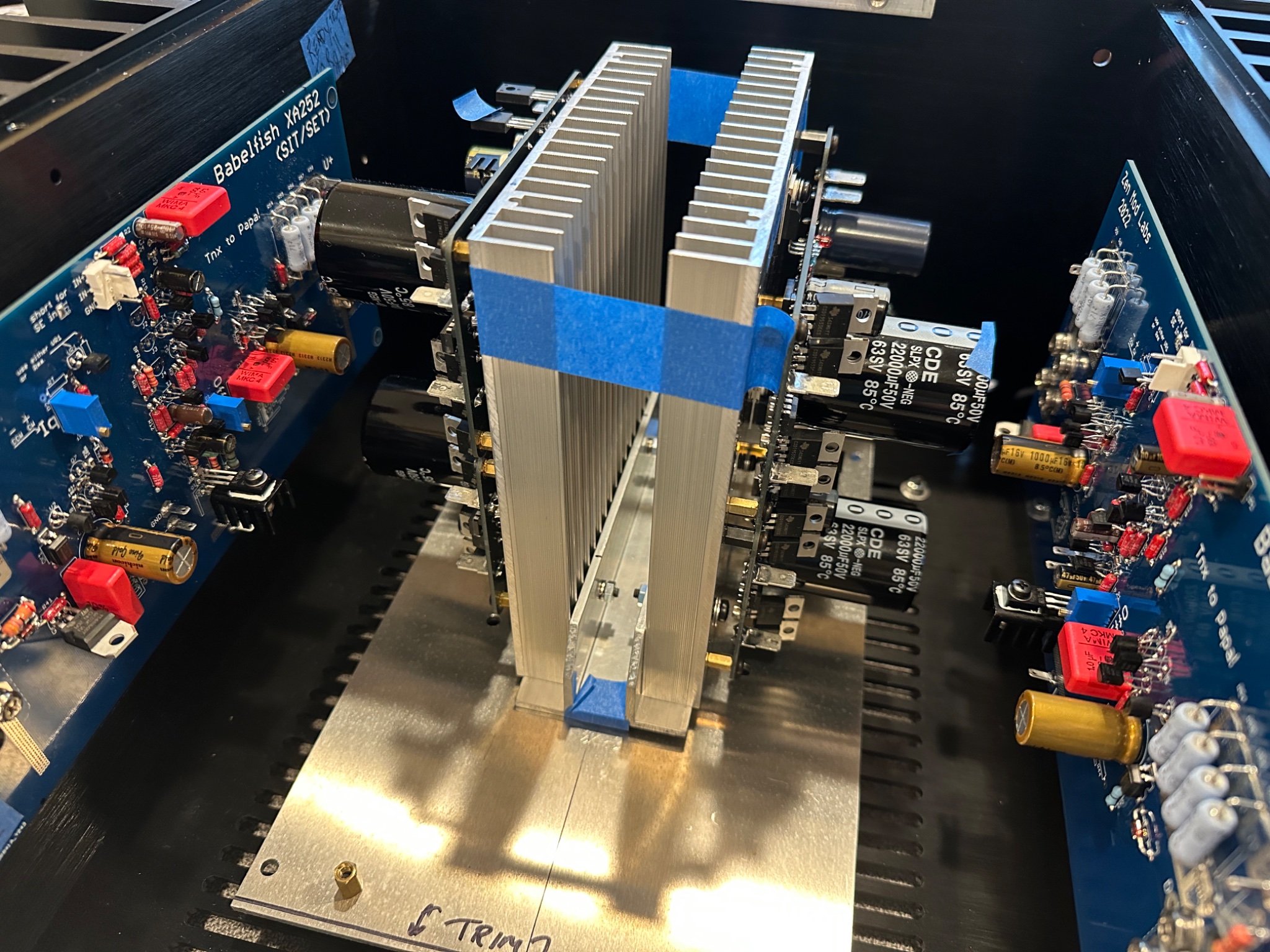

Some examples of the dimensions for the heatsink for each channel:
Of course it can be larger like 4U 400mm.
The fins should be around 40mm long, and the "base plate" (flat part) of the heat sink should be 8-10mm thick. It is important that the fins should be vertically oriented, allowing the hot air to freely move upwards.
I prefer a chassis that is 350mm to 400mm deep, as such a case gives more room to place the power supply boards and transformers.
Btw, you will also have to drill and tap the flat part of the heat sink to screw in the stand-offs that will hold the PCB, and also for the lateral FETs and other parts as shown in ggetzoff's build pic in post #5 of this thread ((attached here also for your reference). Looks like 10 such holes need to drilled and tapped per channel.
With a standard CRC type power supply like one that can be built with the Project16 PSU PCB, power transformers with two (02) secondaries of 18V AC or 20V AC should be sufficient for this amplifier; if you are to go with a dual-mono configuration (one power supply PCB for each channel) a VA rating of 250-300 VA is recommended. So you will need 2 transformers of 250-300VA, 18V Ac or 20V AC voltage.
- 125mm tall x 400mm long (~3U 400mm)
- 165mm tall x 300mm long (~4U 300mm)
- 150mm tall x 350mm long.
Yes, after reading so far it looks the better option is 2 transformers and 2 CRC power supplies. I am thinking using Antek toroidal transformers. From what I read so far an 18VAC probably would be better than the 20V since a lower voltage seems to improve the Class A operation of the USSA-5.0
If you’re located in the USA, Antek is your best option for transformer choices and pricing. Toroidy makes beautiful trafo’s but shipping to US is killer!
I’d recommend 4U height as minimum, big heatsinks are a Class A amps best friend 😉. Not a choice to skimp on and regret later.

I used the R21 add-on modules in my Bliss amp and am very happy with it.
To be fair, I didn't replace a power supply with them, so I don't have a comparison Before and After.
My USSA-5 uses a capacitance multiplier based psu (SLB), this amp is one of my favs. Can Tombo's design further improve the sound? I wouldn't know unless I swapped supplies, not something I'm willing to do to this amp. The chassis is specifically designed for the components inside, swapping PSU's would basically mean rebuild the whole amp 😳.
I'm in the process of building another amp using four of Tombo's new R25 modules

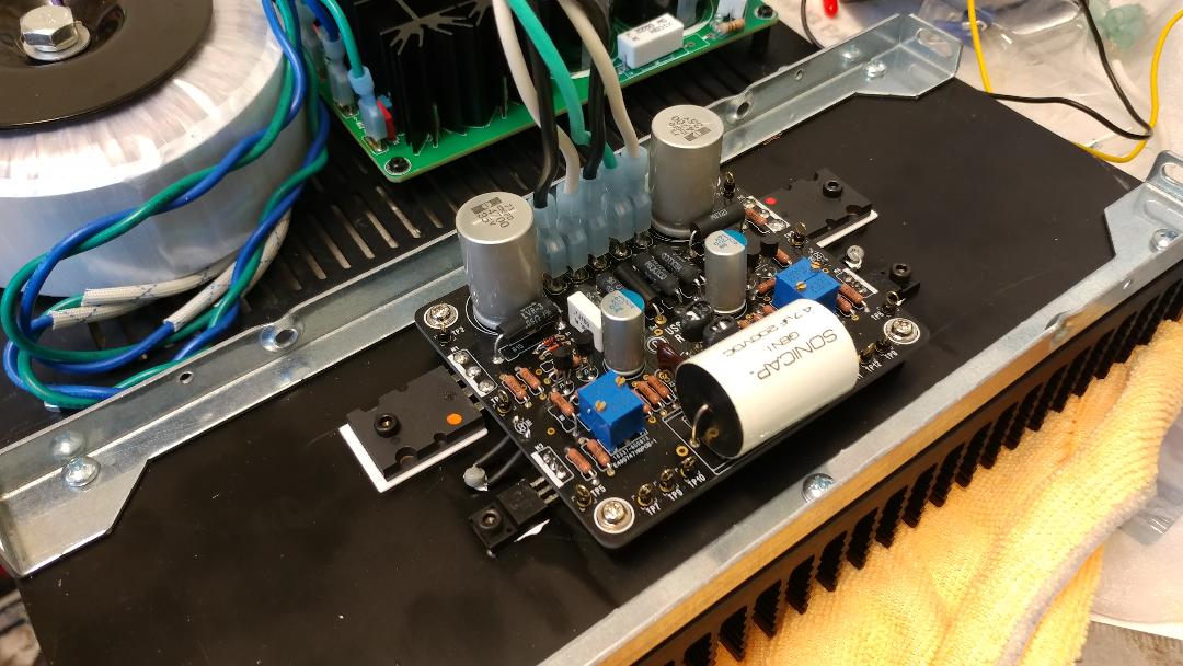

Also, I have been reading the manual, it looks some of the components on my partially populated USSA-5 should not be there at this stage of the build. I guess I should remove some of the components and start with first stage of adjusting the board. I do not not enough electronics to figure out if I dont need to remove components in order to start adjustments from the beginning.

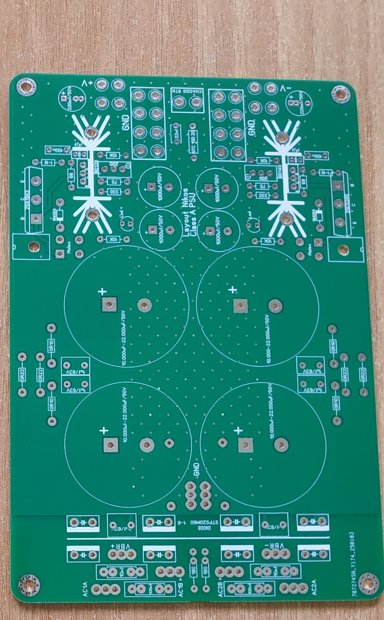

Regardless or which power supply you decide to go with , its important to know that the first bank of electrolytic caps
takes the brunt of the ripple . This ripple causes power to be dissipated inside the caps , and this affects their life time .
So for the first bank of caps , look for caps with a low ESR and a temp rating of 105oC is preferred over 85oC .
Also , the higher the total capacitance , the lower the ripple .

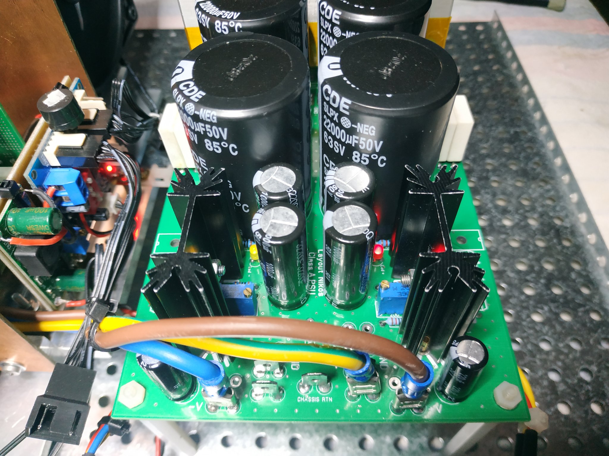

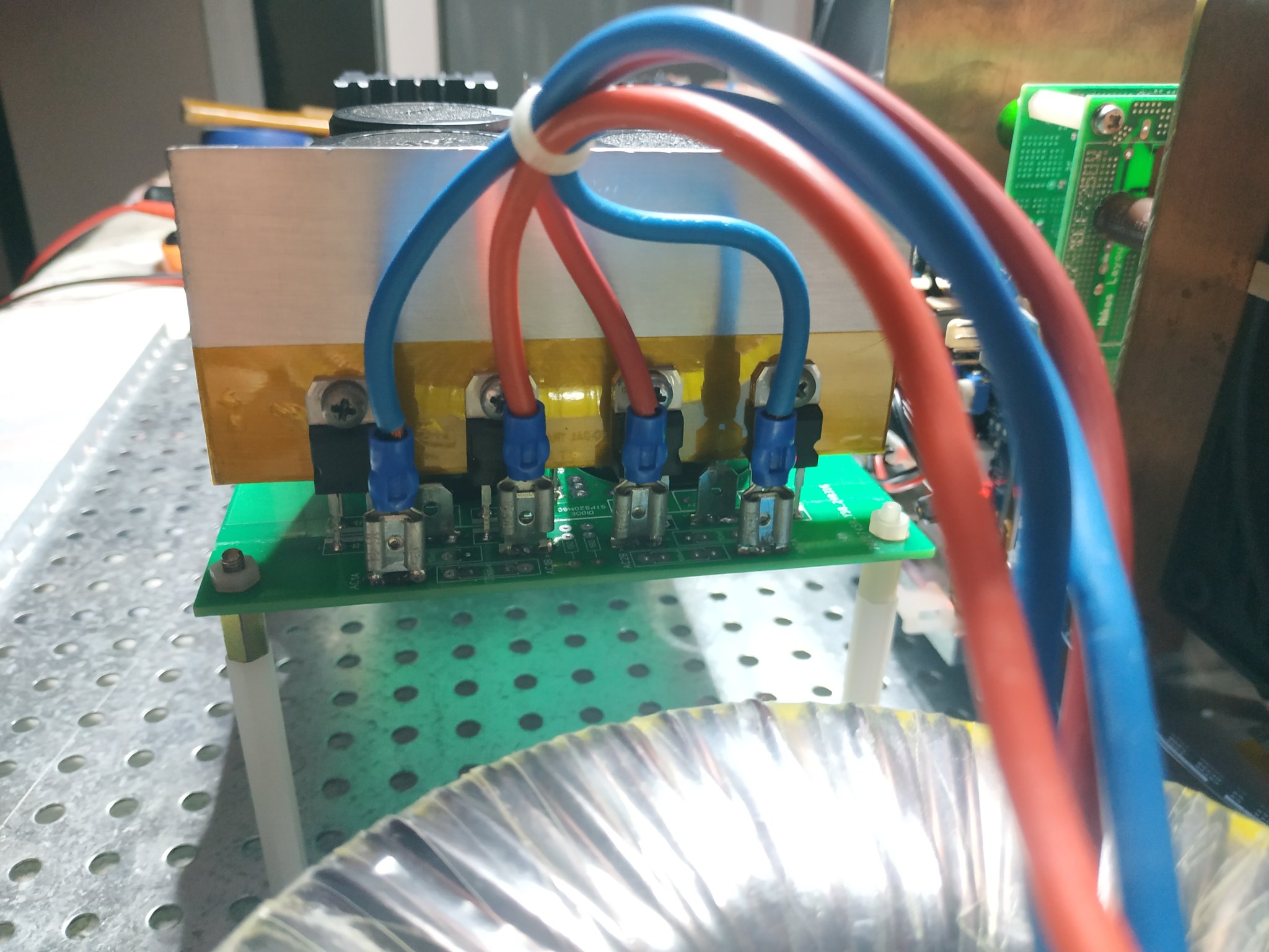

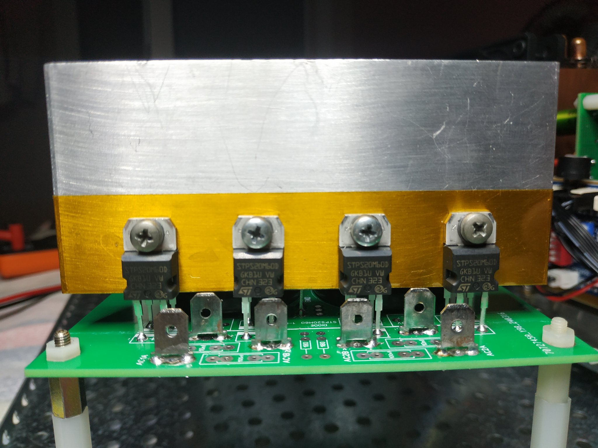

Ι make my own boards cap multiplier with classic diodes STPS20M60 Schottky Vf 0.37V rectifiers 2.6A Bias for my AN 39 1-3mv ripple.Regarding LT4320 option, it has some technical benefits like less voltage loss and no diode switching noise, but the cost is higher. Many good amps have been made using standard rectifiers followed by CRC.
