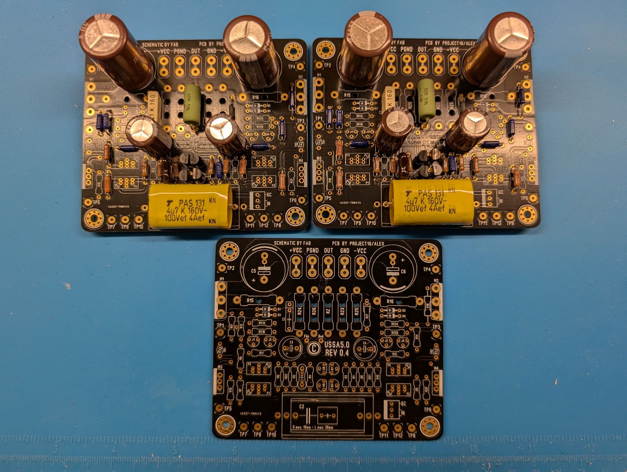

Last year I bought these PCBs from a long time diyaudio member who got ill and had to sell his stuff. Unfortunately these PCBs come with no BOM or instructions on build and start up. I would appreciate if anyone can provide some information on these boards. I would like to start building these, I also understand I will need a power supply for these, any pointers would be appreciated. I found a link to another thread for power supply and it looks that thread is last updated in 2023.

Eliad,
The USSA-5 is Fab's design and he would be able to help you out with the bill of materials.
The image shows 3 PCBs and 2 of them have a good number of components already loaded on to them. Did you get 3 PCBs from the diyAudio member? Did he provide you with any list of parts that he had installed or any bill of materials?
I got these when a diyAudio member, spaceistheplace, got ill and a friend of his helped him sell his stuff. This is all I got, no other information, just these boards and the power transistors. As far as I know spaceistheplace is no longer active which is really sad. He is a very nice guy, I hope he is ok.
It doesnt bother me I probably overpaid for these, I helped a guy in need but now I am stuck with these. I would like to complete this project if possible.

Eliad ,
As Fab pointed out , these are USSA 5.x Amps that have been started . So my 2 cents
1 ) You've pointed out that you received the power transistors . To double check ,
2sk2013y and 2sj313y driver MOSFET 's have been discontinued .... were these included ?
What are the part numbers on the larger MOSFET's ?
2) FAB has graciously put a booklet together with the schematic , BOM , building and testing info .
3 ) As Vunce advised me , highly recommend going with dual power supplies , using LT4320 and MOSFET 's as diodes .

Fab was very gracious and replied to my PM. Great guy.
I started my journey in electronics about 2 years ago,. So far I build vacuum tubes preamps and power amp. I have so much more to learn, I am humbled by the amount of knowledge I have to still learn.
Recently I build a pair of speakers for my workspace and it turned out they are no that sensitive for a 10W output vacuum power amp. I need a little more power to drive those speakers and I recalled I bought these USSA-5 PCBs and looked at them and realized I dont have much information on them.
For my main audio I build Klipsch Belle clones which work great with low power vacuum power amp.
After reading the manual and looking at what i have, I think I figured out what version i have. I believe is 5.1.
At the input I have BC550 and BC650
I have the following components.
Matched Quads 2SK170-BL
Mosfets
K2013x2
J313x2
Drivers
ECW20P20-S x4
Am I correct in my assumption this is 5.1?
Reactions: Uunderhill
My bad, I didnt pay attention. I have the correct Exicon, 2 of each.
I checked the resistors which are installed on the board. There are a couple of resistors which are different value(R7, R8 and R13, R14), I think what i have is ver 5. I will desolder those 4 resistors and replace them with ver 5.1 resistors. Unless I dont understand the differences between 5. and 5.1
