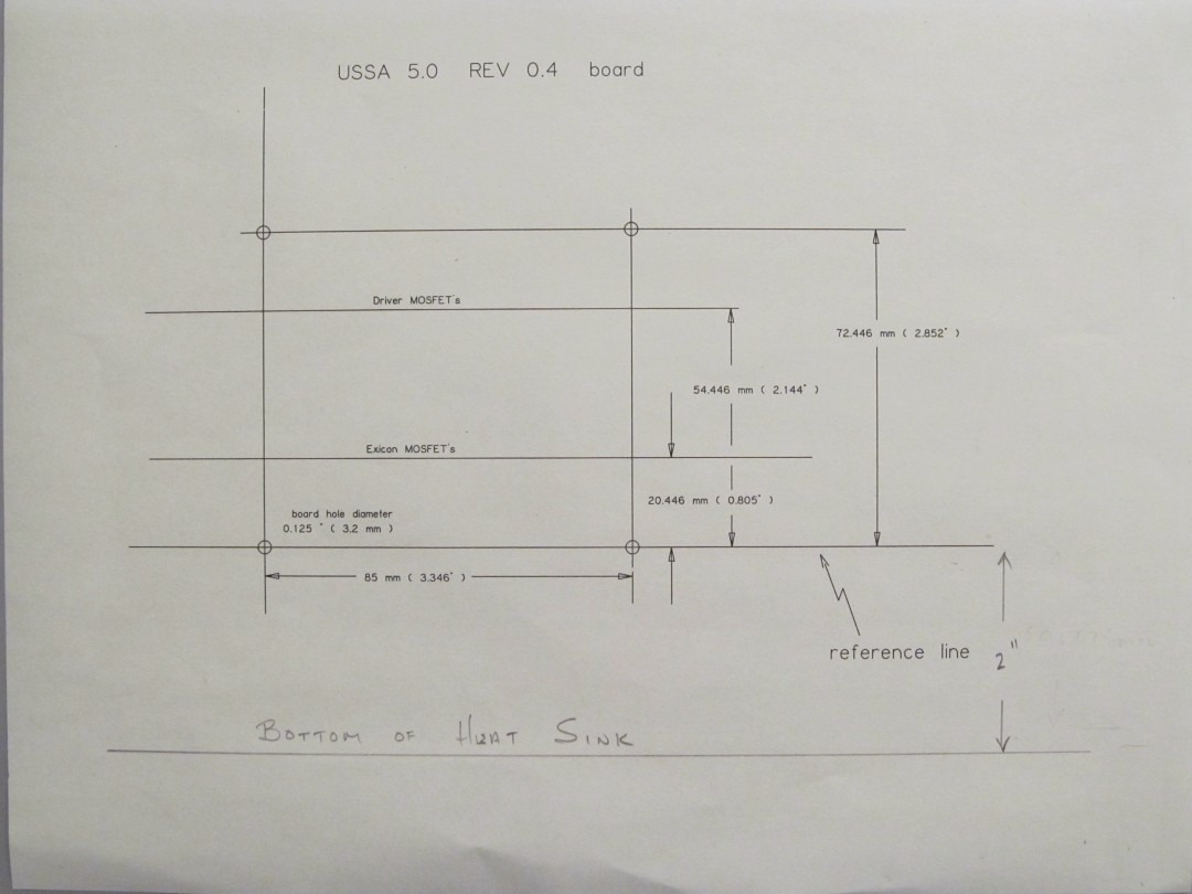

So looking at ACG's thermal image photos , post #426 , pg 22
and FAB's measurements for the mounting holes , post #449 , pg 23
cl00sed's measurements for the mounting holes , post #450 , pg 23

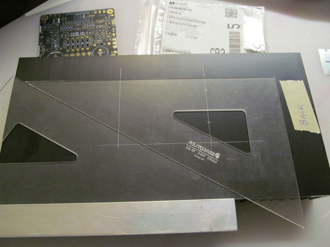

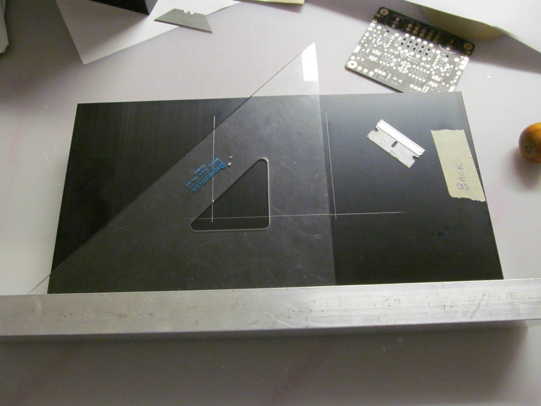

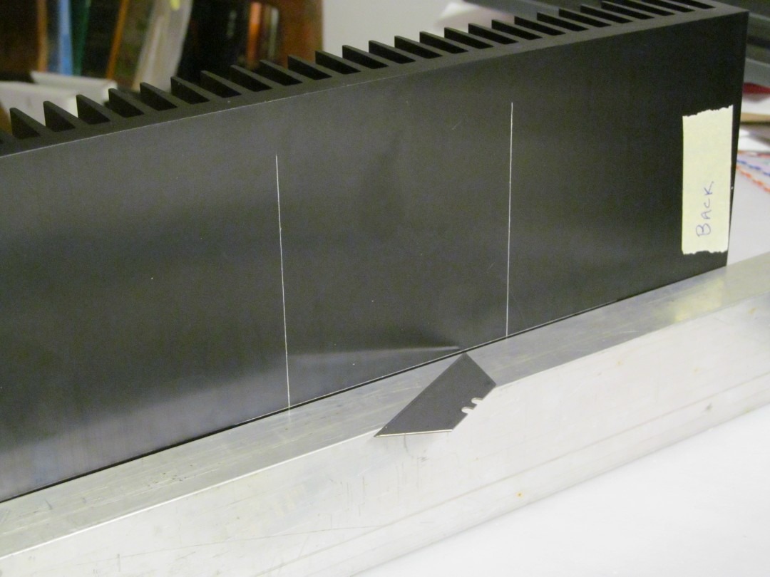

Here is what what I did to scribe the lines for the mounting holes for the USSA 5.0 REV 0.4 board .
- I used a 1 x 2 " piece of architectural tubing , and ran a utility knife blade along it to scribe a reference line along the bottom
- Note how the caliper is made from stainless steel , so it can be used to measure and scribe into the aluminum heat sinks
Don't bother buying a digital read out caliper gauge , an imperial dial caliper gauge is all you need .
- with the architectural tubing at the bottom of the heat sink , ran 2 vertical lines with a set square , and scribed them with a single sided razor blade
- PLEASE NOTE : Your fingers are never in the path of any blade ever . I've seen more accidents with hand tools than anything else .
- For the horizontal lines , the lines are automatically parallel by sliding one set square along another set square

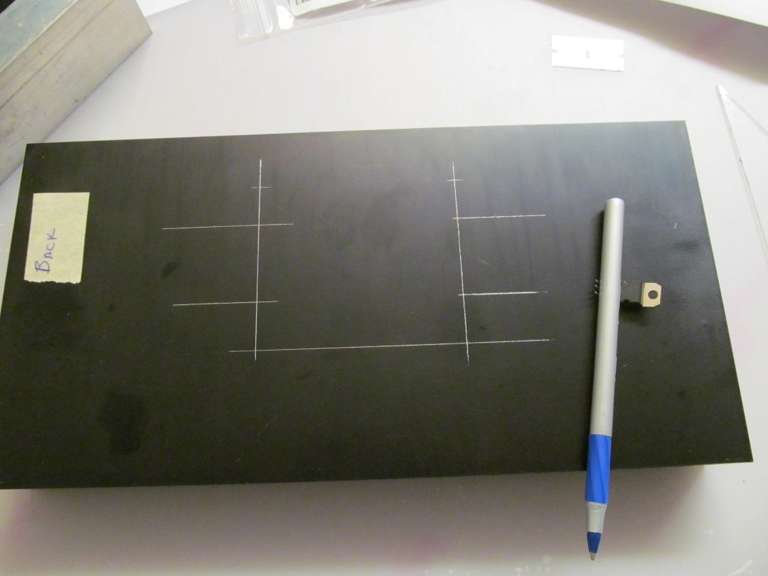

- note how I bent the leads of the transistors around a pen or AAA battery ( For brake lines , use a beer bottle )
- scribe all the lines before drilling

I'm too lazy and just tape the bare pcb to the heatsink and go to the drill press. Drill the 4 mounting hole, remove the pcb, then tap the holes and screw in brass standoffs. Bend the legs of the transistors, insert them in the bare pcb and mount the pcb to the standoffs, mark the exact locations of the transistor mounting holes. Remove everything from the heatsink, hit the marks with a punch, drill and tap holes. Heatsink is ready for duty 😉.
Vunce ,
Running a reference line , and all the measures and cuts are made with respect to the reference line is very basic standard practice .
Then using an imperial dial caliper to measure and scribe is very easy .
https://www.leevalley.com/en-ca/sho...09-stainless-steel-dial-calipers?item=88N7201
Using a reference line avoids compound measurement errors .
Sliding 1 set squares along another , to mark parallel lines , is also very simple trick .
Often a machinist will coat the metal with a blue ink so they can see the scribe lines easier .
Once you get used to used to measuring with a dial caliper , and using simple set square tricks , it becomes automatic .
Its like using a scope , it just becomes second nature .
