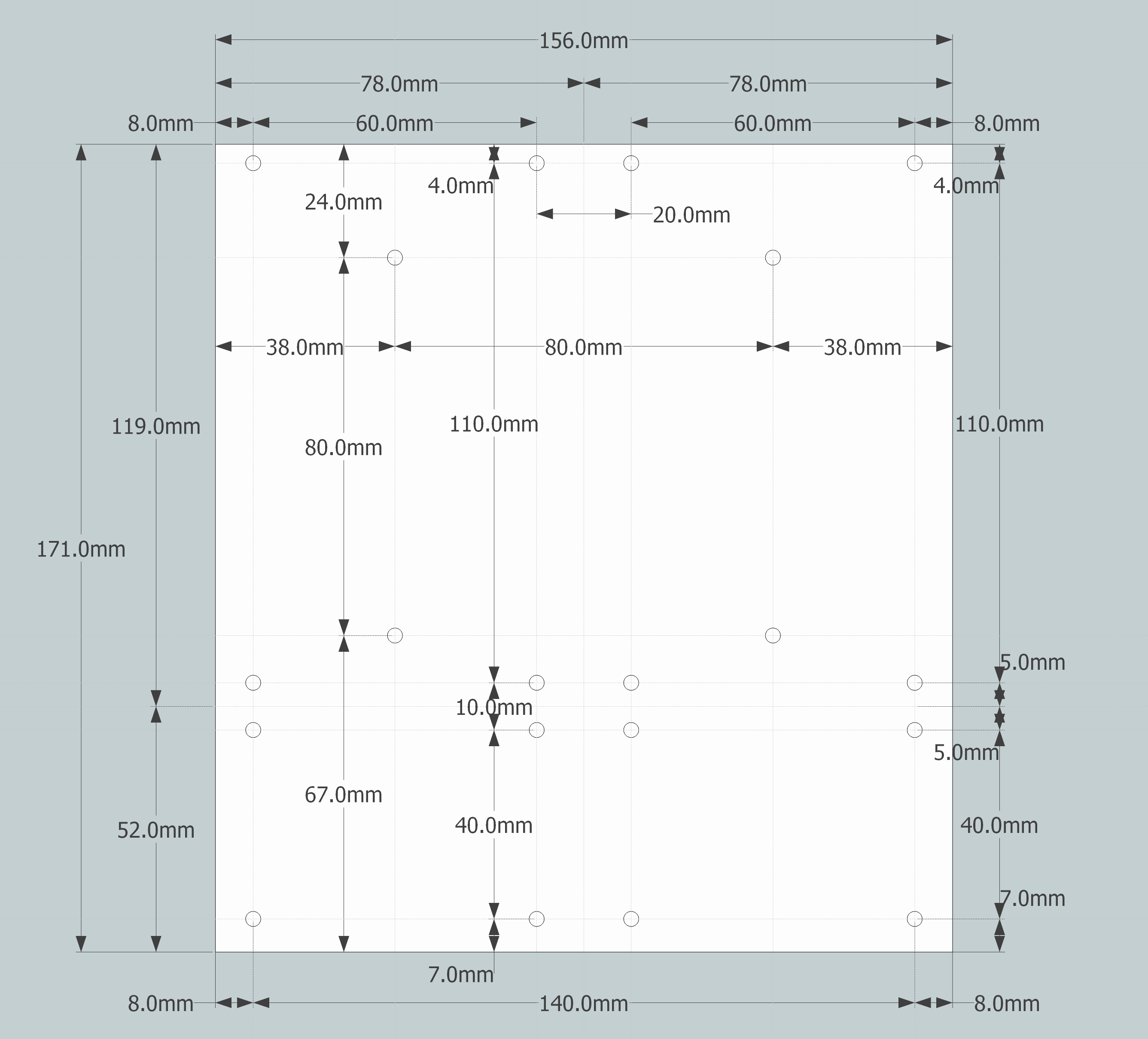

The Short Answer - for the USSA 5 , using CRC power supplies .
Here are the dimensions for the V3 board .
https://www.diyaudio.com/archive/ol...entation/P-PSU-1V30/P-PSU-1V30-dimensions.png
140 mm diode side (w) x 171 mm (l )

Actually , with the weight of fully populated V3 boards with 8 caps each , it would good to use mounting posts in the middle
as well as the corners . However , if you look at the technical drawing for the V3 board , the holes for the mounting posts in the middle of the board
are asymmetric . So if the two V3 boards , are stacked on top of each other , yet are facing the opposite direction ,
the mounting holes in the middle of 2 boards , won't line up with each other .

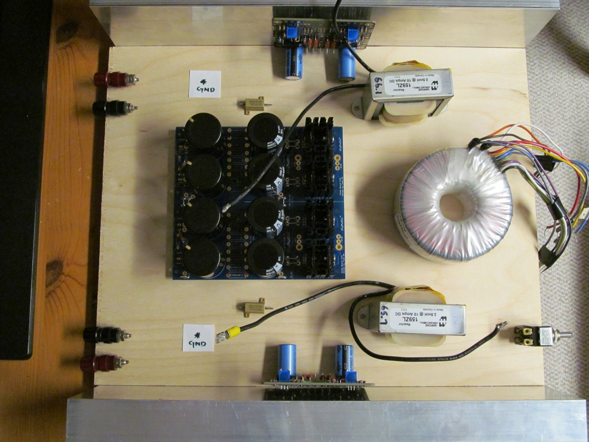

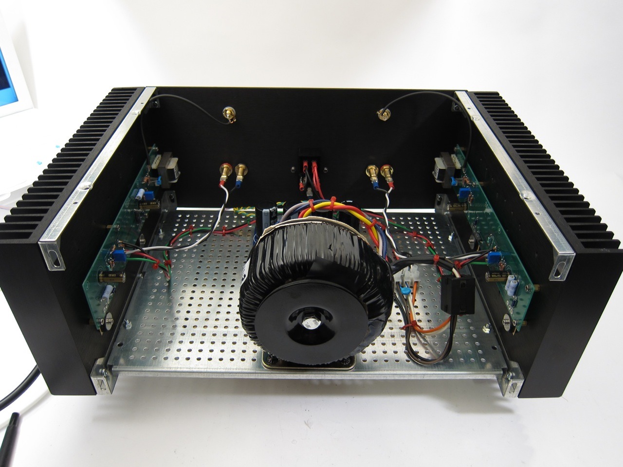

Uunderhill,

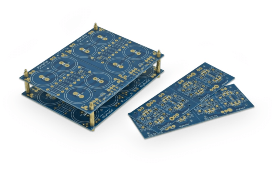

Found this image (attached) on the DIYAudiostore Uinversale PSU V3 product page - the part that has the rectifier diodes can be separated - maybe can make your placement a little easier.
You can also mount the transformers side ways using a bracket like illustrated by 6L6 in one of his build guides.

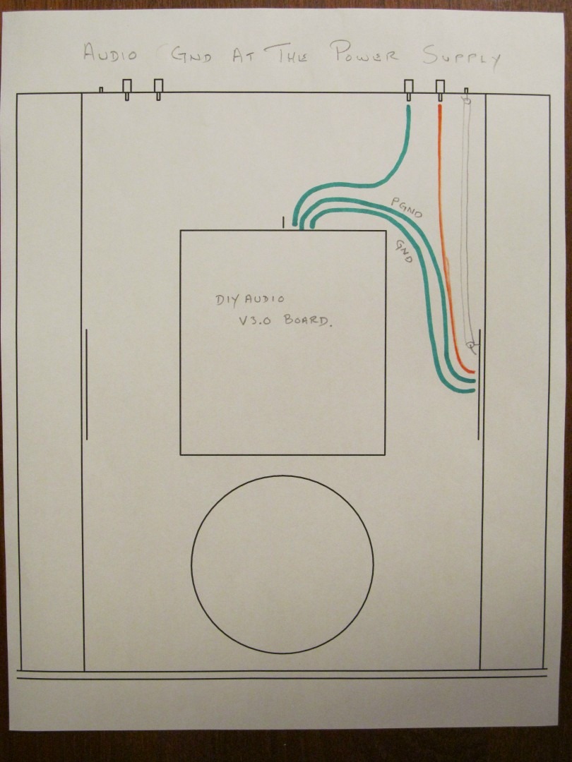

So here is the set up for the Analog GND that I am proposing - any recommendations would be appreciated
The L and R channel each have their own Star GND node - the location is shown in the photo attached .
I'm intending on using a threaded rod and ring terminals for this
To each Star GND node - Speaker GND , Power Supply GND , Amplifier PGND and GND are connected
Use either 12 awg or 10 awg cable for this .
Dumb Question # 47 , How should the RCA ground be set up ?
Note
- the transformer shown is for the display only , and soon to be replaced with an AnTek AN - 6218 .
- the connection tabs for the USSA amp are at the bottom , speaker binding posts are at the bottom
- following a post here , the USSA Amp is centered in the heat sink
Concerning the star GND note .
The GND on the power supply is usually considered the quietest location , so one train of thought is set up the analog star GND node there .
Experienced designers on this website have argued " its an Amplifier " , so a star GND node should be set up on each Amp board .
But if you examine NP's F5 , you'll see he has set up a L and R star GND node 1/2 way between the Amp ,
Power Supply , RCA GND and Speaker GND .
With preamps I've built , the eyelets of the RCA GND's are all wired together , then 1 wire goes off to the star GND node .
The RCA shield / GND does not actually get connected directly to the preamp board .
But , FAB has set up GC - a low current GND , for the voltage gain section , so it looks like the RCA shield / GND
goes straight to the USSA 5 board .
Uunderhill
For clarification, on the USSA PCB V 0.4 you need to connect both the GND and PGND to the main power supply GND. GC is The input/feedback ground. This is where you need to connect the RCA GND.
Fab
Fab

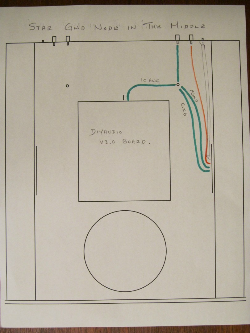

Fab ,
The Exicon MOSFET's have arrived and the AnTek AN - 6218 transformer has arrived .
I just need a few more bits and the 6061 Architectural " tubing" for the heat sinks .
The issue is if the speaker Gnd , Amp Gnd and PGnd , for both the L and R channel are all connect to the mono power supply board ,
then six 0.25 " disconnect tabs will be required for the Gnd Connections - as shown below .
However , with the DiyAudio Stores V3.0 power supply board , for the Gnd , there are solder islands set up for two 0.25 " disconnects.
But I could , file the disconnects , and change the jumpers , to get 4 more disconnects on the board .
To set up the Gnds as you've described , I'll try to get 4 more 0.25 " disconnects attached to the board ,
if not , I'll have to go with plan B - having the Star Gnd node in the middle .
Hi Underhill
you are better running dual mono using 2 independent supplies, it prevents so much possible issues….
I am not aware if some builders have used only one PSU in this project…
Anyway star ground at power supply node gives very good results.
if you have no choice you can bridge the GND and PGND at the amplifier board level And still have star ground at PSU. It will work well but just differently for AC power line remaining noise figure.

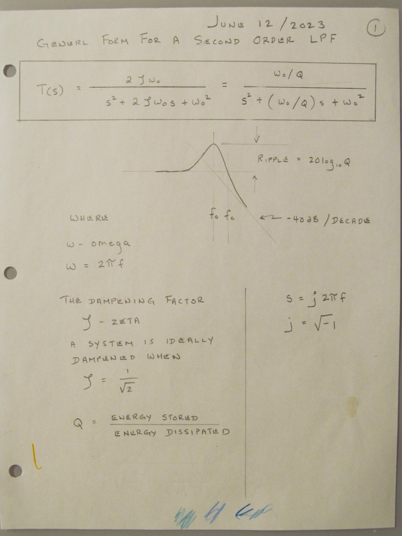

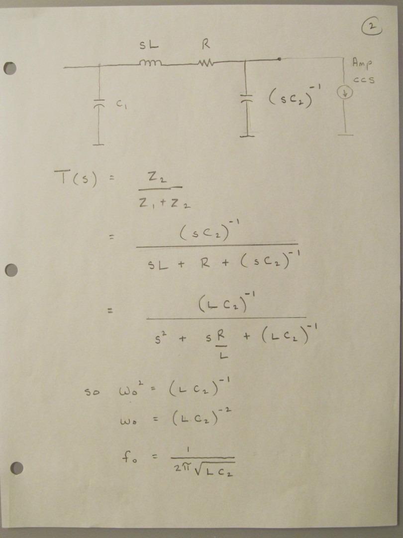

Yes , as I realize now , there are lots of advantages of running dual mono power supplies .
But ... a CRC power supply filter , is just a 1 single pole power LPF .
This is probably why builders are reporting that LT4320 power diode boards , and those SLB ( Smooth Like Butter )
capacitance multiplier boards , are making an improvement .

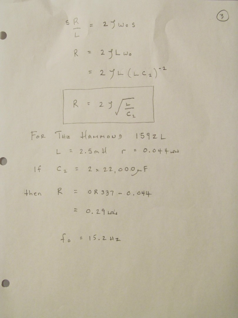

With the mono power supply board , I'm planning on adding Hammond 159ZL chokes
These have an inductance of 2.5 mH with r = 0.044 and have a 10 Amp rating .
Simulation software shows the roll off of a CLrRC filter is - 40 dB / decade .
So that's saying its 2 pole LPF , so I brushed the dust off my 40 year math notes , *
and here is transfer function and algebra , showing how to calculate the value of R required to dampen the choke .
I'm pretty sure this is correct , because it matches with other people's measurements and simulations .
Recall , in an ideally dampened system Zeta = 0.707 , but some people have set Zeta as low as 0.5
Looking from the supply rails into the Amp , the supply rails would see a CCS .
In perfect world a CCS has an infinite impedance , so an amp does not affect the damping .
However , note how the equation shows the second set of caps does affect the dampening .
* Please note : while you and Ggetzoff were off at the Pub having a few beers , and getting A's in math ,
I was working my tail feathers off just to gets C's .

Fab ,
Heat sinks are needed - I was going to buy a 32 " length of 2.0 x 4.0 " of 6061 T6 architectural tubing
and cut it with a chop saw for the heat sinks . But as it turns out , it won't have the surface area needed .
I know next to nothing about heat sinks , so hopefully this is correct
So than means a heat sink with a 0.5oC / Watt rating is needed for each channel ,
but there will probably be a bit more thermal resistance , so say 0.38oC / W ???
