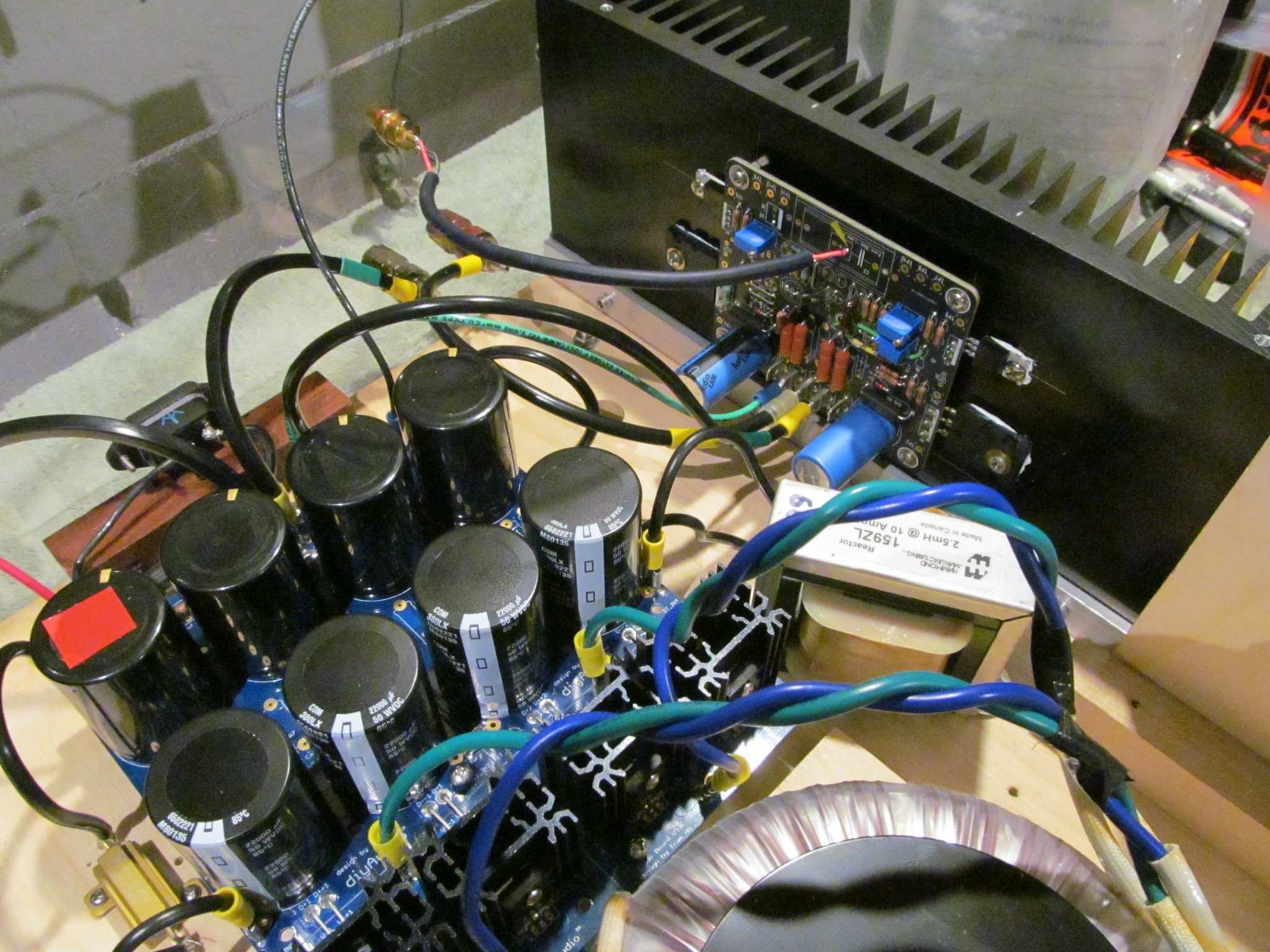

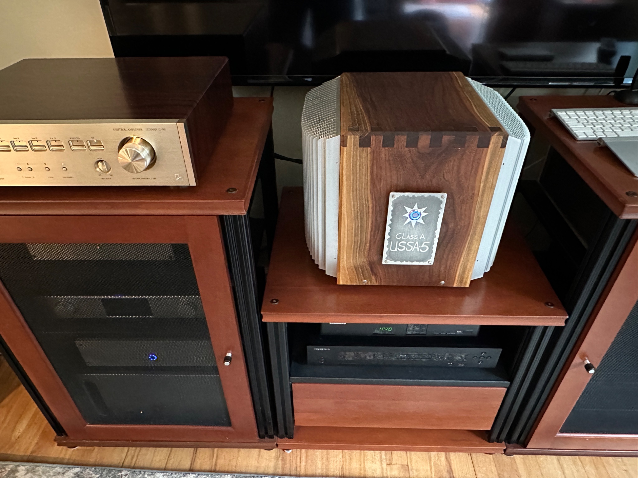

Cooler weather is here and Fab’s USSA5 is first in rotation. Almost 5 years old and still one of my Favs.😉
