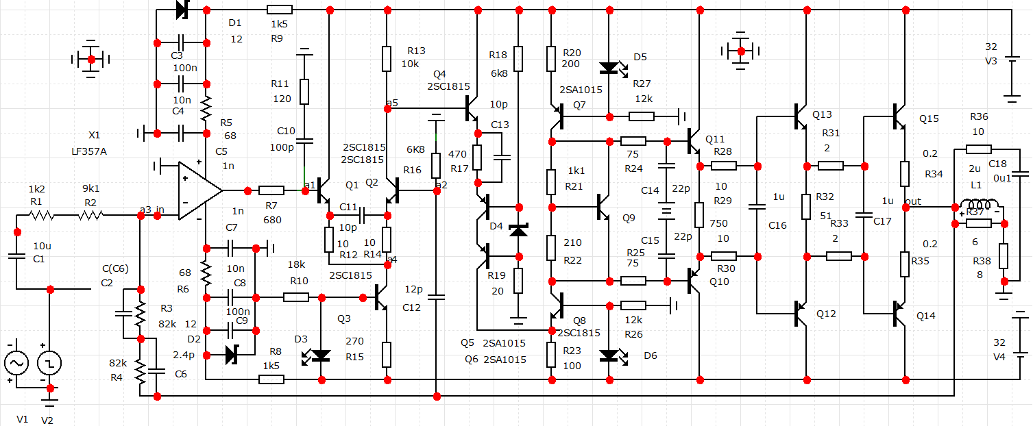

This is work in progress for schematic from post #1020
https://www.diyaudio.com/forums/solid-state/357369-unusual-amp-1987-a-102.html#post6463786

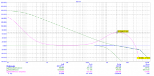

I decided to remove the OE from the signal chain. It turned out well. The loop gain graph shows a large margin of stability .Okay. I'll archive this option. then maybe I'll work with him.

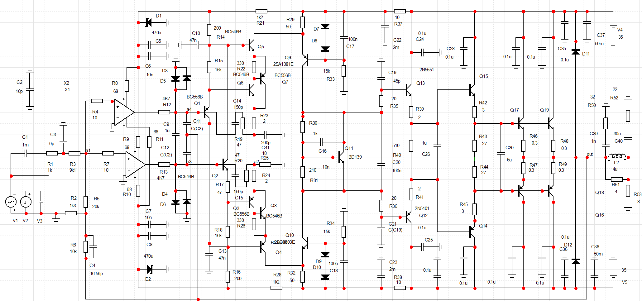

A balanced amplifier is next in line.

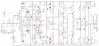

I see you changed arrangement of Q3, with extra feedback from the output...
Thanks Maxim! I'll sim it, this could be next build candidate.Promised
As you know, I was thinking about symmetrical version..
Classic.The Composite Young. an inverting composite amplifier, where the discrete part is a non-inverting voltage amplifier .I see you changed arrangement of Q3, with extra feedback from the output...

Throw out the opamps and you get the L. Zuev amplifier .Radio magazine No. 2 No. 3 2005

Just started testing the amp from post #1020
So far - at first attempt, with rails at +/- 12V, and without input signal,
it's oscillating at 154kHz. Looks kind of like sinus, but only upper halves.
Vpp 9V.
Zobel resistor gets hot.
With PSU current limiter at 200mA, negative rail will start sagging when increasing rails voltage beyond 9V.
Will try with full rails voltage (+/- 45V)..
Update: same thing. 154kHz oscillation at higher Vpp. Negative rail stuck at 8V. Zobel hot. Current limiter at 200mA.

Turn off the limiter diodes temporarily. C7 increase to 270pf. R20 is better to increase a little
