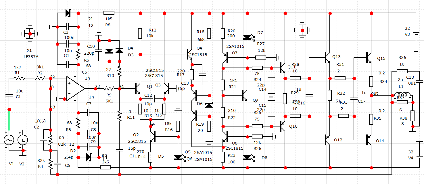

What about your previous version from post #935 ?
https://www.diyaudio.com/forums/solid-state/357369-unusual-amp-1987-a-94.html#post6451615
Modernized Kletsov is any better?
LTP right after op-amp seems to be redundant and avoidable...

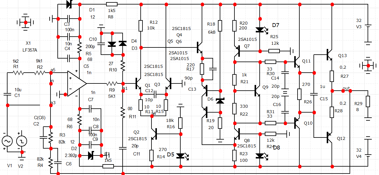

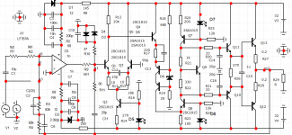

The idea came ,I put it together. It turned out very well.Kg is also minimal.And according to that scheme, everything is not bad either.Yes they are all at the level of noise distortion
Current generator. The source of current . Normal switching on of the differential amplifier .What is the role of Q3?
Figured it out . You don't need to delete Q3. So linear. And without it, nothing will work.Scheme for brain training.

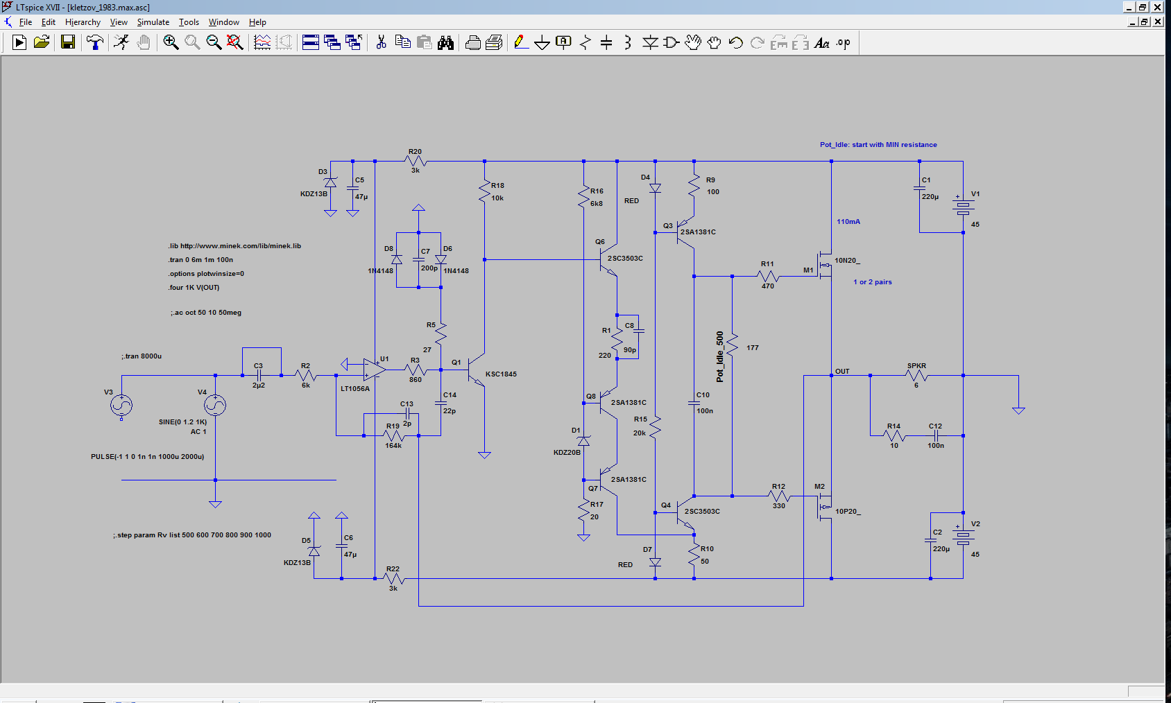

Well, I have PCBs coming on Wednesday for the version from post #935 (one of my later posts with hexfets - complementary and quasi).
So that's what I will build for now...

Also, I'll be building Philips 22AH578 amp from post #792.
https://www.diyaudio.com/forums/solid-state/357369-unusual-amp-1987-a-80.html#post6433425
Also have PCBs for it...
Very simple, fast, only 2 small transistors, 2 TO-126, and dual-die latfets.
Newest sim attached.
So I have 3 amps lined up to build, and one older (current dump passive from Elvee) still waiting for some testing/tuning..

It's not as good as the latest versions of amps here in this thread,
I wanted to try one that's faster, and symmetrical. Let's see how it sounds...
You can't always guess. LTP for example. local oos or something ? Or a limiter clip limiter ?

Understood. differential amplifier.But he's DC current ensures the stabilization of the modes .The output of the opamp is zero DC voltage .
