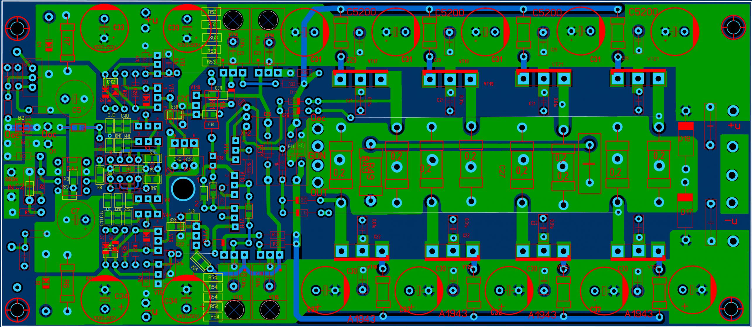

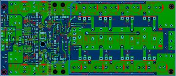

And I'm still trying to do a phase-linear amplifier one.More precisely, the printed circuit board. .I just don't know whether to do it or not.

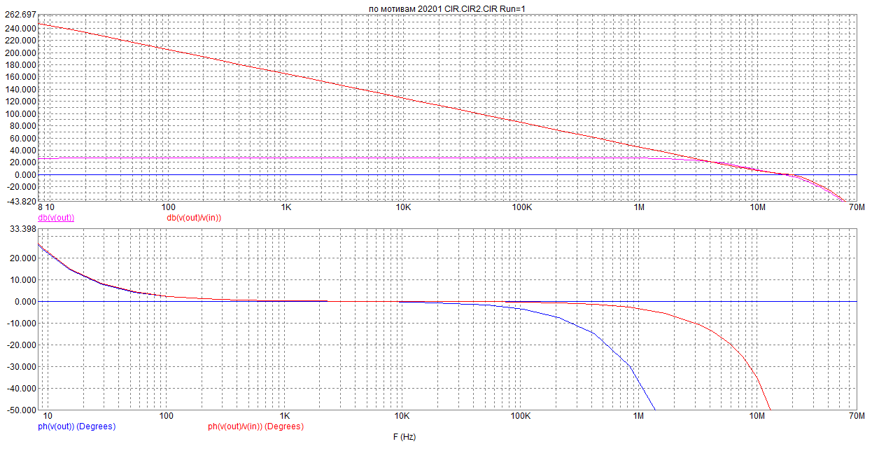

linear phase 10herz-100kHz. lower graph

Up to 20 kHz, the phases are almost identical . The prototype in the hardware is functional .But while there are problems with the PCB.
I just don't know if this phase makes sense or not

I think PCB will be fine. I made 3 PCBs for 4 amps - it's a similar topology.
And my PCBs are not perfect. They don't have ground plane like yours.
And they all worked just fine. No hum, no un-explainable oscillations.
As long as ground(s) is routed correctly, power and signal ground separately, they will work ok...
Very nice board. But if I was a transistor, I wouldn't care if layout or tracks are symmetrical or not 🙂
This is purely for esthetic reasons

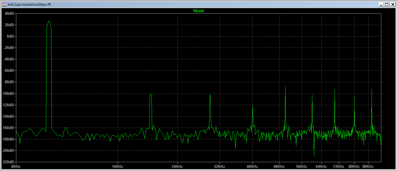

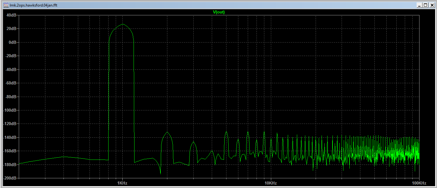

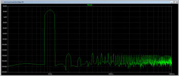

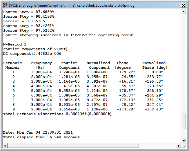

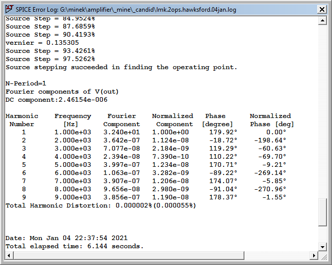

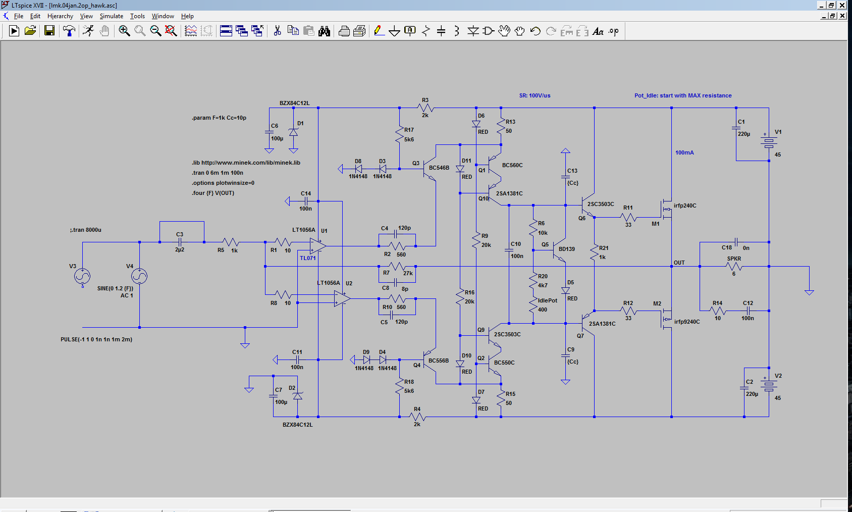

I quickly put together 2 op-amps + Hawksford cascode VAS.
I guess the overall results are similar to the latest/best non-symmetrical schematic, but SR is at least 100V/us.
Plots for 1kHz and 10kHz (at full power). Very nice square waves too. Very stable and tolerant.

This is very simple schematic.
I bet you can slap your voltage shifter/buffer, a coil or two and make it much better 🙂

-120db 1000hz/There are many distortions. But the rate of increase is higher/ Everywhere you have to look for a compromise.I don't like the throttle.they are capricious.
Yeah, your last non-symmetrical was flatter (Thd at 1kHz), at or below 150dB.
That's because more complex voltage shifter (4 transistors).
Here there is only 1.
Tomorrow will try to combine both of them. But it seems little bit over complicated...

A compromise. You reduce distortion, the rate of voltage rise decreases. How to find the middle
But from what I see, Hawksford cascode VAS improves everything,
so it's worth using, regardless of the input and middle stage implementation.
