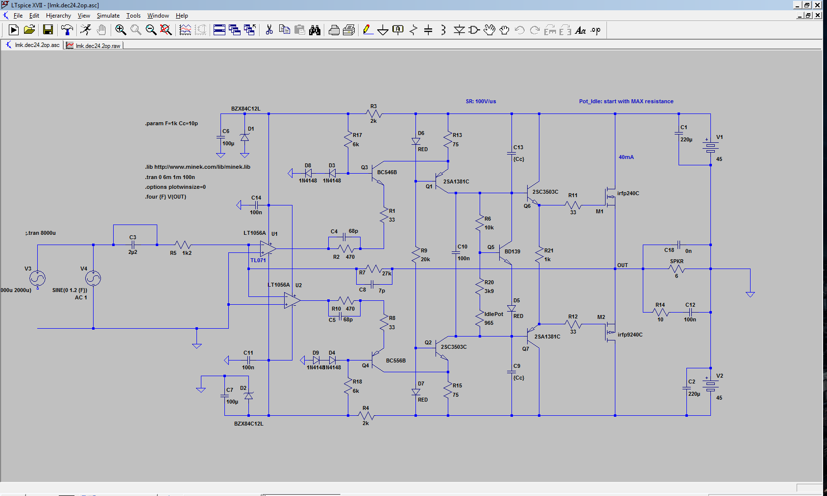

It remains to make a balanced input and get a balanced amplifier.Need to? I don't know. Can try it in microcap / LTC spice .Getting back to 'unusual' amps - how about using 2 op-amps in the input, to drive symmetrical VAS cascode?
Something like in this example (just to illustrate the idea) ?
The entrance to the OPA1632 , then symmetric channels
These 2 op-amps are not in anti-phase, they are parallel, outputting the same signal (more or less).
By using two of them, there is no problem with taking care of the fluctuations at the 'joint' point that you were trying to fix/improve with previous symmetrical models.

I connected the LMK module to the OPS on IRFP240/9240, vozbud terrible up to 1V! at a high frequency.Connected 120 pf capacitor to collector Q5 and 47pf to collector Q6. Both on GND. Didn't really help. Completely got rid of vozbuda installing a capacitor Panasonic BP 100 uf 16V parallel to the capacitor c7 200 pf. You. guys, something here is flawed, most likely the case in the ground loop. All transistors is matching. DC offset 3mv!

Now everything works perfectly, the BIAS current of 115ma. in the headphones is absolute silence.full

Russian-American version of LMK. LMK MM .

It's an LMK (or is it Wiederhold ?) + your's (Maxim's) voltage shifter/buffer (or whatever it's called) + Quasi output + Steve's novel LED quasi voltage biasing of the lower half 🙂
Improvements adding up since 1977, from all continents except Antarctica 🙂

How is crossover distortion? Did you check on the oscilloscope?
I was afraid that the wires would whistle.Although the stability margin is decent. There were doubts about success.
Actually, what was built is not quasi, right?
Your OPS is complementary?
But Prohodimez wrote that he connected IPS to pre-existing OPS with complimentary hexfets.
So what he tested is not exactly schematic from #1048.
He just tested input + VAS....

Oh, about that. He checked the most important thing. The scheme works . we will be waiting for photos and information.
PCBs seem to be OK. Order placed. Should be 2 weeks wait...Working on PCBs (one for complementary version and one for quasi)..
