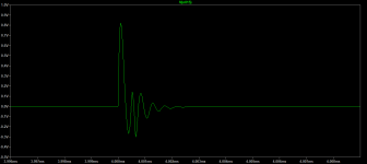

And the signal level of the square wave at the output of the generator can be reduced? I'm sure the level is high
Yes, that's why I reduced it from 2Vpp to 1.2Vpp, and to my surprise it started to oscillate...
With C7=16pF, and input Vpp = 1.2
there is a 'kink' in the rising wave..

The best square I can get for 1.2 Vpp
is with C10=330p, C6=16p, C7=22p
But - slew rate suffers, and it goes back to 15V/us like in original LMK/Wiederhold amp.

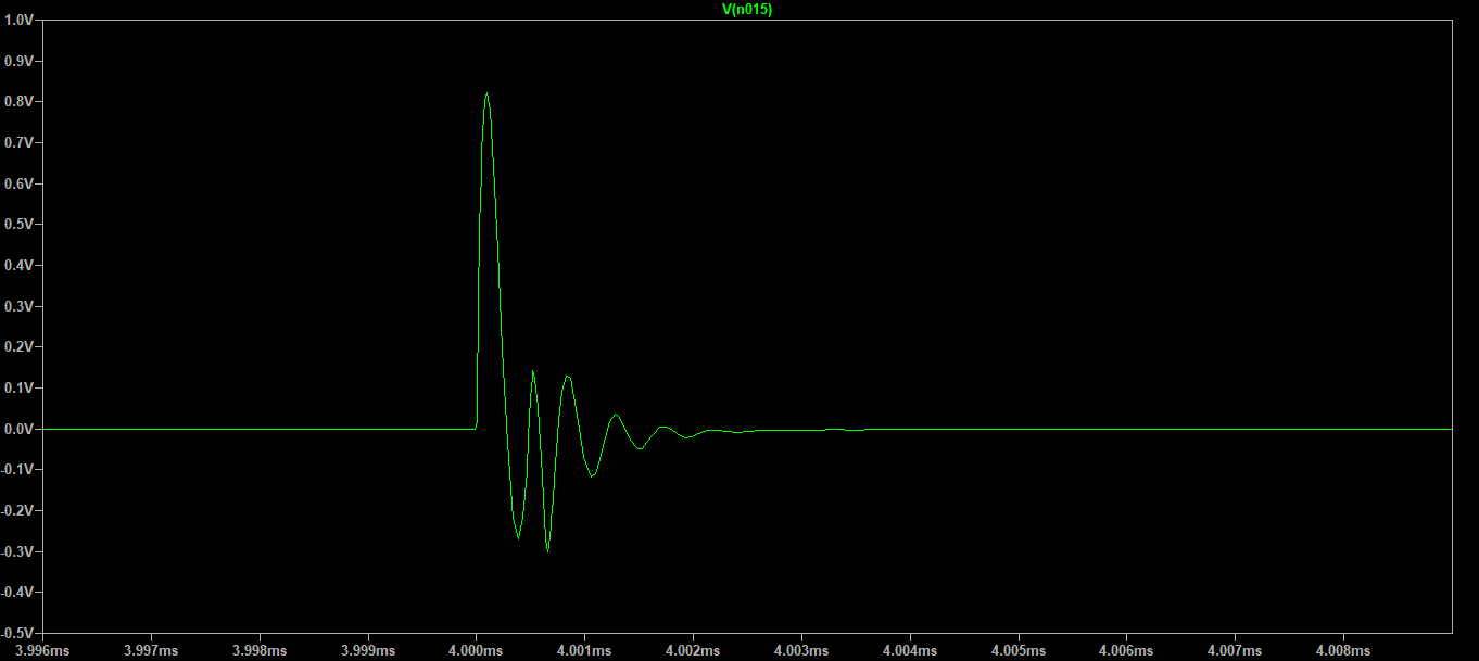

If I add output LR network, oscillations on the rising square corner are increasing.
If I add output LR network AND C to the speaker (10nF), oscillations on the rising square corner are getting even worse.

Amplifiers with such a large gain are not indifferent to the capacitive component of the load. We must be careful .
And so, carefully understanding the correction of this amplifier, it is easier to understand it, the principle of its operation..

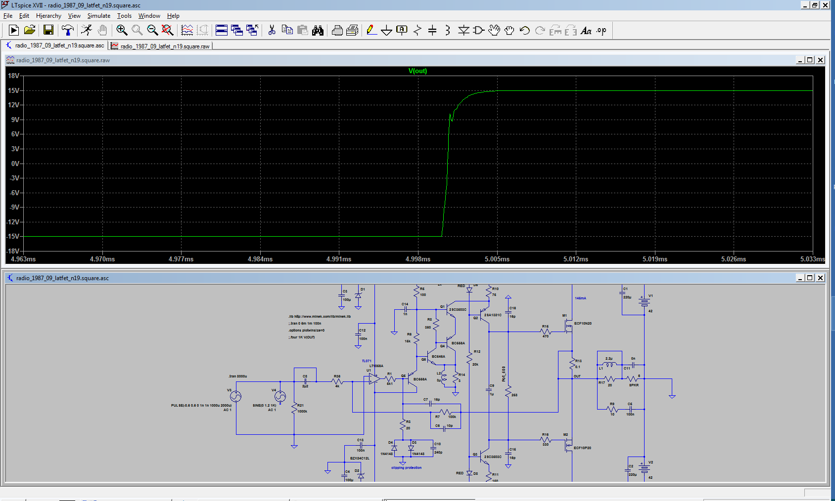

That's the best result so far (in ltspice). Works well with speaker capacitance and LR output network.
Rise time is slow-ish (like standard LMK/Wiederhold).
In real build do we need input RC network, like for instance in the Wiederhold amp I built?
Most likely, the models of laterals are inaccurate .A high-pass filter is required.
