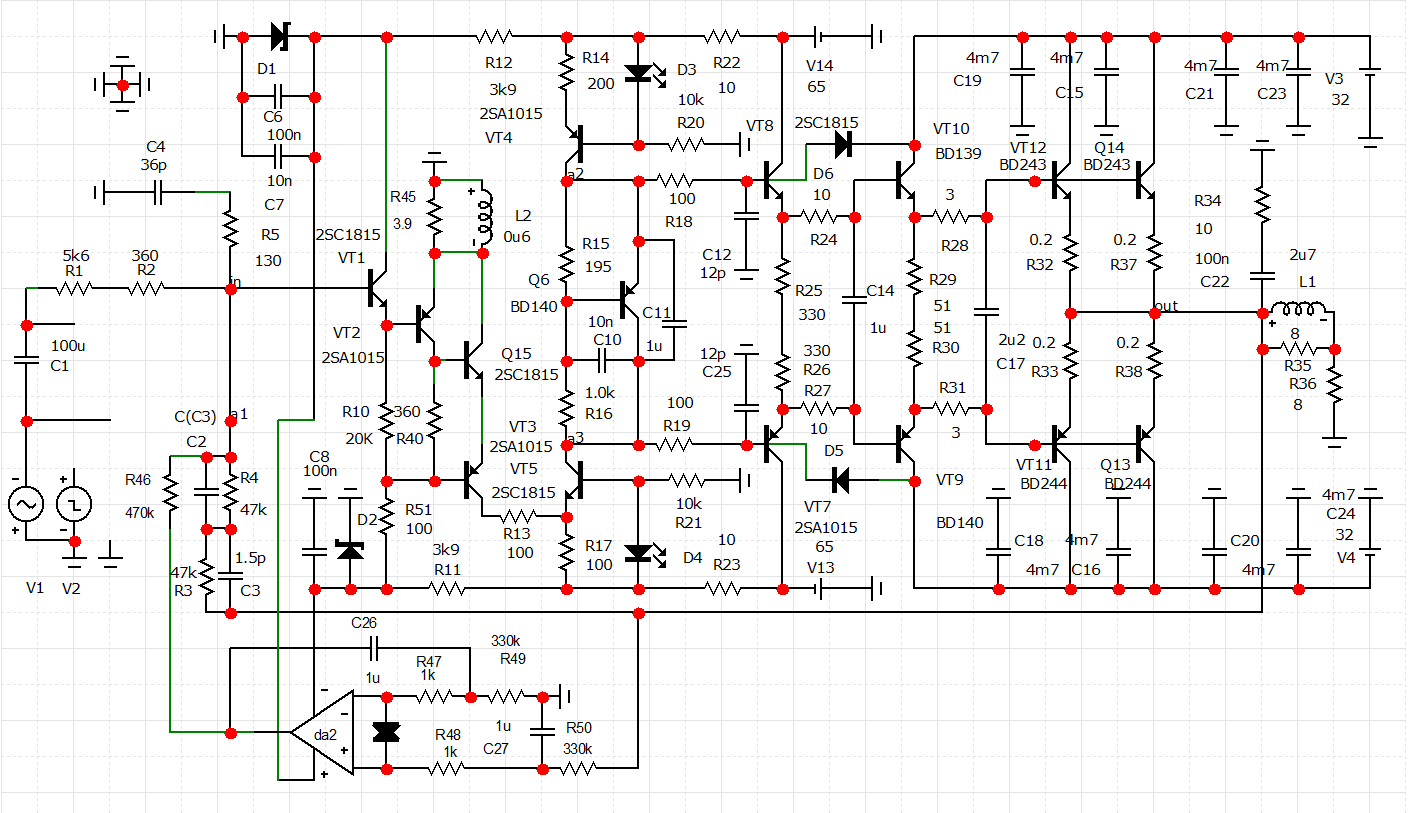

R11/R10 on your schematic (Zener resistors) - should they be lower in value?
All these extra transistors are drawing extra current.
In mine they needed to be 1k7 to leave enough current for Zeners.

I was sim-ing amp from your forum 't20-topic' "Re: Наш ответ оплеухе"
I see your coil has polarity ('+' and '-') ??
No, this microcap is acting on its own.There is no polarity there

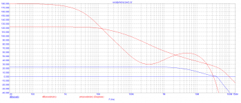

Interesting thing - with higher gain (4k resistor) your amp shows lower Thd (0.0)
than with lower gain (5k6 resistor).
Check the settings in LTS spice, the analysis time, and so on.The accuracy of the analysis depends heavily on these details
I'll show you a modified discrete version with a servo on the ideology of this topic. A fairly modest gain without OOS.Total 115dB at 20 kHz
I'll play more with the sim, and slowly design a board for it (op-amp version, not the discrete one with the servo)..
Just an example of an amplifier with a large loop gain.

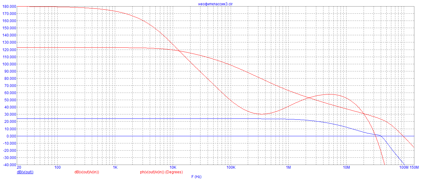

Can't get square waves to simulate correctly.... Oscillating. I was trying to modify all obvious elements, to no luck...
I experimented more, and I'm getting better square waves (but still not acceptable yet) with bigger values of C11 (from your latest schematic from your forum)
(C7 in my sim).
My sim is up to date with your latest version.
One thing that worries me - square waves are very sensitive to the value of C11.
Very small changes in the capacitor value, trigger big changes in oscillations.
With a few pico farads difference, even pcb tracks can affect the results....
How is this behavior called? "Marginally stable" ?
