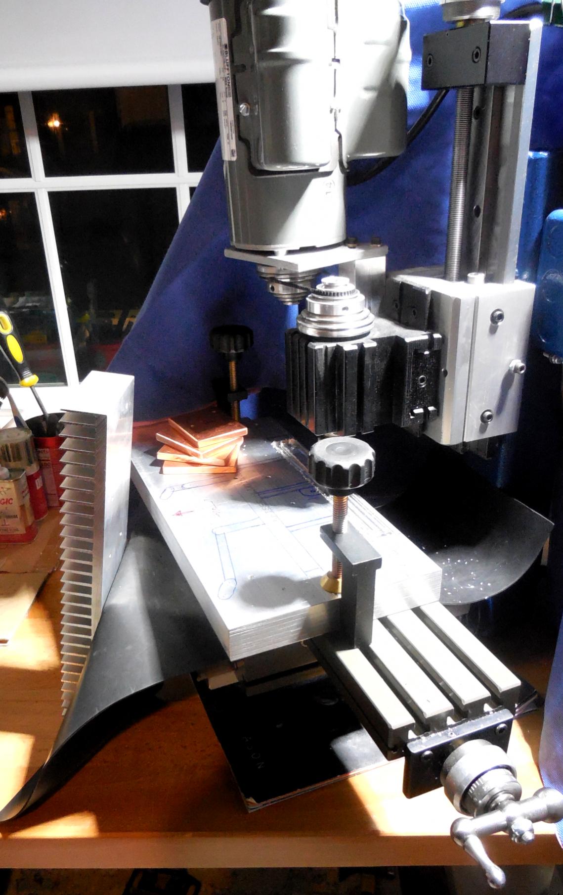

Ivan or Igor - let them be; in the meantime I'm working on the aluminum chassis for Widerhold Quasi Hexfet :)
Machining the Alu plate (1 inch thick, 6 wide x 12 long).
Copper spreaders for fet pairs + heatsink..
Should be enough for honest 2 x 120W.

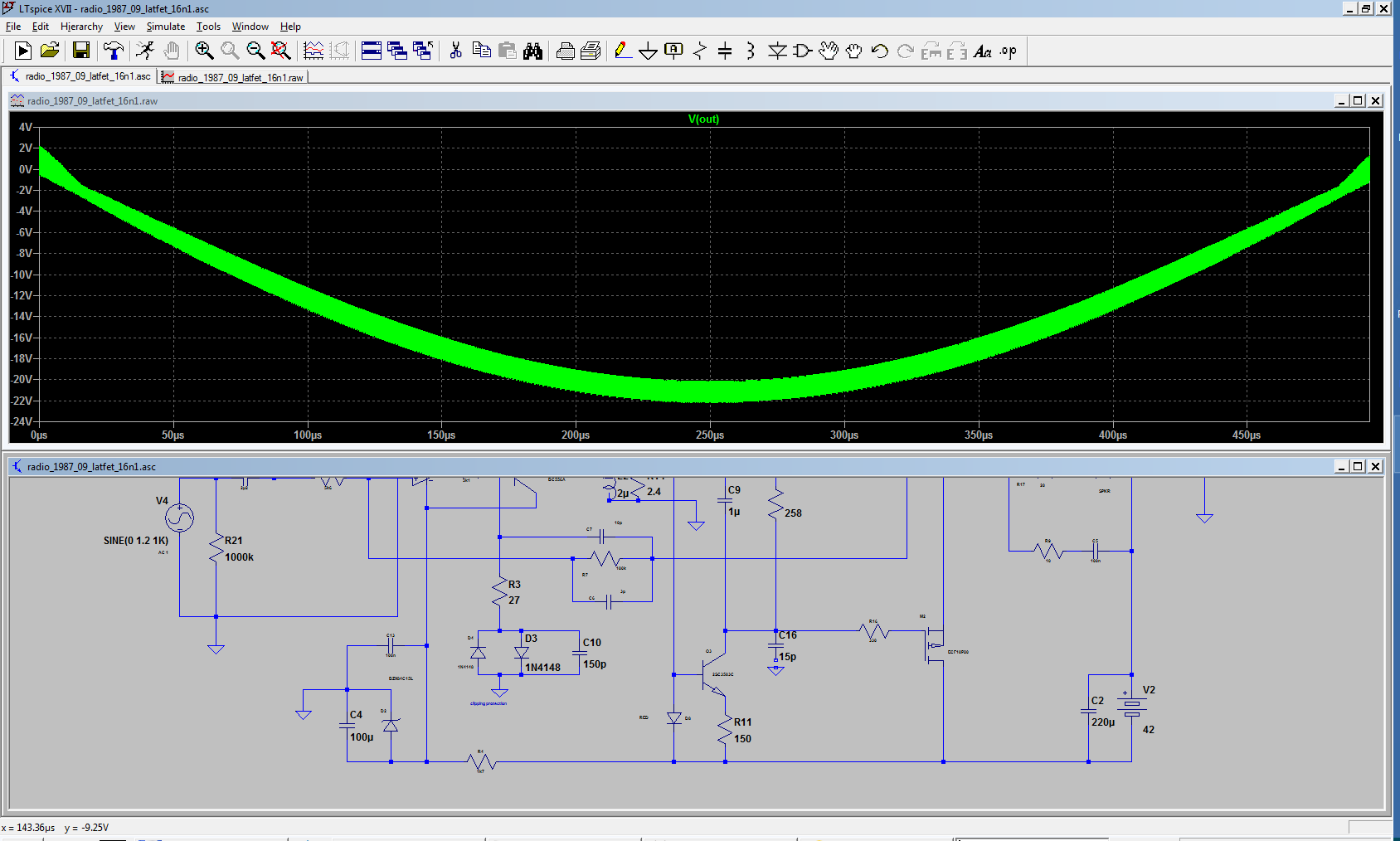

I'm basically fine with versions sim-ed and built so far.
Don't think there would be big difference in measurements/listening -
all these amps already have very impressive parameters.
If there is one thing I would like to improve - it's the slew rate.
So far - 15V/us measured - which matches the sim exactly.
But this I guess is limited by VAS configuration itself, not the input stage..
Just to compare I sim-ed square waves on discrete NMOS200 (blameless quasi hexfet that I built few years ago)
Power amp under development
which shows slew rate over 60V/us.....
15V/us is perfectly fine for an amp, but not impressive :), perhaps more is possible?
