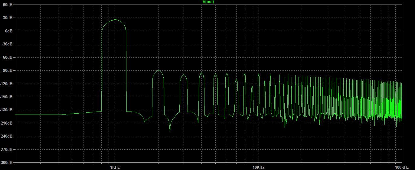

With LTP input slew rate is 50V/us. УНЧ-ВВС-2011 has 100V/us.
You can see my sim of LTP Vhex several posts ago

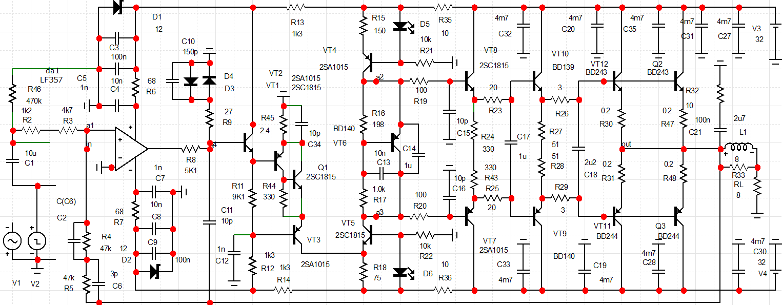

Unusual amp from 1987
Check the numbers...
Doesn't look like I'd be building it anytime soon...

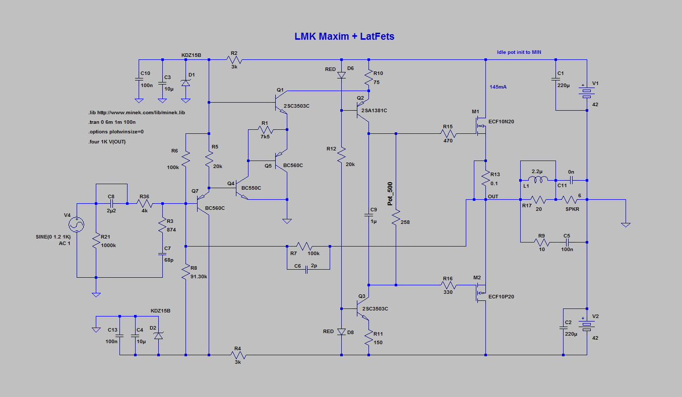

If you add another transistor, the oramp becomes redundant.
Looks very good, Maxim. What do you think about CFP/Sziklai output?

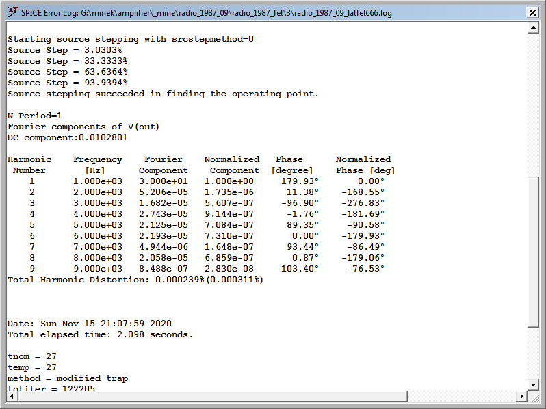

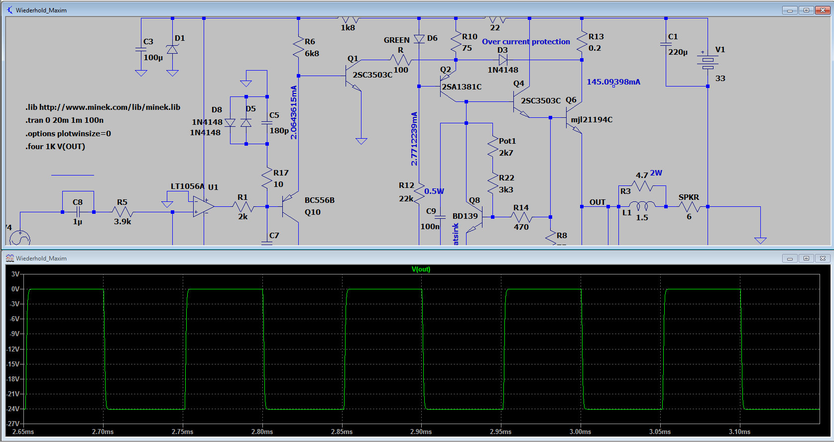

I was surprised that my measured slew rate was about 15V/us.
Was expecting more...
And even worse, it seemed to be the same for all op-amps I tried, even fast ones.
So it means it is limited by VAS...

I tried fast op-amps (e.g. LT1056, LT1357). No difference in slew rate.
TL071 is slow (max 10uV/s), but op-amp in this topology works on the low voltage (700mV or so), it doesn't amplify voltage like VAS does,
so it doesn't need to be fast...

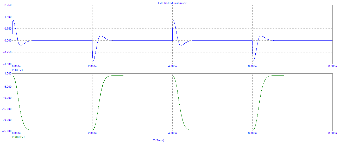

this is how RRCRC correction works
The one in your schematic? It would improve slew rate?
Tried to sim it. Not sure if this is better than op-amp.
Don't like the resistor pot to bias the base of VT1 (Q7).
Thd and symmetry will depend on it...

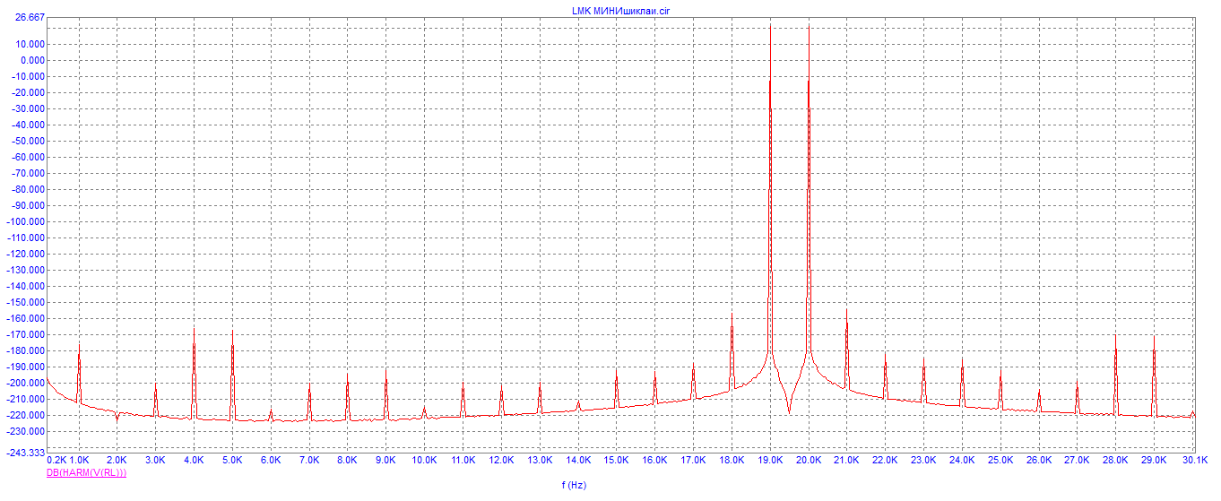

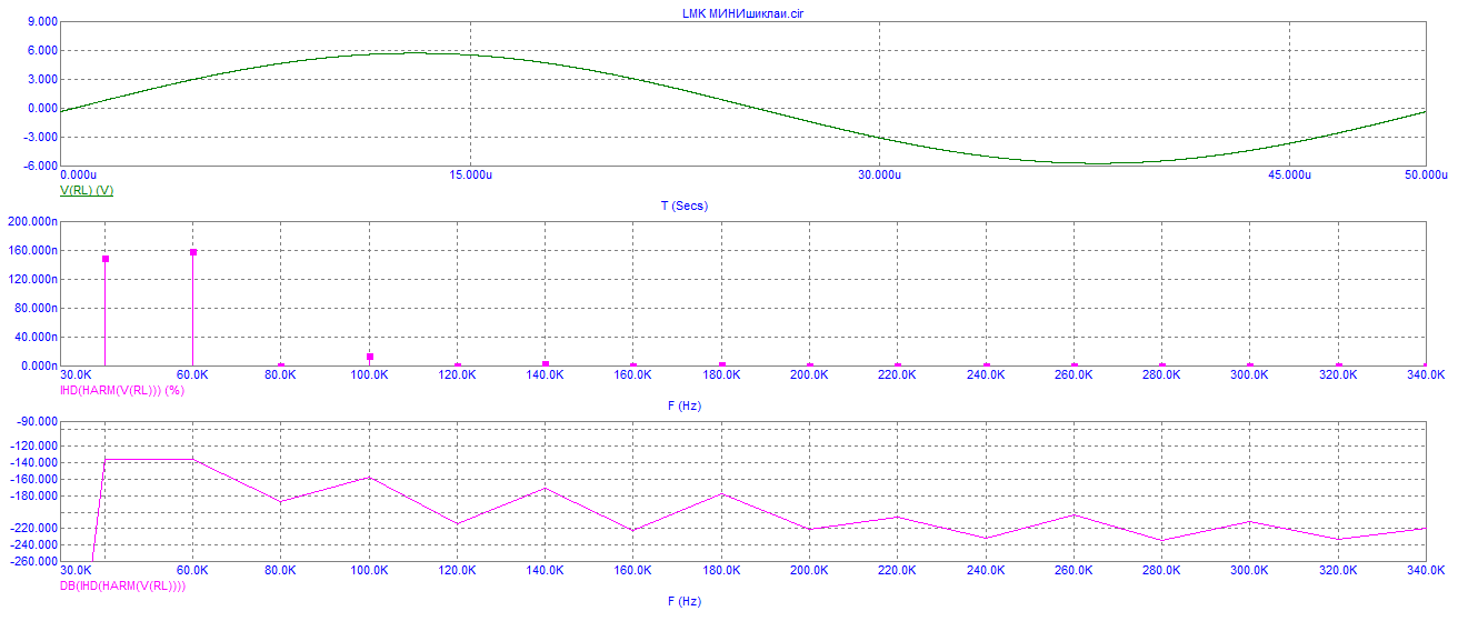

The introduction of the EP into the voltage amplifier gives a positive result. Even in the composite with Oramn.
Added a local OOS to the emitter of the second transistor.A completely different amplifier has become. Of distortion decreased

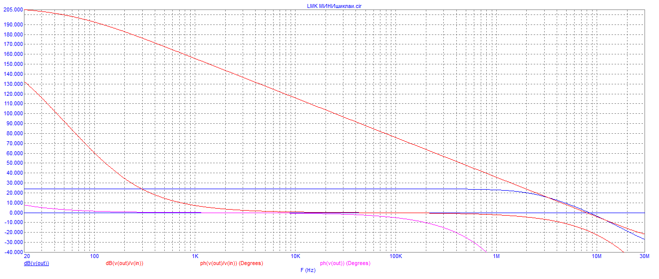

The driver between opamp and VAS appears to limit the SR. (simple or cascaded equally). Using emitter follower + common emitter arrange (Maxim version) gives significantly better Square wave. (10 kHz)
