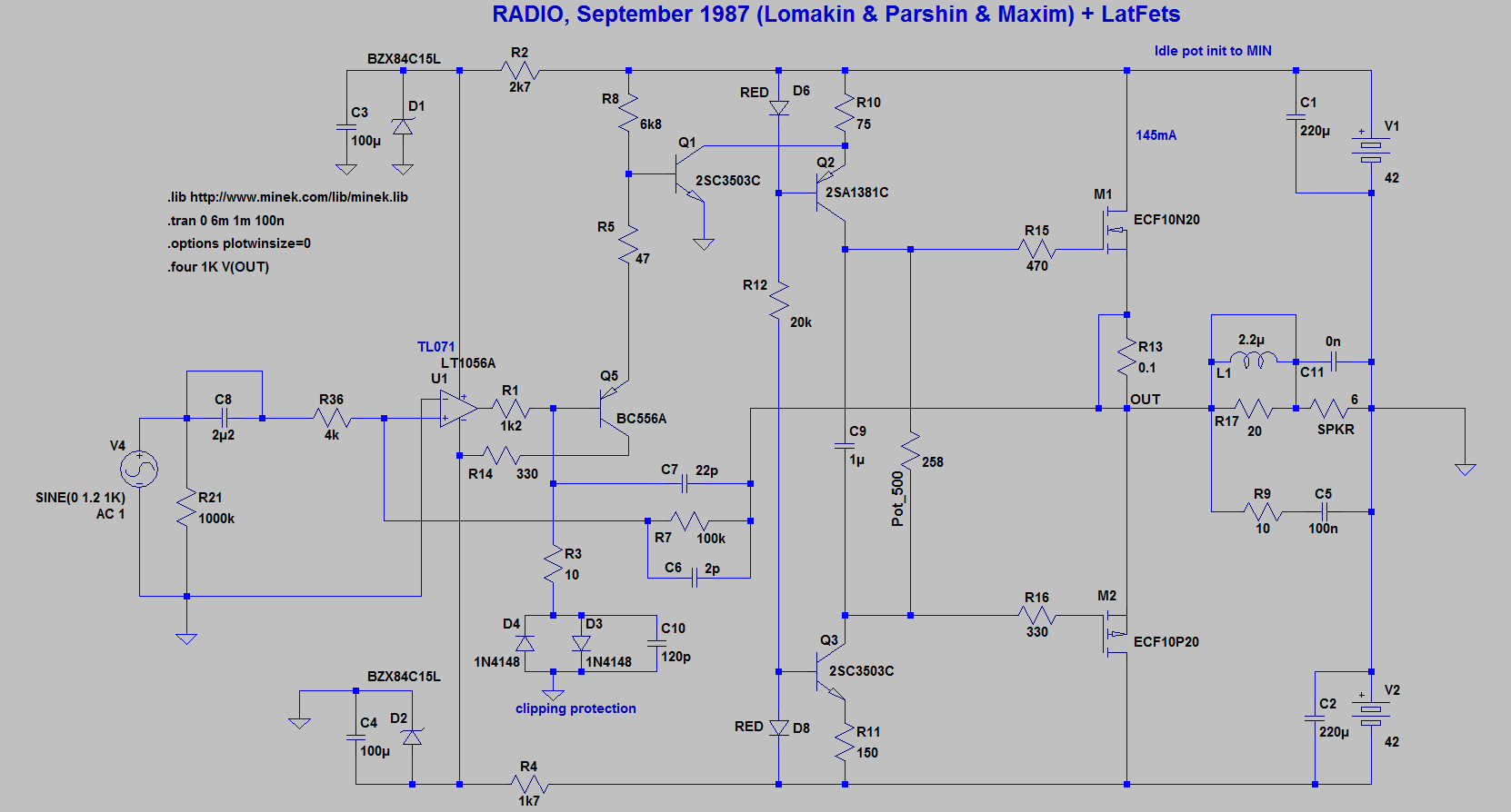

A curiosity: Wiederhold/Lomakin/Parshin derivative from 2016 with triple EF output, designed by T117
"If you want to build a really cool amp, that could sound better brand of amplifiers, you can build it for this schematics. This is a very simple amplifier, but there aren't many amps better than him.
1.The triple output stage is always needed, regardless of the type of VAS. This output stage has a high linearity. I do not offer a simple and bad decisions.
2. VAS contains 4 of the transistor. This is a very small number and this is the best solution how to get out of this small number of transistors is such good value of THD." - T117

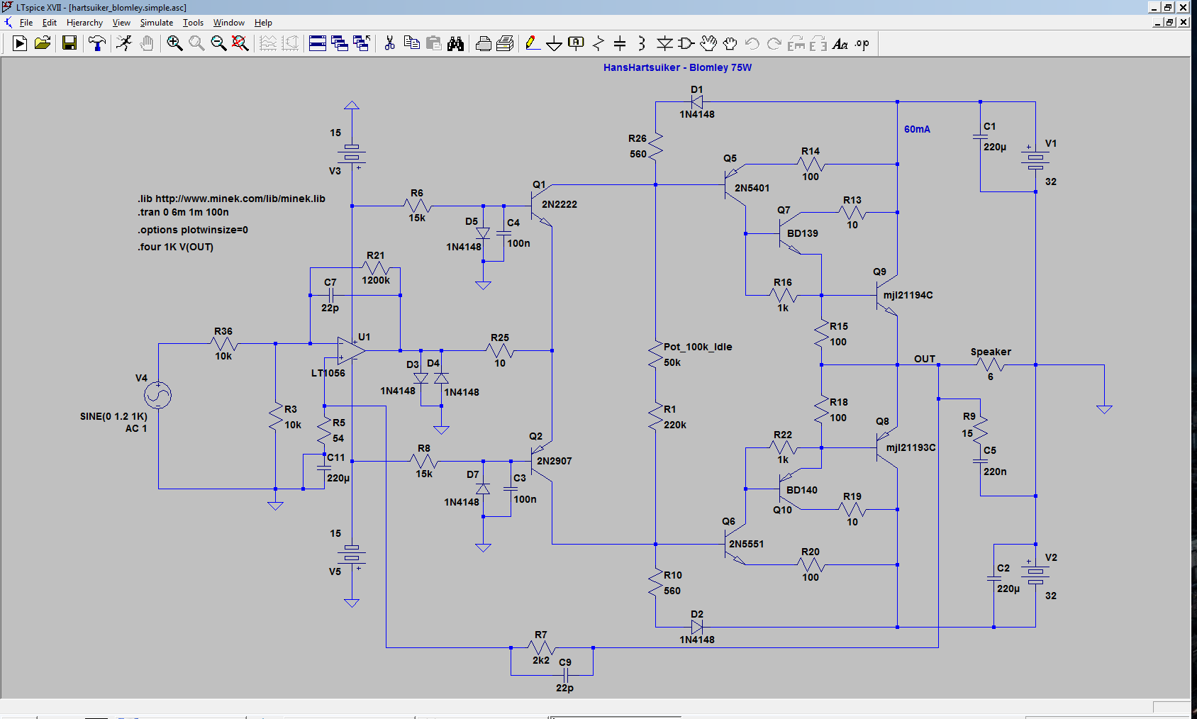

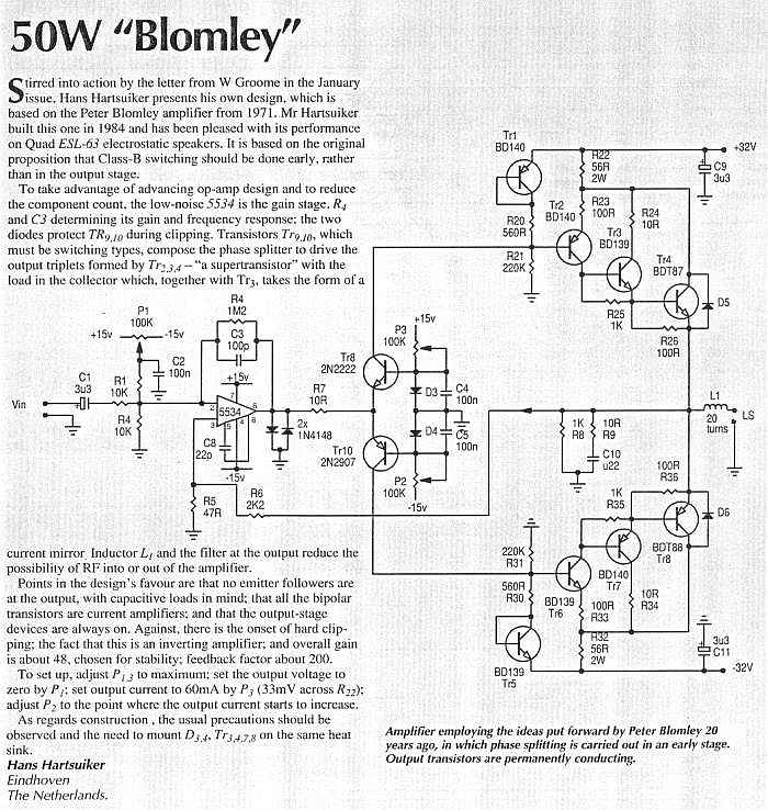

Can you make Blomley out of this triplet?
I don't have enough skills for that. Blomley has an unique non switching Class B sub-circuit (the first one in audio history?), maybe Elvee or Valery can answer your question. They have amount experiences in non-switching outputs.
Of #42 PM, part of scheme Q1, R19, R22, R23, R20, Q3 (Blomley).
Your scheme # 441, respectively Q8, R33, Q10
Bloomley Hartsuiker

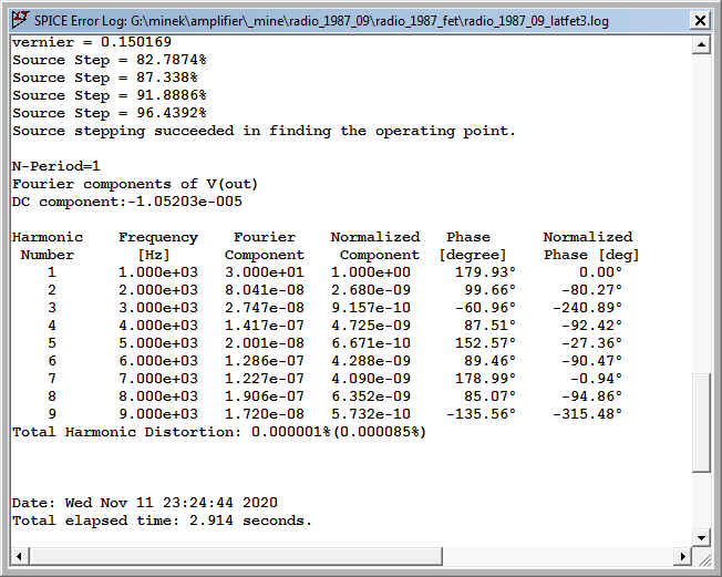

If anybody is interested in buildable Blomley, here is modified Hans Hartsuiker version,
slightly improved, that at least sims ok.
It has symmetrical rails - primary reason I gave up on 'regular' Blomley..
From what I remember Blomley was a good candidate to add servo to it to control output DC offset..

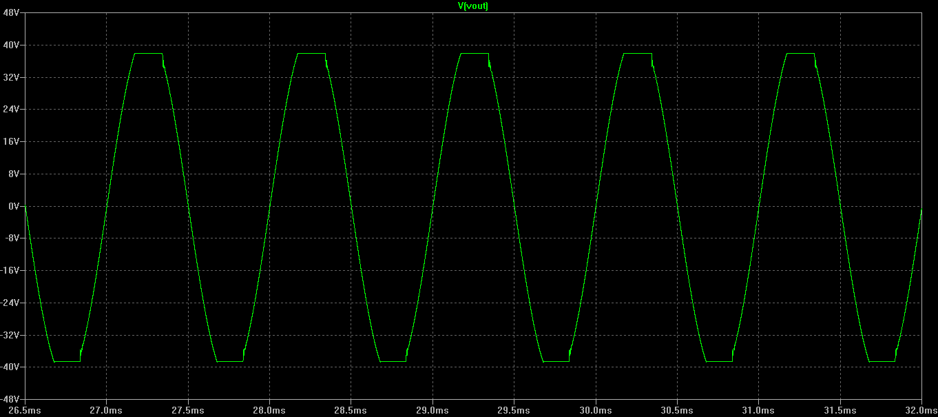

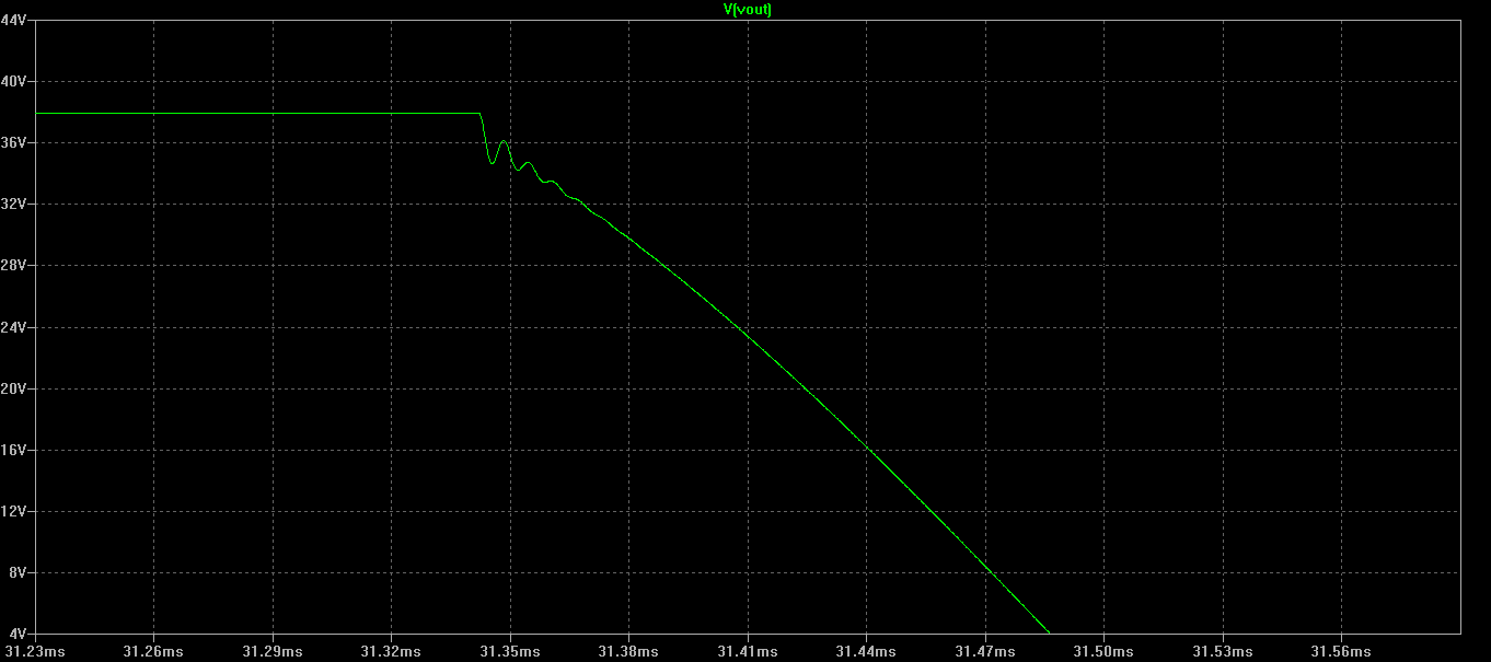

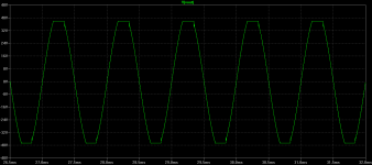

minek, thank you for the sims, but frankly, it is neither promising, nor appears to surpass Lomakin & Parshin/wiederhold.
A run-of-the-mill Blameless can stand 1uF across the load without a sweat. I think that work around this interesting circuit and make It able to do the same, worth the effort. I'm talking the Wiederhold hex quasi.

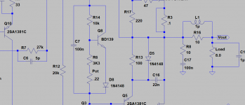

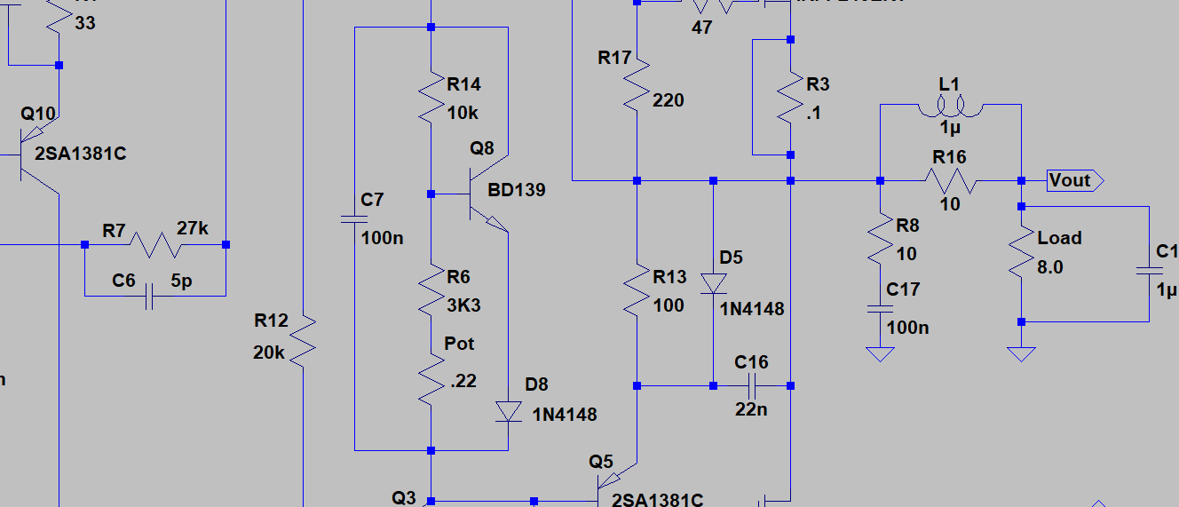

Put an RL filter on the output of the amplifier and you will not be afraid of the capacitive component
Also, even without LR, increasing values of C9/C12 (e.g. to 220pF) will improve response to capacitive loads.
C16 makes it worse. Without it, response to capacitive loads is also better.
In my build I don't have C16.
C16 is harmful. inductance 1i is small, put 2-4u. Well, the correction should be selected more precisely. The sound of this amplifier is incomparable with these simple amplifiers. Space
1uH is small? I usually put 1uH + 4.7 Ohm damping resistor.
I just checked Douglas Self's book - from his practical experience he is recommending 2.3 uH inductor.
2u-4 u.
Note the output filter in the SLA.
Page 9 in the attachment Сверхлинейный УМЗЧ с глубокой ООС.pdf - Google Drive
That corresponds to at least:
a) 20 turns of 1.0 mm wire on a diameter of AA battery (14 mm).
b) 30 turns of 1.6 mm (14 gauge in US) wire
The thicker the wire - more turns needed.
It's better to use thicker wire.
I'm going to use 4.7 Ohm damping resistor with this coil.
Yes, to be adjusted on the real object.Well, the correction should be selected more precisely.

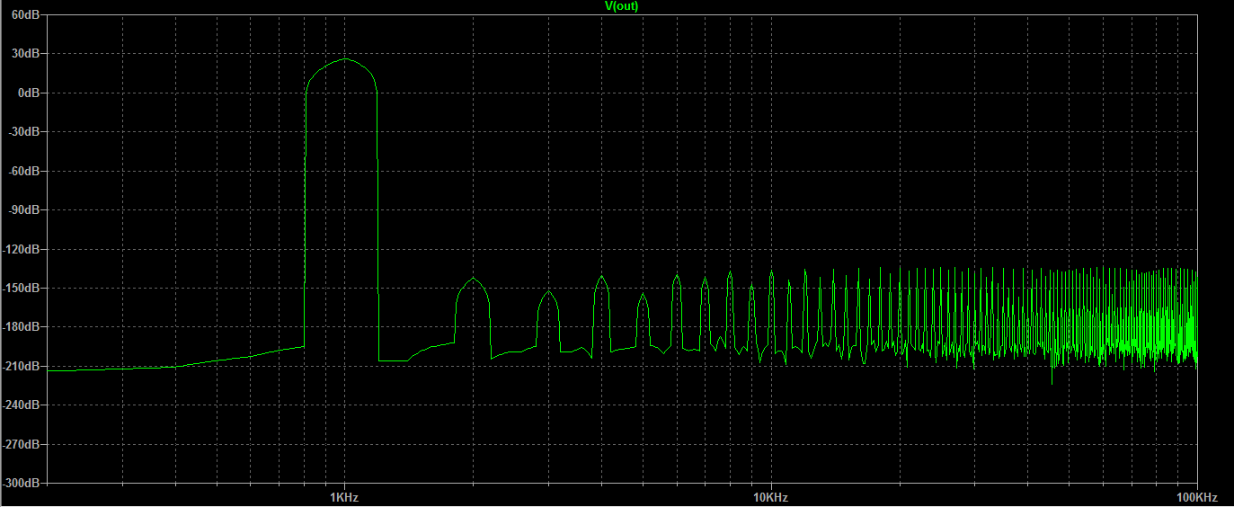

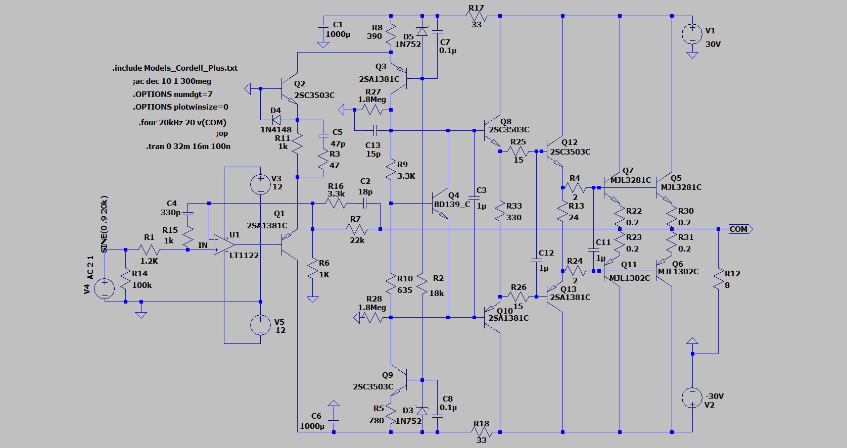

Here is LMK with few changes (2 resistors added around Q5).
FFT profile looks better.
Perhaps Maxim can tell if these changes make sense?
