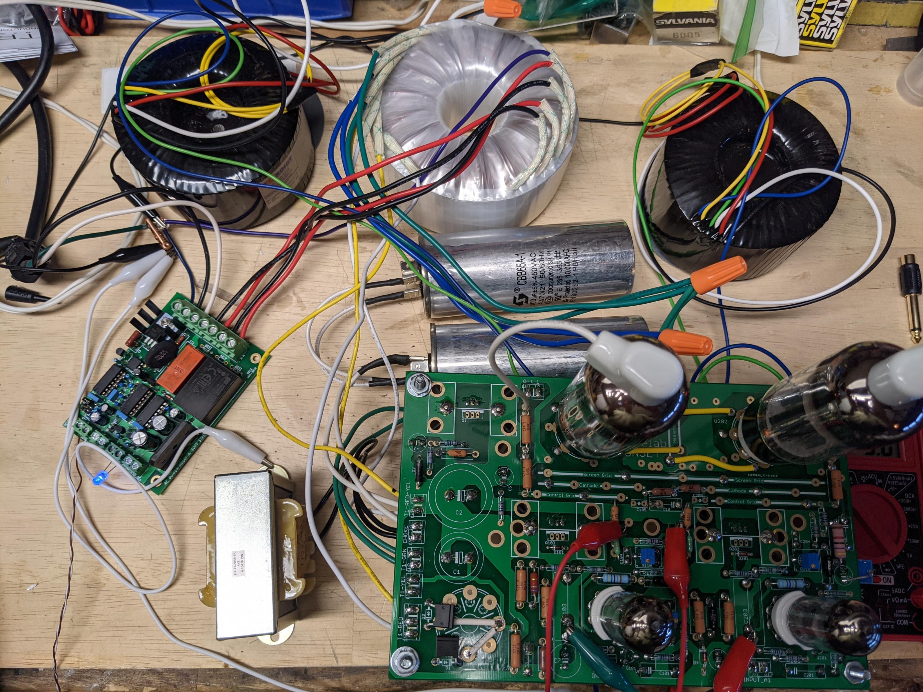

Pic of latest setup using 2 of the motor run caps and sounding good.

I decided to try some different driver tubes and replaced the 6J51Ps with a pair of 6KT6, a physically smaller tube but hopefully still up to the task. I plugged them in and let them cook for a bit at 70V plate voltage then brought them up to 125V and rechecked the bias at 80 mA for the output tubes.
First thing I noticed is they are much less microphonic than the 6J51P. Second setup like this with the 2 supplemental motor run caps with a total of 320uF of C2 the UNSET is sounding good with everything I throw at it. I was very much enjoying some punk rock with an aggressive rolling drum line, guitar, and screaming singer. After that some EDM followed by Blues and Soul.
