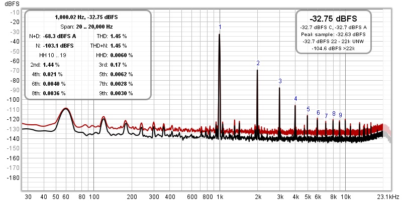

I did some testing with REW loaded on a laptop and using it's internal sound card for input. Test signal was from a 1kHz flac file played through a Chromecast audio into both channels and 8ohm dummy loads at the outputs. Volume was set to read 2.8V at the output. I don't yet trust the overall THD measurement as it read higher than expected on both amps I tried however it gives a FFT spectrum that looks reasonable and responded to changes.
What I found is that lowering the plate voltage of the driver tubes reduced overall THD but this reduction was almost all from the 2nd harmonic. Basically the pot functioned as an H2 adjuster. Set at 125V where I have been running them so far the profile is H2 dominant as you would expect.
Current though the driver tubes was slightly higher with the 6J51P than with the 6KT6 and would also increase with lower plate voltage but these are not big changes.

What I found is that lowering the plate voltage of the driver tubes reduced overall THD but this reduction was almost all from the 2nd harmonic. Basically the pot functioned as an H2 adjuster. Set at 125V where I have been running them so far the profile is H2 dominant as you would.
Good progress with REW!
Do I understand the above quote correctly? When you say “lowering the plate voltage of the driver tube” you are not reducing the supply voltage, but instead are trimming R104 to change the bias on Q101. When you decrease the Q101 bias the V101 tube conducts more current and therefore lowering the plate voltage due to a bigger drop across the load resistor R108. Did I get this right?
Here is the REW plot I am getting at 1W
The mains noise that is shown in the REW plot is audible. I have been trying to cleanup the grounding but can still hear a buzz through the speakers. Right now I have a ground from each opt speaker outputs, one from left input to pcb, toroidal ps shield, and mains earth all meeting at one point using clip leads. Any advice on what to try next?

The mains noise that is shown in the REW plot is audible. I have been trying to cleanup the grounding but can still hear a buzz through the speakers..... Any advice on what to try next?
Your spectral plot shows considerable 60 Hz with lots of harmonics. This would indicate that the hum could be originating in the power supply.
Some more info could be obtained by performing a few simple tests.
Fire up the board so that you can get the same plot.
Disconnect the input wiring from the board. Obviously there will be no 1 KHz tone, but do the 60 Hz and it's harmonics remain present, and at the same level.
If so, power down, remove the driver tubes and repeat the test. If the hum remains with only the output section alive, then there must be some ripple on the supply, or other means of hum coupling.

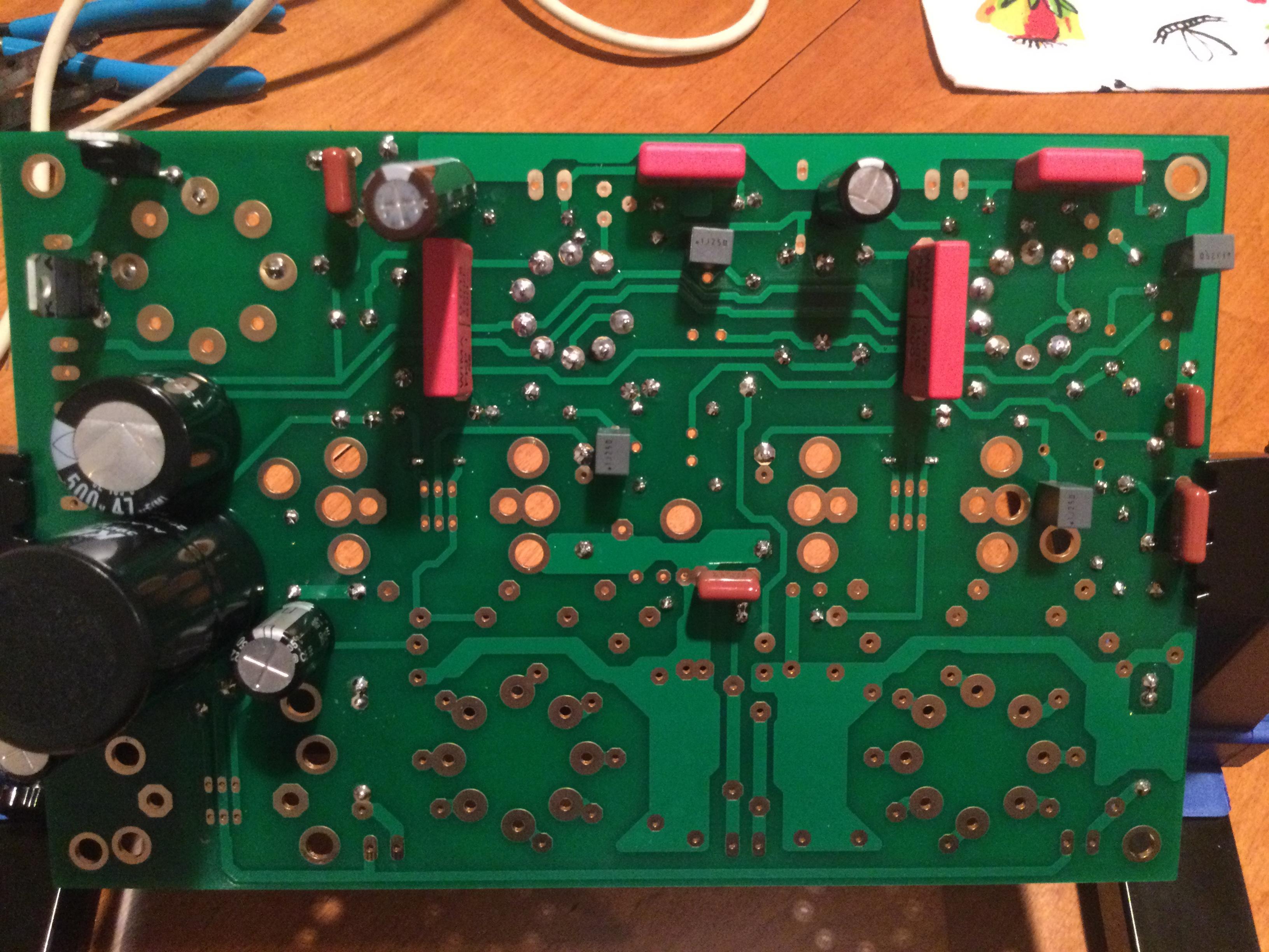

I would like to report my progress after orders arrived. Would like some feedback if any, and I present it for the information of present and future builders.
Photos are of my build as of this afternoon. Most resistors and capacitors on the PCB are soldered now. Next I have to do the semis/heatsinks and wiring. I am planning to use 6EJ7 and 6DQ5 tubes, with about 425 Vdc at the B+ supply, employing Toroidy output transformers (TTG-KT88SE ) with Za-a of 3k ohms.

George, my feedback for future UNSET boards, based on my initial experience with the Beta boards:
1. For this (and future) UNSET boards, I expect very few tube rectifiers will be used (versus SS rectifiers) due to the high currents required by the TV sweep tubes, especially at higher power than your “common 300B SE amp”, the rai·son d'ê·tre for the UNSET. Why have an on-board tube rectifier? I’m using 1200 V SIC (STPSC2H12D STMicroelectronics | Mouser) rectifiers and I plan to report on how that goes. But the question is, why have the rectifier socket on board if it is not used?
2. This PCB has the power tube sockets built in (I think the original reason for this with Tubelabs was ease of supporting various levels of builders), but it still requires the builder to select, and mix and match all the inputs to the power tubes. Why have the power tubes on board if it would allow much more flexibility when off-board, and about the same “confusion factor”?
3. Same for input tubes.
