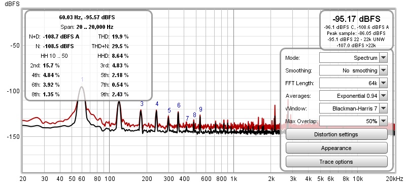

Some more info could be obtained by performing a few simple tests.
Fire up the board so that you can get the same plot.
Disconnect the input wiring from the board. Obviously there will be no 1 KHz tone, but do the 60 Hz and it's harmonics remain present, and at the same level.
If so, power down, remove the driver tubes and repeat the test. If the hum remains with only the output section alive, then there must be some ripple on the supply, or other means of hum coupling...

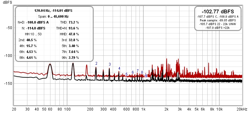

With the inputs shorted I still see the same level of 60 Hz (first attachment). If I remove the driver tubes it is less (second attachment).
I wonder of the traces for the heaters of the driver tubes induce the 60hz. Could you try a DC supply for the front tubes?
Hooked up an old 9VDC wall wart to an ebay adjustable regulator and dialed in 6.3V. With this feeding the driver tube heaters the 60Hz noise sits about -110dB so an improvement of 10dB. I'll give it a few more tests and a listen tomorrow.
Good news. Interesting progress. I assume that was with a driver tube installed. What happened to the 60hz without a driver tube, when you had the heater DC connected to the board?
Let us know how you listening and testing go.
To be clear only the driver tubes have the heaters hooked up to DC, output tubes are still hooked to AC. With the driver tubes pulled the results are the same. Attached are the measurements with the driver tubes in hooked to DC and input disconnected.

I’m back from my vacation and reviewed my previous work. Noticed that I forgot to solder in the pico fuses in the cathodes of the power tubes. Will fix that before finishing my Beta boards.
@spiggs, I wondered how your listening went, and if the hum abatement efforts were satisfactory.

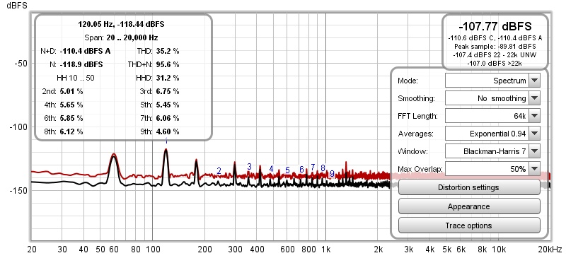

I am happy with how quiet the amp is now. I cannot hear anything through the speakers with my ear right up next to them. I am putting together one of Pete Millett's filament supply boards to run the driver tube heaters to replace the
wallwart and ebay regulator I have hooked up now.
My overall listening impressions are good. I brought the UNSET in and hooked it up to my main speakers in place of my triode wired EL34 SSE. I liked what I heard and think the effort to get this in a nice case will be well worth it. More punch and dynamics with the same SE sound.
Having said that I would like to figure out why my build does not seem to meet spec. REW consistently shows about 1.2% THD at 1W and hits 5% THD at ~9W. Since this is my first use of REW I am not 100% confident in the readings but on my Modulus 86 amp I do measure much lower distortion so it seems the setup is capable of lower readings. I can get the THD slightly lower by playing with the bias but nothing dramatic. I will be very interested to see how other UNSETs measure.

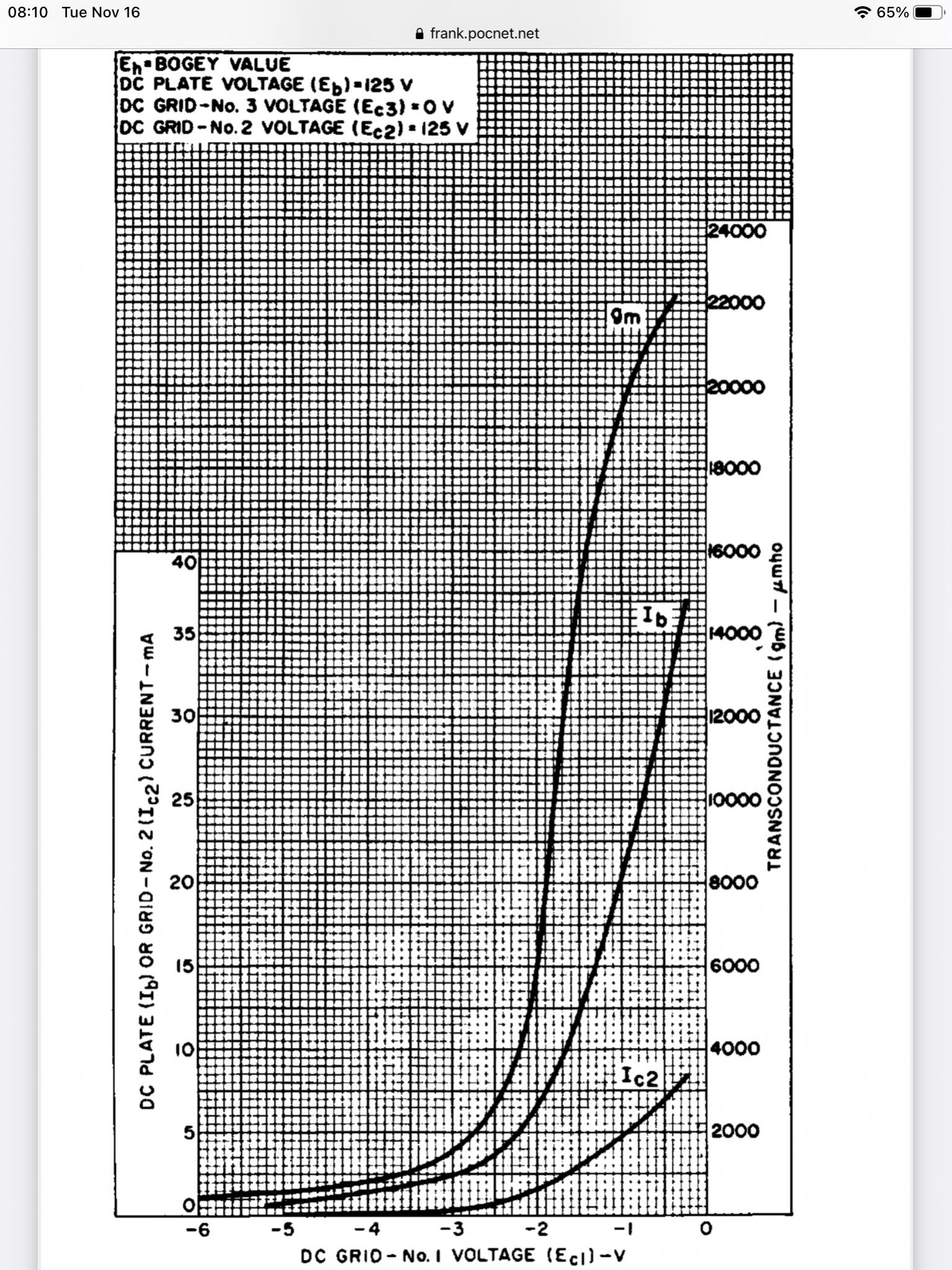

The distortion performance of your UNSET is concerning! One would expect that the SE UNSET would show much more distortion than a good Modulus 86, but 5% at 9 watts is disappointing. What could be the cause? Drivers?
Your REW measurement was with 6KT6 and 6DQ5 tubes, right? IIRC your 6KT6 plate current was 2.5 ma, plate voltage 125Vdc, but don’t recall the screen voltage. Do you have any 12GN7’s to try. IIRC George achieved his “good” distortion measurements with that driver.
I’m not familiar with the 6KT6 tube and looked up it’s datasheet. See the “characteristic performance” graph attached below, with plate and screen voltage both at 125V. It appears that at 2.5 ma plate current the 6KT6 is in an undefined (unlinear?) region of operation. But if this low plate current of the 6KT6 (with 3 watt max plate dissipation) present a problem, the problem could be worse using 12GN7 a much “bigger” tube with 11 watt dissipation. Of course we don’t know what George’s 12GN7 plate current was running.
