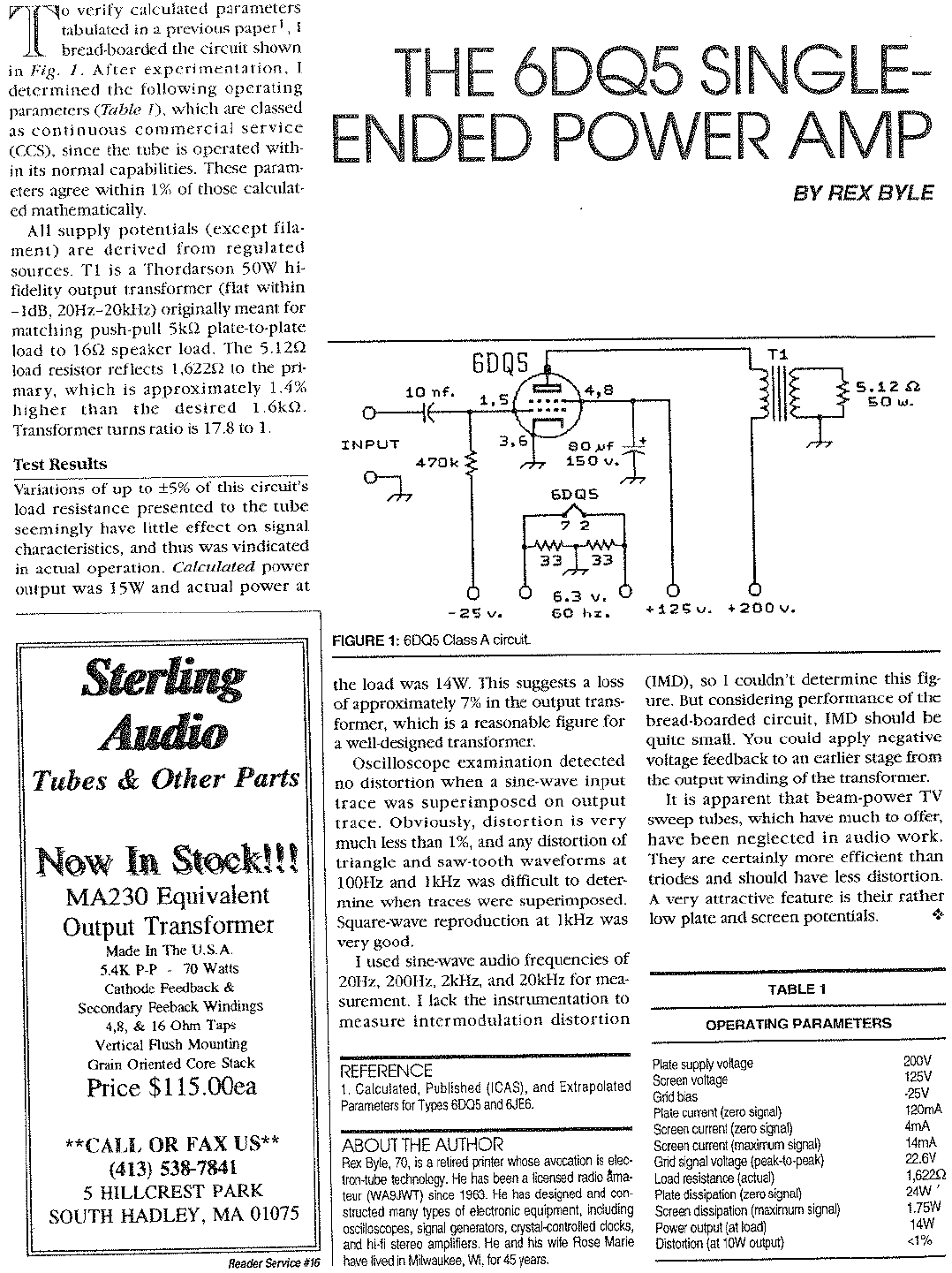

I revisited an old Glass Audio article on a “conventional” SE 6DQ5 implementation, and the author claimed “much less than 1% distortion”, and 14 watts output at 24 watt plate dissipation. The operating conditions and loading are interesting. See the attachment.
The author describes the OPT in that article as a push pull transformer - i.e. no air gap, and the output power and distortion claims look dubious to impossible to me. I'm not sure how you eyeball less than 1% distortion from a scope trace.
Maybe I'm just tired and misread it - it's pretty late here.
That article smelled funny so I did some simple stupid math. The B+ voltage is 200 volts. The load impedance is 1622 ohms. Lets just say that the author has a theoretically perfect tube that can put all of the power supply power into the OPT, and the OPT is also theoretically perfect. If the tube were to fully conduct, there would be zero volts on the plate, so the plate end of the OPT is at zero volts. On the next half cycle the tube is fully off (non conducting). Our perfect OPT will "fly" the plate end up to 400 volts. This puts the MAXIMUM Peak to Peak voltage across the OPT at 400 volts. 400 Volts P-P is about 142 volts RMS. 142 volts RMS across 1622 ohms is 12.43 watts, so I call BS on the entire article! In reality he was probably in the 10 watt range if it even worked at all.
The OPT was intended for a push pull amp. My experiments have taught me
that I might get 2 or 3 watts in SE through a P-P OPT that's rated for 80 watts. That was running a 6V6GT on 30 mA. Attempting to get 15 watts from a 6DQ5 is going to take a lot of current on a 200 volt supply, but we already know that it is impossible. My 1500 ohm OPT graphs start at 300 volts and I still didn't get 15 watts.
