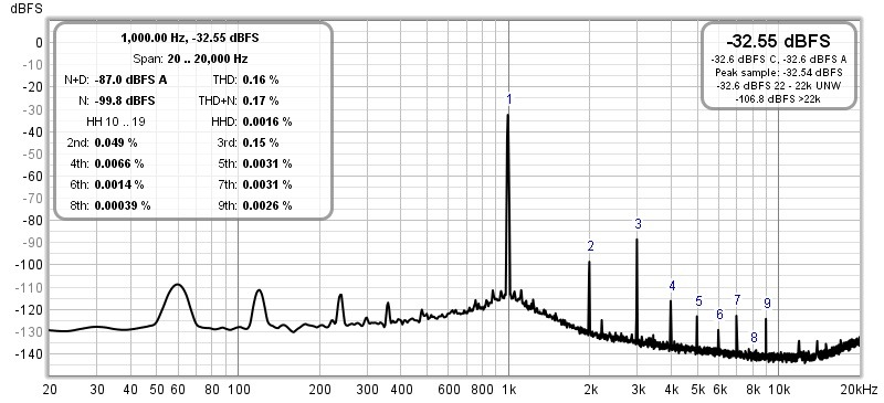

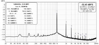

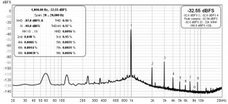

Attached are the FFT graphs of the current setup with the amp adjusted for 0.65% THD at 1W. This is where it sounds best to me even though I can adjust the THD lower. This also shows where the noise floor is with the SMPS driving the heaters and a regulated B+ but of course no case. The second graph is THD at about 12W output.
I agree that 1% at 1 watt is too high, and I have measured far better than that in my amp.I hope we could figure this out as well as the ~1% distortion at 1 watt. The UNSET could not be called a Hifi amp with those distortion figures at 1 watt.
Remember that we are attempting to replicate a SET amp with a TV sweep tube. The typical SET rarely does much better than this. A typical 300B amp may get 9 or 10 watts from 34 watts of dissipation. A TV sweep tube run in triode mode is restricted to a low plate voltage due to its low screen voltage spec. A TV sweep tube can be run in SE pentode mode and cleaned up with feedback, but the curves don't start looking very linear until the dissipation is near or into the red plate region for class A operation. The UNSET attempts to dance around these limitations. Again, more than the 40% seen here should be attainable.0.5% at 1 watt and 13.7 watts at 5% look better. But your 6DQ5 is dissipating 34 watts! Not the efficiency expected from UNSET topology.
Your experience is what drives the whole SET trend. Many SE users prefer a bit of 2H over a perfectly clean signal. The amount of 2H preferred depends on the user and the makeup of the harmonic profile. A bit of 3H, which is musically related to the fundamental can also be tolerated and provides "brightness" on loud notes. The 5th harmonic is dissonant as are all higher odd order harmonics. Even at low levels they cause listener fatigue, as does any IMD.I can adjust THD at 1W from anywhere between 0.3% - 1.2% or more using the pots but to me it sounds best with it adjusted in the 0.6 - 0.7% range and this corresponds to a H2 dominant FFT, 5% THD is around 13W.

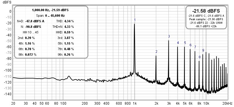

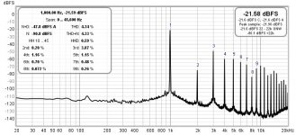

One other interesting thing I noticed when testing the amp. The UNSET spends most of its output at least slightly 2H dominant but there are two crossover points. 3H becomes dominant at 4-5W of output but drops down under 2H again then rises to becomes dominant again around 10W. Total distortion follows a similar pattern with a small peak around the 4-5W mark.
One more test for the evening. Ran a 30hZ tone to see what it has for low end. 1% THD at 1W and 5% THD comes at just a little over 9W.
