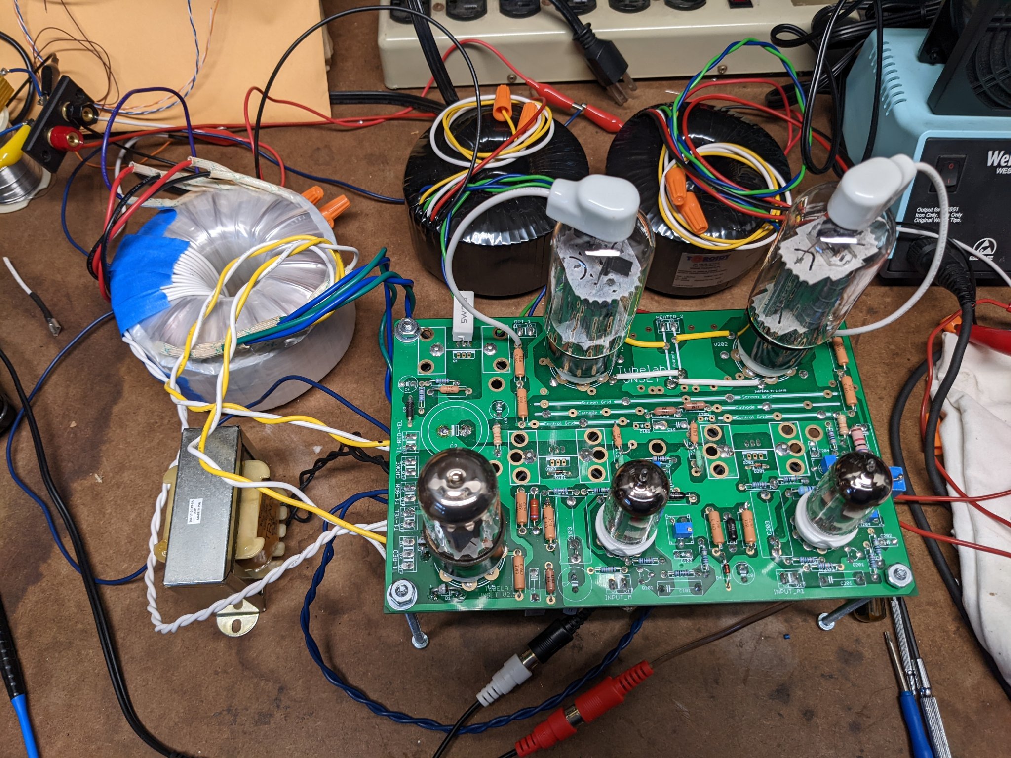

I decided to try out a tube rectifier with the 6DQ5s in combination with 6J51P drivers since I have a bunch of these and they are supposed to be a 6EJ7 equivalent. Really I had all the parts on hand so all it took was a little time at the bench. I am using a Antek AS-3T275 for power. These don't come with a 5V tap for the rectifier tube so I used some 18g wire to add one, it took about 15 turns to hit just a smidge over 5V under load. You can see my bodge under the blue tape, I'll use some good electrical tape to wrap it if I decide it should be permanent. B+ ended up at 340V. With these driver tubes changing the values of R108 and 208 did not seem to do much of anything, lowest value I could get away with was 125k but I just left it at 150k. Dropping the value for R7 did make an improvement. Overall 1W has 0.75% THD and 5% THD is at 10W. No listening yet.
I wanted to listen to the UNSET with the 6DQ5, 6J51P, and tube rectifier but was too lazy to unhook the 26HU5 version and drag the speakers over to the other bench so I decided to try some headphones. Also if this were to replace my office amp it would would be optimal if it could do headphone duty as well as speakers. I had built a little headphone adapter for my SSE using an 8 ohm resistor across the speaker terminals and a couple of 120 ohm resistors in series to the headphone jack so I hooked that up. First thing I was reminded of is that a number of these 6J51P tubes I have tried have been a bit microphonic. One of the driver tubes gave just a hint of microphonics as background noise but it would settle down once I stopped fiddling with the setup. I have about 30 of these tubes so eventually I will sort through and set aside all the good sets for future use. Pity about world events and of course this is the least of it but these are old Soviet era tubes I purchased through a seller in the Ukraine for $1 each. In my testing they have been at least as good as the 6EJ7 tubes I have but I imagine they will not return to the market for a very long time if ever.
The UNSET sounded good through headphones. Besides the bit of microphonics the background was quiet and the music clear and dynamic. The sweet spot to my ears ended up being 100mA dialed in with the pots for the output bias and 100V dialed in to the plates of the driver tubes. Easy to remember.
One thing I would like to try is a little less B+. From testing with the adjustable regulator I always seemed to land on 325V B+ with the 6DQ5 tubes as the best setup. 340V isn't far off but is there an easy way to drop another 15V of B+ easily?
