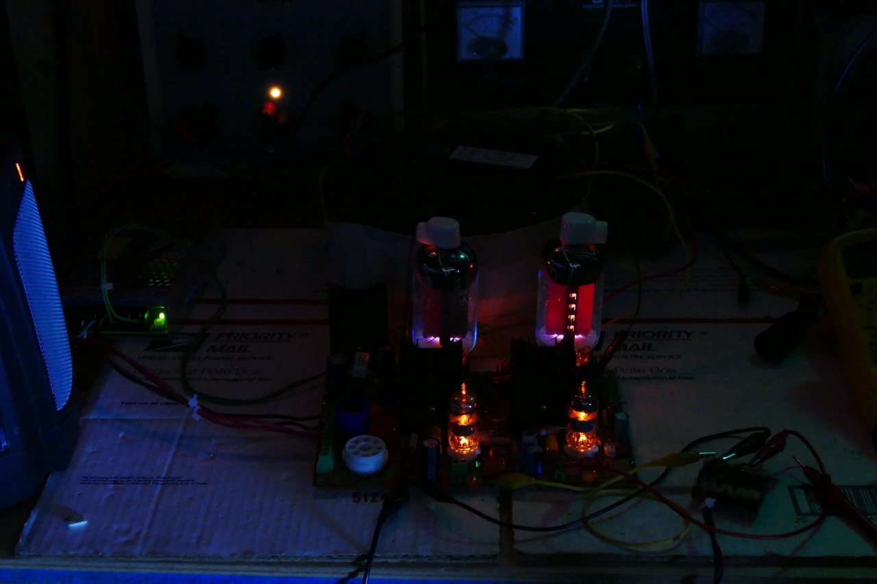

Unfortunately, little has been done in the lab for some time. Today will be spent shoveling snow and ice or doing taxes. As of yesterday morning about a third of this county had no power, many roads were impassable due to ice, and snow continued to fall all day yesterday. Church service for this morning was cancelled yesterday due to lack of power and an ice covered parking lot. At least the sun is shining, and the temperature is expected to rise above freezing for the first time in 5 days. It's 14 degrees F (-10C) right now though.

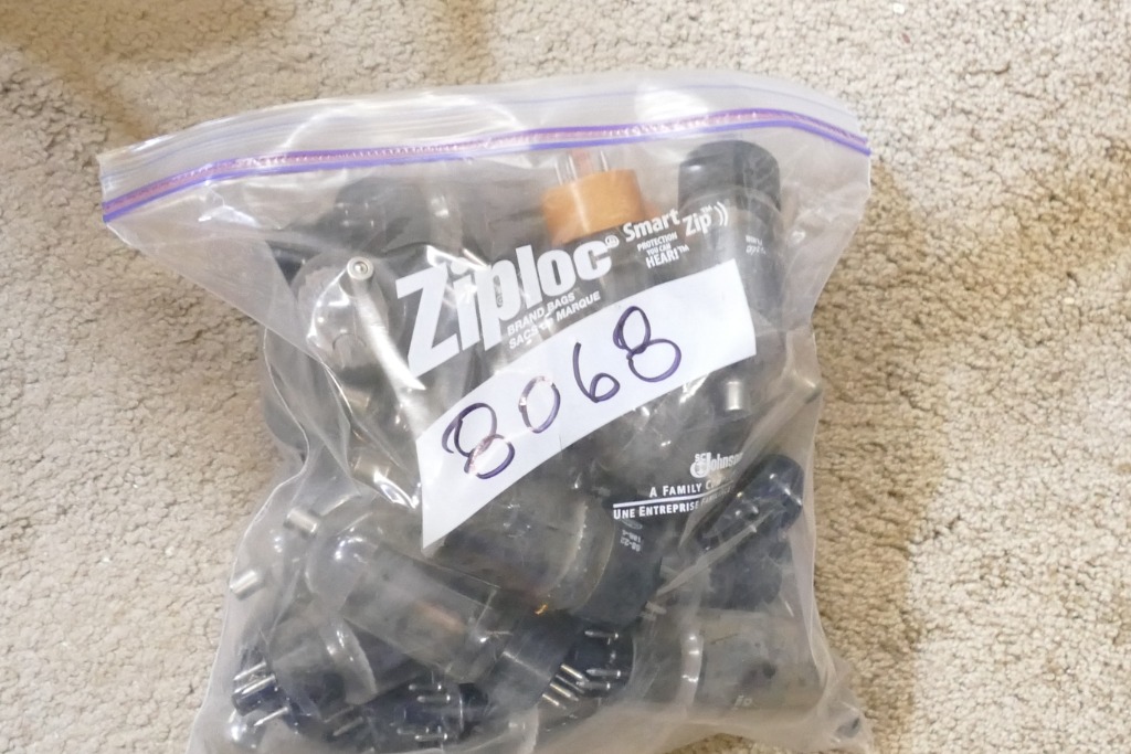

I'm extremely interested to see where your experiments lead. And I'm also comforted to see I'm not the only one who squirrels away tubes in Ziploc bags.
When you are given over 100,000 tubes for free you use just about anything to store them. I had three 55 gallon drums full, lots of boxes, and bags and some plastic totes, all stuffed with tubes. At one time I had three 10 X 20 foot warehouse bays full of tubes. It took about 6 years to sort, then sell, trade, give away, and even trash some of them. I'm down to about 5,000 now (best guess) after moving everything 1200 miles.
I had to chuckle a little bit because my situation was similar but on a much, much smaller scale. People have been giving me tubes for 20 years now, and I've accumulated two or three thousand myself.
Two weeks ago I went into the basement to retrieve some tubes out of my stash, only to discover several of the plastic tubs partially filled with water. That area flooded during a thunderstorm late last year and apparently those containers (they were the ones with the hinged flaps for lids) were right beneath the "waterfall". You can imagine the mess - I've been drying and re-sorting tubes ever since. Oddly, they don't seem any worse for wear; all the ones I've tested several in circuits so far seem to be fine. Apparently I rescued them before pin corrosion became a problem.
I just never realized how many 6AL5s, 6AU6s, and 12AU7s I really had! Geez...

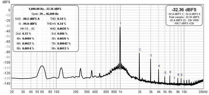

I just completed another UNSET pcb build this time wired for 26HU5 tubes. Changes from the BOM include
R113/R213 33K
R108/R208 100K
B+ is 350V
110mA on the output tubes (~30 watts calculated)
Driver tubes are the same 12GH7A I have been using and of course a pair of 26HU5s for the output. I am seeing 0.35% THD at 1W and 14.5W at 5% THD.

I have not had a chance to do an extended listening session with the 26HU5s but the 0.35% THD was measured with a 2H dominant harmonic profile very similar to my preferred profile when using the 6DQ5s. Like with the 6DQ5 I can adjust it lower. First listening impressions are good but I'll really pump some music through it this weekend and see.

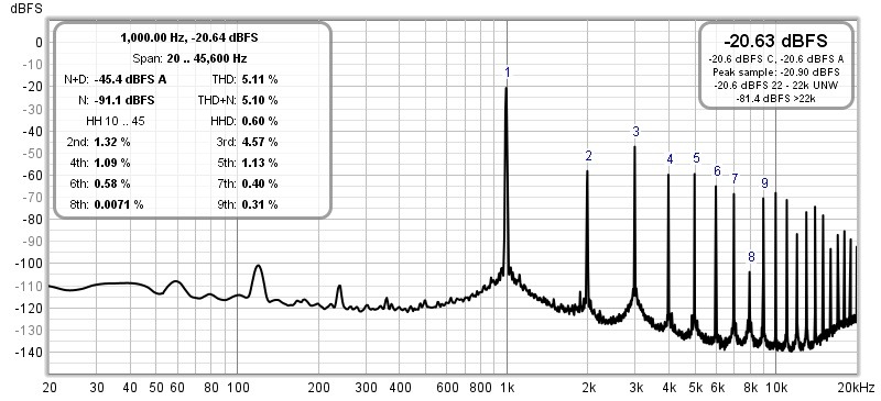

Attached are graphs of my 26HU5 UNSET at 1W 0.34% THD and just a bit over 5% at 14.5W. Gave it a good listen this weekend and it sounds much like the 6DQ5 setup which is good. I also decided to measure my SSE for comparison. The SSE is setup in triode mode with EL34 tubes. At 1W it had 1.8% THD and 5% came at 5W. Heavily 2H dominant all the way up to 5W. What does the TSE measure like with a 300b?

I have not measured a TSE or TSE-II with a 300B in many years. Much of my experimentation with the TSE-II was done with the 2A3 as this is one of the hardest tubes to tame in many amps, and all my 300b's are 15+ year old Sovteks or Shuguang's. Most of my experiments were done well above the published ratings too. Who runs a 2A3 on 375 volts at 80 mA? My 15 year old Shuguang's see no signs of distress at this level and have been in the amp for nearly two years.
I found that the OPT and the idle current will make a huge difference in the amount of 3rd harmonic being produced several years ago. It is possible to drop the 3H down into the noise with some OPT's (notably the $29 Edcor) at 1 KHz just by playing with the bias current. I saw near zero 3H at about 80 mA with the small Edcor at 1KHz. This vanished as the frequency was changed. I have seen the 3H "null" in some other OPT's but not to this level. Either it doesn't exist in the large Edcors, or I haven't found it. Listening tests don't show much change as I ran a 300B from 70 to 90 mA through the little Edcors since we don't tend to listen to 1 KHz sine waves, and real speakers are not 8 ohm resistors.

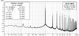

Thanks again for your informative posts and experimentations. Your 4.6% result on third harmonics at 14.5 watts got me thinking again about the driver current.
Why would that be, I’m wondering. I don’t know much about how higher order distortion is increased at increased power, but does it have anything to do with running the drivers at near starvation plate currents in the BETA UNSET?
