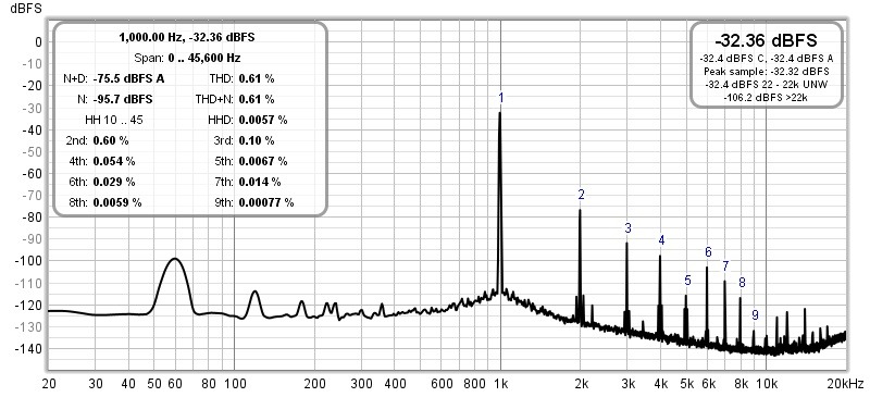

When running tests I noticed that THD would always go down at any output level when I turned up the bias on the output tubes. I was wondering if more current at a lower voltage would give better results so I added a regulator in place of the choke and did some testing at lower voltages. After spinning the pots around I landed on 325V B+, 85V across the driver plates, and 92mA (23watts calculated) on the output tubes. Attached is the FFT plot at 1W and 0.61% THD. 5% THD comes at 11.5 watts. A better result I think.

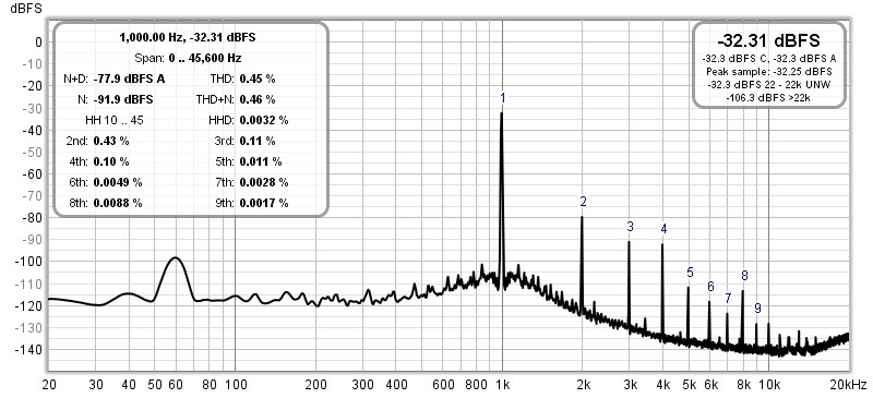

More testing. I wanted to try some different driver tubes with the KT88PSE OPTs so plugged in a pair of 12GN7As. Using the 8 ohm taps at 8 ohm for 1.5K results were better but still poorer than any other setup. I then connected the 4 ohm taps to 8 ohm for a 3K load. Best results so far. In this config the driver tubes wanted more volts across the plate for lowest distortion. Interestingly 2 different ranges gave acceptable distortion at 1W, ~110V and ~160V. I went with 110V since this had the 2nd harmonic dominant while at 160V the 3rd was dominant at 1W. Now getting 0.45% THD at 1W and 5% at 13W. Think I will do some subjective testing and give this a listen for a while. This is with B+ at 325V and output tube bias 93mA.

I ended up settling on a calculated value of 92K for R108/208 by paralleling 2 470K resistors with the 150K in place. Setup like this THD is 0.55% at 1W and 5% THD comes at 13W. Still using 12GN7A driver tubes and 6DQ5 outputs biased for a dissipation of around 22W. This is the best result I have had with the KT88SE OPTs.

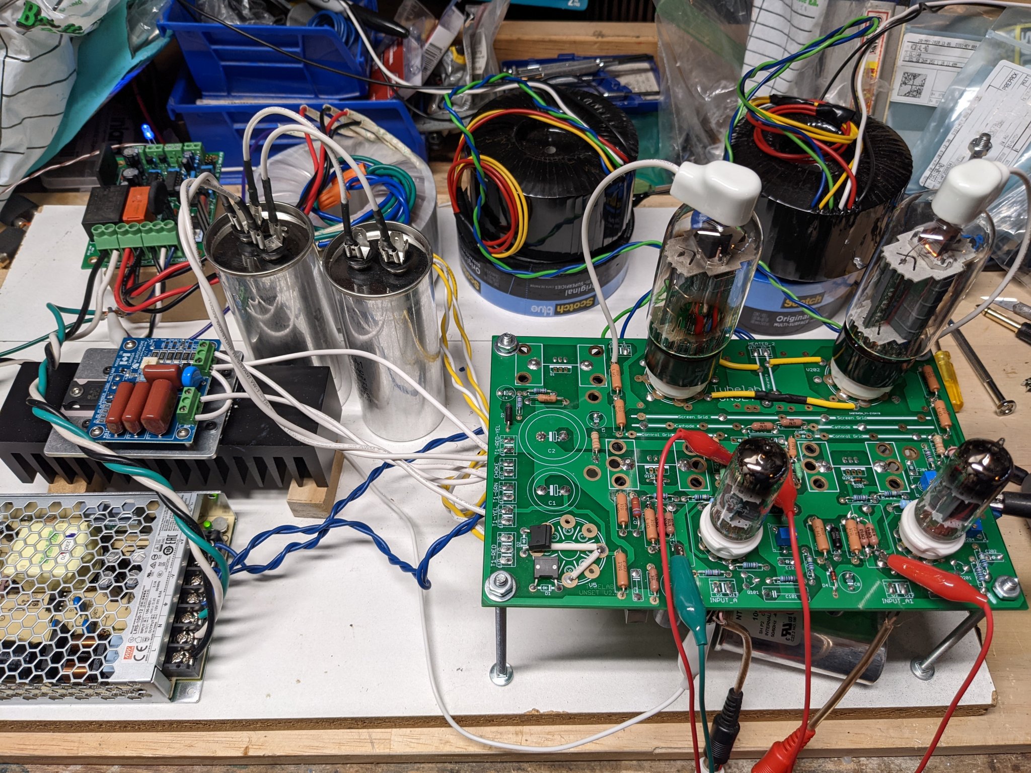

Spent the afternoon in the garage with the UNSET cranked up. Sounding toe tapping good in it's current config 🙂

Well I managed to blow it up. I was testing different 6DQ5 output tubes to see what kind of variation I saw in THD between different constructions (~.1% THD at 1W) and suspect I plugged a tube in wrong. Fired up the amp, heaters on the output tubes did not glow, then saw smoke coming from Q1. Shut it down, pulled tubes and made sure they were in right, heaters now glow but bias adjustments not coming back in line and no sound. Bummer, well it looks like Mouser still has a few IXTP3N100D2 in stock, hopefully that's the only part that went.
