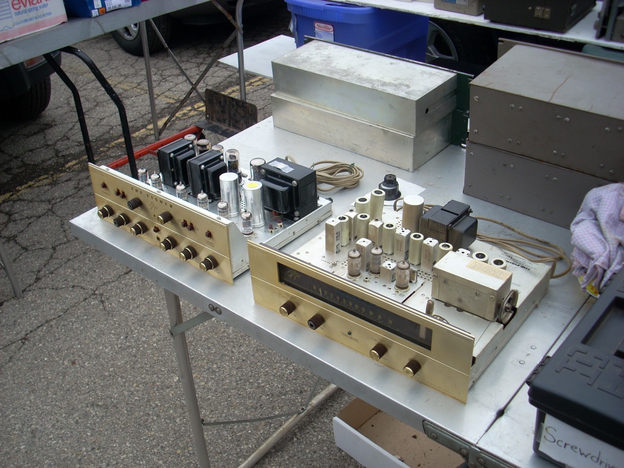

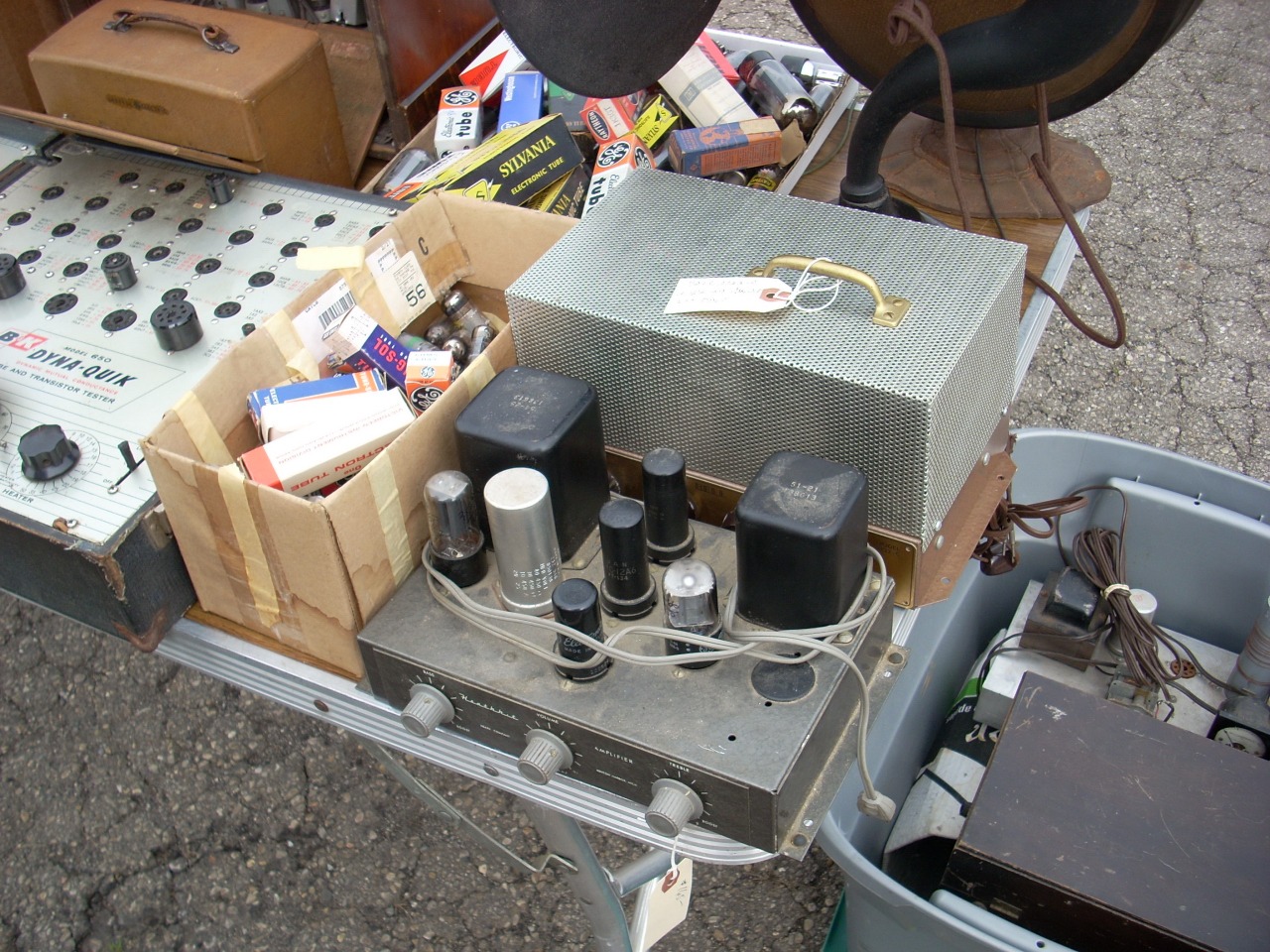

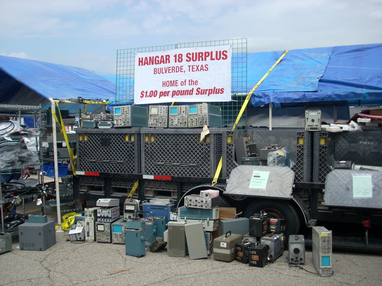

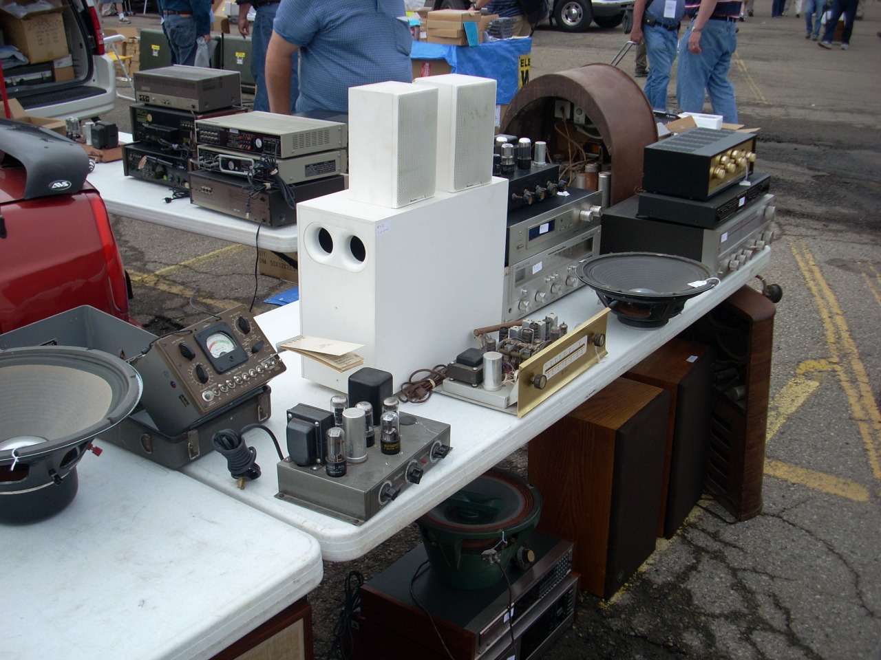

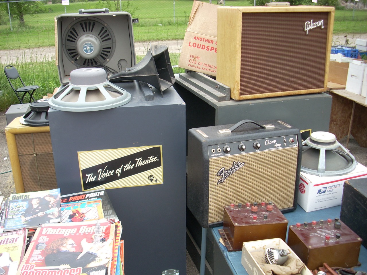

There are lots of strange sights at hamfests. The strangeness is somewhat different from say a computer show. The pictures show a few of them. Miss AntennaHead was a common fixture for several years. I can be found walking in the other direction on the left side of that picture. Someone is likely to be pickin something somewhere. You might even run into a NASA astronaut. Audio stuff in all sizes. Fishers come in two flavors, old and older. Speakers come in multiple sizes including large, and extra large. Sometimes things are cheaper by the truckload. Test equipment for $1 per pound.
I got a Mackie 32 channel mixing board with flight case for $75 at that show, and of course lots of tubes.

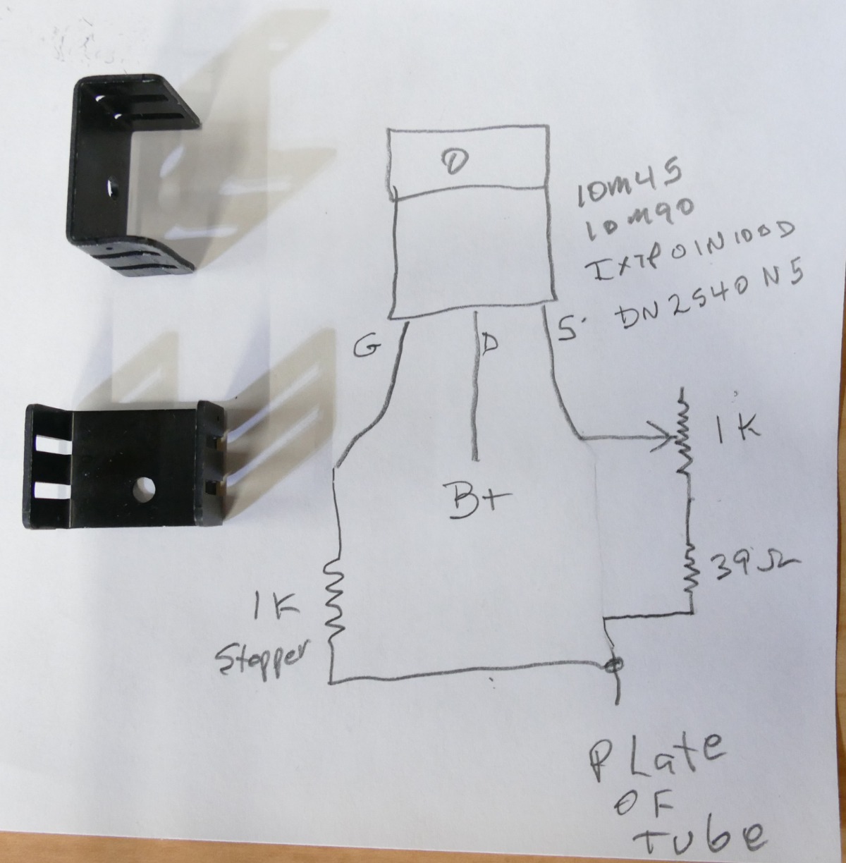

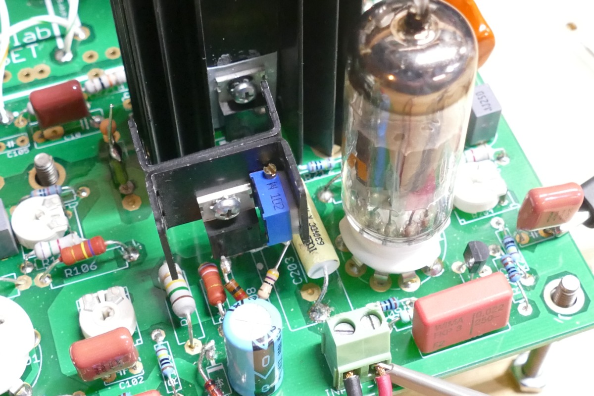

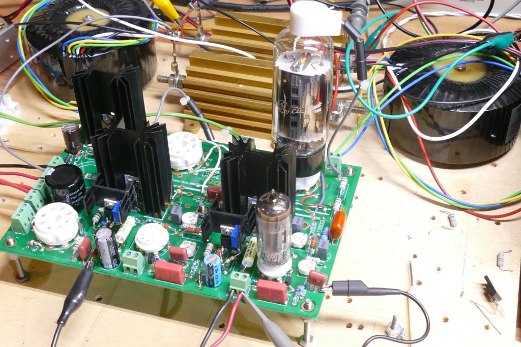

How would you implement a CCS in the UNSET for use with the driver tubes? Does the circuit just replace the plate load resister R108/208? Could I use something like this CCS pcb to experiment with? Should the resistors in the CCS circuit also be rated for 3W?I have been playing with LT spice simulations to find a happy spot for the UNSET input tube with a CCS chip or mosfet based CCS for the plate load as used in the SSE and TSE boards. This allows for a higher tube current and plate voltage.
It looks like the board you referenced will work fine, but I didn't look too deep into it. The circuit is simple, so I just sky wired it. Schematic enclosed. I'll be leaving for church soon and have a Nerf gun war with the grandkids and their video game playing friends scheduled for the afternoon. My board is up on a shelf, but I'll try to get a picture of the CCS circuit this evening. The CCS chip needs to be heat sinked since it will eat a watt or two. I used a pair of the little guys shown in the picture placed back to back. I didn't use an insulator since I have been trying different parts. This puts B+ on the heat sink, so it's not recommended.
An ideal triode likes a pure CCS load. Neither of these exist in the real world. The 10M45 chip has somewhere around 1 megohm of impedance over the audio range in reality. Some triodes do not always work best into a near infinite load that a good CCS can provide so I stuck a large value resistor (1 MEG I think) in my board in place of R108 / R208 and wired my CCS on top of that. I did this partially for ease of experimentation, so I have not yet tried the CCS by itself.
You would need a 10M45 chip or a DEPLETION mode mosfet like the DN2540 or the IXTP01N100D and two resistors, a 1K gate stopper resistor and a current programming resistor in series with the source. Typical values range from a few ohms to a few hundred ohms depending on the CCS chip or mosfet being used. A 330 ohm resistor with a 10M45 chip gives 8 to 12 mA. Both resistors can be 1/4 watt since most of the dissipation will be in the chip or mosfet. I used a 1 K trimpot in series with a 39 ohm resistor in my experiments.
Thanks, George. I was waiting for this guidance. When installed, what is your best guess wrt current we set for the CCS? spiggs and I are both using the 12GN7A driver tube.

Although I did order some of those CCS boards (and will have extras if anyone is interested) being impatient I went ahead and wired something together for now. Did I get it right? Chip is a 10M45 (from Ebay!) and my pot is 470ohm with a 47ohm resistor in series since this is what I had, gate stopper is 1K. No smoke or explosions when I hit the power. Early indications seem to show a little improvement but real testing will need to wait till the electric company is done with some repair work. Power went out on Friday at 1am and stayed out till around 7pm. Crews where out all day replacing underground transformers and cables up and down the street but in the end brought in a generator and parked it in front of my house to provide power until they could get back Monday or Tuesday to finish. As a consequence where I was seeing 465V at C1 and regulating it down to 425V of B+ now I see 418V of B+ unregulated. We will see what happens when everything is back online.
I did a little more testing with the CCS this evening since I was getting a measured B+ of 425V which is comparable to my setup prior to the electrical issues in my neighborhood. Gain is less with the CCS in place but I can still easily drive it to clipping with just a DAC as the source. Driver plate voltage wants to be higher, I have it set at 210V vs around 110V without the CCS. I am seeing about 0.45% THD at 1W, a 0.1% improvement. My benchmark has been to adjust the amp to have at least slightly dominant 2H up through clipping. 9V of output is a good reference since this is where the amp has the highest 3H relative to 2H. Getting 2H to equal or slightly exceed 3H at 9V results in dominant 2H throughout and a nice profile at 1W.

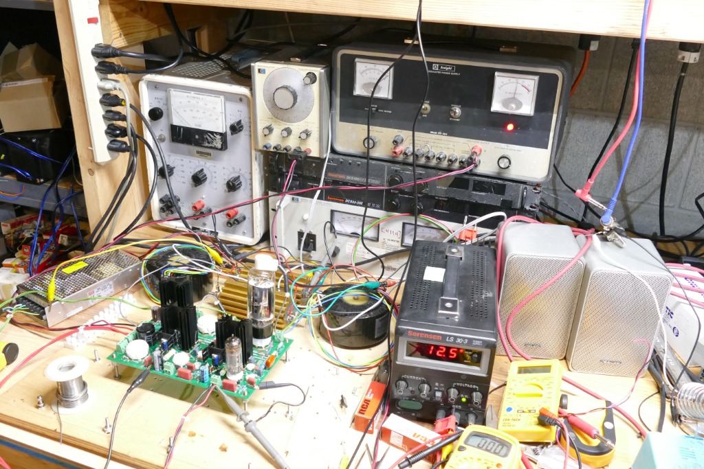

I got the UNSET board off the shelf and attempted to fire it up with several issues. I had been messing with the right channel driver circuit when it got shelved, which was dead when I powered it up. Some parts were lifted and the CCS circuit was dead, so I made two new ones and resoldered the parts that had one end lifted. The new CCSs used IXCP10M45S chips with a 1K pot, 1K gate stopper, and a 47 ohm max current resistor. Both were set at 10 mA with a power supply and DVM before installation and not touched after install. I popped in a 12GN7 and a 25HU5, set the output tube bias at 125 mA, and attempted to test with poor results. The THD was gross at about 5% at low levels due to lots of 60 Hz (not 120 Hz) sawtooth ripple. This turned out to be from my trusty old Fluke 407D power supply which is still all original. I guess it won't be for long. Rebuild time.
I swapped in my old Knight Kit supply which only goes to 400 volts, so that's where I tested (400 volts B+, 125 mA in the output tube, 10 mA in the driver, 1500 ohm load). I cranked the power up to 10 watts and turned R204 for best THD at 10 watts. With a constant 10 mA, R204 now sets the plate voltage. The THD at 10 watts remains below 1% for plate voltages between about 185 volts and 300 volts. Testing was done at 250 volts. My FFT analyzer is still not functional as turning the PC on without connecting it to the amp drives the THD floor up over 1%.

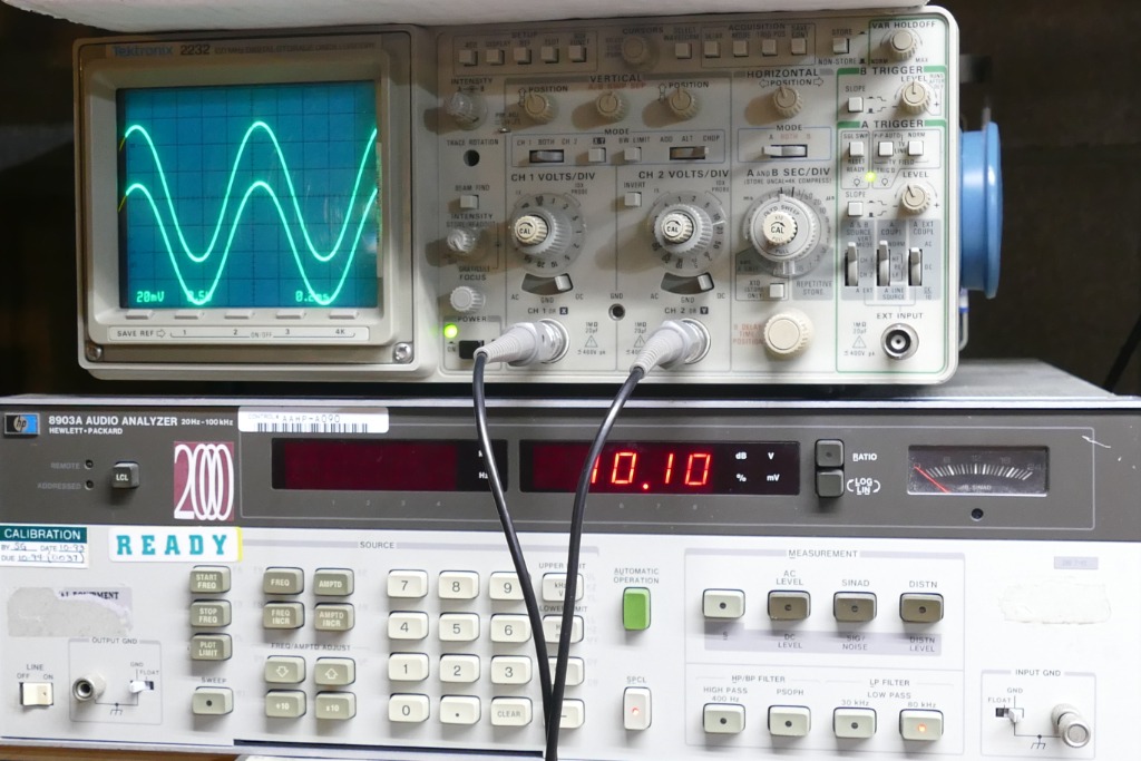

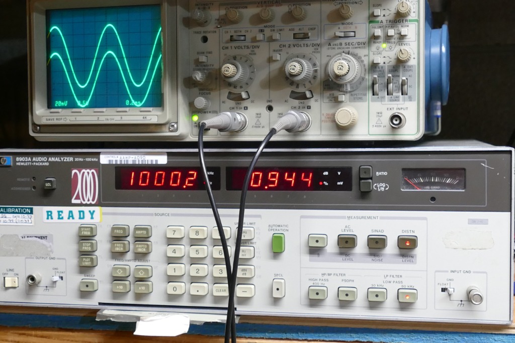

I got the following results.
Power THD
100 mW 0.144%
500 mW 0.183%
1 W 0.242%
2 W 0.333%
5 W 0.507%
10 W 0.944%
15 W 1.27%
18 W 1.32%
20 W 2.09% with visible clipping.
At 20 watts output the driver is putting out 28V RMS @ 0.228% THD

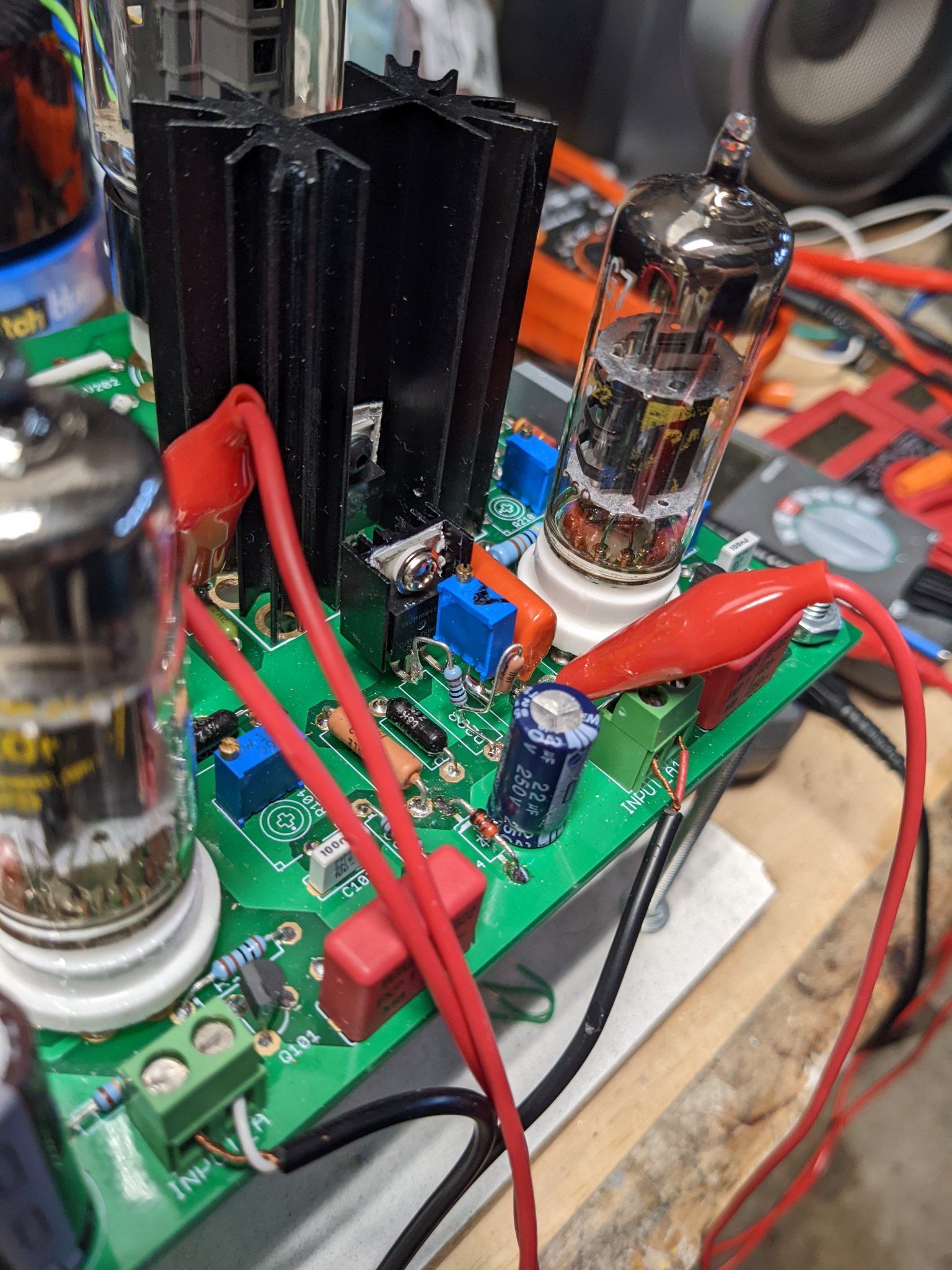

I tinkered with my UNSET as well but all i managed to do was kill it :-( I can no longer adjust the right channel driver plate voltage. It just sits around 107V and the pot R204 does nothing. Left channel adjusts fine. I also noticed the screen voltage is about half what it was ~22V vs ~55V before on both tubes. I tried replacing Q201 and R204 but no change. I also took out the CCS circuit and just put resistors back in but no change. I think this is a result of a slip with the probe I use for grounding the DVM on the right side of the PCB off one of the small caps but I can't see anything obviously fried.
The most logical explanation for this would be a shorted C202. This is also where I have my ground clip attached so it is possible that the cap is cracked or otherwise physically damaged. Measure across it with an ohmmeter while turning pot R204. The reading should change while turning the pot. If constantly zero, the cap is shorted. Note that the cap is connected to the pot wiper, so a zero reading is normal if the pot is at the grounded extreme.

UH, it's dead! I cobbled together a simple power supply that made too much voltage, about 515 volts of B+, so I removed the expensive power transformer and replaced it with an Antek toroid. My B+ was still a bit high at 470 volts, but I decided to play with it. I had both channels driven to over 30 watts when there was a pop followed by deadness. Autopsy tomorrow.....maybe.
The reading did not change on c202 when adjusting the pot but it was not zero. Pulled it anyway and it tested good. Have not taken all the voltage reading yet but I did pull the driver tube in the bad channel and screen voltage returned to normal.The most logical explanation for this would be a shorted C202. This is also where I have my ground clip attached so it is possible that the cap is cracked or otherwise physically damaged. Measure across it with an ohmmeter while turning pot R204. The reading should change while turning the pot. If constantly zero, the cap is shorted. Note that the cap is connected to the pot wiper, so a zero reading is normal if the pot is at the grounded extreme.
If this doesn't help, make the following measurements. Do any voltages on the tube (cathode, control or screen grid change when turning the pot? If not, what are the voltage readings? Does the screen voltage on the adjustable tube return to normal if the tube in the defective channel is removed?
This implies that something is forcing that tube into nearly full conduction. Either the cathode is nearly zero volts (shorted Q201, broken ground on pot), or the control grid is too far positive (open or broken R205).I did pull the driver tube in the bad channel and screen voltage returned to normal.
Well still no joy. R205 tested good but Q201 tested bad so I changed out Q201 and now I am back to a constant 340V plate voltage that I cannot adjust. Heater glows. i measured each pin with the tube out and got the following.
