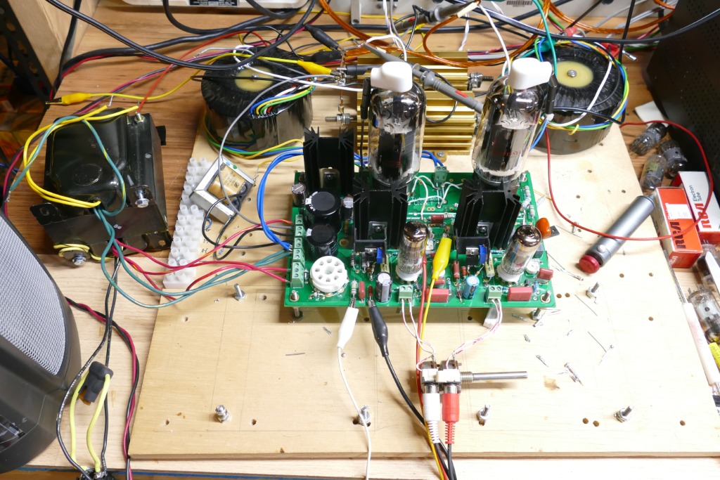

UNSET Beta Board Build

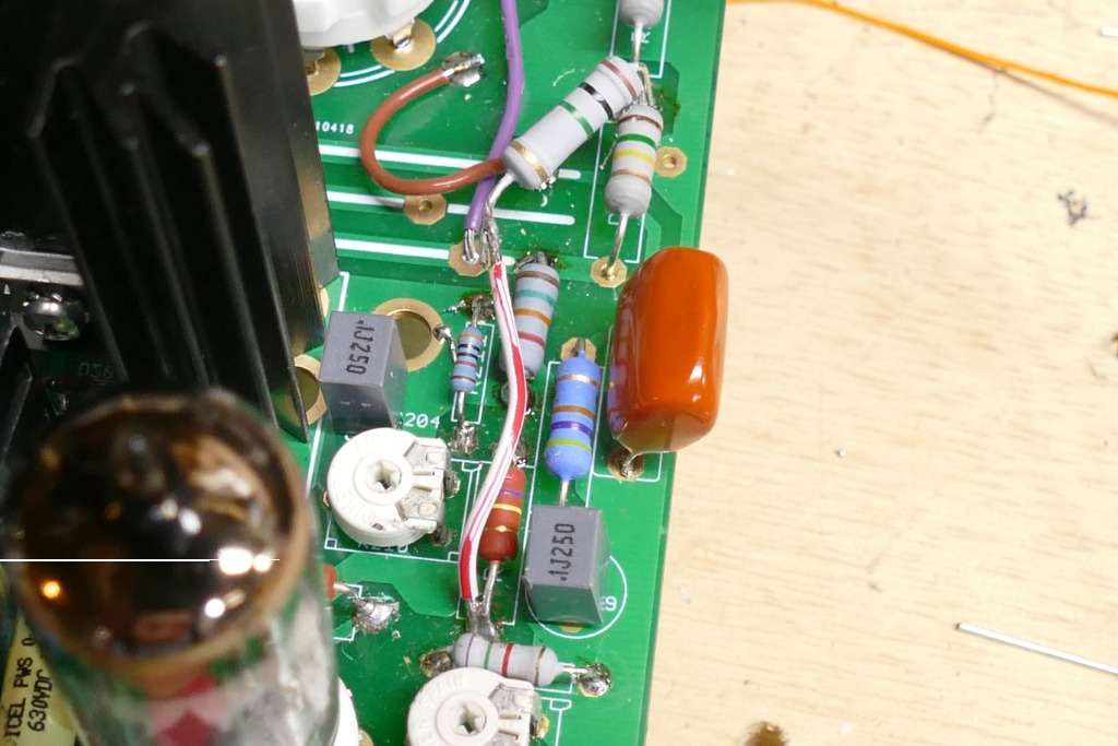

Now your tube is completely cut off, drawing no current. If the grid (pin 2) is 10.2 volts (about right) the cathode (pins 1,3 and 9) needs to be about 12 volts for proper conduction. What voltage does any of these pins read with the tube installed and the pot turned from one end to the other.?
Pins 1, 3 and 9 are all connected together, yet you report different voltage readings. I'm not sure what the voltage reading should be with no tube installed, but I'll measure my board as soon as I can get it working.
An accidental overdose of electricity (over 600 volts) has left my board with several dead parts. R7 got so hot that it unsoldered itself and fell out of the board. I have changed several parts and it still doesn't work right. It is clear that a 6.8K resistor for R7 was fine when I was running a few mA through each driver tube and using a B+ of 450 volts or less. It is NOT fine when cranking over 30 watts from each channel on about 500 volts with 10 mA flowing through each driver tube. I now have a 1.2K 2 watt resistor in the board for R7, but there are still dead parts in here somewhere as nothing works right.
The big Toroid.com transformer that I first tried got me 545 volts even when I was drawing 300 mA of current. I swapped in an Antek which had lousy regulation but got me about 485 volts when drawing 300+ mA. Unfortunately the B+ was well over 600 volts when all tubes were cold on power up. That blew up the screen regulator because I had a 500 volt fet installed. There is still something else dead as all voltage readings are whacky.
My current favorite needs 1.2 volts to hit 20 watts where it makes 1.14% THD. It eases gently into clipping near 25 watts where it makes 2.67% THD, and clips pretty hard at 30 watts where it makes 6.05% THD.
Those are impressive numbers! Sorry that your board went “pop” with that overdose. Good luck with getting it to run smoothly again.
Regarding R7 - do you see any problem with my plan of replacing it with a 16H, 40 ma, ~600 Ohm choke to make available as much HV as possible from my regulated supply off Q1.
I am usually OK with blowing stuff up in the name of science. In this case I saw the 26HU5's show a bit of plate glow when idle on nearly 500 volts at about 120 mA, so I did the obvious, I installed the fattest 26LW6's that I have. They were cold, so the B+ went somewhere beyond the range of the 600 volt scale on my cheap DVM which made some dead parts.
I had seen the voltage drop across the zener diode when turning the pot on the input tubes while using a 10 mA CCS for the plate load, so I had swapped the 150K R8 for the first big resistor I found which was a 39K 3 watt part. It got hot, but not too hot. It now looks like the zener got hot too since it is also unsoldered on one end. It is however still alive.
I see no reason why you couldn't use a choke in place of R7, but I have not actually tried it. I have a box full of mystery chokes nearby, so I may try one later after things are working better. I now have power, but lots of distortion. Perhaps resoldering the zener will fix it. Don't know yet since I took the board out and brought it to my "building stuff" workbench for a general clean up. There is more light here, and this is where I noticed the unsoldered diode. I have made a mess out of the soldering changing parts from the top over the last few days.
The impressive measured numbers can be obtained by applying a small amount of feedback from the output tube to the driver tube. This is accomplished by soldering a large value 2 or 3 watt resistor to the junction of R114 and R115 and running a wire from the other end of this resistor to the junction of R105, R106 and R107 (pin 2 of the driver tube). This gives up some gain for increased power output and lower distortion. I have not yet listened to the amp wired like this so I don't know how it will sound. I do know that I was getting over 30 watts from each channel at under 3% THD when I decided to install bigger tubes and try again. Do not try this mod until everything else is working correctly. I have used a 510K resistor with a 6JD6 tube but it didn't have quite enough gain. I now have a 1 meg 2 watt resistor in there and I have seen good results with every driver tube I tried except some Japanese 6KY6's.

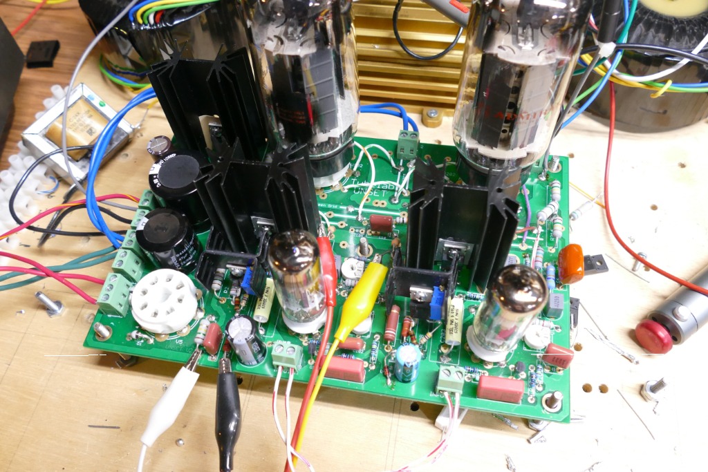

I took some measurements with the driver tubes in
Bad channel
1, 3 and 9 - 13.1v
2 - 10.2V
7 - 340v
8 - 99v
Good channel
1, 3 and 9 - 9.5v
2 - 8.5V
7 - 225v
8 - 98v
On the bad channel pins 1, 3, and 9 do respond to the pot. Initially the reading was 33v, 13.1v is the lowest I could adjust it down to.
This all points to the mosfet. is the correct part installed correctly?
Try sticking a small resistor, say 560 ohms to 1K from pin 1 to ground and see what the tube voltages do. If the plate voltage comes down, the fet, pot, R102, or R103 are not working correctly. Does the voltage on the wiper of the pot vary when you turn it?
Well that was annoying. Replaced the mosfet again and now everything seems good. This is the 3rd mosfet I have tried while troubleshooting this issue. The mosfet I removed tests as a mosfet on a cheap mega tester I have but something was wrong. Bad part, bad soldering? Good thing I purchased a number of these from Digikey. Thanks for your help. Now I can get back to playing with this amp and some of your tweaks.

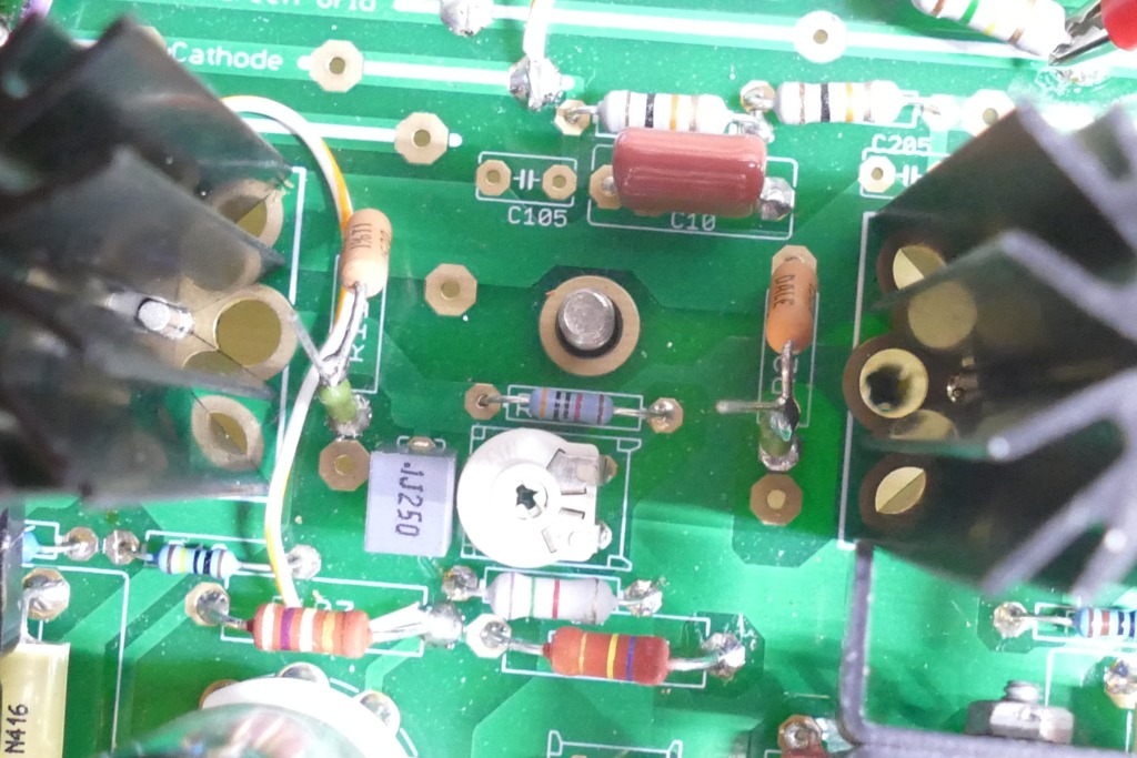

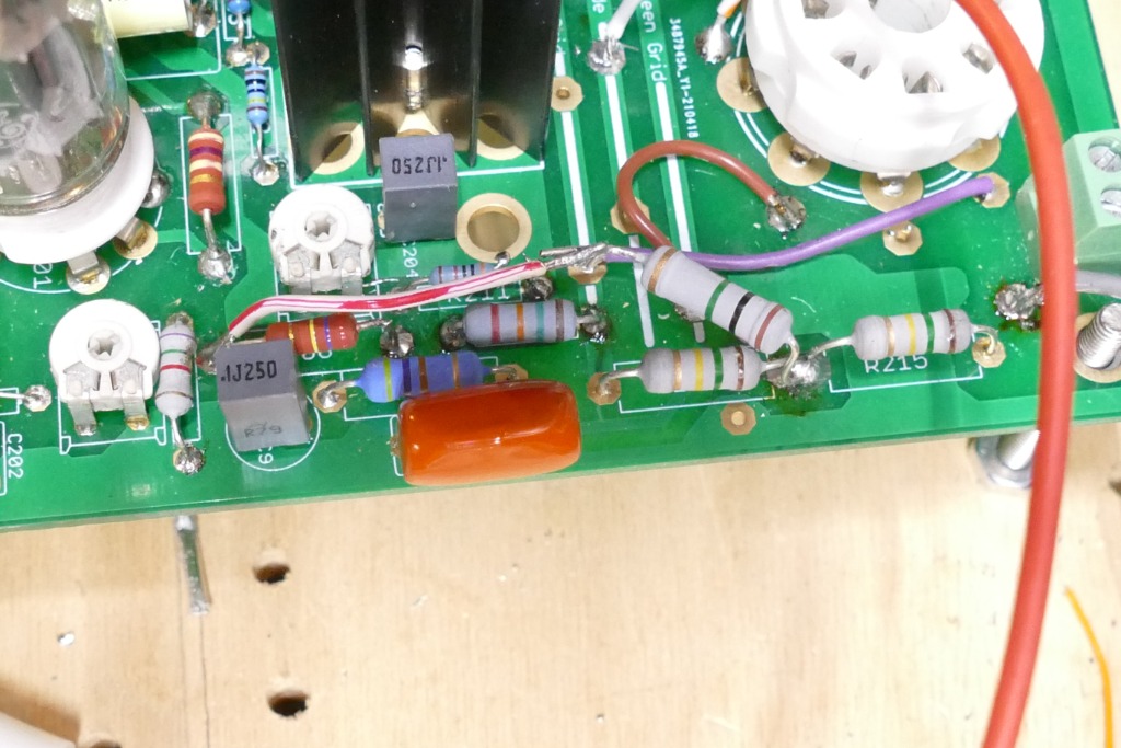

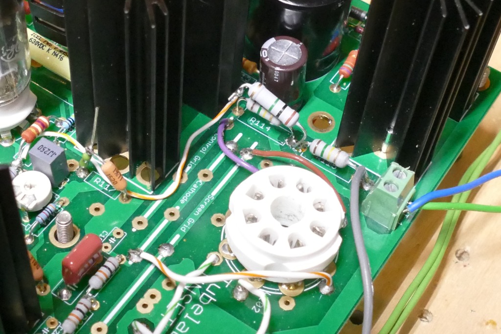

First change was adding in the CCS. I set it at 10mA and soldered it in place of R108/208. I found dialing in the plate voltage unstable like this so soldered in a 1M resistor across the R108/208 below the CCS, This made things stable. I also reduced R7 to 3.4K and R8 to 75K ohms as well as put the 56V zener back in at D4. This setup gave 0.44% THD at 1W and about the same 5% at 17-18W. Driver plate voltage is set at 250V
Next I reduced R113/213 to 15K. Gain increased and so did distortion, THD was about 0.81% at 1W. Not a good change on it's own.
Last I added in the feedback mod. To do this I had to put 5 200K ohm 1/2W resistors in series since that is all I had to get me there. Much less gain now. THD at 1 W is 0.3% and I get 20W at 3% THD. My DAC at full output drives it to 13V but the THD spectra starts to look a little ugly.

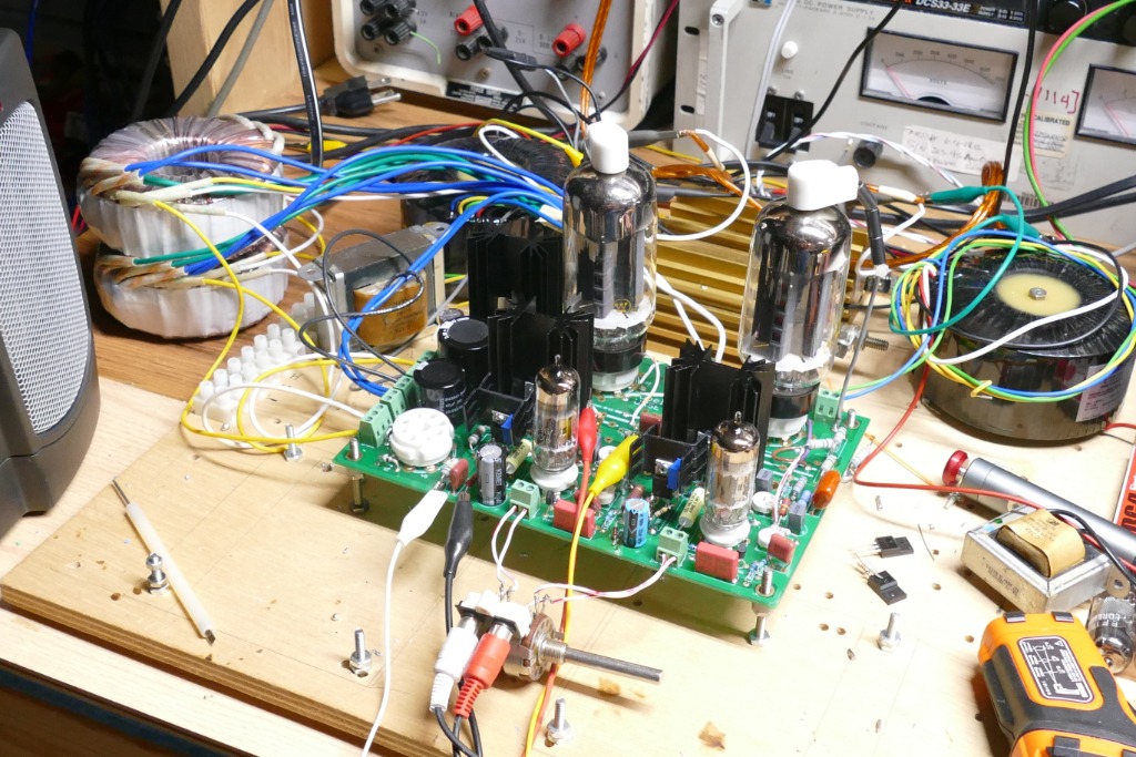

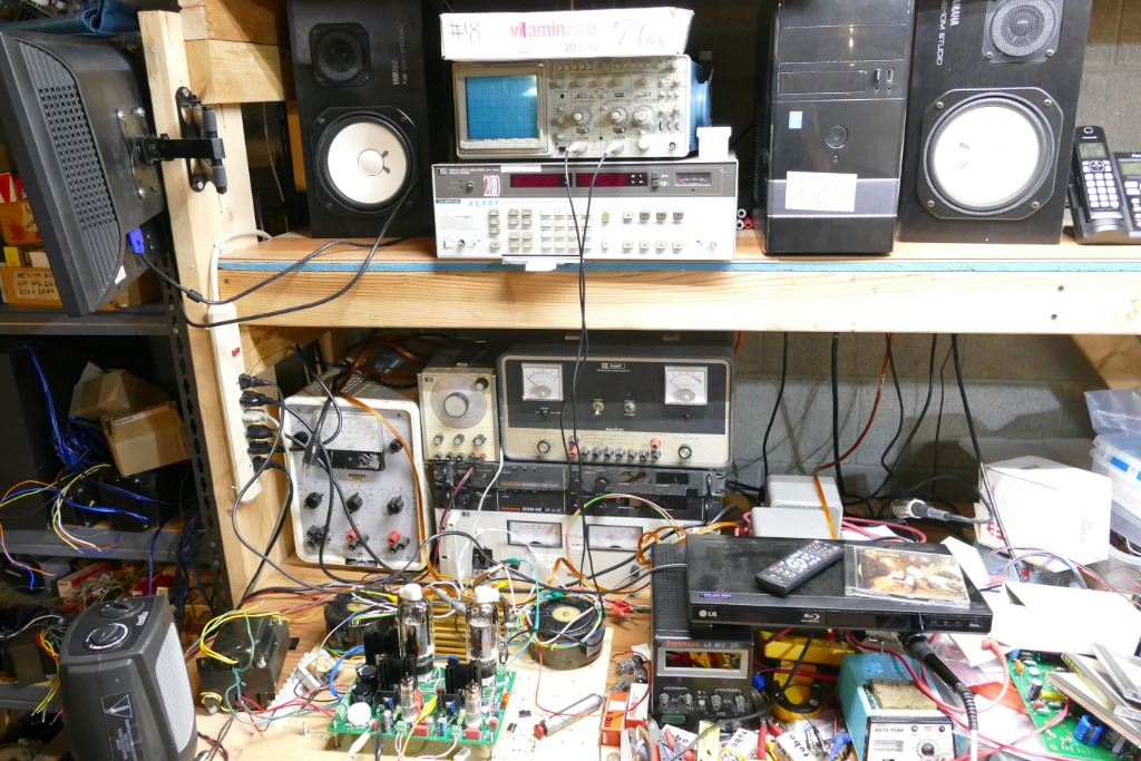

Friday, I took the board out of my test setup to clean up the mess of poorly soldered parts that had been tacked on, removed, swapped a few times, or just burnt due to contact with a soldering iron in my shaky hands. I also replaced anything that looked like it had eaten too much power. Remember, my board has seen over 600 volts.
Saturday, I began to reassemble and test everything and search for a suitable power transformer so that I may look toward building a complete UNSET amp. All measurements have been done with bench power supplies up to this point. Maximum power tends to be lower once an unregulated supply is used. At this time, I discovered two inconsistencies in my setup that may make some of my previous measurements suspect. When I got the rebuilt board up and running one channel made more power than the other. I also noted that the heat sink on one channel was hotter than the other. Investigation revealed that one channel was wired for 1500 ohms and the other was wired for 3000 ohms. One of the cheap meters that I had been using to set the bias current was bad due to an overdose of electricity. This led to the hot channel running a lot more current than I thought.
I did find results similar to yours. With the OPT's wired for 3000 ohms I got good results up to almost 20 watts with bias currents in the 100 to 110 mA range. This would limit the B+ to under 450 volts to get a semi - sane tube dissipation level with even the biggest 'LW6 tubes I have. Operation on 1500 ohms requires a bunch more current, and a corresponding lower B+ voltage to control tube dissipation. Any of the 360-0-360 volt transformers that I tried delivered a B+ voltage in the 480 to 500 volt range. I saw power levels over 30 WPC with the Antek which delivered the lowest B+ voltage. Unfortunately even the Antek produced some plate glow in a dark room when run at enough current for the THD to level off. I decided to explore lower voltages at higher currents and a 1500 ohm load. Here I needed to be in the under 400 volts range.
By Saturday night all was working properly. After about 5 different tries I found a suitable power transformer that would deliver 396 volts to the OPT's at idle, and 375 to 385 volts at 30 WPC depending on where I set the idle current. In order to get good THD at 30 watts into 1500 ohms, I need about 150 mA of tube current. This is too much for the power transformer I have, but for now it's the best I can do with parts at hand. I have been using an SMPS to power the heaters of the output tubes for all tests so far. The transformer I found has a 6.3 volt winding with 8 amps of current, so it is powering all the heaters and some fat 6LW6's are in the board. Note that there are two different size bottles for 'LW6 tubes, and several different plate structures. I picked a pair with the fat bottles and the biggest plates. Yes, that little choke is a bad joke, but all I could find on short notice. I do have a bigger one somewhere.
Bench testing revealed that I could easily get 30+ watts at under 5% THD with both channels driven, but it took about 150 to 160 mA to get there. At this level there was no plate glow in a dark room. Sherri and the neighbor next door would both be away all afternoon Sunday, so I could make all the noise I wanted, so I dragged out my trusty Yamaha NS-10M Studio monitors, attached a volume pot and some input jacks, plugged in a DVD player, and set up for some serious listening tests.

Sadly, the critical listening tests did not occur yesterday. Our power went out as we were leaving for church and did not come back on until 8 PM last night. I did get about 45 minutes of "loud" time before Sherri came home. I learned that 150 mA of idle current makes the heat sinks on the cathode fets too hot to touch, so a fan was placed near the board. It ran fine like this, but I kept reducing the current during listening to see where the reduction became audible. Around 130 mA there are noticeable artifacts on transient sounds as the amp is pushed near clipping. This becomes visible on the scope below about 120 mA. I set the current to 135 mA and turned the fan back on. There should be some more listening time on Tuseday night.

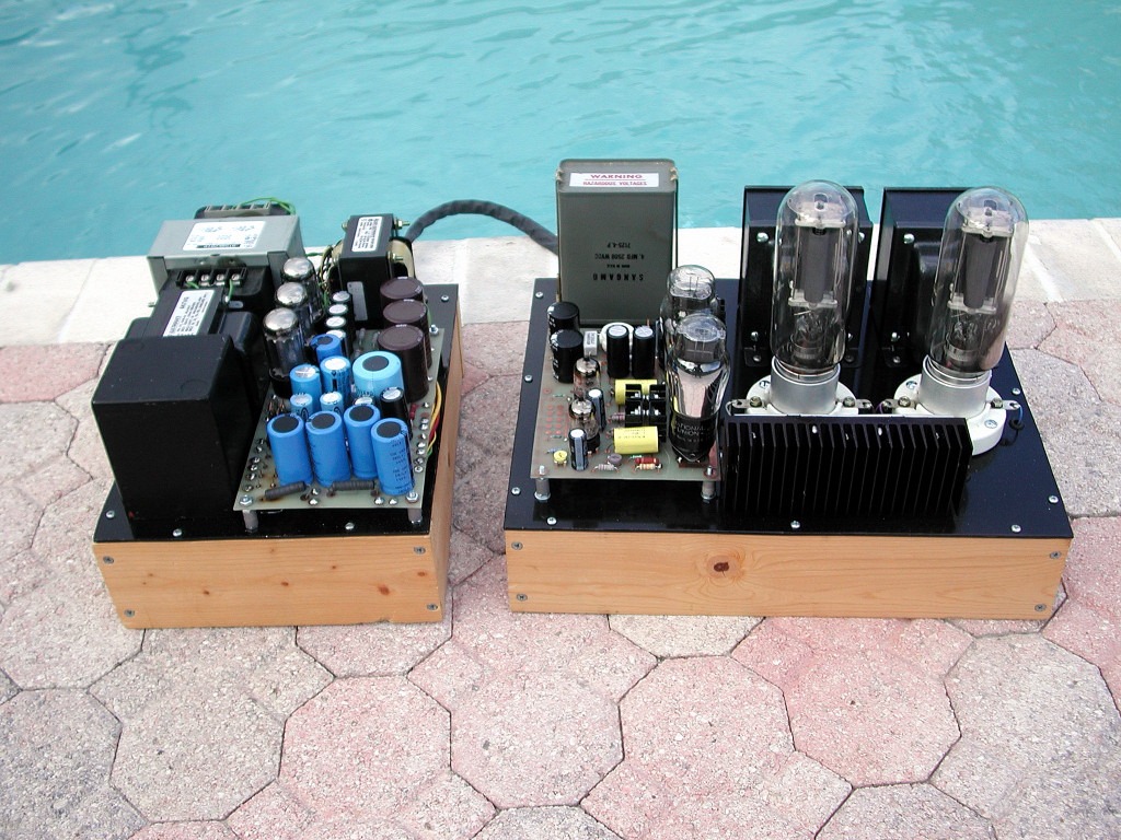

The amp was powered up continuously for over 4 hours. After dark I took the obligatory shot in the dark picture, and had the current turned up to 150 mA for about 10 minutes at idle (no music) which is worst case for any class A amp dissipation wise. There is a dull glow on the sides of the plates that face each other. The glow faded when I cranked up some loud music at full tilt with occasional clipping seen on the scope. After the first hour I pointed a small fan at the heat sinks as the one on the right had reached 80 degrees C on my cheap IR thermometer. With some airflow it dropped to under 60C. The Anteks were pretty hot, but not too hot to touch.
I threw everything at this amp from mellow to metal with a detour through some uber compressed 80's techno. The bass was solid and I didn't need to crank up the idle current to reduce the boom like I do on a SSE running KT88's in UL. In this regard, the UNSET beats the SSE hands down. It would take a side by side comparison to chose an overall winner between the UNSET and my last high powered SE amp (the UNSET wins in the bass department despite the small OPT), which is an 845 being driven by a TSE board for about 30 WPC on 1050 volts. That amp still sits on a shelf and has not seen power for over 10 years.

My measurements are close to yours George. With my setup I am seeing 0.22% 1W, 0.54% 5W, 0.88% 10W and 1.9% 18W. Output will just touch 20W at 2.9% THD then everything falls apart quickly. I did try to lower the screen supply resistor to 1.5K and while the screen voltage didn't drop more than a few volts at 20W+ the distortion was still climbing rapidly so at this point I don't think I am really gaining anything with the lower value. I switched back to the 2K value for the above measurements. I am running 105mA bias and this puts the tubes at 38W.
