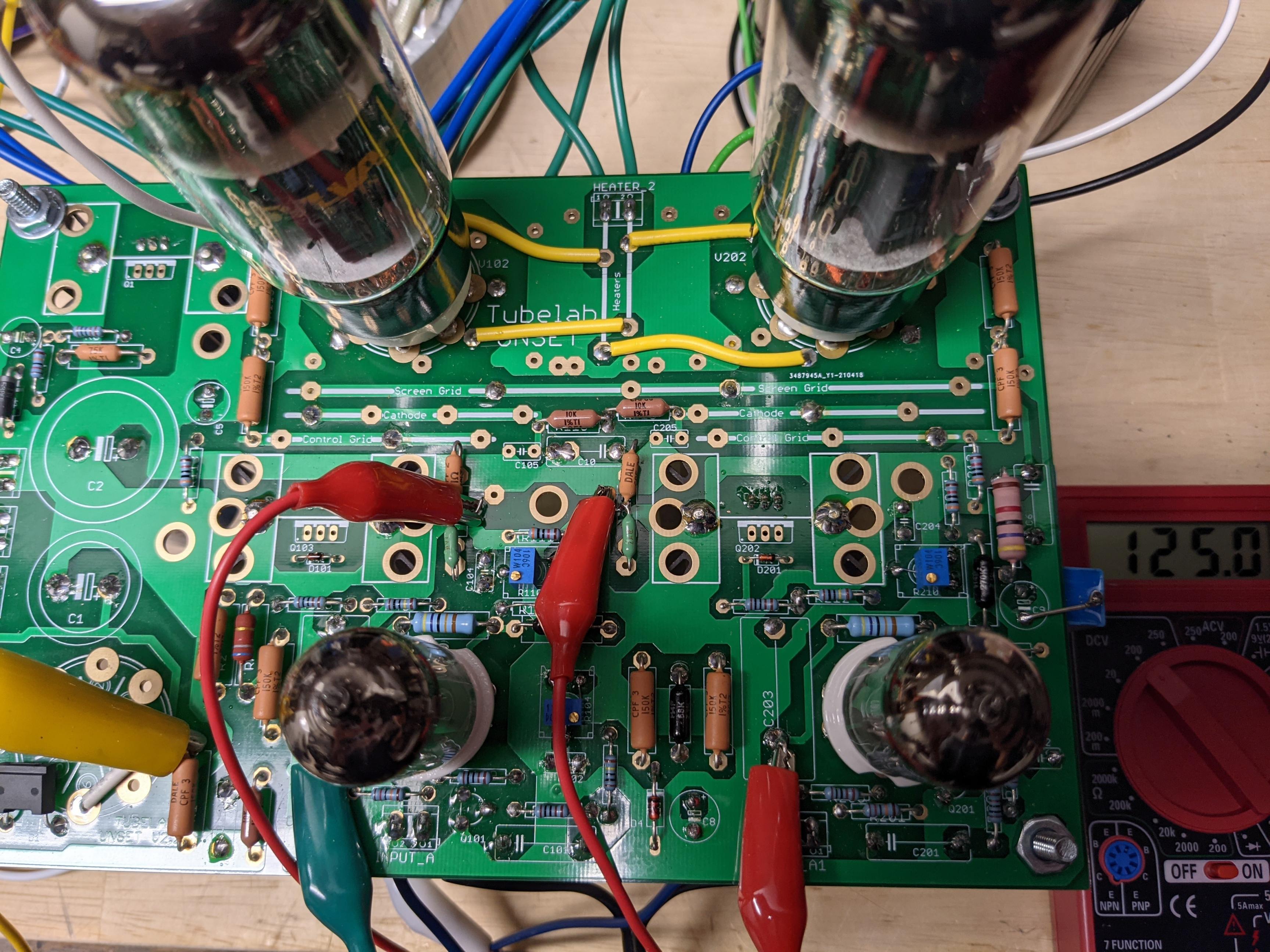

Did some measurements using a better multi meter with fresh batteries plus a bias increase. Here is where it landed tonight.
B+ 477V
R115/R215 450V
cathode 70V
bias at 65mA
So that puts 380V across the tube and 24.7watts dissipation

Had some time for testing today. Bias at 65mA and speakers to the 4 ohm taps to give me a 6K load and took a listen. An improvement. I felt it added a bit more sharpness or clarity in the lower range with the same punch as before and that SE sound throughout.
After this I swapped the PT for an Antek 3T275 to try out a lower B+ Adjusted everything and ended up with the following
B+ 376V
R115/R215 344V
cathode 61V
bias at 80mA
So that puts 283V across the tube and 22.6watts dissipation. At this lower voltage the pots seem slightly less sensitive so hitting the target values was a bit easier.
Speakers back on the 8 ohm tap and cranked up some music. I would say this sounded at least as good as the prior test. At this point I think my test speakers are at the limits of their sound quality.
This seems like a good setup so far. I'll continue to listen to this over the next week. I have some multiturn pots on order and a softstart board to finish up next. I am also working on a way to get some capability to measure distortion so hopefully I can dial in the amp further.

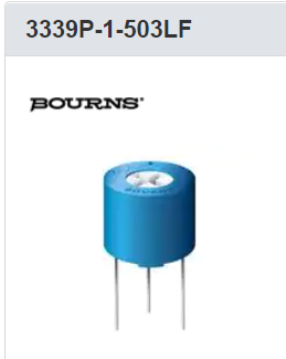

Changed out the trimmer pots for these Bourns multiturns PV37W104C01B00 and adjusted everything again. Easier now to dial in and seems to stay stable around +/- 2% of target value. Also finished up a soft start board to make turn on a little gentler.

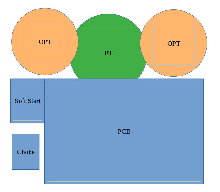

Starting to think about chassis layout. George you mentioned that oscillation can be a problem with this amp. How careful do I need to be in routing the input and output? Can I run both to the back panel keeping them as separate as possible or should I keep the inputs on the front and outputs on the rear? I am planning to mount the PT under the top plate and OPTs on top.
I used these trimmer resistors recently. They are a bit more pricey, but I like the idea I can mount them behind a hole drilled on the top plate.
Bourns trimmer

Also followed your lead with the multiturn trimmers, but I got 50k trimmer and a 30k and 20k resistors to use on the sides of the trimmers (to reduce dissipation). Do you know where (what value if available) the trimmers are set after your adjustments? (I hope the 20 and 30k resistors will hit the sweetspot).
