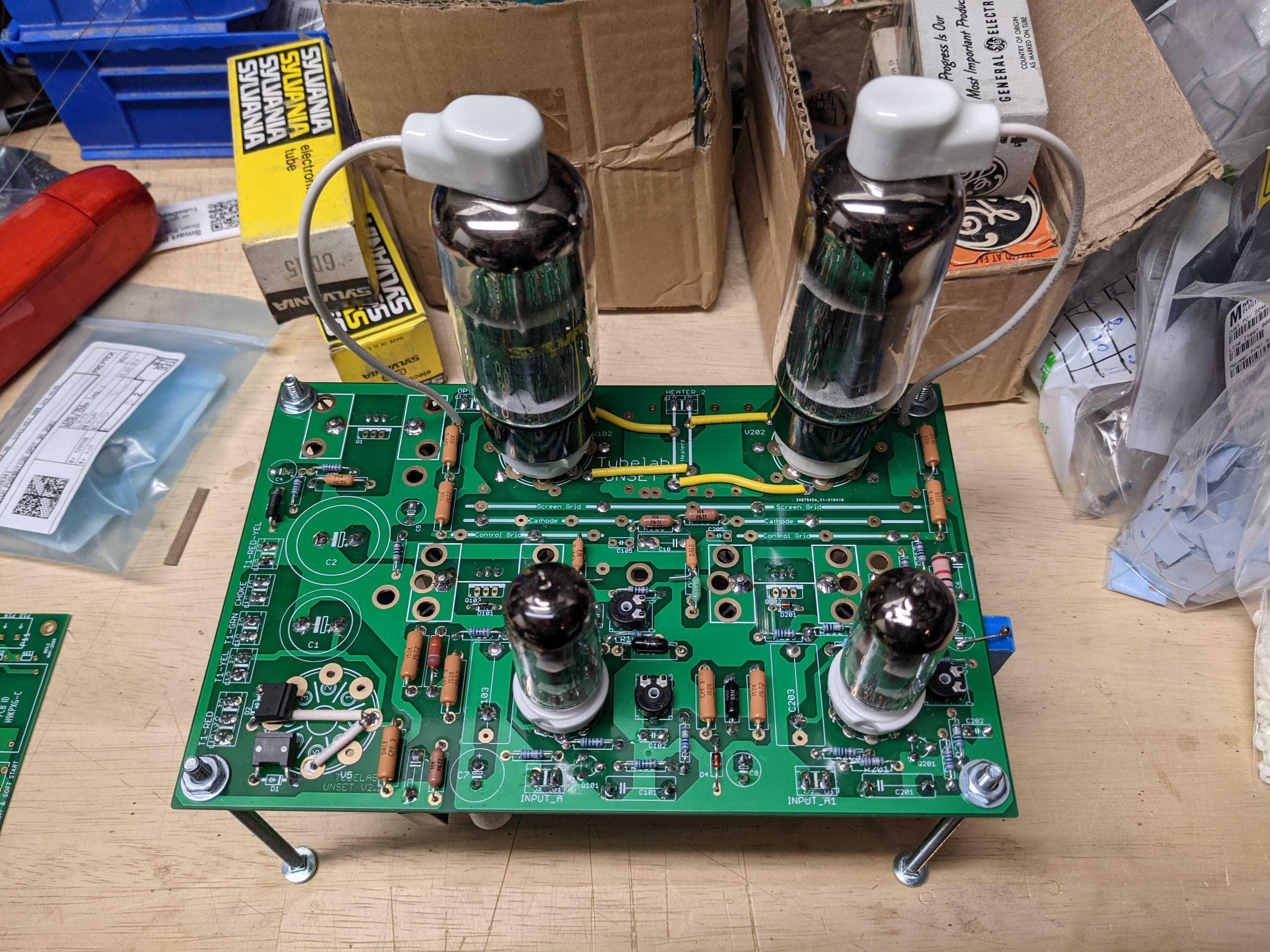

...Tubes on top (just trying some candidates here), components below deck...

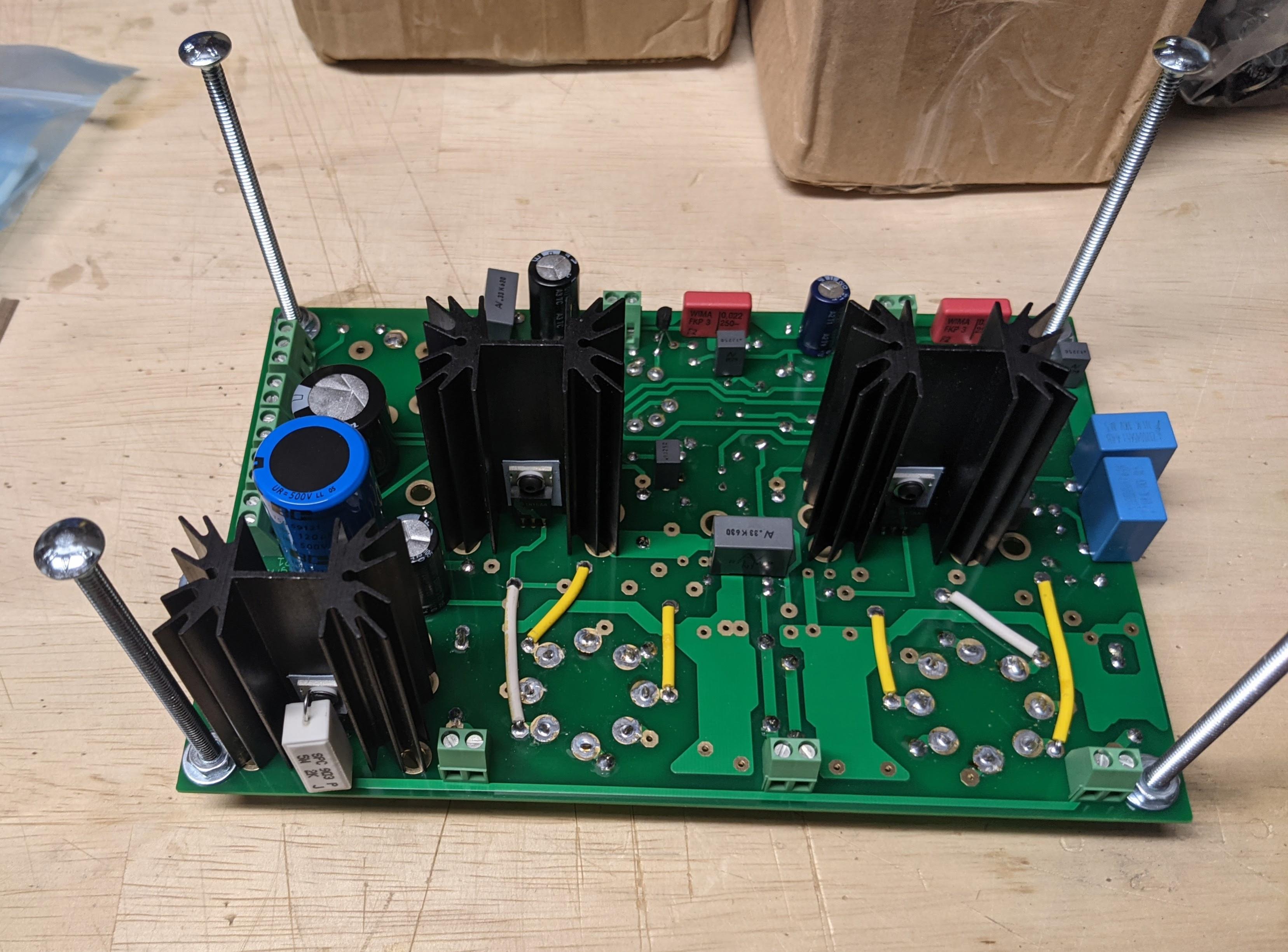

What are the thoughts on the BOM heatsinks mounted below and cooling capacity? I went with the 3k Toroidy OPTs and have an Antek AS-3T350 that should put around 420-430v B+ to some 6DQ5s to try for now. With some careful placing of vent holes top and bottom am I likely to be good or should I be thinking of a more robust cooling setup?

So if I want to build a 15 WPC capable UNSET with heat sinks on the bottom it appears some extra consideration should be given to thermal management.
There are some nice big ventilation holes in the board aligned to the radiator fins to aid airflow.
Top and bottom plate would need them too.
But quite possibly, the conclusion could be that for a setup producing more than xx Watts you'd need forced airflow for a below deck implementation.
With the FETs on the opposite side of the tubes, you could go for even bigger heatsinks.

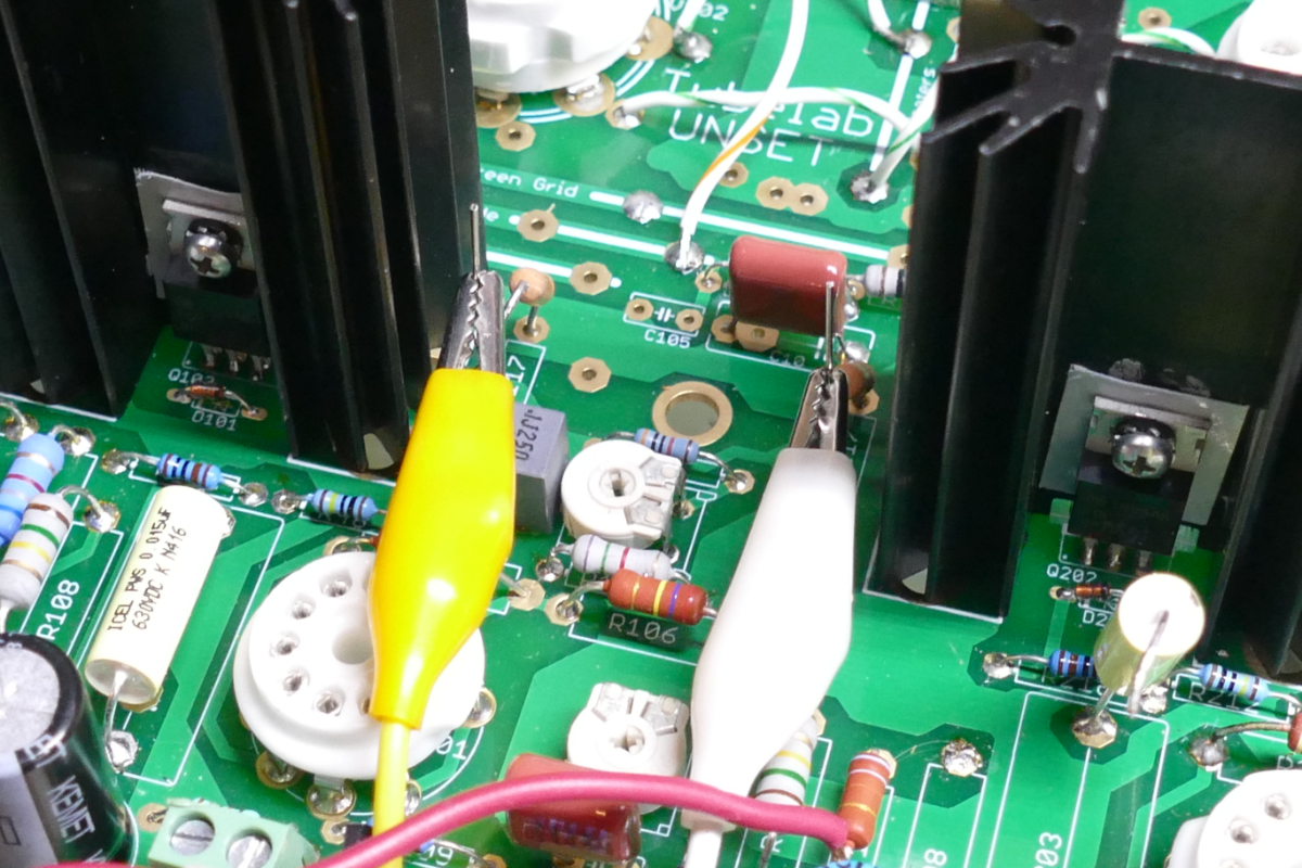

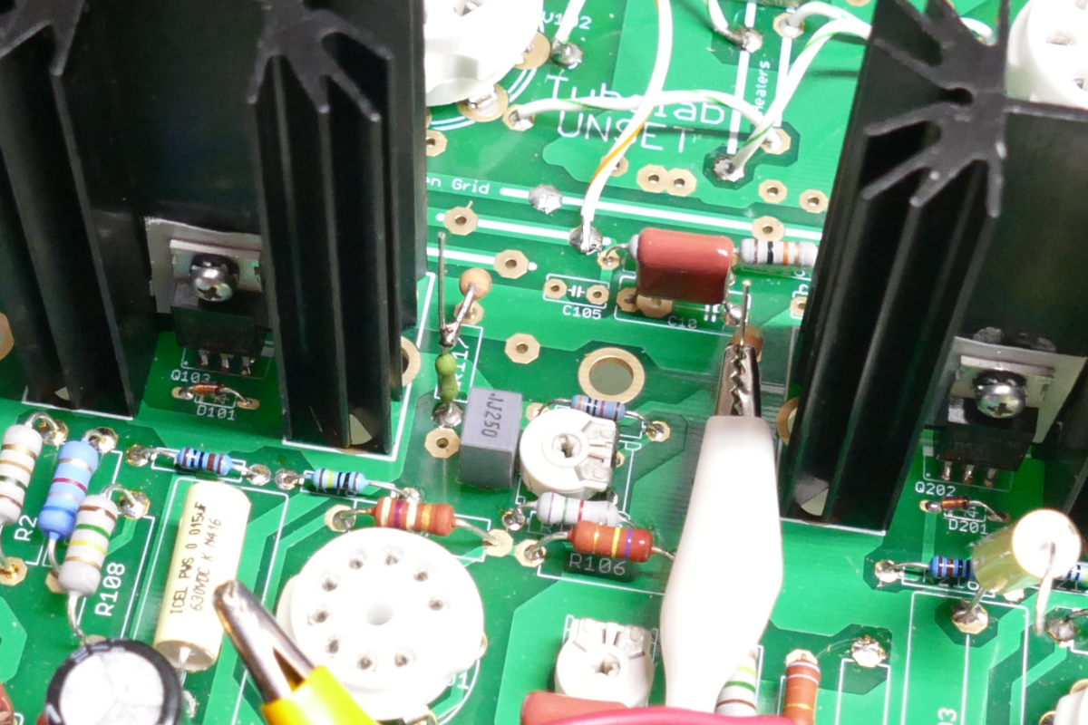

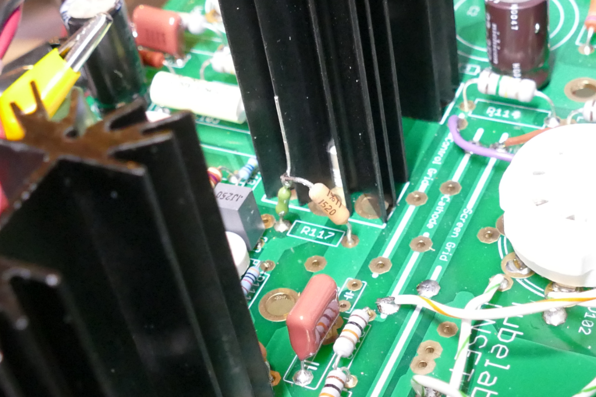

The fuse should be placed in series with the 1 ohm resistor in the cathode circuit of the output tube. It goes between the resistor and the mosfet so that one end of the resistor is still grounded. A volt meter is placed across this resistor for bias adjustment and tube current measurements.
I left a fuse lead wire pigtail sticking up for easy clip lead access. I always have a meter, scope, or both connected to this point (other lead on ground) for watching the output tube current. Since the resistor is 1 ohm the meter reads milliamps directly on the millivolt scale. The 0 to 200 mV reads 0 to 200 mA. The 2 volt range reads 0 to 2 amps.
Note the Zener diodes must be installed opposite what the silkscreen shows. This is also shown in the middle picture.

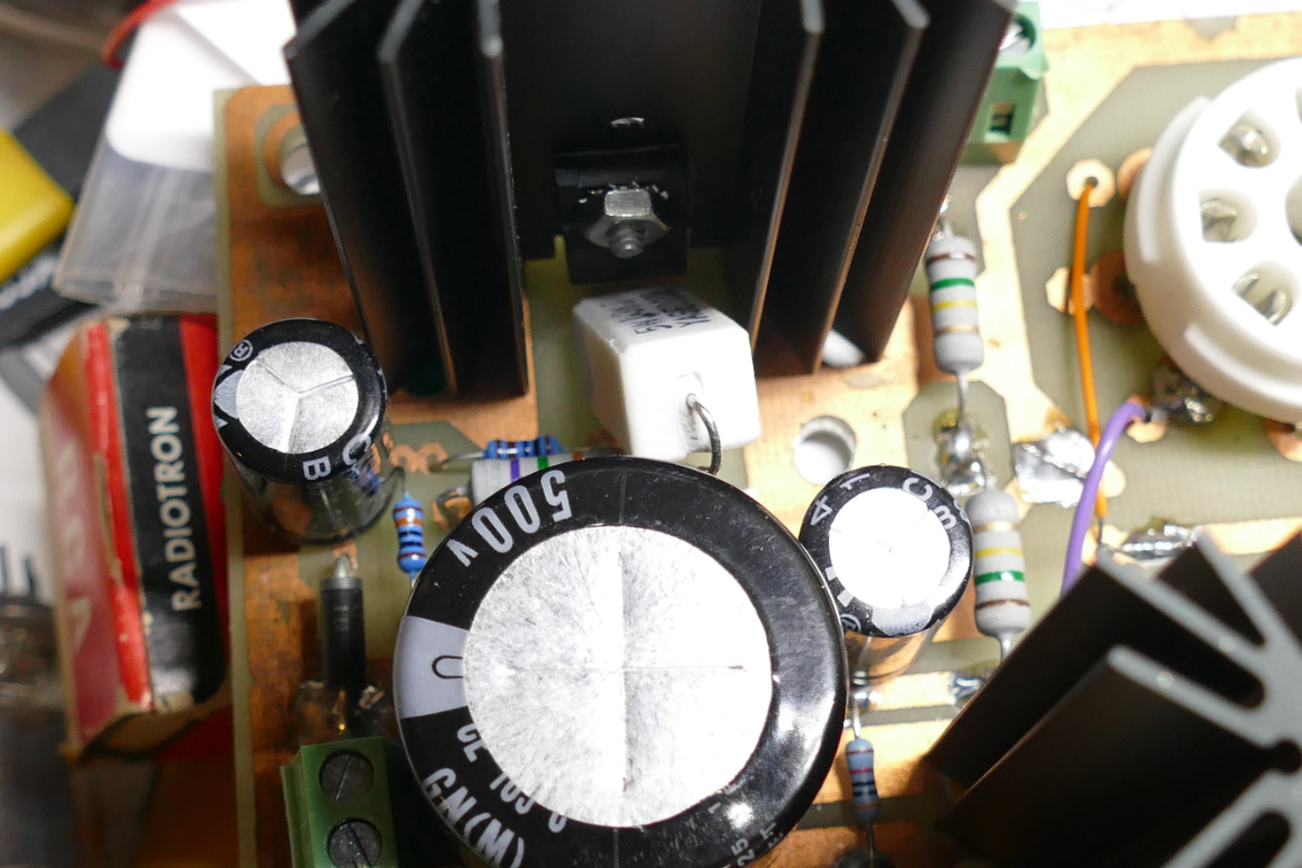

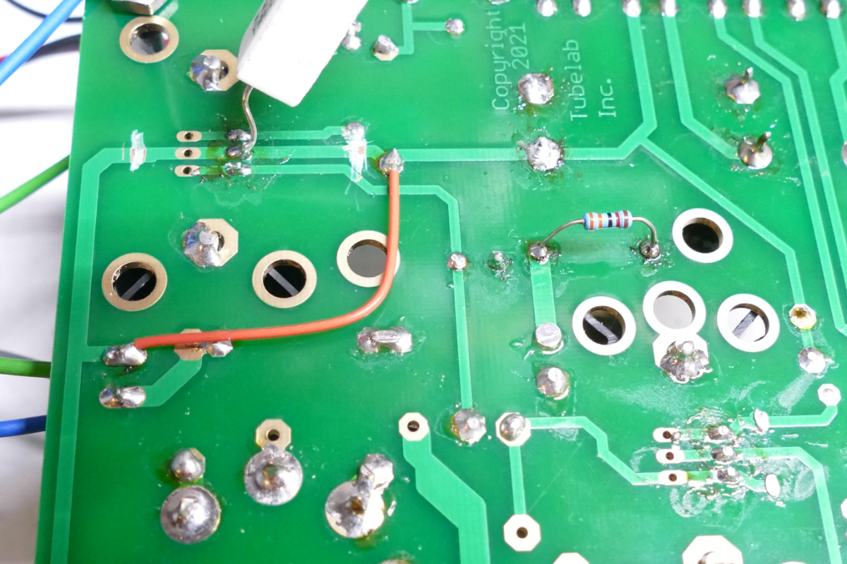

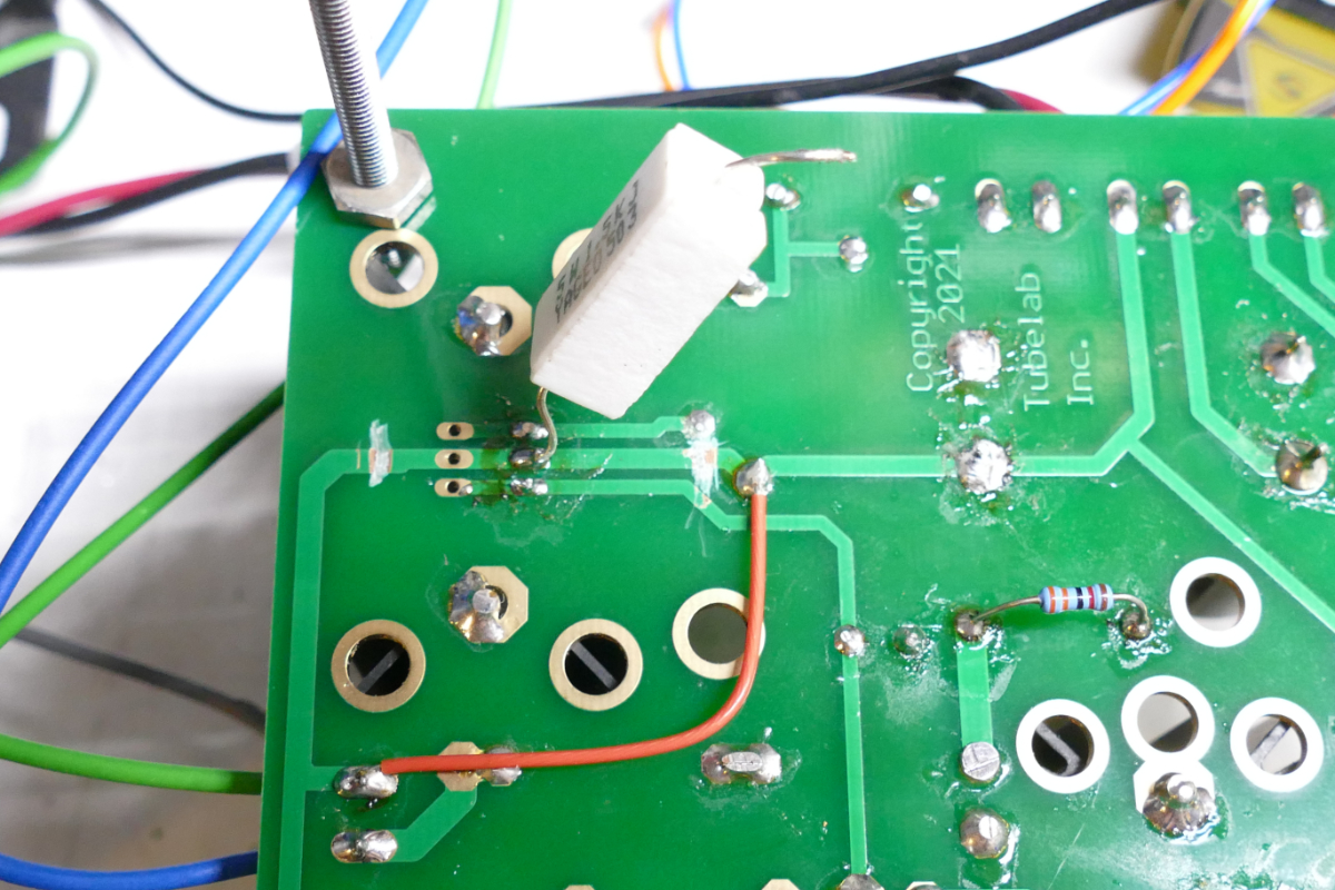

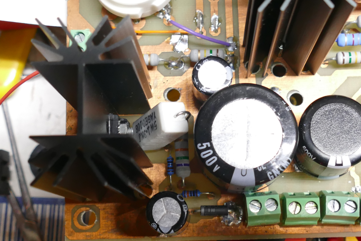

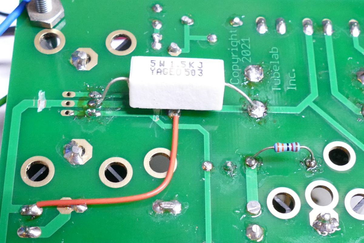

There are two ways to do this.
One involves cutting a trace in two places and adding a jumper wire and the resistor to the board.
The other involves bending the middle pin on the mosfet up and soldering the resistor directly to the mosfet pin. The other end of the resistor gets soldered to the B+ end of R4. No board mods are needed. I'll get better pics of this when I build another board.
Notice that I have used a 1.3K and a 1.5 K resistor. These work too, but 2 K may be safer if you are not trying to squeeze 30+ WPC out of the board.

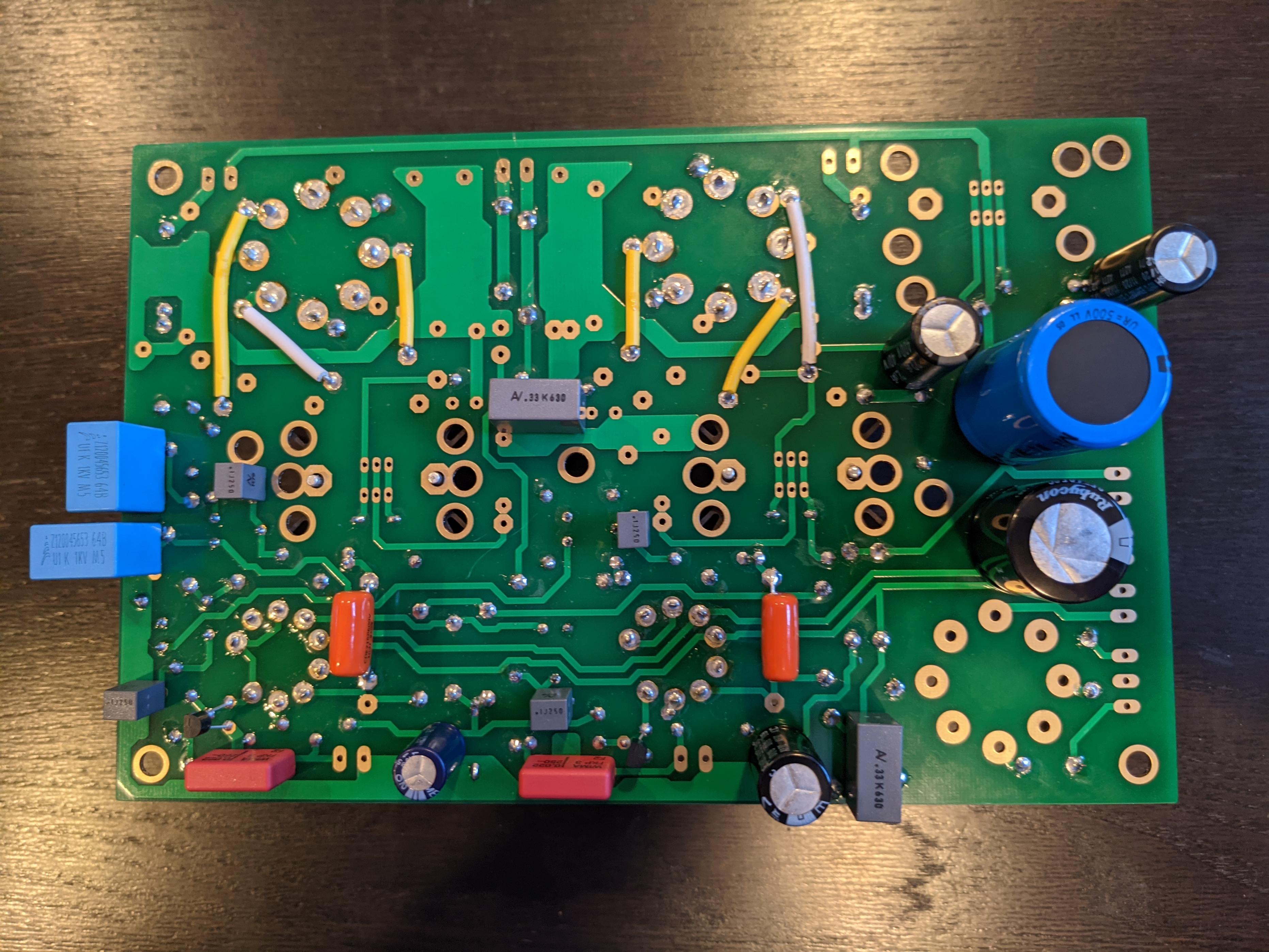

Coming together, still waiting for a few parts but all the caps are on and only R117, R217 and the 2K one on the mosfet remain for the resistors. Didn't catch the spacing requirement for C9 so that is a bit of a kludge. Anything else look amiss?

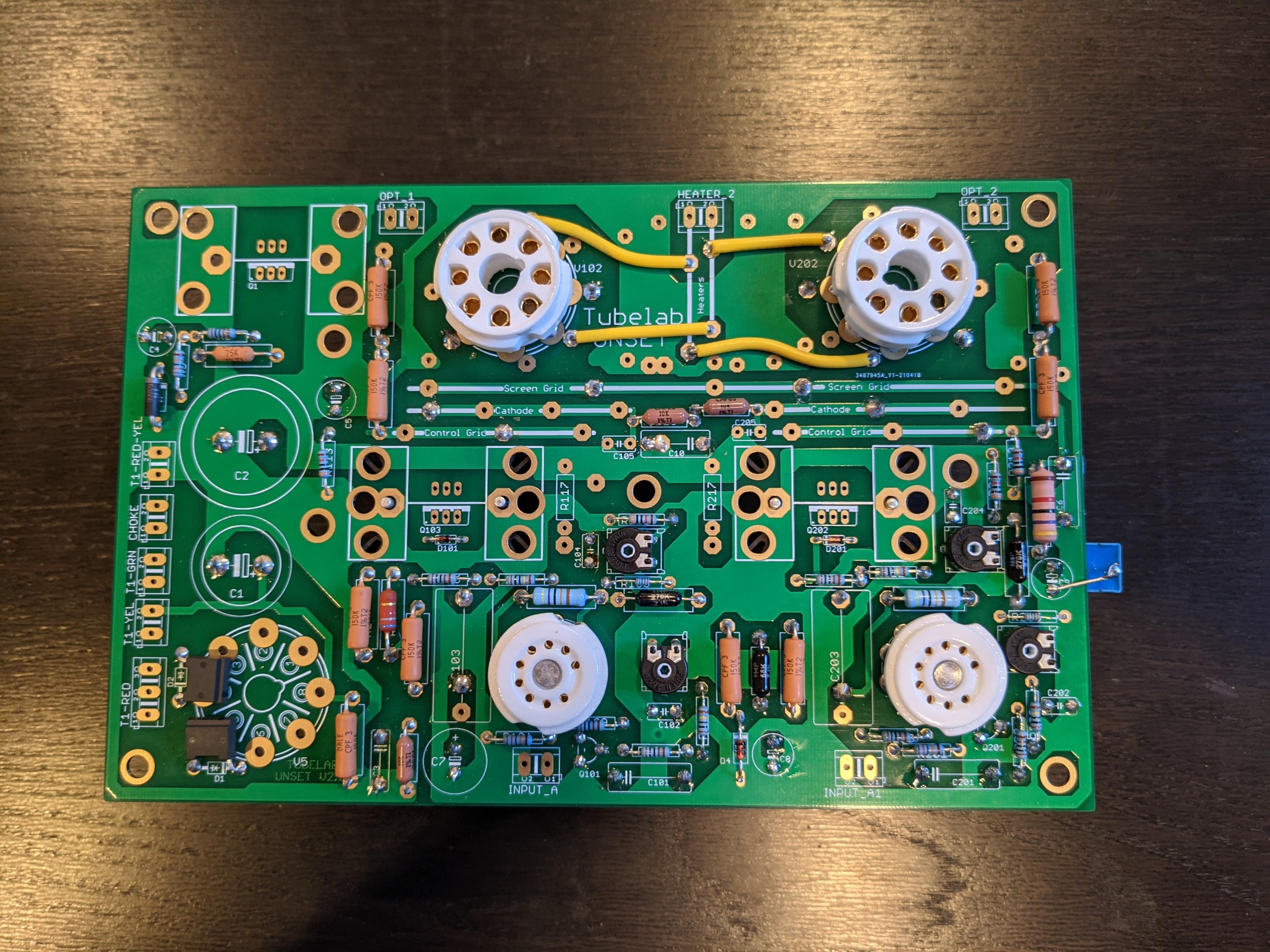

Last few parts came in and I finished stuffing the board. Put some tubes in it to see that everything fit. Next will be hooking up the power, choke, OTs then checkout. Any guidance on checkout? Can I generally refer to the TSE guide?
I usually follow a method similar to the TSE / TSE-II, with a bit more caution.
All of the signals in this board are in phase. Oscillation is more likely with this setup than in a typical two stage amp like the TSE-II. The board inputs and outputs are in phase as in a three stage SE amp. Inputs and outputs should not run next to each other. A messy bench like mine was what caused several
