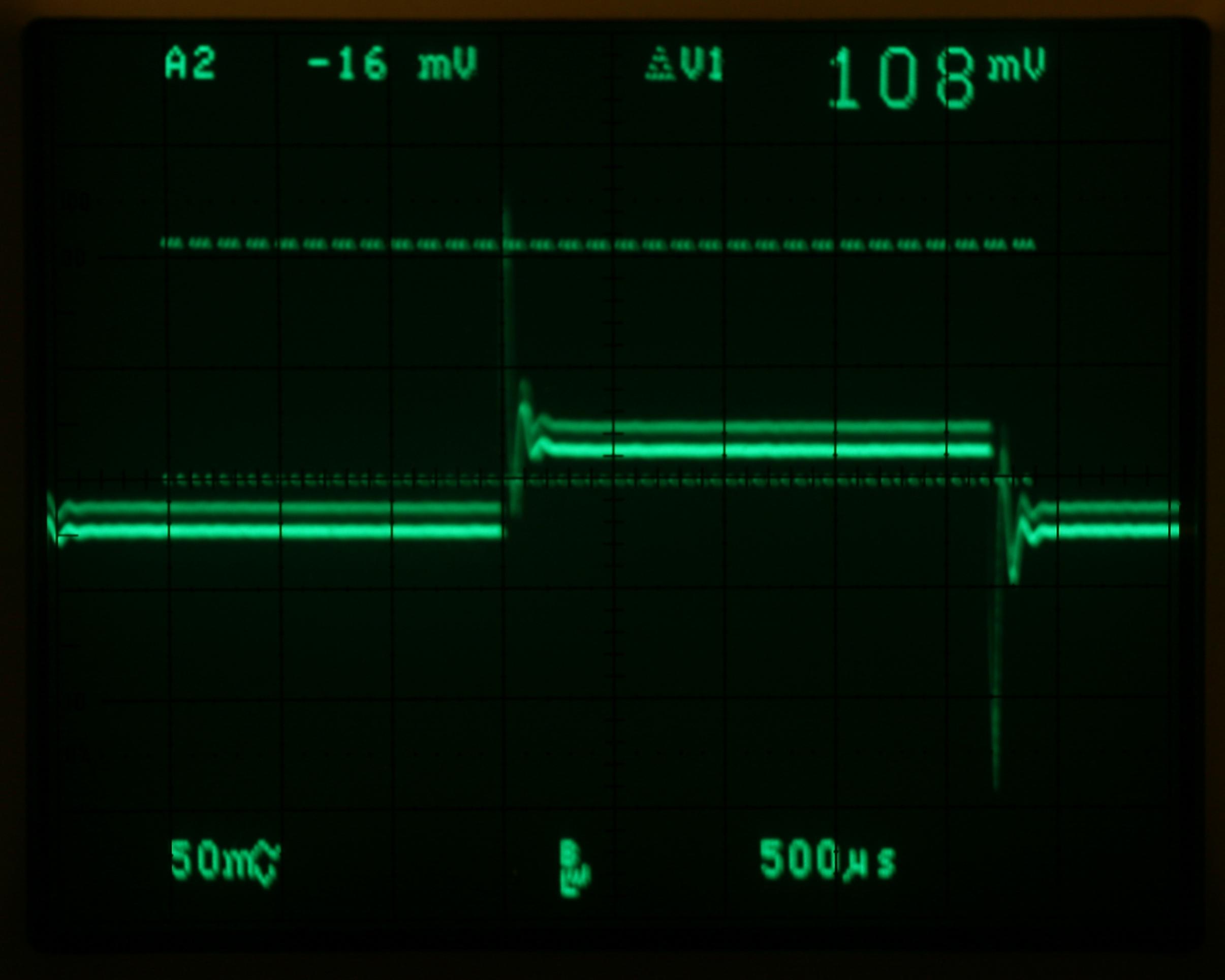

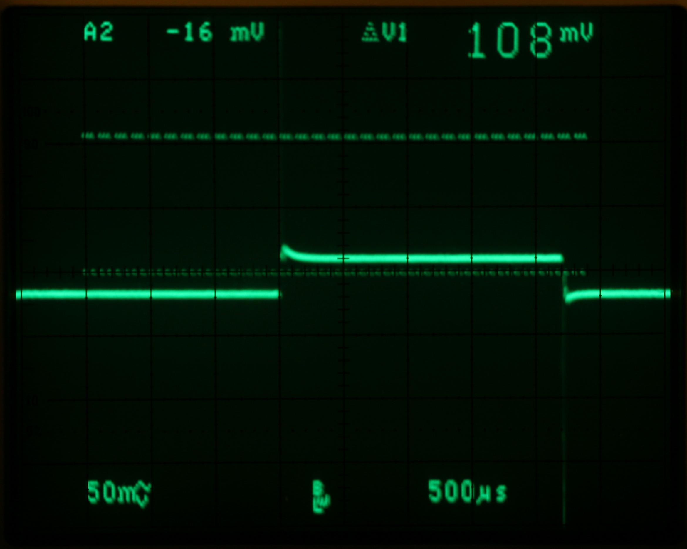

Latest developments
So... I played around with WebBench trying to find a good optimum. I discovered a few things.
1) I was running the LM22673 slightly above the recommended maximum of 180 uF for the output cap.
2) As a result, the control loop had pretty low phase margin, hence, poor transient response.

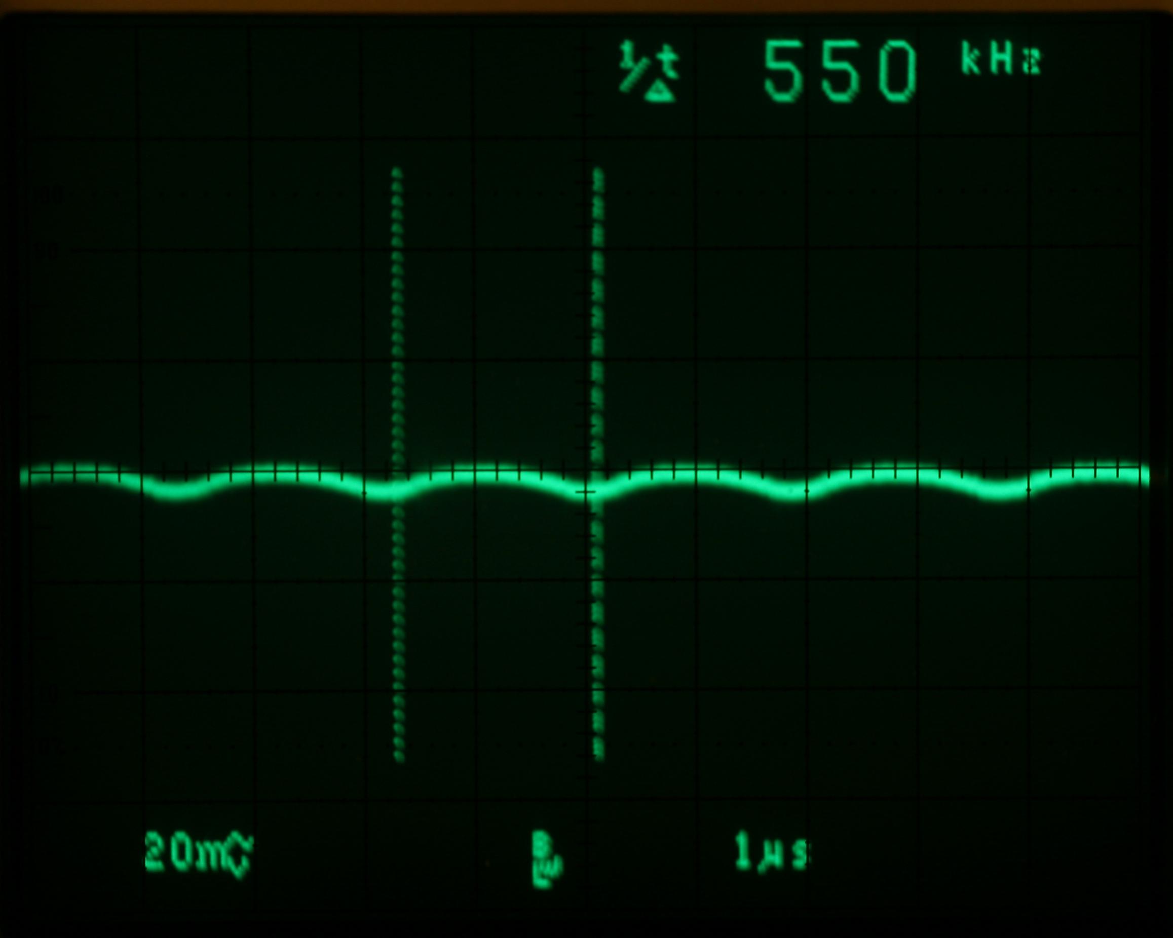

So, I swapped Cout for a 47 uF Murata X5R ceramic cap. The output ripple actually got lower (!) probably because the ceramic cap has a higher SRF (i.e. it works as a capacitor at the switching frequency). The transient response and output impedance improved as well.

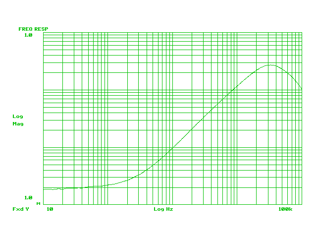

One trick I was taught regarding stability analysis was to look at the impedance of a node. If the node impedance has high-Q peaks in it, the circuit is likely unstable. With Cout = 200 uF, the Q was about 2. Now, with Cout = 47 uF, it's dropped to 0.67. This is supported by WebBench, which reports an improvement in phase margin from 40 degrees (Cout = 200 uF) to 58 degrees (Cout = 47 uF).
Attached shows the transient response with 200 uF and 47 uF. I'm not sure what causes the double-trace at 200 uF. Sorry about the voltage marker. That 108 mV means nothing. The ripple at 47 uF is shown as well (the ripple for 200 uF can be found in Post #69). Finally, the output impedance for 47 uF is shown.
The transient response was done with 1.25 A static current and a 63 mA step at 240 Hz or so. The output impedance was measured at 1.25 A static current and 94 mA RMS test signal.

If you just swapped output C, then that clearly indicates the ESL of the electrolytic. Ceramic smt would have to be the best option at any time you can physically stack it - maybe difficult for production, but manually stacking large smt format ceramics is always a neat method.
You should get some switching transient improvement from smaller footprint smt ceramic caps on input and output, probably placed on the underside, with the smallest loop distance of the switching loops.
Ciao, Tim
If you look at the first step response o'scope picture, you'll notice an extreme spike followed by 10-ish kHz ringing. The extreme spike, I bet is the ESL of the 'lytic. But the ringing is loop behavior.
I wasn't clear in my post above, but the 200 uF I used was actually 47 uF X7R ceramic + 150 uF electrolytic (one of the modern 7 mOhm ESR types by Nichicon). For the experiments with just 47 uF I removed the 150 uF cap and left the 47 uF ceramic cap in place.
I don't need to stack the caps. The output lead from the inductor is almost 10 mm wide, so I can put several ceramic caps side-by-side. But of course, in addition it is possible to stack the caps.
Pin 2 is Vin, so the input cap sits on the left side of the chip with a short trace running to pin 2. The other end of the input cap is connected to the ground plane. I basically ripped off NSC's layout (see page 13 of the data sheet). Placing the input cap on the bottom layer may reduce the overall trace length, but then you have to deal with vias and their inductance. I think I would have preferred the supply to come in from the left rather than under the chip to pin 2 then continue to the input cap. I may play with that... On the other hand, it works pretty well the way it is...

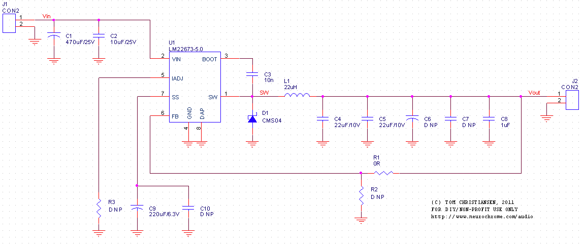

Latest musings

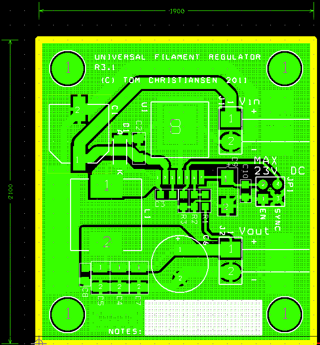

I've been playing with WebBench quite a bit lately. It looks like I can hit the required output voltages and currents without making any modifications to the board aside from changing out the inductor, output cap, and feedback resistor(s). But as the filament voltages usually aren't changed on the fly, I'm thinking that's an acceptable solution.
Attached is the schematic as well as the first stab at component placement on the PCB. Some routing required...
~Tom
~Tom

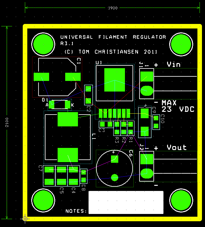

Tom, If you shift all the components to the right slightly you will improve the spacing between the two left screw holes and components. It looks like there is plenty of room to do so.
Yeah, I was mulling over that. J1, J2 are right-angle connectors and like to sit far from the board edges. I suppose, I could let them hang outside the board by a few mm... I need to get my paws on a handful of connectors and see how they work out in real life.
I am a bit concerned by the stresses from the mounting holes -- especially on the ceramic caps.
~Tom
I prefer to have the polarities match. Part of that is my general neurotic state. But part of it is also ease of assembly or ease of use. It's bad enough that they're both 2-pin connectors. Someone will eventually hook the DC in from the rectifier to Vout...
With a ground plane on both sides, the (-) connection to Vin is easy. The (+) connection will be a tad long -- especially if C1 is rotated -- but with an 80-mil trace it really shouldn't matter much.
Another suggestion that's come up, is to bring out pins 5 and 7 to a header. This would allow for all the various LM2267x options to be used. Pins 5, 7 are used for current limiting, sync, enable, and other stuff depending on options. They all require a 0805 (or similar) component to GND, so they could share the same layout. That's an option under consideration anyway. It's not really relevant for my particular build, but would allow for more flexibility when using the board in other applications.
~Tom
~Tom
After some mucking around...
Top layer + top silk shown. Bottom layer is a solid plane (aside from the holes for the output cap, connectors, and thermal vias of course). The top and bottom layers are stitched together with some via matrices (79 vias total).
~Tom
