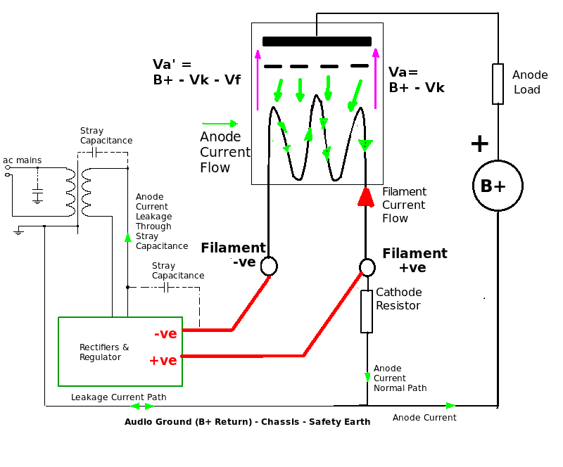

Tom, The convenience is unbeatable, and for IDHTs it will be a winner. For
Directly Heated Triodes, though, the sonic performance will be some way short of
what is possible, for a number of reasons:
- Anode [plate] current in the filament: looking at the sketch attached, the
anode current flows in the filament substrate [ie the wire] to supply the
emission sites all along the length of the filament.
In a 300B DHT, running the standard 60mA, the portion of the filament nearest
FIL+ will carry the whole 60mA, with lower fractions of current found as you
work back toward FIL-.
Keeping Kirchoff in mind, the anode current and the Filament current flow
together indistinguishably in the filament wire. SO - Any disturbance in the
filament current supply will directly reflect as a disturbance in the anode
current - and remember, the 300B output is the anode current - it's not a
voltage!
This is a real risk to the quality of the 300B stage. Consider this: the little
10mV spikes on the switcher's output seem innocent enough - but what happens to
the current? Well the 300B filament is 5V 1.3A = 3.8 ohms [hot]. 10mV peaks give
2.7mA peaks of current in the filament.....which is imposed directly on the
anode current [since this is much higher impedance circuit than the filament
supply's]. This amounts to a 4.5% distortion current on 60mA. Of course, this is
mostly ultrasonic energy, but not entirely, since the duty-ratio of a
buck-converter bounces up & down with the input voltage, which in this case will
be the raw dc ripple and mains noise. This effect will produce large amounts of
spectrum at audio frequencies.
This current-mixing effect is the reason why simple Bridge + Cap dc heated DHTs
sound worse than any other heating method. In this case, the filament current is
modulated by many mA of ripple current, plus the rectifier recovery **current**
pulses, which start life at the 1.3A level equal to the dc current.

ac heat also forces the anode current to be shunted around the transformer
secondary winding, where it is exposed to magnetic and electrostatic noise, and
bad dielectrics.
Other problems to be tackled:
With a switcher the output cap may be 100uF or so, which may present 50 ohms or
so at bass frequencies. This is shunting the filament, whose impedance is about
4 ohms at all audio frequecies, as above. Now we have the anode current taking a
frequency-selective diversion around the output cap, opening the risk of
colourations, both from the frequency-selective shunting, and from forcing
some of the anode current through electrolytic and high-K ceramic switcher-caps!
This is one of the reasons that a high-dynamic-impedance CCS improves DHT
heating, since the anode current remains contained within the cathode circuit,
and does not get diverted around the filament heating circuit.
The other reason CCS drive sounds so good is because the feedback for the
heating current does not sense at the filament terminals. This is important,
since the filament terminals do not distinguish between the anode-current
signal and the filament current, and you wind up mixing the anode current into
the closed loop of the heating current. CCS heating senses the filament supply
current ONLY, at the supply input, and does not sense or influence the anode
current in any way. This advantage cannot be had by any circuit which senses the
filament voltage.
CCS heating with 3-terminal regulator ICs also falls short - partly because
their input terminals do not adequately reject anode signals at the input, and
partly due to their excessive voltage noise, which translates into current
noise in the anode current.

- Anode [plate] current in the filament: looking at the sketch attached, the anode current flows in the filament substrate [ie the wire] to supply the emission sites all along the length of the filament.
In a 300B DHT, running the standard 60mA, the portion of the filament nearest FIL+ will carry the whole 60mA, with lower fractions of current found as you work back toward FIL-.
You are making the assumption that one electron in the space-charge cloud is distinguishable from another. That argument is false. I'm sorry... Physics just don't work that way.
This is a real risk to the quality of the 300B stage. Consider this: the little 10mV spikes on the switcher's output seem innocent enough - but what happens to the current? Well the 300B filament is 5V 1.3A = 3.8 ohms [hot]. 10mV peaks give 2.7mA peaks of current in the filament.....which is imposed directly on the anode current [since this is much higher impedance circuit than the filament supply's]. This amounts to a 4.5% distortion current on 60mA.
If the switching spikes really caused 4.5 % distortion, I'm sure I would be able to pick it up with my HP 8903A distortion analyzer. It's noise/distortion floor is 0.002 % THD+N.
Of course, this is mostly ultrasonic energy, but not entirely, since the duty-ratio of a buck-converter bounces up & down with the input voltage, which in this case will be the raw dc ripple and mains noise. This effect will produce large amounts of spectrum at audio frequencies.
A well designed regulator (like any modern switching regulator) is designed to be as immune to variations in the input voltage as possible. This is characterized in a figure called line regulation. What you are describing above sounds like an unstable system. A well designed regulator is a stable system. A well designed regulator will provide a constant output voltage for any variation in load or input voltage (within limits, of course).
In any event, should this regulator turn into a happy bounce house with duty cycles varying all over the map and causing nasty, nasty audio frequency intermodulation products, I'm absolutely certain that it will be picked up by my HP 3562A dynamic signal analyzer. Its -145 dBV noise floor can hear the grass grow, trust me. In previous experiments, no switching-induced IM products were found. In fact the 120 Hz, and 240 Hz components were reduced by almost 20 dB by the switching supply due to its better line regulation.
This current-mixing effect is the reason why simple Bridge + Cap dc heated DHTs sound worse than any other heating method.
Except for the "current-mixing effect" which I believe is bogus as outlined above, I am willing to buy that statement. Double-rectified and smoothed DC is a rather nasty waveform with a lot of harmonic content. Also, in applications where significant current is drawn, the ripple voltage becomes harder to keep within reasonable limits. Hence, the amplitude of the nasty harmonic content becomes sizable and will couple into the circuit. This forms various IM products that can easily be picked up by a spectrum analyzer (such as the 3562A I mentioned before).
With ac heating, the effect of 50/60Hz current is cancelled by means of an unbalanced pot, which equalises the 50/60Hz current in each half of the filament.
Between the cathode/filament and grid is a coupling capacitor. This capacitor is not a real capacitor (i.e. physical component) but rather a parasitic capacitor. Unfortunately, the way physics work is that when you have two conductors in proximity of one another they form a capacitor whether you want it or not. So any AC voltage present on the cathode will couple to the grid (and anode). It doesn't matter if this voltage is the 2~3 mVpp @ 800 kHz that comes out of my regulator, or the ripple/noise that's present on the output of a constant current source regulator, or the AC from a filament winding on a transformer. But in case of the filament winding, the voltage on one end of the coupling cap is 6.3 VAC. That's a sizable voltage. By using a humdinger pot, this voltage is reduced to 3.15 VAC. That's how a humdinger works. It has nothing to do with electron emission. It's simple capacitive coupling.
ac heat also forces the anode current to be shunted around the transformer secondary winding, where it is exposed to magnetic and electrostatic noise, and bad dielectrics.
No it doesn't. Poor circuit design forces the anode current to return to the mains. In a well-designed circuit, the AC signal path for the anode current consists of the OPT, the output tube, and a high-quality cap from the cathode to the B+ end of the OPT primary. See Loftin-White for more information. This trick has been employed in modern measurement gear as well, by the way.
I did read through the rest of your response - including the website you linked to. I considered picking the arguments apart one by one, but as I said to begin with, I don't want this thread to turn into a flame war.
My fundamental point is this: A well-engineered, well-designed circuit will have superior performance over one that is not well-engineered or well-designed. I intend to design a filament regulator that performs well both when considered as a stand-alone voltage source and when used for a filament supply in either a directly headed triode or an indirectly heated tube. I will back up my claims with measurements and I will base my design decisions on facts and measured data. To me - as an engineer and a scientist - that's a reasonable approach. Others are free to disagree.

is also coated with emissive [cathode] material, and emits electrons towards the
anode [plate], which form the anode current. One [or both] of the same
filament terminals is connected to the anode supply's return path.
Therefore, filament current and anode current flow in the same conductor.
Therefore noise and disturbance in the one current are added to the current of
the other. We can ignore the question of distribution across the length of the
filament [for now] - since even if the anode current flows across a tiny
portion of the filament wire, it will still MIX with the filament
current.... it has to because the filament current must flow through every
part of the filament wire, by definition. The diagram I posted [#23] illustrates
what I say here.
For there to be no current mixing, the filament heating current would need to
flow on a different conductor to the "cathode" of the tube..... but then we
would not have a DIRECTLY heated triode.
This is the great difficulty with DHTs! Because of current-mixing, they respond
to minute attention and care to the heating circuit, because the errors
in the heating circuit are imposed upon the the anode current.
We may have built a wonderful regulator for 5V 1.3A supply, and measure
artefacts in the voltage output to be 0.1%. Ok, so 5mV in 5V, great.
But, connect a 4 ohm load [=300B filament] and you get artefacts of 1.3mA,
imposed on a 60mA signal current - > 2%, of full output signal. That's the
reason dc-unregulated [and some regulated] filaments still hum!
With listening tests, this effect is obvious. To me and many others... so if
you don't measure it, well, come on - let's dig into the analysis and find out
where the energy is going. I am genuinely and openly interested to explore it.

Tom, the aim of my post was to offer a critical analysis of the switcher solution. I used the data you displayed, and calculated some likely effects.
The current mixing effect is supported perfectly by Physics - it's simply Kirchoff's Current Law: We have two currents entering/emerging from one conductor, therefore Kirchoff Rules, No exceptions.
But, if you won't entertain my criticism, fine. I leave it for others to make of it what they will.

Here's the noise mechanism:
The filament is a length of wire with a thin coating. There are emissions from all along the length of the coating - but how do the electrons get to each point along the coating? Along the substrate wire!
But this same piece of wire is the conduit for the heating current, therefore we simply face the situation where our signal current is sharing a conductor with a 1.3A heating current.
It's not fancy (or mythical) physics, or conjecture, it's just simple realisation that you have two currents - one sensitive and small, one big and burly - piped along the same dumb piece of wire.
