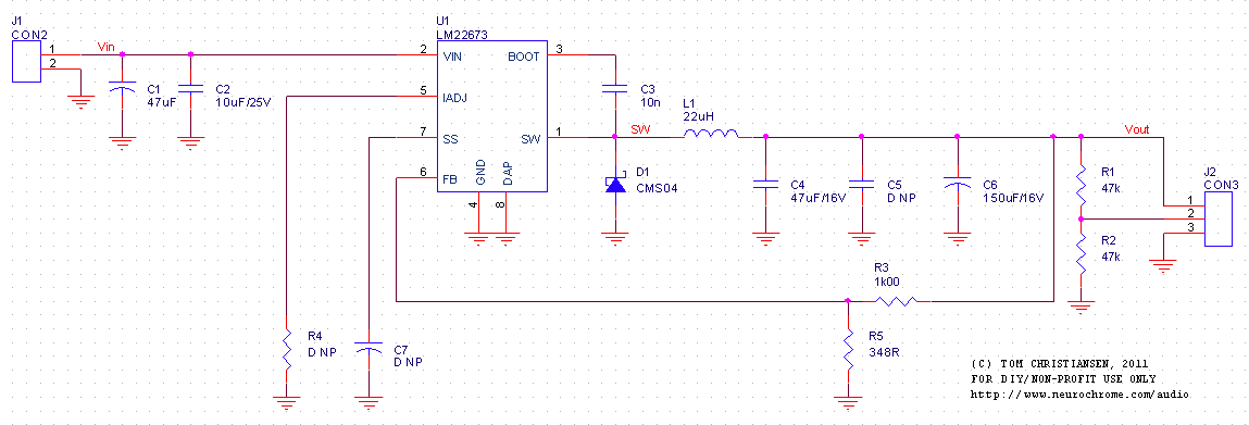

Trying the LM20333 to get a little more output current capability (3.0 A vs 2.5 A) and I'm also hoping to gain a little more efficiency. The LM20333 has the option of using an external schottky diode in parallel with the synchronous MOSFET. This should yield slightly higher efficiency (--> less heat dissipated).
I just threw the schematic together. I'll need to get crackin' on the board layout and test.
~Tom

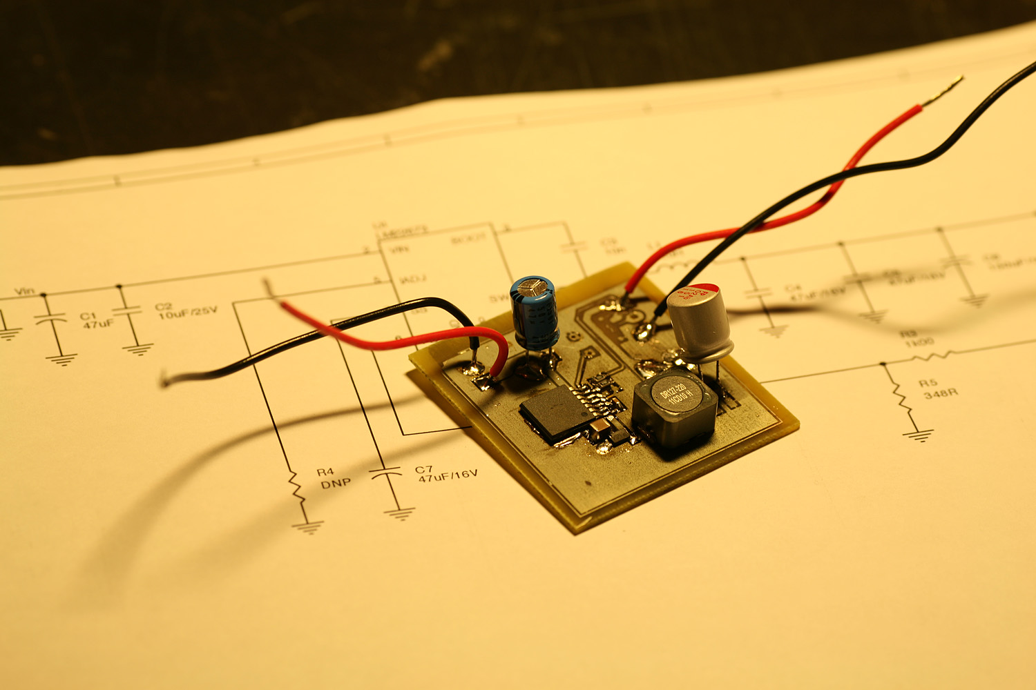

So thus far I've tried the LM3102, LM20333, and LM22673.
The LM3102 and LM20333 are both in 20-pin eTSSOP with exposed DAP that need to be soldered to the ground plane for heat dissipation. The LM3102 is a constant on-time (COT) regulator, the LM20333 is a traditional current mode regulator.
As I've reported earlier, the LM3102 is rock solid. But I find it to be a tad marginal for use with, say, a 2A3 that requires 2.5 A for the filament as the LM3102 is a 2.5 A regulator. Hence, I've been on the hunt for a 3 A regulator.
The LM20333 is a 3 A regulator. It works just fine, but the ripple voltage on the output is on the order of 30 mVpp (2 A load). The pin-out of this chip is not the most efficient for a 2-layer board layout. Both the input voltage, ground, and switch node are pinned out on both sides of the chip. Hence, the most efficient layout is to route Vin down from one end of the chip and the switch node up from the other end. However, that reduces the thermal path to the DAP to around 5 mm in width. So the chip gets rather hot in normal operation (about 90 C after 30 minutes of delivering 2 A @ 5 V). Granted, I don't have thermal vias in place on my prototype, but still...
Then I stumbled upon the LM22673. 3 A output current, TO-263 Thin package with exposed DAP (very hand-solderable), a very intelligent pin-out, and traditional voltage control with internal compensation. What's not to like?
So far I like it. After 30~45 minutes running flat out at 2 A, 5 V out, the top of the chip is 45 degrees C. The board and surrounding components are barely above lukewarm. The DC load and line regulation are quite impressive.

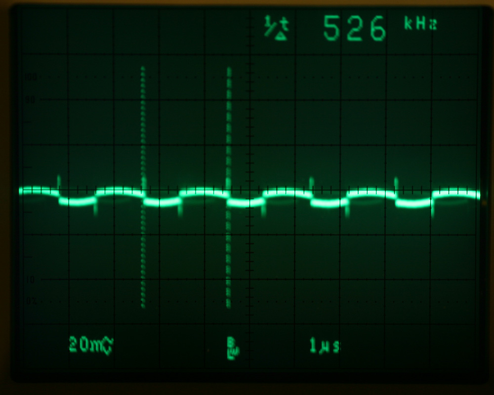

Here's a brief recap. Attached pictures show the LM22673 schematic, setup, and measured ripple (20 MHz BW).
LM3102:
Efficiency (12.8 V in, 5 V @ 2 A out): 87.4 %
Ripple voltage (5 V, 2 A out): Approx 8 mVpp
Line rejection (change in Vout for a 10 V change in Vin): 36 mV (49 dB)
LM20333:
Efficiency (12.8 V in, 5 V @ 2 A out): 89.5 %
Ripple voltage (5 V, 2 A out): Approx 30 mVpp
Line rejection (change in Vout for a 10 V change in Vin): 4 mV (68 dB)
LM22673
Efficiency (12.8 V in, 5 V @ 2 A out): 90.7 %
Ripple voltage (5 V, 2 A out): Approx 6 mVpp
Line rejection (change in Vout for a 10 V change in Vin): 1.1 mV (79 dB)
Load regulation (change in Vout for a 2.37 A change in Iload): 600 uV (72 dB)
For those doing the math at home, the 600 uV change in Vout for a 2.37 A change in the load current amounts to an effective output impedance of 253 uOhm. Yes. uOhm...!
And the winner is ..... the LM22673.
~Tom

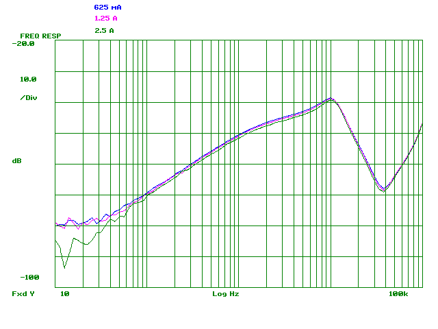

I finally had a couple of hours of free time to work on this filament regulator project. I've measured the line regulation (ripple rejection) for three different output currents at 5.0 V out. See attached.
At 60 Hz, the ripple rejection comes in at 75 dB. Not shabby...
Now I need to go and build a test rig to measure the load regulation.
~Tom

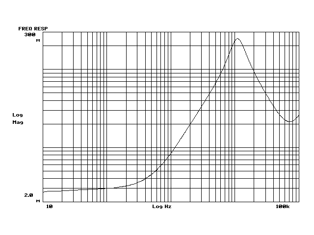

Now that the rainy season has officially started, it's time to start up on the filament regulator project again.
I put together a test rig to measure output impedance. The results are attached. < 3 mOhm @ DC. The peak at 10 kHz is the resonance of the output LC filter. The Y axis is the output impedance in ohms. (300 mOhm at the top of the chart, 2 mOhm at the bottom).
~Tom
