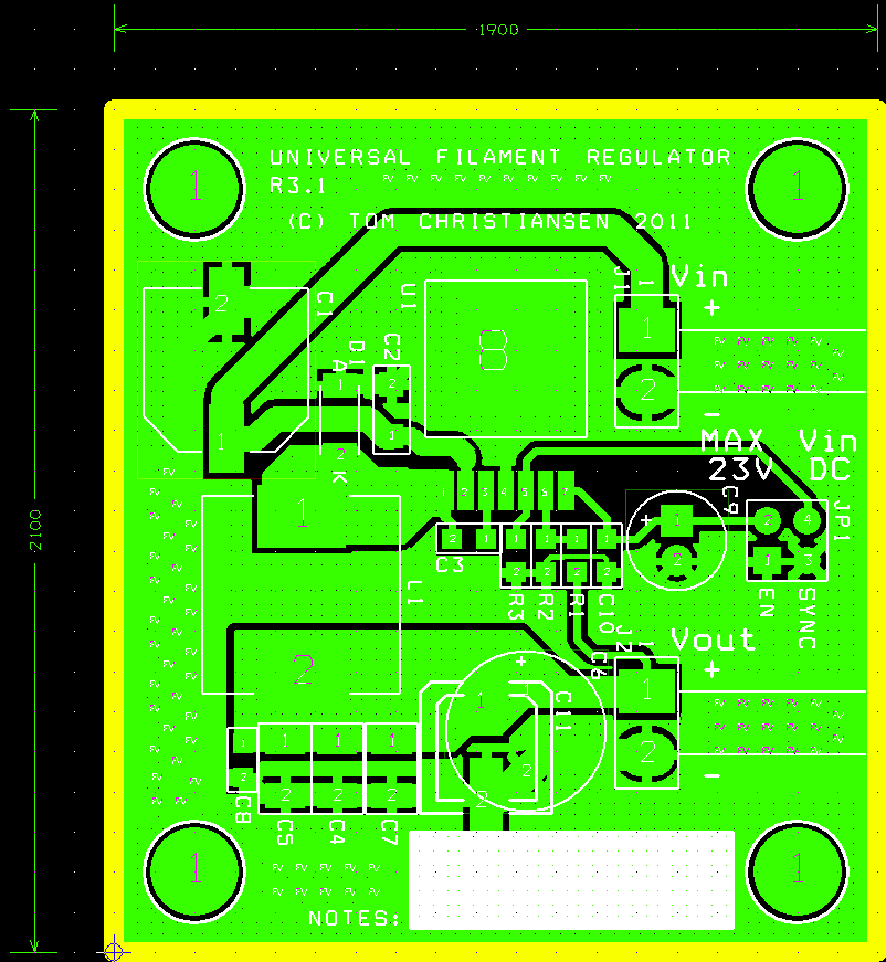

One thing I would like if possible is to have through hole headers for input and output so it could be possible to stack on another board in addition to the connectors you are using. Do you think this would be possible? Either way I am very interested.
Thanks,
Chris
If you're driving multiple boards by the same input voltage, you could run some solid core wire between the boards. The connectors I use are through-hole.

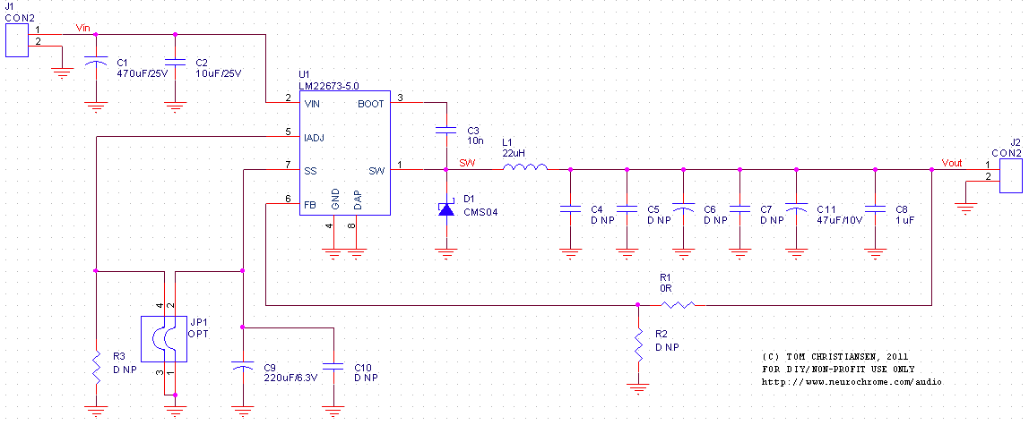

Note that the filaments supplied by each transformer winding will need to be at the same potential. So if some filaments in the amp are required to float at different potentials (to avoid breaking down the filament-cathode interface for example), they will need to be supplied by separate transformer windings. Hence, they won't be able to share Vin -- or even ground.
In case of directly heated tubes, you'll need one regulator per tube. Just like you need one transformer winding per tube. If one end of the filament is connected to ground for all the tubes you're driving, you could run them on the same Vin but using separate regulators.
Does this make sense?
Do NOT run regulators in parallel to get higher output current. Use the LM22679 for up to 5 A output current. If you need more current because you have many filaments in parallel, separate them out on multiple supplies. If you need more than 5 A out, you'll need a different regulator.
Why couldn't you run two DH filaments in parallel if both 'grounds' are connected and it doesn't exceed the current limit?
This supply could be approximated by an ideal battery. If both negative terminals of two identical batteries are tied together and they are driving equal loads, what does it matter if I replace the two batteries with one that is twice as big and connect it to two loads at once? The load is going to be anchored to the same reference and at the same output voltage and the supply is ideally zero output impedance...
If you intend to tie both cathodes together then this is fine.There are very few topologies where this is acceptable. Two output tubes - not, PP output Yes, LTP-not, Multiple gain stages - not...
I'm really still not on the same page with you on this. I can think of ways to make all four of these work. In most designs, it doesn't work because cathode bias is frequently used. You can't share supplies because there is no common point to hang these supplies since each tube needs to develop its own voltage to bias itself (excluding shared cathode resistors, of course).
Specifically, Tom stated that "In case of directly heated tubes, you'll need one regulator per tube. Just like you need one transformer winding per tube. If one end of the filament is connected to ground for all the tubes you're driving, you could run them on the same Vin but using separate regulators."
If one end of the filament is connected to ground for all the tubes I'm driving(they are not cathode biased with individual cathode resistors), and they are equal filament voltage, and the regulator can put out the current, what exactly is stopping me from doing this? I know I just tied them together, but why is that a bad thing since I was going to tie them to the same place, ground, individually anyway?
If the regulator was indeed an ideal battery, SpreadSpectrum would be right. If one end of both cathodes is at ideal GND, then the other ends of both cathodes/filaments (assuming DHT here) could be tied to the ideal battery. The regulator is very close to an ideal battery -- at least at frequencies below the resonance frequency of the LC output filter (10-ish kHz). However, its output impedance is finite and non-zero. Hence the cathode currents from the two tubes could potentially interfere with each other. It really depends on the ground impedance as well as the output impedance of the regulator.
My advice would be that you need a separate regulator per directly heated tube. Or, say, you convert a design from AC heating to DC heating, you'll need one regulator per transformer filament winding.
For indirectly heated tubes, you can use one regulator to power several tube heaters as long as the heaters are to float at the same voltage.
Latest board incarnation attached. The multiple output caps are options. You'll see that only one is populated.
~Tom

Thanks for the response, Tom. It sounds like you are worried about signal(or some undesirable noise/distortion) coupling between the filaments in the shared supply. Is that what you mean by the cathode currents interfering with each other? Please explain if I have this wrong.
I am planning on using two regulators for four 841s. Each regulator would see a total load of 7.5V @ 2.5A. These are fixed bias, sharing a negative filament supply reference. They are also CCS-loaded so there would be very little plate current swing, just plate voltage swing.
I guess I could do four regulators but I only want to do so if there would be a real benefit. What do you think?
More a coupling between the cathode currents. Let's say tube A runs at Ia AC anode = cathode current. This creates an AC voltage on the filament regulator output that's Ia * Zout, where, Zout is the output impedance of the regulator. If tube B's cathode is connected to the same regulator, this means tube B's grid-to-cathode voltage will have an AC component on it that's Ia * Zout. In addition to whatever AC component is in tube B's anode = cathode current.
I think the effect will be minuscule -- at least near DC, but I can't deny it's there. I would expect a significant effect at frequencies near the LC resonance.
First off, I suggest using WebBench (National Semiconductor | High-performance Analog) to work out the inductance and Cout. Note that the DC resistance of the inductor as well as the ESR of the output cap play a role in the overall stability of the regulator. So you wan't to buy the right parts.
Do the tubes operate in parallel? If so, you could tie the two tubes that are in parallel to one regulator. I don't see a big issue with that as the cathode currents of the two tubes in parallel should be nearly identical.
I think there would be a benefit, but I can't quantify how much. You could start with two boards and get another two if you don't like the results.
~Tom
