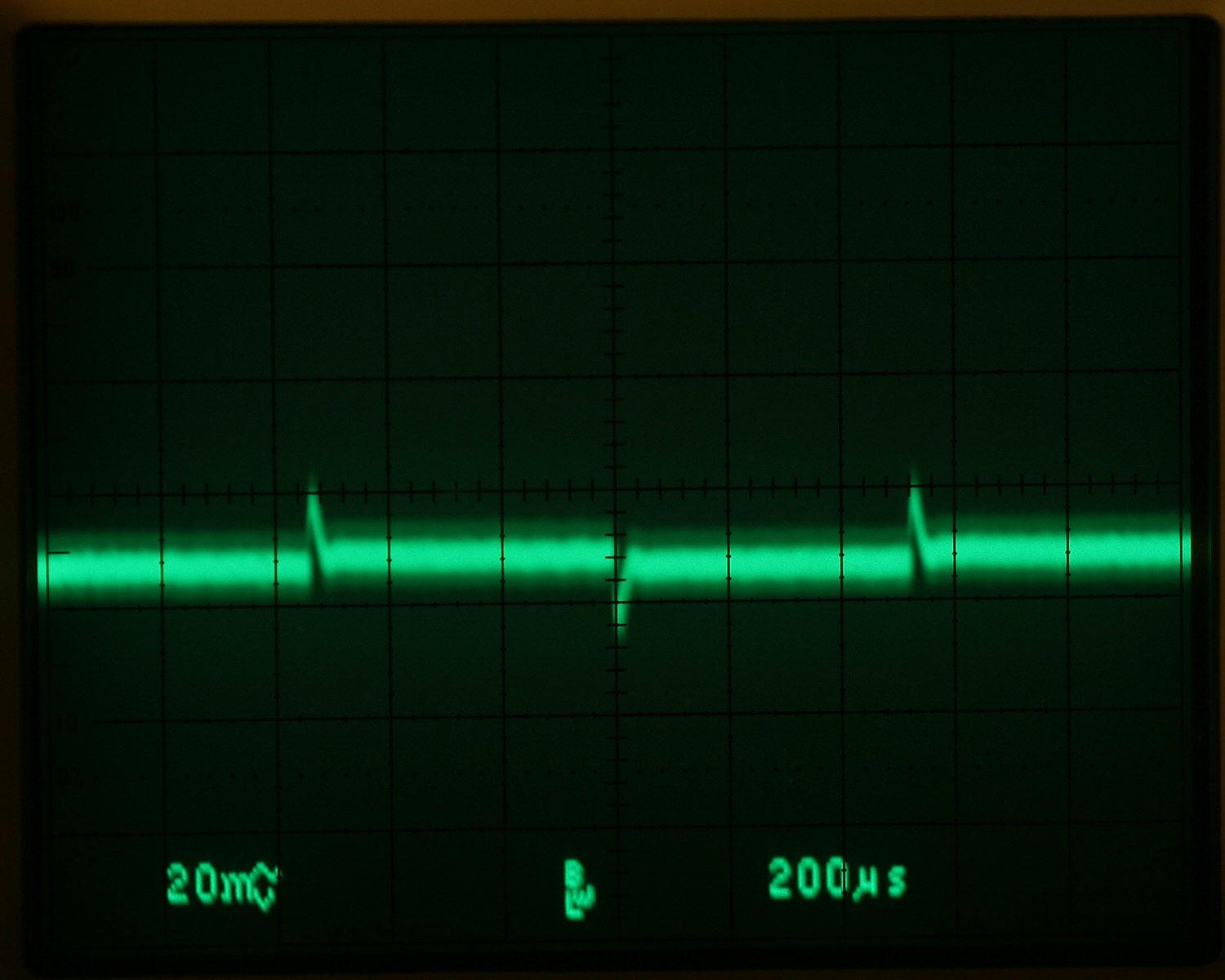

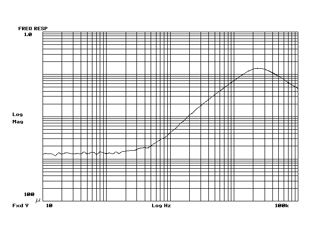

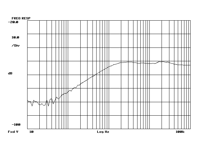

Attached are Transient Response (1140 mA DC + 100 mA step); Line Regulation (ripple rejection) in dB; Output Impedance (1.24 A DC + 50 mA AC) in Ohm for the 7.5 V, 22 uH, 47 uF, LM22673-5.0 option.
