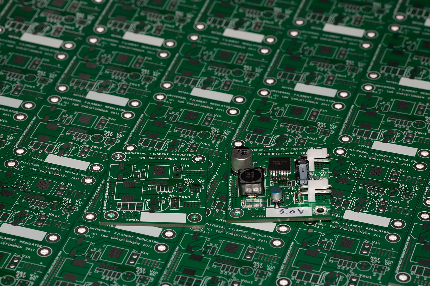

Folks,
The boards arrived a day early. They'll be in the mail today. Thank you to all who pre-ordered.
I assembled one board. With 15 V in, 5.0 V out at 1.55 A the regulator IC barely gets warm. On the top of the IC package, I measure 31 degrees C. I'll post more results as I have them, but for now I'll focus on getting my website updated with design documentation of the filament regulator.
~Tom
Soldering the IC is actually pretty easy once you know The Trick™ 🙂
The Trick is to arm yourself with a good soldering iron with a big tip (big thermal mass). I use a 6.3 mm wide chisel tip on my Metcal. Then cover the thermal pad on the board with solder. Use enough to plug the thermal vias and leave a light coat on both the top and bottom side of the board. Then lightly coat the DAP on the IC with solder. "Lightly" is key here. Use enough to cover the DAP but not so much that it forms a bump. Apply flux to the thermal pad on the board and the DAP. Place the IC on the board and heat up the thermal pad from the bottom. Once the flux has boiled off you should watch the solder melt and the IC center itself on the footprint thanks to the surface tension of the solder. Once that happens, remove the soldering iron and let the board cool down.

So far I've tested 5.0 V @ 1.5 A; 6.3 V @ 1.2 A; 7.5 V @ 1.25 A; and 7.5 V @ 2.5 A using the values in the Known Good BOM spreadsheet. The output voltages come in within 1~2 % of the target value, which is about as good as one can ask for. The output impedance looks good and indicates better loop stability than I was seeing with my setup a few months ago due to better choices of output capacitors. I still need to look at the transient response, though.
I'll post pictures when I have a little more data together.
