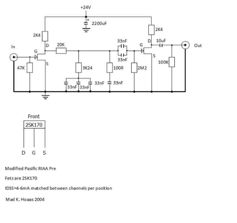

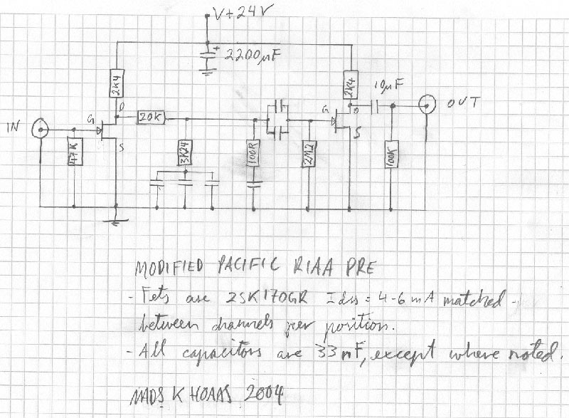

Hi Mad, Your schematic shows a 2k4 on the darin of the first Jfet, but your explanatory notes specifies an 22k4. Please clarify. Thanks!
Hi aplt
It is a 2K4 to both the JFET drains on Mad_Ks original schematic. 🙂

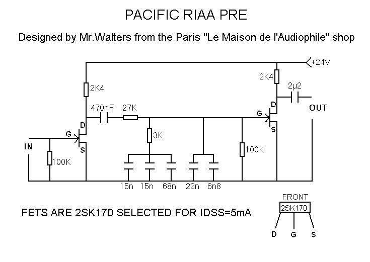

... & Mr. Walters from 'Le Maison de L' Audiophile', Paris ... original 'Pacific' schematic.
Thanks! You can't be too careful with this stuff. Does anyone have the circuit for the Salas version? Sound comparison?![]()
