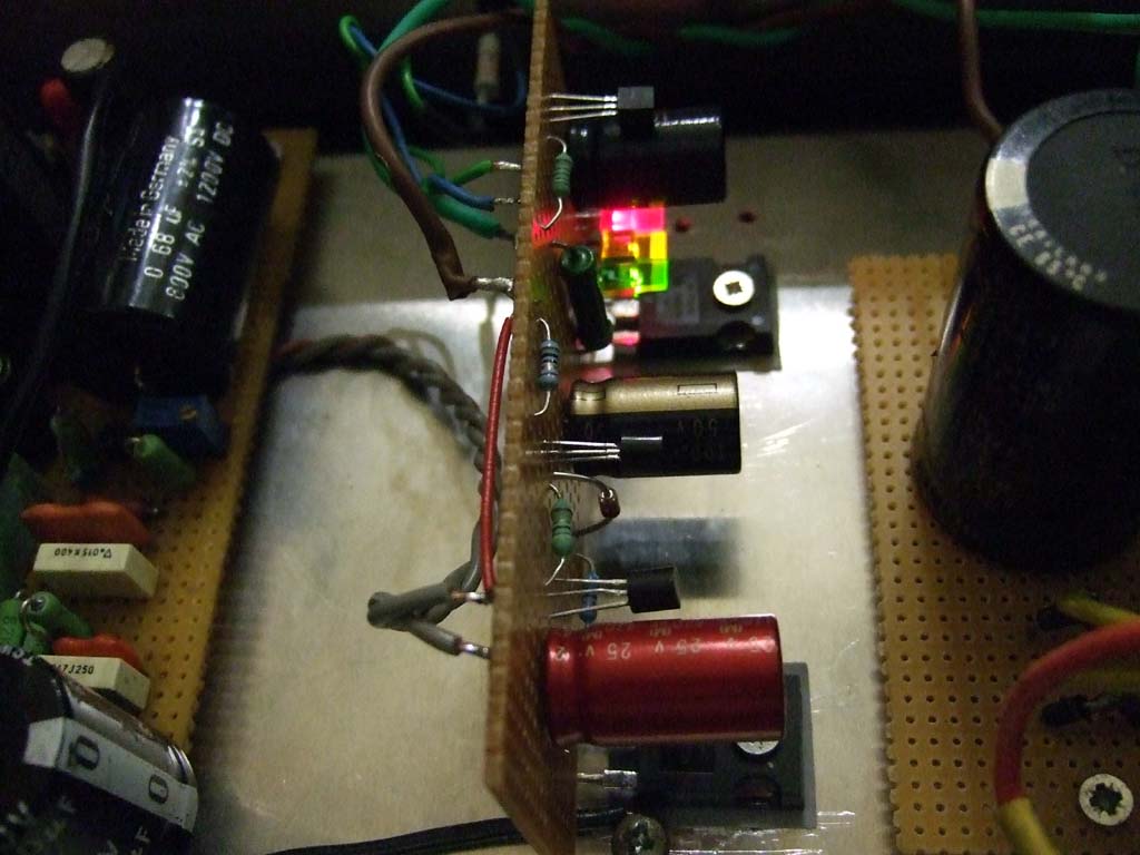

thank you ionian! i was looking at the silver output caps myself, however these are a bit out of my price range at the moment and my system is only middle of the range as far as good systems go, so ill stick with the 10uf mcap for now... ill create my own thread when i havethe parts to start building it so you can all see what im up to... i still cant decide weather or not to use batteries, as i want to fit a tube buffer stage to it, but ill keep you informed!
would 3k3 do?
It is <2% high.
Does that 2% matter in this location?
If it does matter, then trim the 3k3 with a larger parallel resistor.
180k || 3k3 ~=3k2406 +- the tolerance of the 3k3.
Alternatively 3k0+240r = 3k24 +- tolerance of the 3k0.

ok, i have built the circuit and tested it, wow! it sounds fantastic! however the gain is too low for my carts, can someone suggest a way to increase gain in this preamp if possible, if not, could someone suggest an lsk170 preamp to add some gain? i was looking at using tubes to do this at first, but i like the idea of using batteries!
thanks in advance, will post pics soon!

Q6 and Q2 are not good for this circuit.
Q1 & Q6 form a cascoded common source amplifier. Similarly for Q4 & Q2.
To get good performance from the common source amplifier the Vds of Q1 and Q4 need to be >2*Vp (Read Borbely).
Lsk170 for Q6 and Q2 cannot get you sufficient cascode voltage to meet Borbely's voltage condition.
You should have a high Vp device for the cascode, not a low Vp device.
A low Vp device can usually be identified by very high gm.
A high Vp device can usually be identified by a low gm.
You need to select a low gm device, then measure the Vp.

Thanks AndrewT.
What volume would you recommend of Borbely? I went to his website and there are loads of volumes are there any in particular that are specific to cascode configurations in preamps?
Suprisingly it actually sounds pretty good at the moment. Not quite sure how if Q6 and Q2 cannot provide sufficent cascode voltage.

Measure Vds of the amplifier jFET.
It will almost certainly be less than 2*Vp. It will probably be less than 1*Vp.
The Vds of the amp jFET is also the Vgs of the cascode jFET.
High gm jFETs have a low Vp. An Id between Idss and 1uA (for Vp) results in a Vgs <Vp but greater than 0V
Borbely published a 2 part treatise on jFETs discussing their characteristics, how to test, how to select for duty, how to bias for good and very good performance.
It is worth reading all FET articles that Borbely released. They are gems worth remembering.

Andrew's perfectly right.
A proven and really good combination are the 170 and a 4391 either in throughhole as 2N4391 or in SMD as MMBF4391 or SST4391.
The 4391 will give the 170 a drain source voltage of around 4-5V.
Also the 4391 are lownoise, low capacitance types, preserving the very lownoise character of the 170 and allows for high bandwidth.
For MM useage the 4391 and its little brethren 4392 and 4393 would already be low enough in noise.

Calvin, thanks for your suggestion. I got some 4391 to try out. I placed the 4391 into the circuit. I noticed that the Idss of the 4391 is between 50mA and 150mA, my LSK170 has an Idss of 5mA. How do I calculate the new value for R8?

I have calculated the required resistance values for a common source LSK170B amplifier (See below) however when I introduce the 2SK246BL as a cascode how do I introduce this into the equations? Doesn't this reduce Id and therefore alter the required Rd and Rs resistance values? Should the Idss of the LSK170 (8mA) match the Idss of the cascode JFET (2SK246BL)?
Many thanks
Dom
the current trough the Master JFET Q1 is still defined by its source resistor.
It'll be slightly lower than uncascoded, as its DrainSourcevoltage Vds will only be the GateSource voltage Vgs of the cascoding JFET.
To determine the Vgs see the Id-Vgs graph in the Datasheet and find the Vgs for the Id value of Q1 (5mA).
For the 4391 this will be around -4 to -5V.
This is more than sufficient for SK170.
