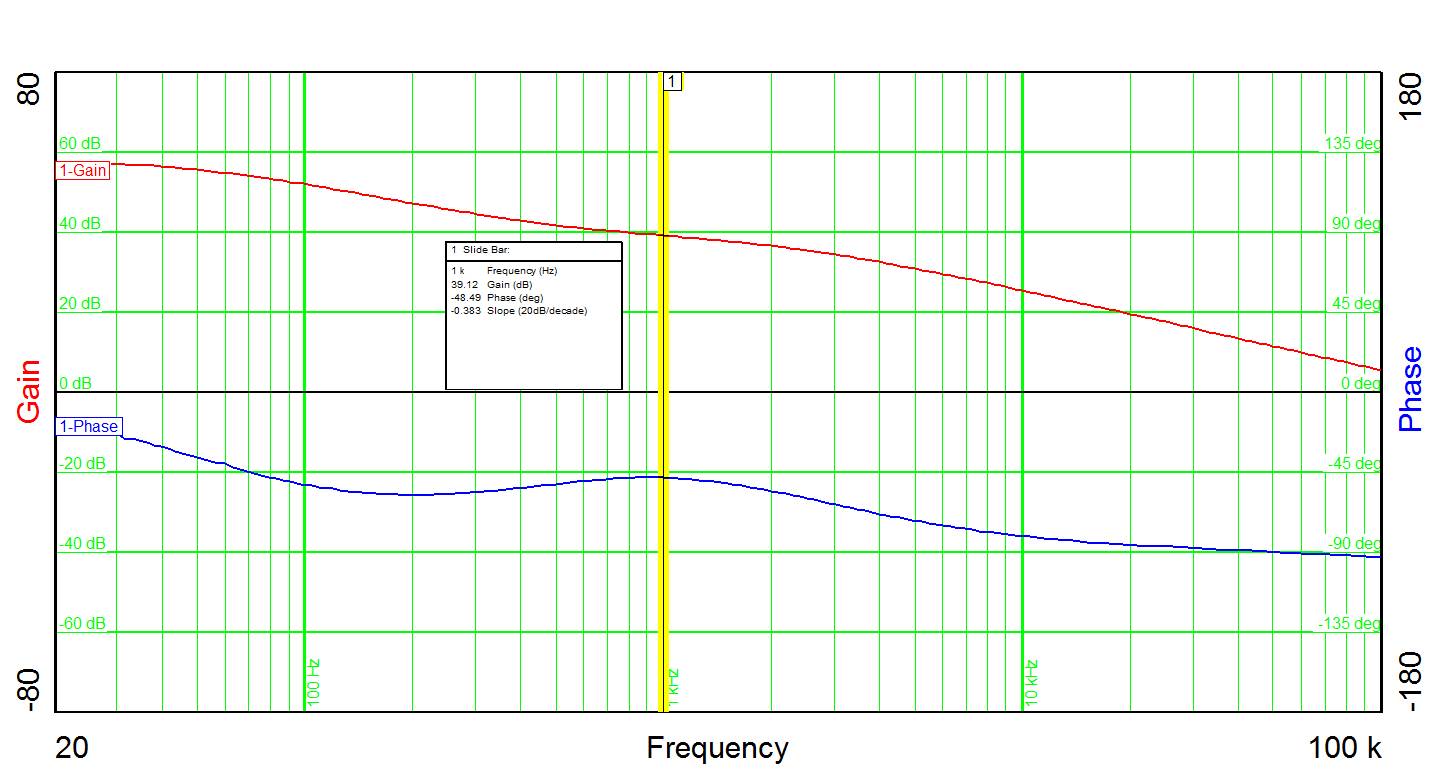

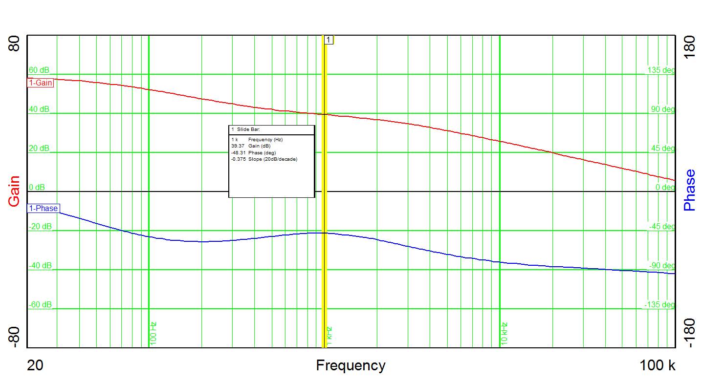

I finally got to scan the RIAA preamp sections of this preamp after a humiliating experience last weekend (locked myself out of the lab and had to slink home in disgrace...). Match between channels is not quite as precise as earlier versions of this amp, but still OK.... I think wat happened in this case was I was only able to match the PN4341-based 2nd section of this preamp at the max current capability of my sorting jig, which is ~15 mA. Actual bias current was more, so the second stage gain elements likely had a less precise matching at the higher bias current vs. the max 15 mA of the sorting jig. I think that I will go back into the jig and mess with the bias resistors on my reference so I can get at least 30 mA capability. 0.58 dB of difference between channels at 1 kHz is still not all that shabby.

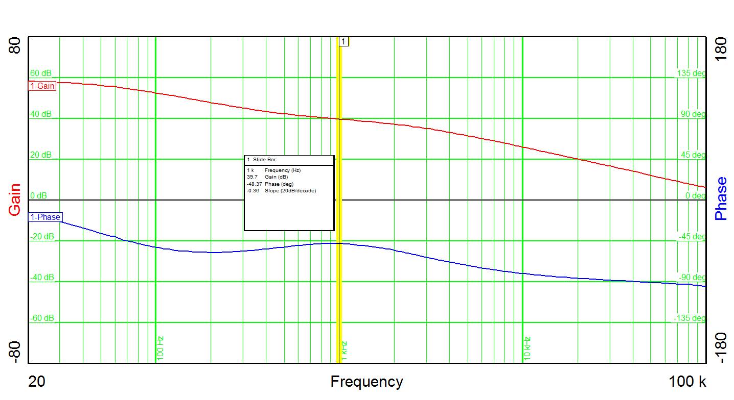

Here are the results from this afternoon's G-P scan. I found that I had used 4.53k instead of 4.32k as the gain resistor on the 2nd stage of channel 2. Using the proper value of gain resistor (and a bit of rebiasing) reduced gain mismatch between channels to 0.25 dB, down from 0.58 dB.
