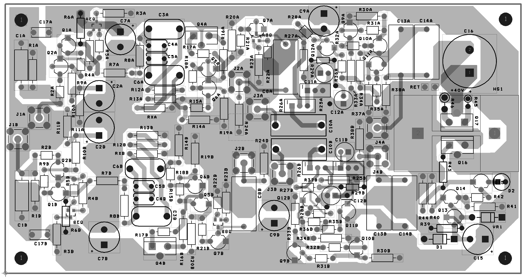

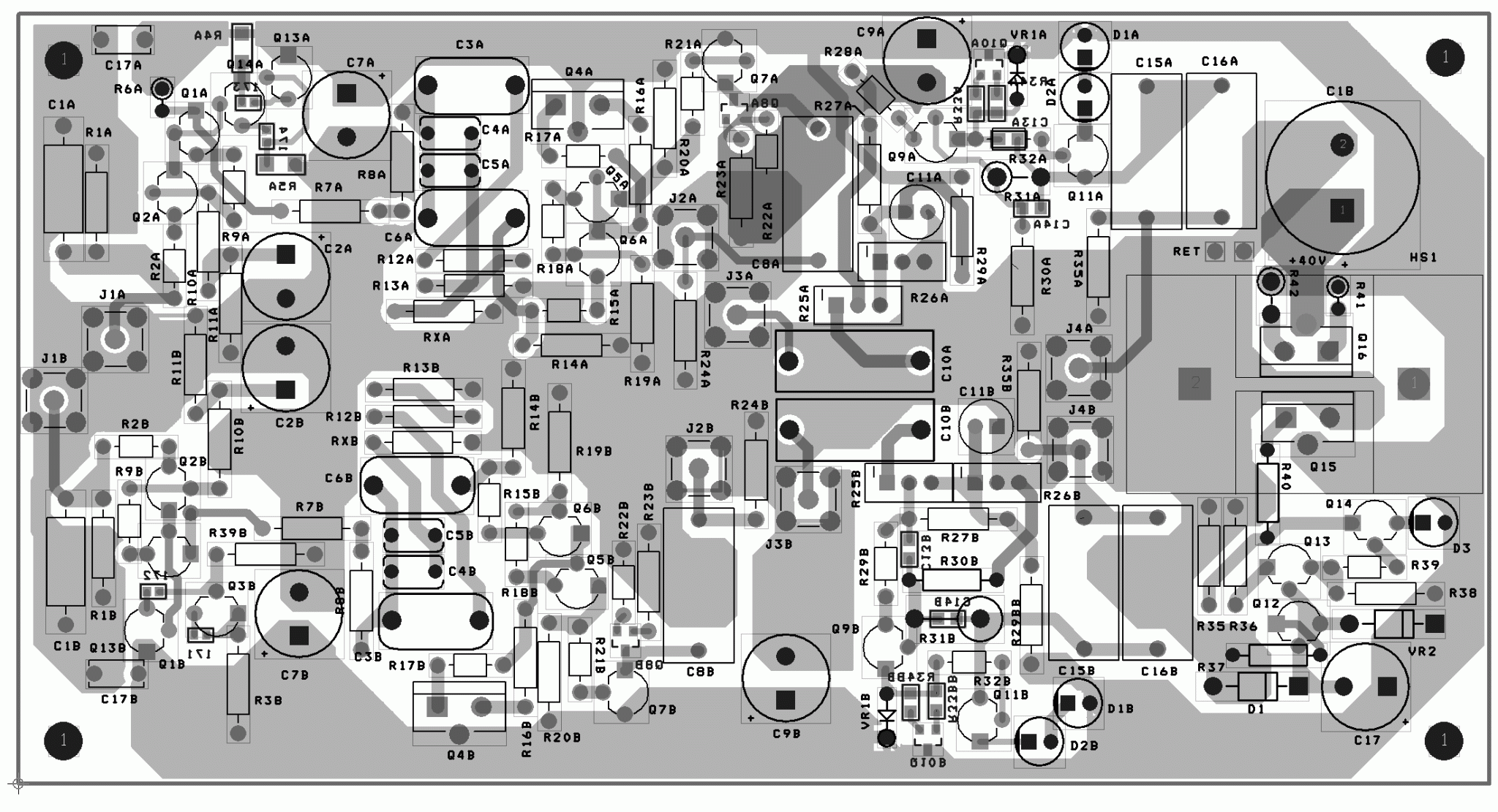

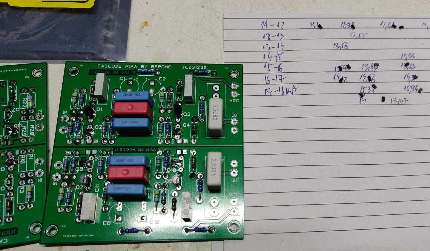

I'm busy putting together a layout to incorporate the two gain cells I've presented. I'll also throw in a lineamp, - an all-in-one preamp board, as it were...

Last night I nailed down some NOS Vishay/Siliconix PN4391s and some National PN4091s. Layout is in the last stages of tweaking and checking. I may go out for boards this weekend. I'm also considering getting some Linear Systems PN4391s, as they use a different process with higher transconductance.

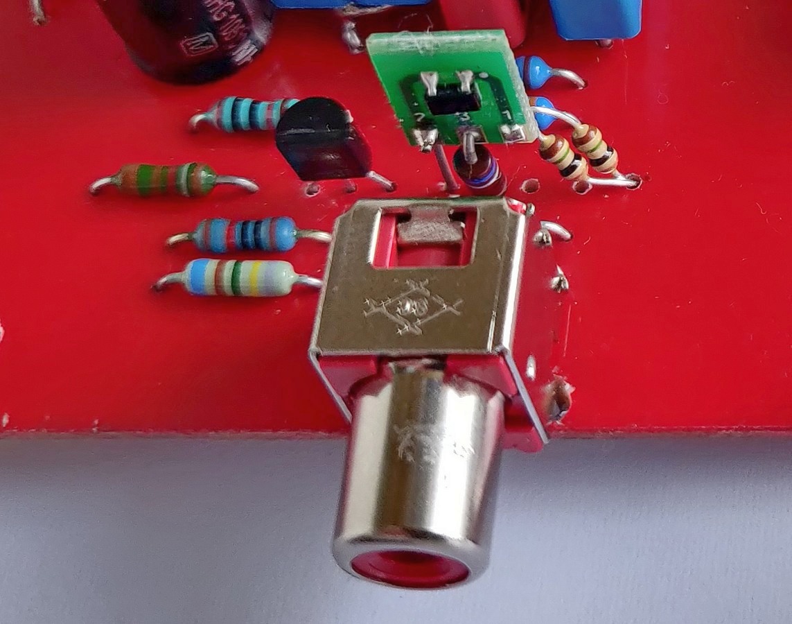

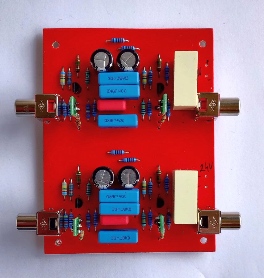

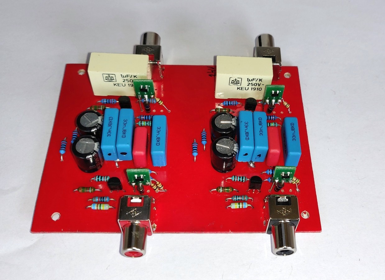

produced boards for cascoded version.. matching in progress of 2SK2394 's, Idss is from 12-17mA so Rs=20ohms is used for bias..it can be changed to any other value very fast because is in SMD 1206. PCB is accepting any other fet SMD or TO-92 package, so i can experiment with anything from the shelf

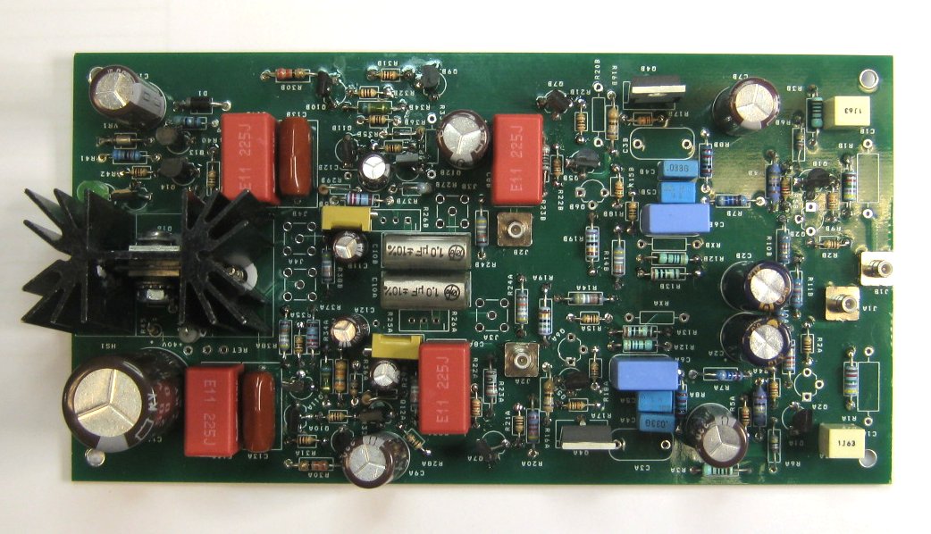

Here is one board, almost completely stuffed. I still need to select some JFETs and capacitors, and rustle up a few more SMB connectors for the ins and outs.
One board = one entire preamp, with 2 channels each of RIAA and line stage. The heat sink to the left is for the onboard discrete shunt regulator, that will supply +30V for the main supply.

I'm kinda scratching my head, as I declared the board finished, but for the life of me, can't find it. Maybe it's already lurking at my workplace - I'll check when I get in on Monday.
Couldn't find the finished board ore the other bare boards. What i did instead was to redesign the output buffers (new layout) for 5X gain with bias adjust. Those are in fab as we speak at PCBway. I'll have another go at construction when they arrive.
Boards are here - I'm kinda frosted that I have to go through this whole exercise yet again, but I'm happier with the line amp design on the new PCB.
