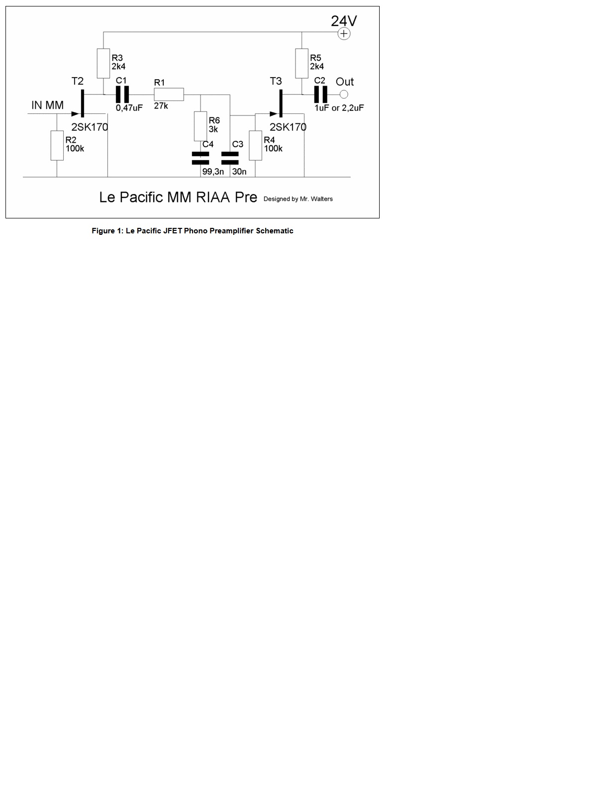

Just as a matter of interest, wrenchone, the original 'Le Pacific' circuit has the Drains of the jfets connected to the +ve DC rail (via a resistor).
AIUI, this setup removes any Miller capacitance - which is important, in the case of the 1st gain stage of a MM phono stage (otherwise this Miller capacitance would be loading the cart).
Does the 1st gain stage setup in your revised circuit (which is cascoded) also remove Miller capacitance?

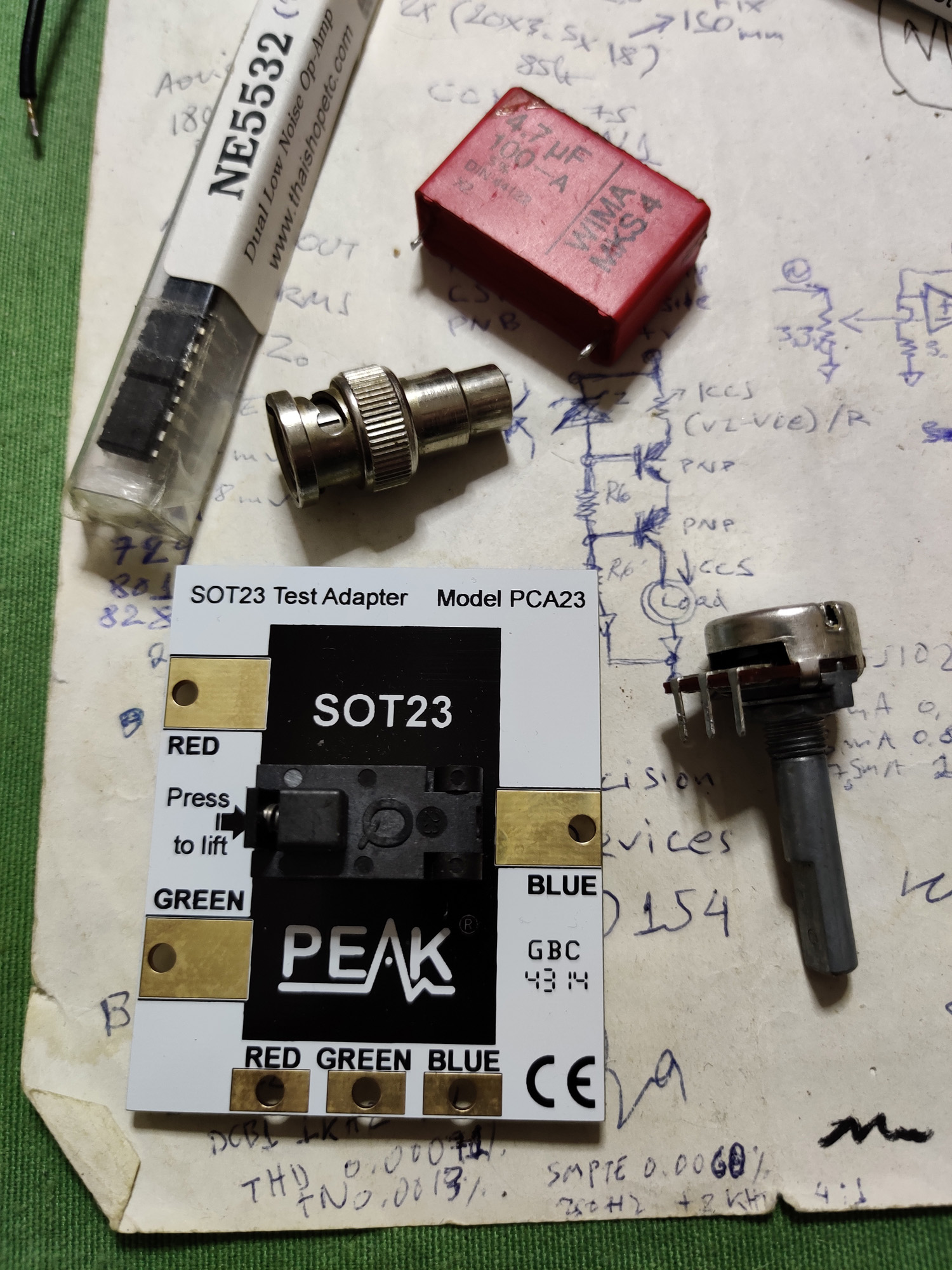

Nice one your jig. I have this useful thingy for SOT-23.
Very nice, I will buy one, thanks Salas.

The original Le Pacific setup does not stop Miller developing by full gain.
Aah, OK, Salas ... I didn't know this. 😱
I thought that when Drain was connected to the +ve DC rail (via a resistor which sets the gain) - see attached circuit - this setup removed Miller capacitance?

No, its a classic common source arrangement.
Watch this video. You will understand.

Hi Salas,
I notice that the circuit which the guy shows in his video has the cascode as an NPN transistor sitting on top of a second NPN (so the Emitter of the top transistor is connected to the Collector of the bottom transistor).
But I have seen in other circuits, a PNP transistor sitting on top of a 2SK170 (so the Collector of the top transistor is connected to the Drain of the bottom 2SK170).
So can either a PNP or an NPN transistor be used as the cascoding transistor?
Thanks,
Andy
Yes, but a PNP must be used when the DC voltage at its collector is lower than the one's it cascodes. Liike in "folded" cascode that has the load resistor connecting to ground. My UFSP phono's input stage for instance. Which is NJFET+PNP hybrid fold. The straight to rail cascode as in the video, which is most commonly met, is also sometimes named "telescopic".
P.S.
Always emitter input on top to be a common base for cascoding. Collector to drain you saw maybe it was a constant current source load.

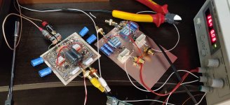

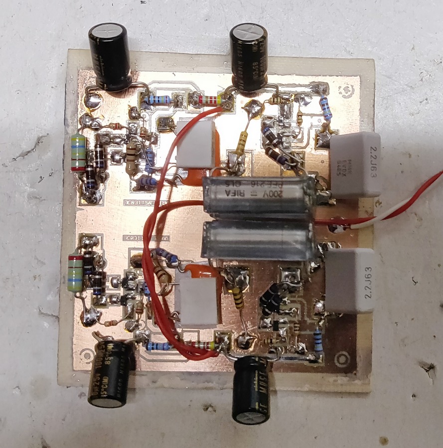

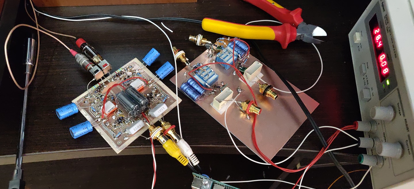

iteration next is 2x2SK209 in parallel per position. developed board, fets matched, separate g.stoppers and s. resistors per fet. pcb is done fast , in a few h, and components mounted in 3D. voltage gain is fine, 35dB, DC supply with Rs=30 ohms must be over 24V, from 28-32V.. or Rs to be increased to 40ohms and use lower DC supply (with lower total gain ). found some nos polystyrene Rifas which i will test through RIAA and coupling positions.
on first there is no big difference between this and previous version with 2SK2394.. need to make A/B switcher to find out differences fast.

Nice test board work. Its for MM cartridge, yes? Because gate stoppers and highish source pin resistors contribute directly to the noise budget. Signal source impedance must be much higher than those to sufficiently swamp them.
