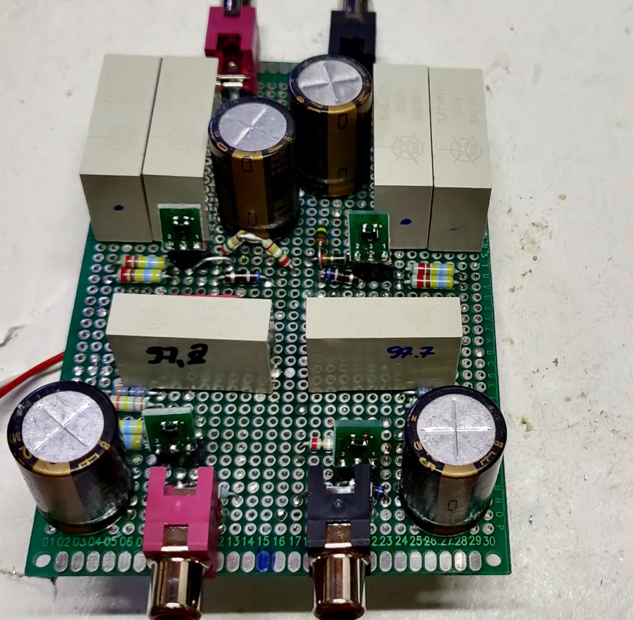

sound wasn't verified.. but instead new build started with CPH3910 on universal PCB , with Iskra and Wima polypropilenes . CPHhave high Idss so like with 3557 resistors 20-40 R needed in drains of both stage..connected to adjustable DC supply, several working points were checked..Riaa deviation stayed like before, straight line
at the begining sound was little bit shrill on my system (no any valves at that moment in chain, all solid state, usually im on valves) and i didt like it too much, but i didnt hear any noise at all. quiet performance, but with presence.. i tried with changing the material in RIAA, i get some results but i started to loose time, felt like CHP is not perfect for this application.. plan was to find other Jfet wit lower Idss..i will return to CPH one day.

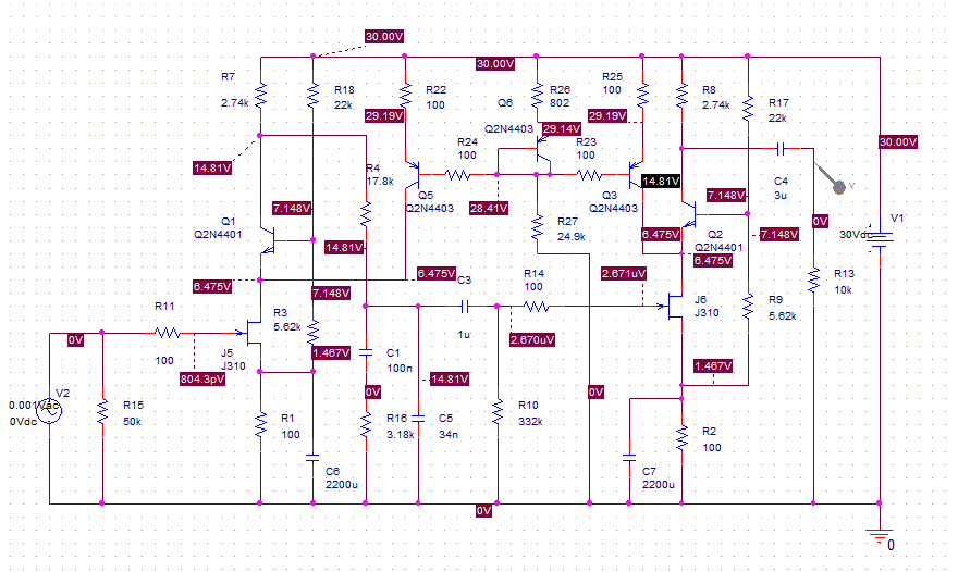

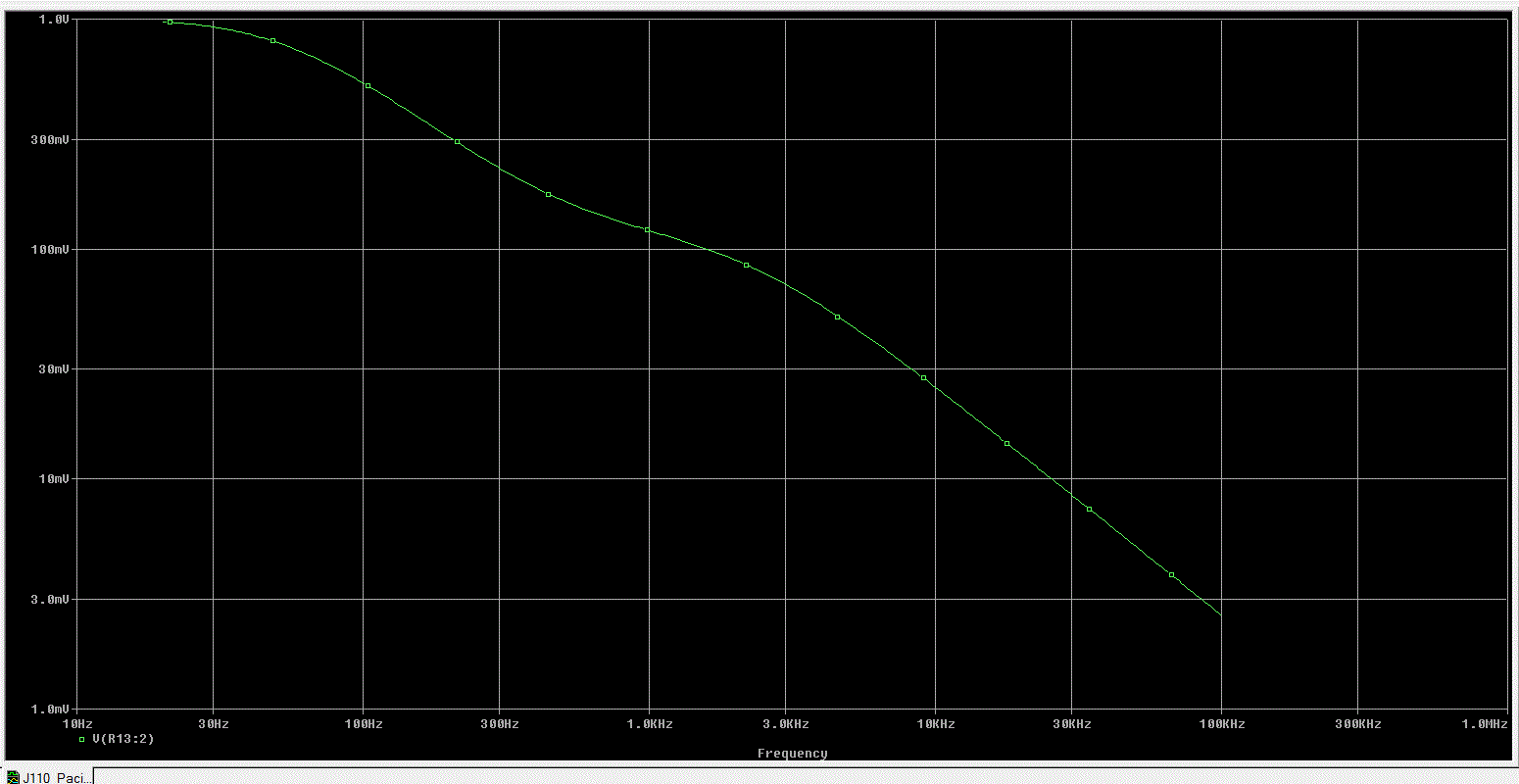

Much earlier in this thread I mused about an implementation of the classic "Pacific" circuit using readily available (at the time) devices like the J110 and J310 rather than the 2SK/LSK170. Attached is a stab at how it could be done, with cascoded gain devices and auxiliary current sources to provide extra bias current for higher gain and lower distortion. The circuit is a variant on the classic folded cascode, sort of "unfolded". The J310 is still readily available NOS from a number of sources, and of course the 2N4401 and 2N4403 are bog-standard devices available just about anywhere.
The circuit is more complex than the classic 2-device "Pacific" circuit, but the attraction would be lower distortion. Attached are the schematic from the PSpice simulation I ran, plus a response curve. This is a variant of the "All American preamp I posted a few years ago, detailed here:
"All American" RIAA Preamp

thx wrenchone for schem.. do you have harmonic spectrum of it?

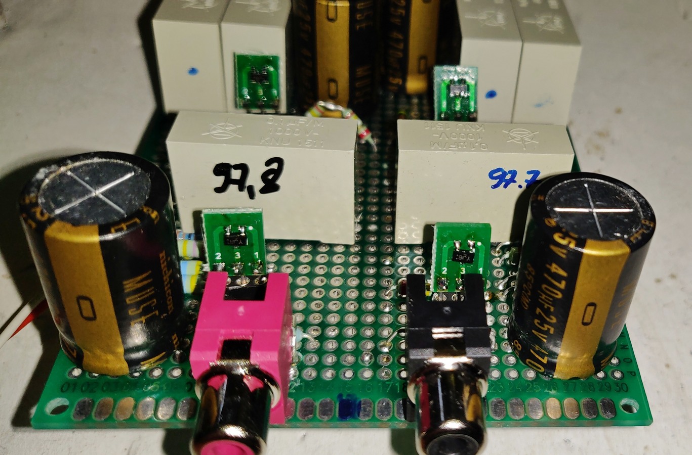

after CPH was removed i installed 3 pin sockets (cut from IC socket) for changing the fets on fly mounted on SOT23 adapter.. checked the schematic shortly with original 2SK170 and passed to next one, 2SK2394-6, with Idss 11-17mA.
tested with 10-20 ohms in source 1- source2, on 18VDC, and 5ohms (S1) and 10 (S2) ohms on 24-27VDC supply.. maybe i prefer later..here review is very positive, bass is fast and strong, middles are great and highs on my system little bit jumping out (SS), but tested on second system valve preamp with valve SE 8W.. this was creamy , other dimension, not fatique any more.. great..9/10.. compared to tube phono EAR834, valve phono has more "body", "thickness" in the middle , this missing here for 10/10. but EAR has flubby bass compared to this one.

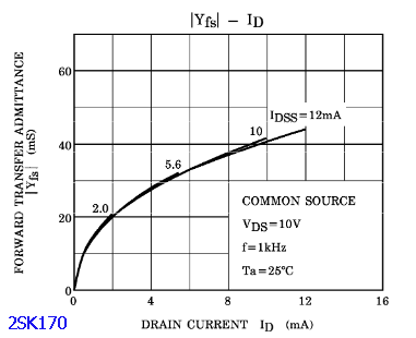

Roughly speaking. To be more exact lets examine their official Yfs/Id curves. At say 4mA Id the 2SK170 has 28mS transconductance (Yfs) when a 2SK209 has 16mS. Same test conditions. Thus the K170 has 75% more Yfs than a K209/K117.

but your gain is dropping with lower current (see datasheet transconductance vs current).
Yes, I understand that gain reduces, as you reduce the current.
But where do I find the "transconductance vs current " graph in the datasheet - for instance, in this datasheet?
https://au.mouser.com/datasheet/2/308/NSVJ3557SA3-D-1813828.pdf
Andy
EDIT: Do I look at the "Forward Transfer Admittance vs. Current " graph?
yes.. those graphs quoted from Salas, see how the transconductance (also gain you can say) is going up with the currentDo I look at the "Forward Transfer Admittance vs. Current " graph?

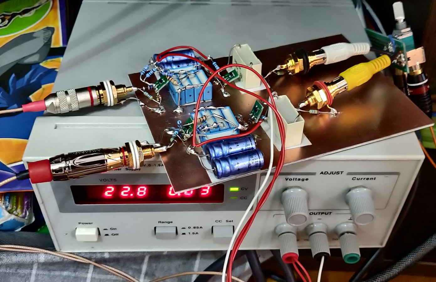

how the 2SK2394-6 is working fine, it was time to explore different assembly 🙂
RIFA PHE450+Iskra MKT output caps, and some vintage Philips Elcos, 2SK2394 on adapters soldered directly on copper clad..no any technical problem, noise and hum are negligible and sound from this combo is very good. bass, mids remained great, highs on my solid state system calmed down one level..very good. now is time to change amplification for some tubes or serious SS amp to check this riaa more in depth , and prepare/develop new pcbs for 2SK209 in parallel
